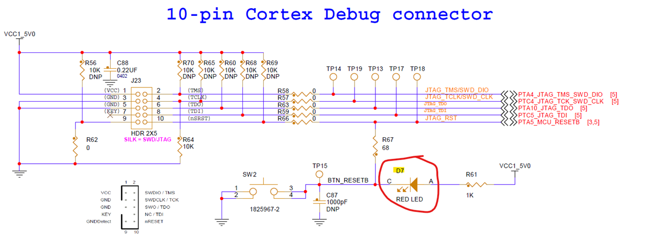

I work in the Automotive Industry, and I'm aware of the AUTOSAR architecture. Hence I decided to apply for this RT. Initially, I received the board with the three PMSMs. However, I could not use the board, after debugging this with the manufacturer we found the board was defective, link to the ticket. To summarize the issue, the MCU's_reset LED (D7) was glowing continuously after the board was powered ON, this explains why the debugger could not halt the core. I'm unsure if the issue is with the MCU or the board. The debugger was able to connect with the new board. I used a SEGGER J-LInk debugger.
 Thanks to   for arranging the replacement for this board. I was able to work with the new board & got the motors to spin.

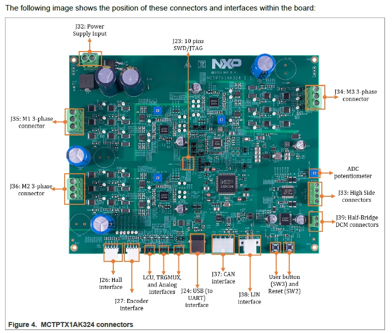

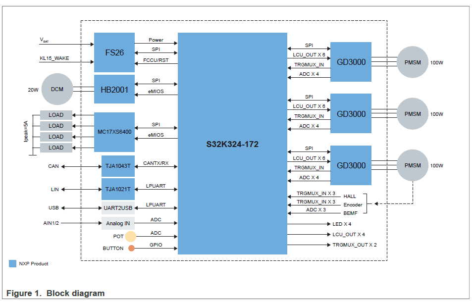

The board is rich in interfaces for the user, such as UART for FreeMASTER, CAN, and LIN interface. The triple PMSM motor operation is based on sensorless application, hence we need to connect only the phase wires of the motors. The board uses three GD3000 3Ph motor pre-driver ICs. The board can also be used to control a DC motor. One of the interesting applications for this design is the Integrated Thermal Management Unit used in automobiles.

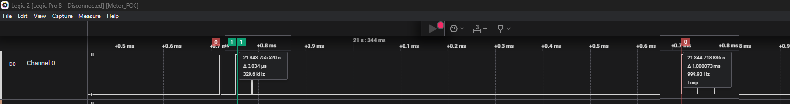

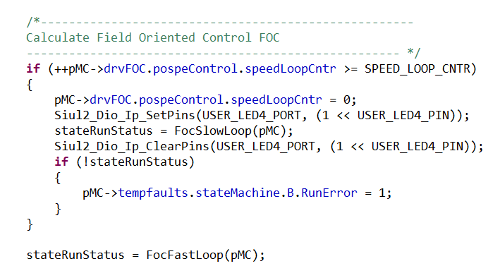

Yet, it lacks a user GPIO. I was trying to profile the FOC loop SW and figured there is no user GPIO on this board. However, I managed to do it by using LED4 as GPIO and connecting the logic analyzer probe to the test point on the boar

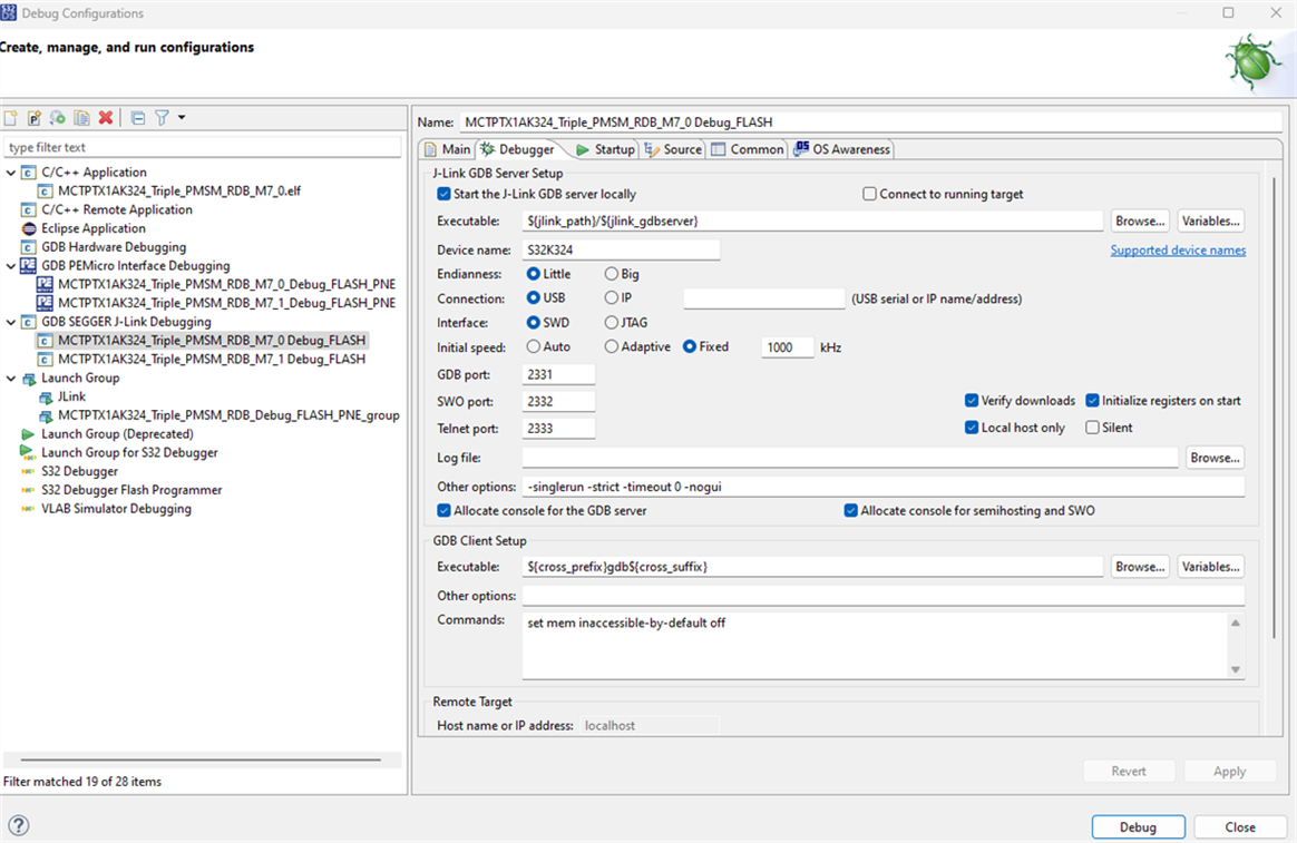

As mentioned above, the out-of-box demo is not pre-programmed with the board. I assume the flash is erased after testing the board before shipping. One can follow this link to get all the required SW, starting from the S32 Design studio to all the other SW packages such as Inter platform communication SW, Real-Time Drivers, etc. But one thing to note here is, that you must give the default install location in C:\ drive while installing the SW packages since the source files are referenced using the absolute path, and if the packages are installed in D: or E: drive, the SW will not build with the reference projects that was imported into the IDE.
Given below is the debugger configuration that was used to flash the application into the MCU.

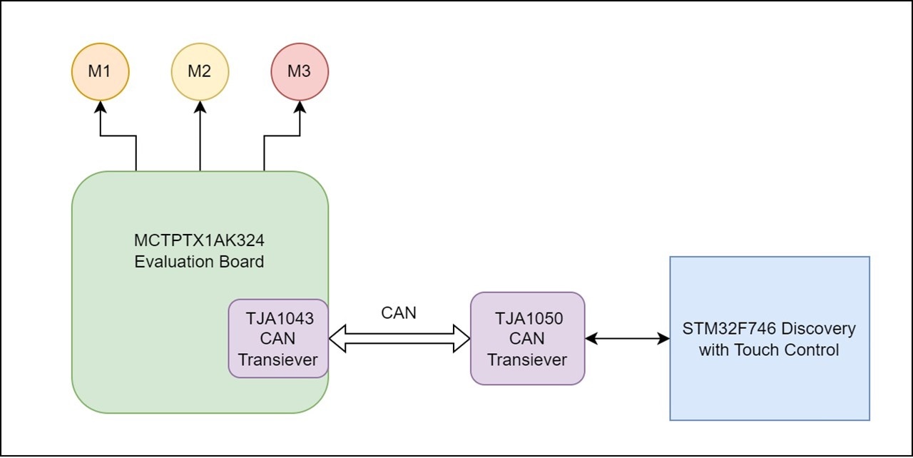

The GUI Demo uses the onboard CAN interface & an STM32F746 Discovery Kit. The GUI application is developed using TouchGFX, the code used for this demo can be found here.
I felt the details on the data fields in the CAN interface provided in the getting started page could be more detailed - even though I used the obvious approach and it worked.

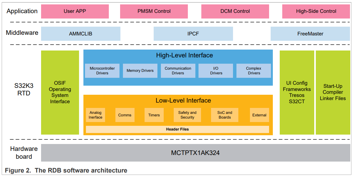

The RTD (Real-Time Drivers) supports the AUTOSAR environment which ensures easy integration while developing for automotive applications. The FOC calculations that involve Park/Clark transformation are done using the Automotive Math and Motor Control Library Set (AMMCLib). It also provides functions for observing the back EMF, as used in this sensorless application. The IPCF is used for communication between the cores which also provides freedom from interference and a zero-copy approach for optimal performance. The PMSM control comes as part of the application layer, where one can also write applications for DC motor control. The FreeMASTER tool on the host machine uses JavaScript for the UI.
This section describes the profiling of the FOC loop in SW using the LED4 GPIO.
Here we can see that the time taken for the FOC loop is much less, and the three spikes show the FOC loop being run for three PMSMs. The interval between the consecutive FOC loops for the same motor remains 1ms irrespective of the RPM set.
