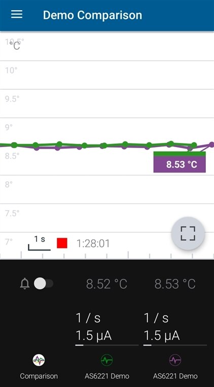

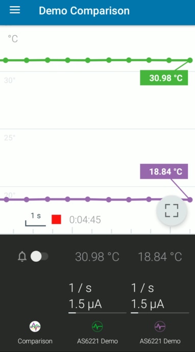

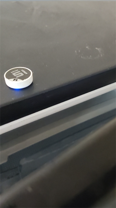

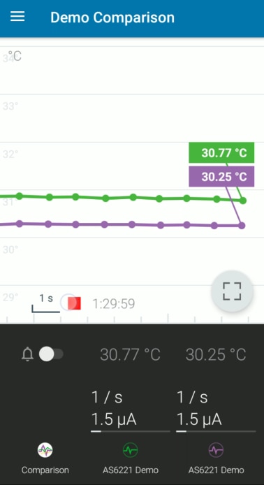

First test: The test carried out with ams OSRAM Digital Temperature Sensor Kit is to monitor temperature of the cold storage chamber in refrigerator to know the temperature of the freezer remotely instead of looking on the display every time. It helps to know the refrigerator working condition and its cooling period. In the test I used two AS6221 digital temperature sensors Demo kits one is place inside and the other is place outside the refrigerator and it was observed the temperature fall time in Companion App AS6221-DK in mobile while cooling the chamber and the data is recorded in the file.

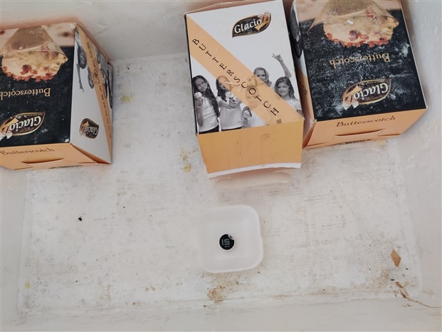

Second Test: In the second test the Demo kit was place in a thermocol box where ice-cream boxes are carried out to the nearby place for the distribution during the event. The temperature is observed time to time so that precautions are taken to complete it before melting. A sample test status was shown in the below pictures.
image Sensor kit is placed in the thermocol box.
image   The max temperature indicates the senor was placed from open air into the box and the temperature of the box is maintained about 15 o

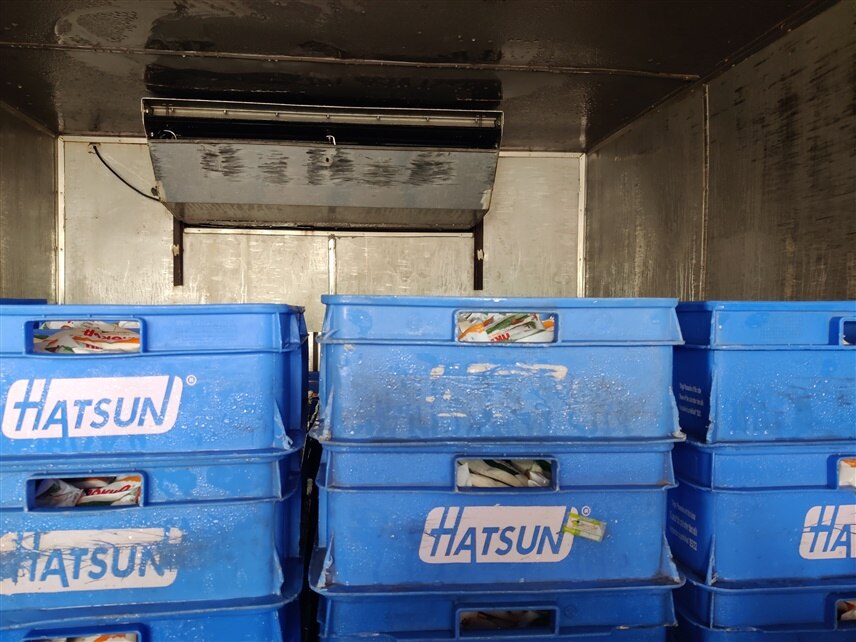

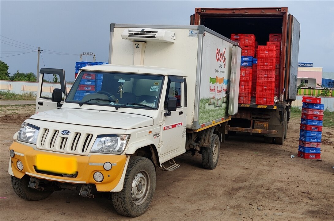

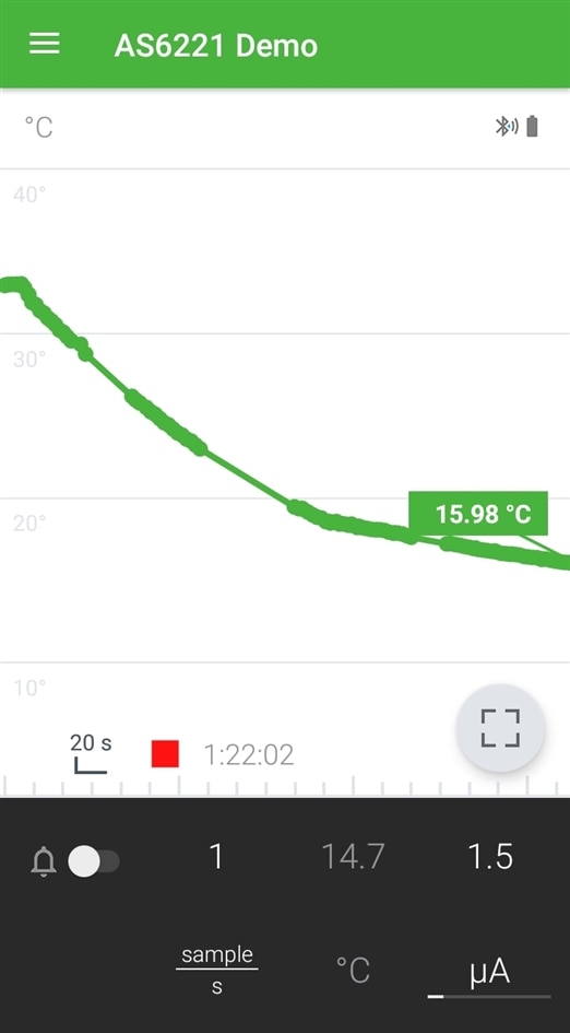

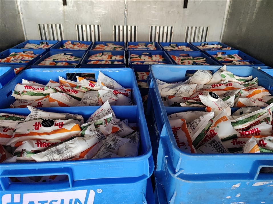

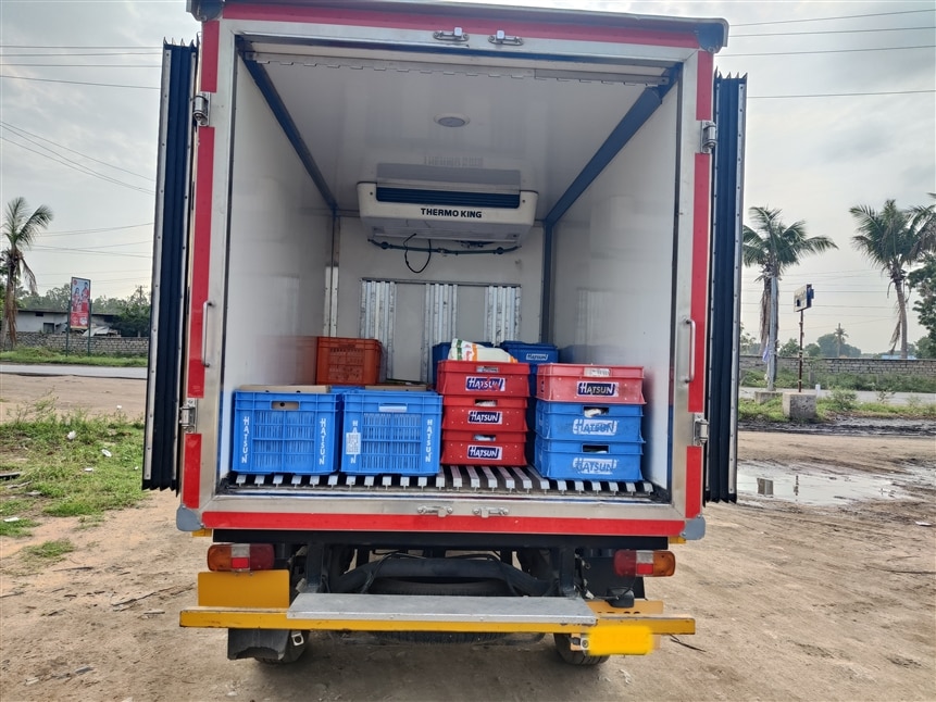

 Third test: This task was performed for logistics container where milk products are transported to long distances. If the temperature is maintained constantly then the food products will not damage. The products in containers are transported via trucks and is distributed to the local vans. The temperature value can view in mobile app. The temperature measurement is carried out with two devices and few pictures are shown below.
Below picture shows the freezer in the mini truck and in the container to maintain the low temperature.
image  image
image image
Temperature fall in the app shows not food products temperature, it is taking time to settle to the container temperature.
 image  image
In the above app it shows the settle temperature to the container temperature.
