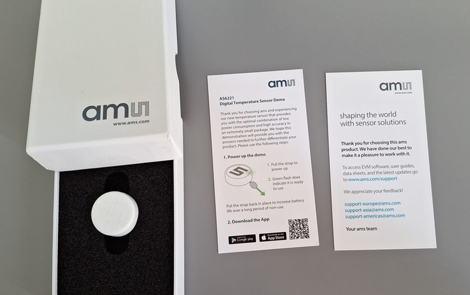

AMS OSRAM Digital Temperature Sensor Kit AS6221 is shipped in an elegant, compact antistatic packaging with two small leaflets covering needed details to start with.
Prerequisites:
As per the instruction leaflet that came with the kit mentions to download either Android or Mac app to operate this kit. So, one should have the right device that supports these apps in hand to operate this kit.

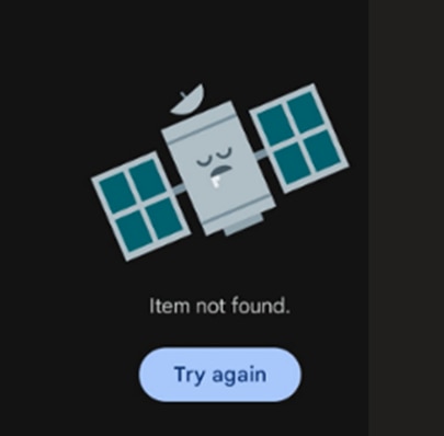

         1. Android App: It seems this app is not yet made available to user.
             Since I have an Android mobile, I scanned the QR code that is given in the leaflet, but it throws an error that the App is not available.
            The QR code which is given in the instructions leaflet to download the Android app is not working. It shows the error. “Item not found” on my android mobile.
            The link when I scan the QR code is as below:
                   http://ams.com/AS62xxiOSApp?utm_source=QRcode&utm_medium=folder&utm_campaign=AS62xxApp
           Then to Android App the link is: https://play.google.com/store/apps/details?id=com.ams.as62x0
          Note: I contacted the AMS support team but there was no response. Then I went through Element14 manager who was responsible for this review. He, personally discussed with the concerned team and informed me that the Android App is not yet available.

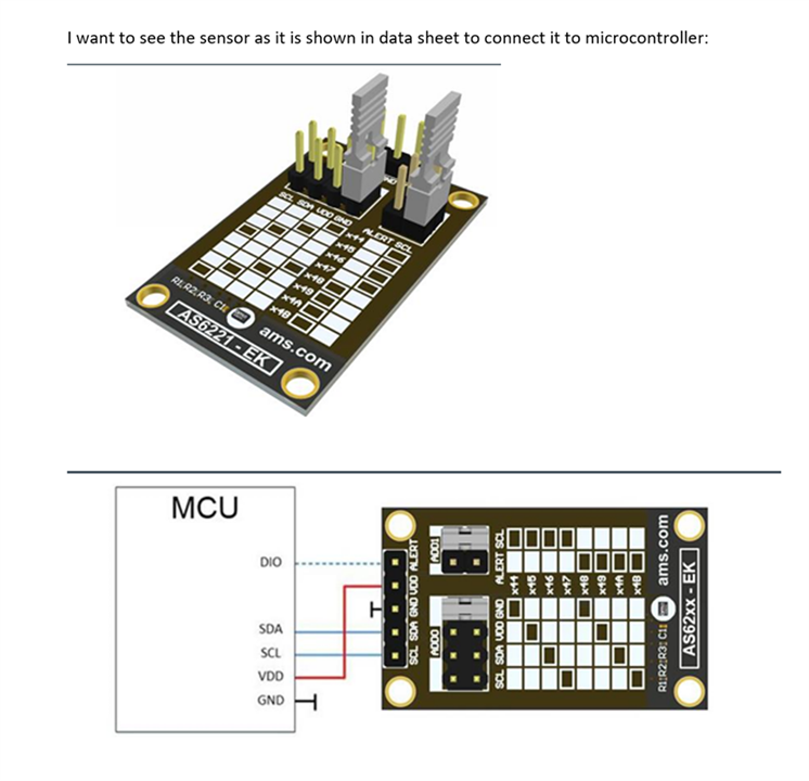

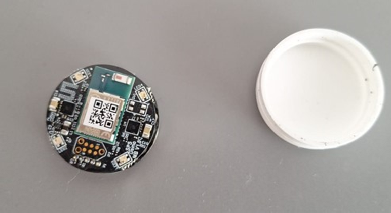

           3. I2C interface: I assume this will work and asked the support team whether I can open the case and try to connect to this I2C interface. But for this as well there is no response from support team. Again, manager from Element14 intervened here and he got an answer that this kit can be tested only with Mac App. With the permission from Element14 manager, I opened the case to connect to I2C interface. But I don’t see any activities on that interface. It could be that I am doing something wrong and running around the bush without the support from the vendor.

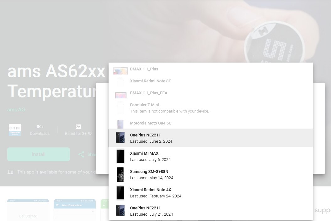

  • Looks like the AMS resource gave an incorrect answer to Randall. Not yet available is different to no longer maintained.
  • According to Google Play, the app has been available for a good many years.
    However, it seems it has not been updated since 2020, so when I try to install, it will only go onto my older 32-bit Android devices:
    I would suggest you try using an old Android phone, probably one with Android 7 through 9. If you have the later Android versions, say 13 or 14, which are 64-bit capable or 64-bit native, the Google Play store will not show you or allow you to install older 32-bit-only apps which is why you are receiving the error.

  • Unfortunate that you couldn't get it working on your Android Phone. But What would have been interesting is reverse engineering the module a little bit. For example, You can use nRF Connect app to see the BLE profiles used by the module. Since it's a temperature sensor module. You will likely see a standard temperature profile inside the GATT server. Until unless they use a custom BLE profile for sending data.
    The other interesting thing is to play with the JTAG provision ( Tag connect ) given in the board. It looks like it's a Bluetooth module based on nRF52 series. If the JTAG is not disabled. You can read the flash and probably run your own applications.
