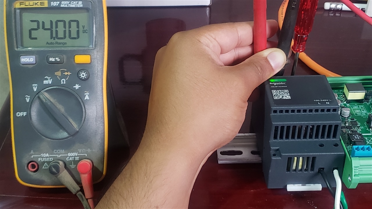

The AD-SWIOT1L-SL requires an external power source to operate. In addition, its case has a special feature, this is the DIN rail molded supports. Considering these characteristics, all the components are mounted on a DIN rail for easy mounting and wiring. On the other hand, the power source must be out 24V, this is reached with a Schneider power source, used in other projects Wink, and it is adjusted for the correct board functionality.
Output voltage measuring in the power supply

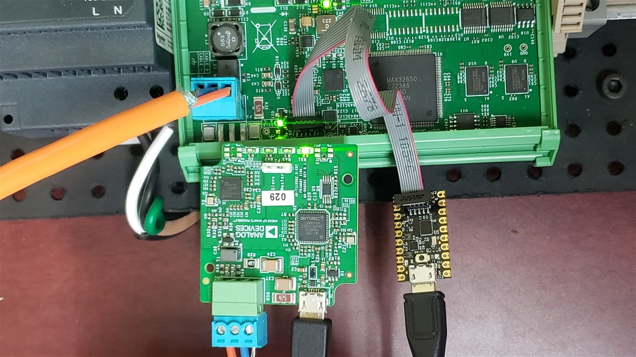

Once the power source is validated on the operation conditions, the rest of connections using ferrule elements to avoid issues with the wire movement during the tests. The final mount consists in the usage of the main board, the MAX32625PICO for programming and serial port monitoring, and the 10BASE-T1L to USB adapter board for the use of MQTT-based firmware.
Available communication interfaces

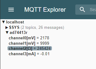

For monitoring, the MQTT Explorer application runs an GUI for easy visualization of the data transmitted. For the connection is sufficient with localhost server and 1883 default port to connect to MQTT broker. For first impressions, the topics created by the AD-SWIOT1L-SL are shown below, and you are able to observe that the units are available in the topic while the numeric value is published for easy parsing as mentioned before.
Data readings

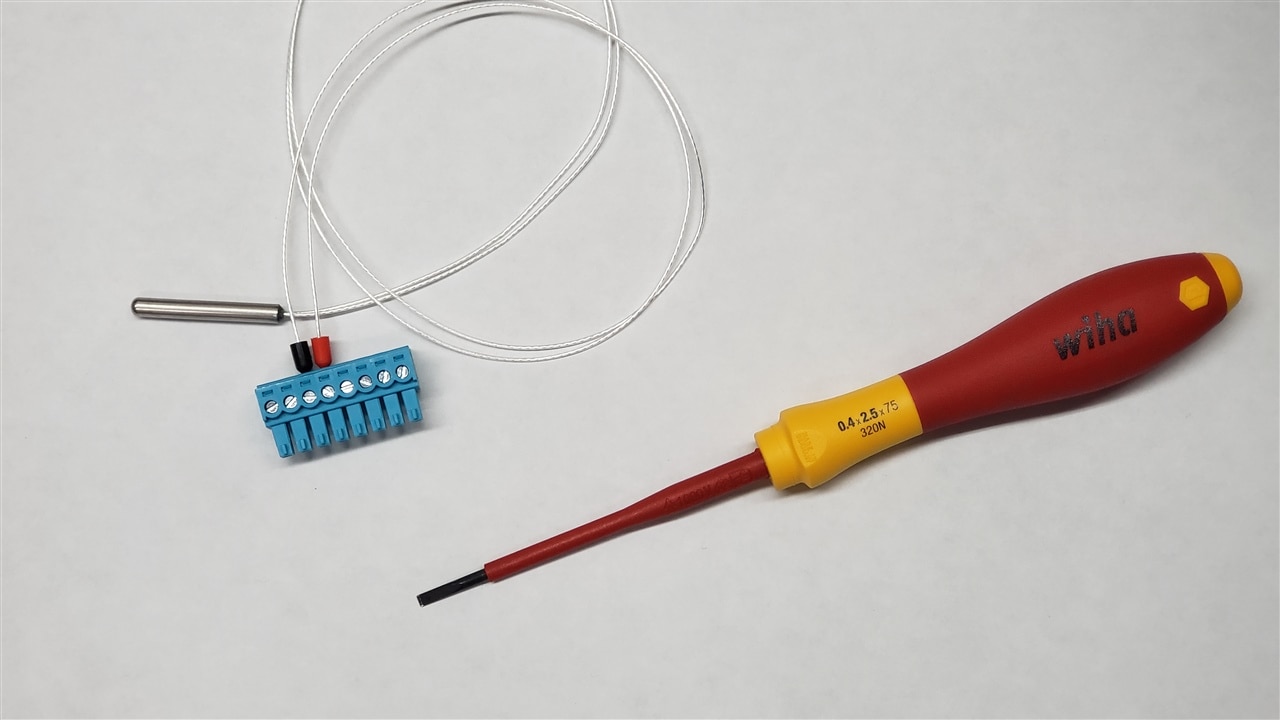

For each data acquisition challenge you are able to connect the sensors in a pair of terminals. for this time, an RTD PT100 sensor is connected to the channel 2 since it is configured as resistance measure as default.
Sensor connection

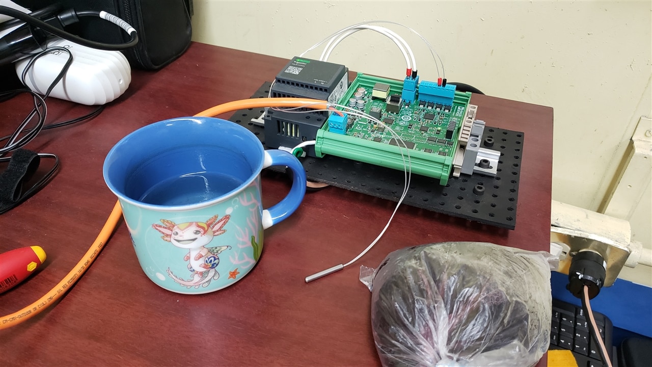

For the experiment to test the response of the PT100 in Ohms, a cold water bag and a hot water cup.
Experiment setup

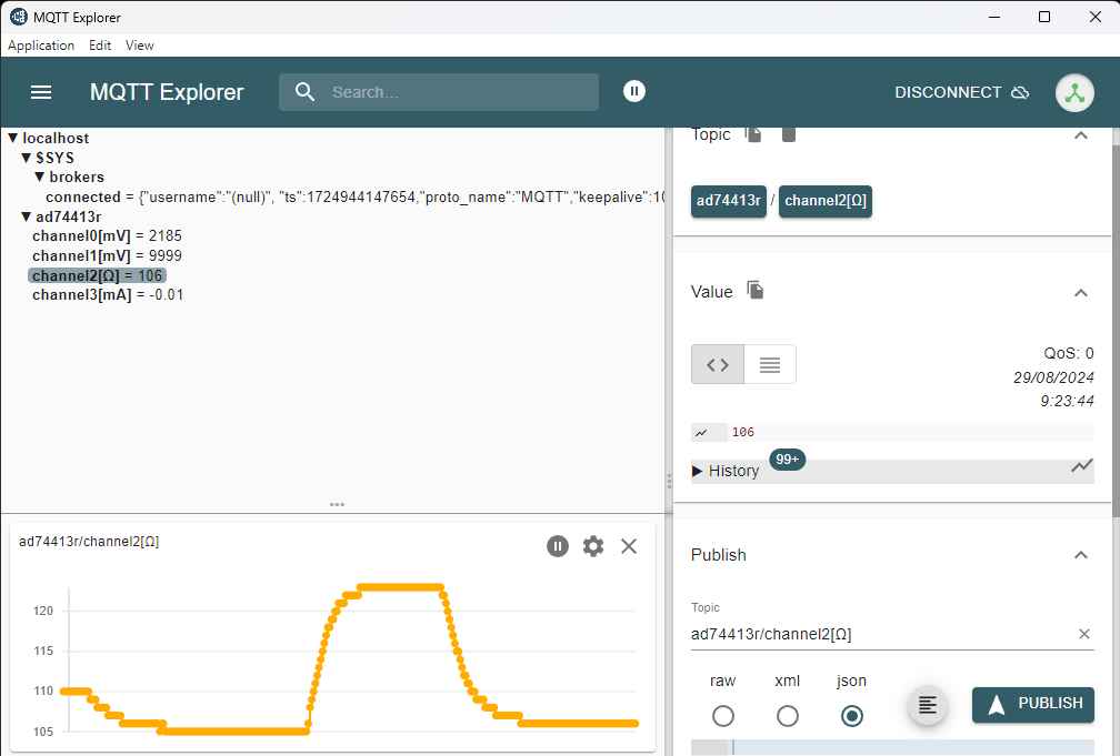

The process consist of the room temperature acquisition, wait a pair of seconds, sample the falling edge with the cold water up to no observable changes. Finally, the rising and falling edge with both containers is made to get the sensor response.
Sensor response
The future work consist in the mounting of a lab stage to improbe the sensor characterization and calibrate to standard PT100 response to obtain a funtion to get temperature according the resistance measured.
