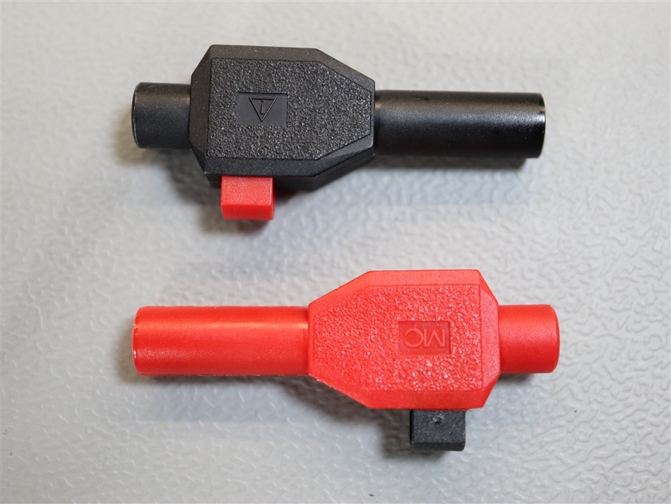

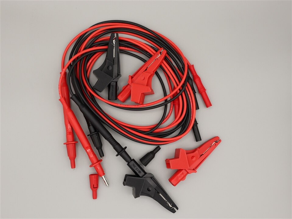

  • 6 pair of CAT III banana test leads with alligator clips and 6 pair CAT II banana adapters for bare wire, along with other accessories
{gallery}Accessories

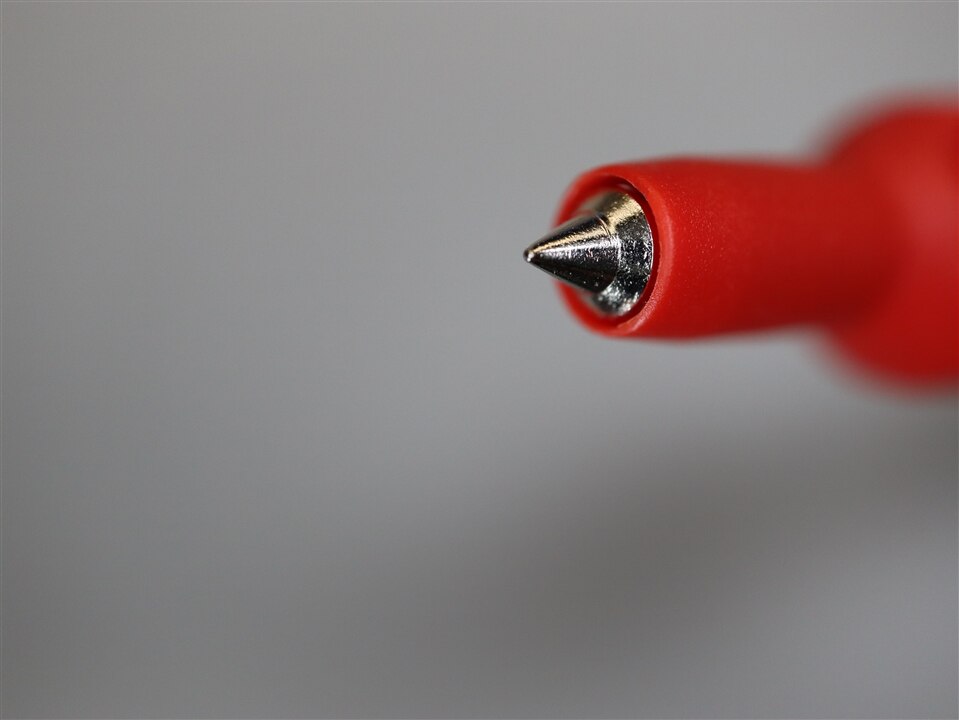

Analog Probes with Alligator Clips
Probe Tip
Bare Wire Banana Connectors
Connectors for PT100/1000 RTD Temperature Sensors

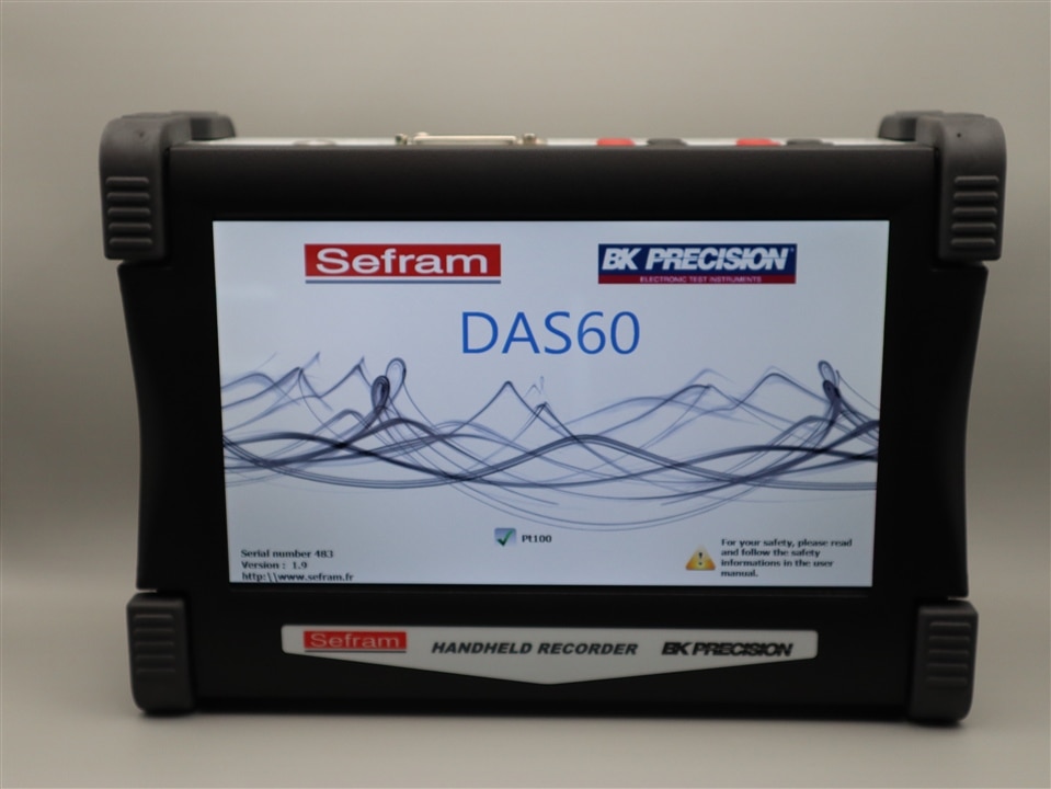

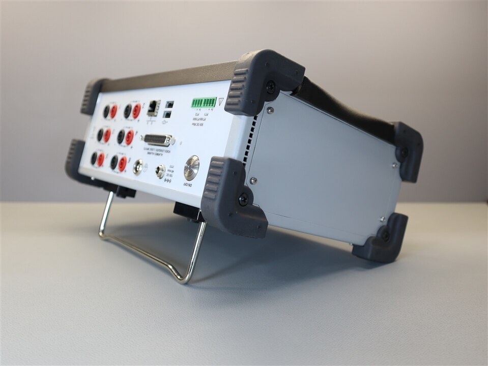

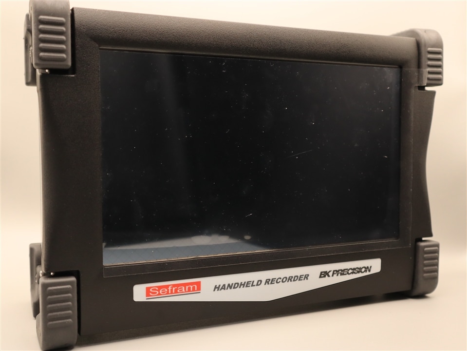

The DAS60 is solidly built with metal casing and thick bumpers on each corner. It is battery operated and designed to be portable – I appreciate the sturdy carrying case, which made transporting between locations easy while protecting the equipment. The DAS60 is well built. If there was one thing I would change, it would be for adjustable feet to allow you to tilt the equipment back slightly, and improve the screen viewing when working on a bench. There is a stand, this stand presents the ports on an angle well however is too low to improve viewing of the display.
{gallery}DAS60
DAS60 on Stand
DAS60 Front
DAS60 Case
The large, bright, 10” WSVGA (1024x600) TFT color display brings important detail forward when viewing waveforms. The capacitive display is responsive to the lightest touch, which is helpful considering all controls are managed on the touchscreen aside from the top power button. The DAS60 supports dragging a cursor, but does not make use of other common gestures such as swiping and pinching – there are occasions where multi-touch gestures would be useful, such as zooming in/out on a waveform. The USB ports accept a mouse and keyboard, which allow easier control.
Custom RGB colors are available to identify channels or functions, a feature that becomes critical when displaying several waveforms at once. Another feature to help manage multiple channels is the ability to separate the screen into several segments instead of overlaying many signals on top of each other.

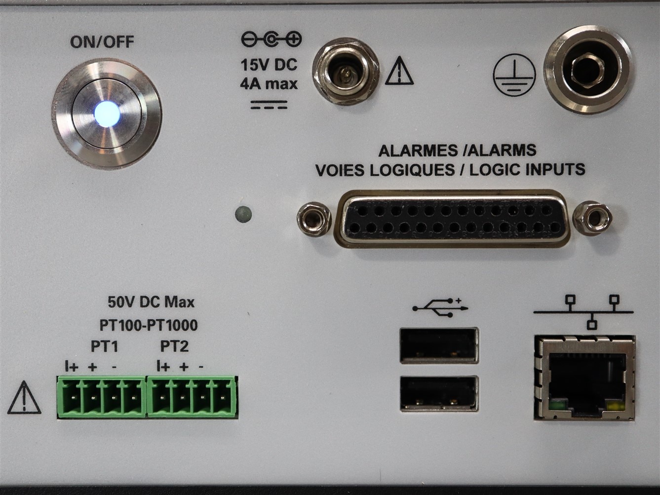

The DAS60 connections are easy to access on the top of the device and straight forward to work with. When acquiring data from many sources, this panel can get crowded, but the layout simplifies an otherwise busy surface.

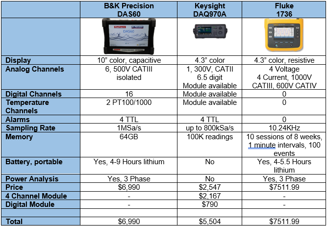

Comparison
The B&K Precision DAS60 has many capabilities, and it's precision and speed place it close to high end equipment. The inclusion of power analysis in a multi-channel, multi-function recorder sets the DAS60 apart. There is no direct comparison that has all the functionality in one device. Nevertheless, there are alternatives depending on what primary use-case is the deciding factor for a purchase.
If you are looking for a high-precision multi-function recorder, you may want to consider devices such as the DAQ970A. For those wanting only robust power analysis, the Fluke series would be my choice. If you want it all, you can purchase multiple devices. However, to achieve the best combination in a single piece of equipment, the DAS60 provides the greatest value.

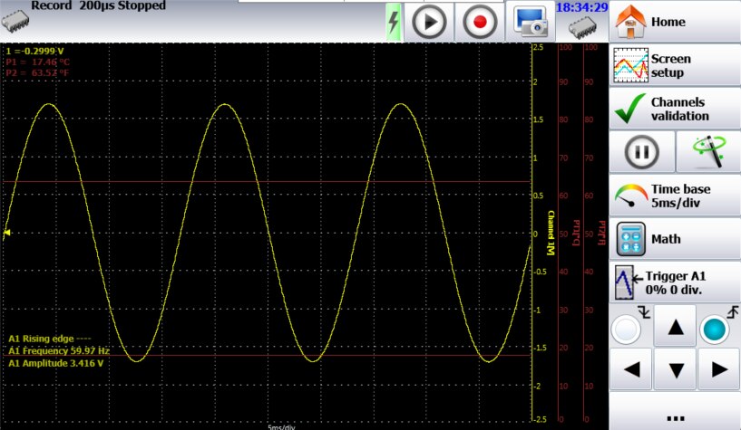

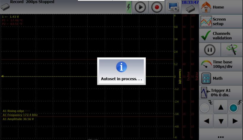

It is easy to get started with an initial measurement by selecting memory mode, F(t) display and pressing autoset. The autoset feature works does a great job and gets things going quickly.
{gallery}Autoset
Autoset Start
Autoset in Progress
Autoset Complete

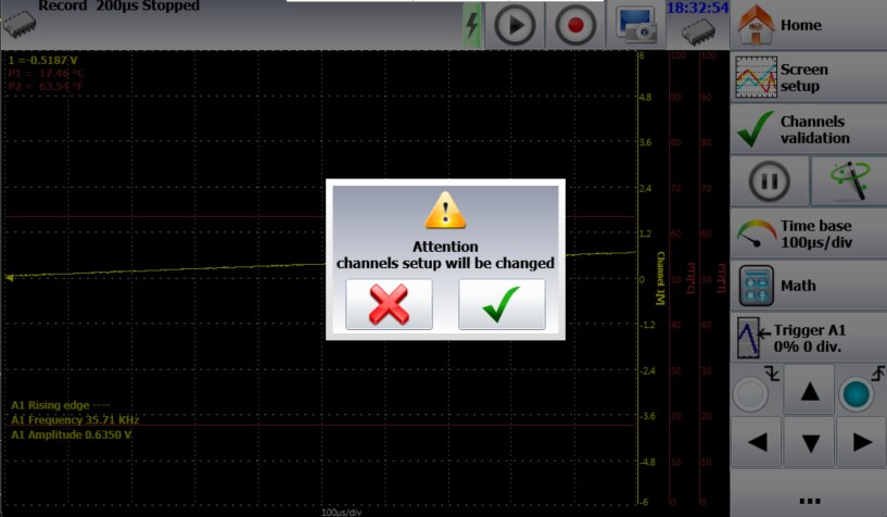

The DAS60 is powerful, flexible and nearly infinitely configurable, there is a setting for almost everything. I do like to have a flexible, customizable system! That does add complexity, which the device and pdf instruction material manage OK, but the manual could be more informative, intuitive, and polished - more on that later.
The menu buttons are for the most part, self-explanatory with pictograms and descriptions. But this is not always the case. A few data fields, when clicked on, bring up relevant sub-menus. This is good, but a way to improve the out-of-box experience would be to highlight fields that have sub-menus as it is not always obvious. Additionally, some buttons/functions disappear completely if a related option is not enabled. This had me looking for buttons I was sure I had seen previously. I like functions to be visible but greyed out if they are not available. For example, on the F(t) display, there is a math button to setup the functions. That button does not exist until you enable Display Math in another page.
{gallery}Button Missing
Math Button Missing
Math Button Returns

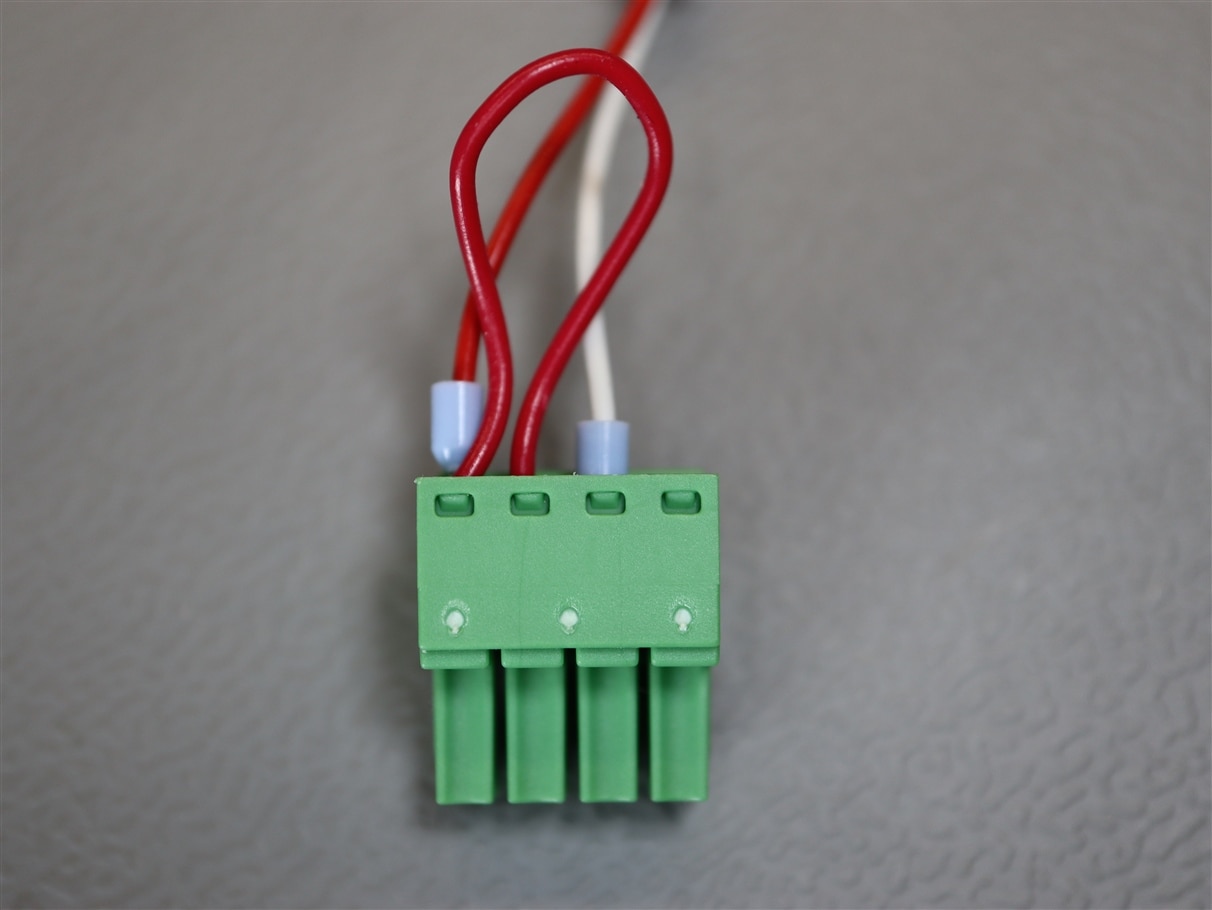

An example where the DAS screens provide better information surrounds the instruction to connect a two-wire PT100 to the four-port connector. The manual is incorrect, and the connector labels unclear. I found a picture in a PT100 submenu that explained things perfectly. Adding that picture to the manual would help.
{gallery}PT100 Connection
Manual's Description
Ports, there is no " |- " terminal as noted in the instructions.
Correct Image - this does help
PT100 Wired Correctly

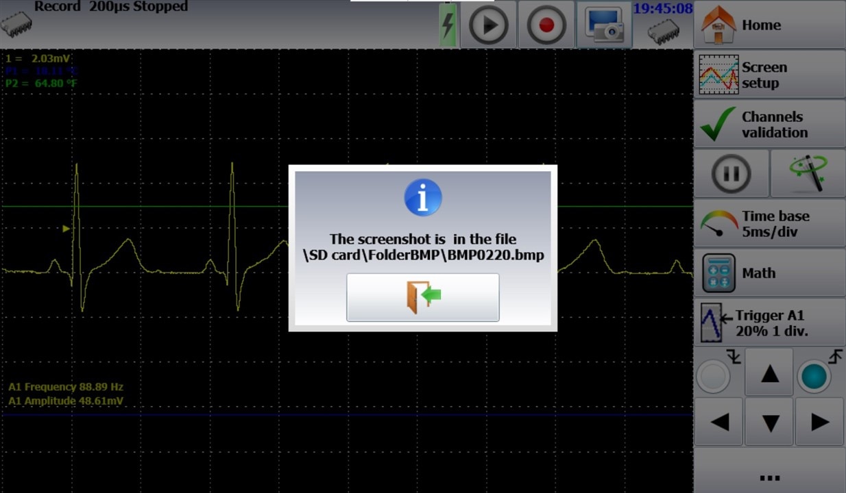

I also found the ability to take screenshots with one button press to be very convenient for capturing images, and to present graphical readings to augment recordings. I used this feature constantly during this review!

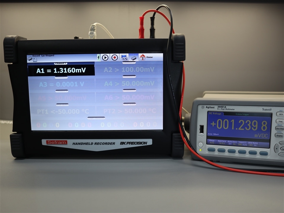

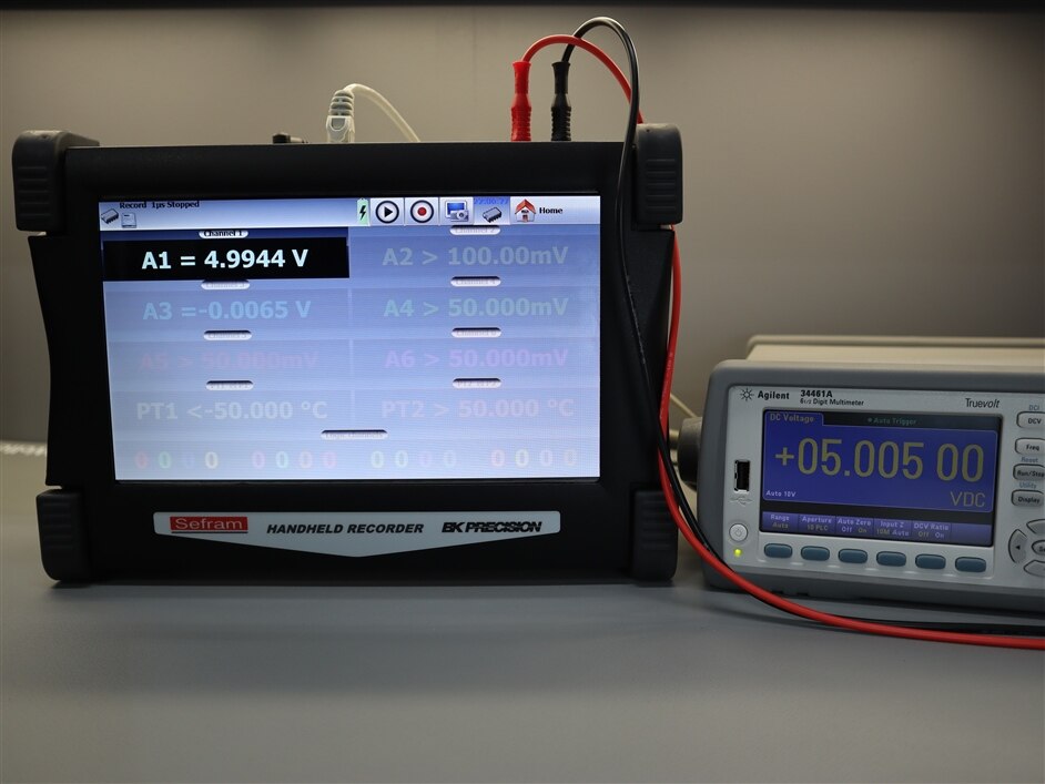

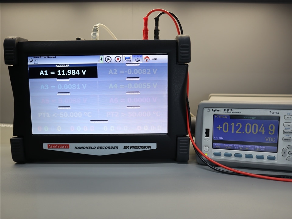

As compared to a 6.5-digit Keysight 34461A, the DAS60 has outstanding accuracy and well within calibration tolerances - with only small variations from the Keysight. Each channel is separately calibrated and the results align nicely with the calibration report.
{gallery}Accuracy
5V Comparison
1.2mV Comparison
12V Comparison

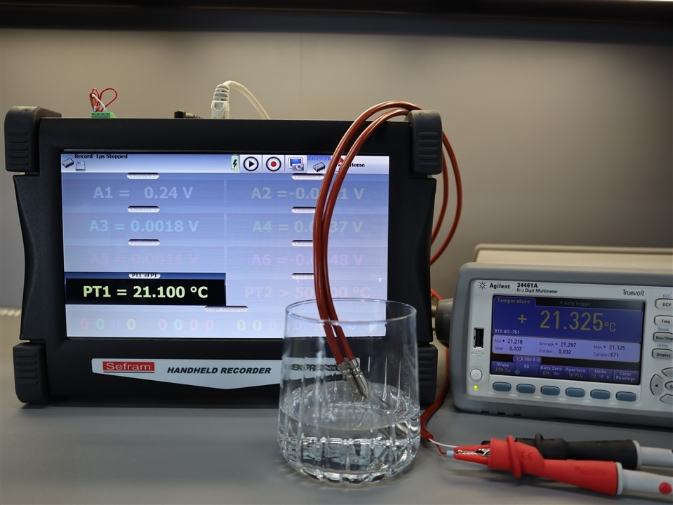

An additional two channels are dedicated for RTD, PT100 temperature measurement. If thermocouples are used on analog channels, the DAS60 is capable of recording eight temperatures simultaneously. When compared to a 6.5-digit Keysight 34461A, the PT100 measurements were consistently accurate, with a difference of up to -0.225°C from the Keysight once compensating for a slight probe variation of 0.1°C.

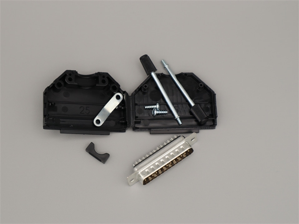

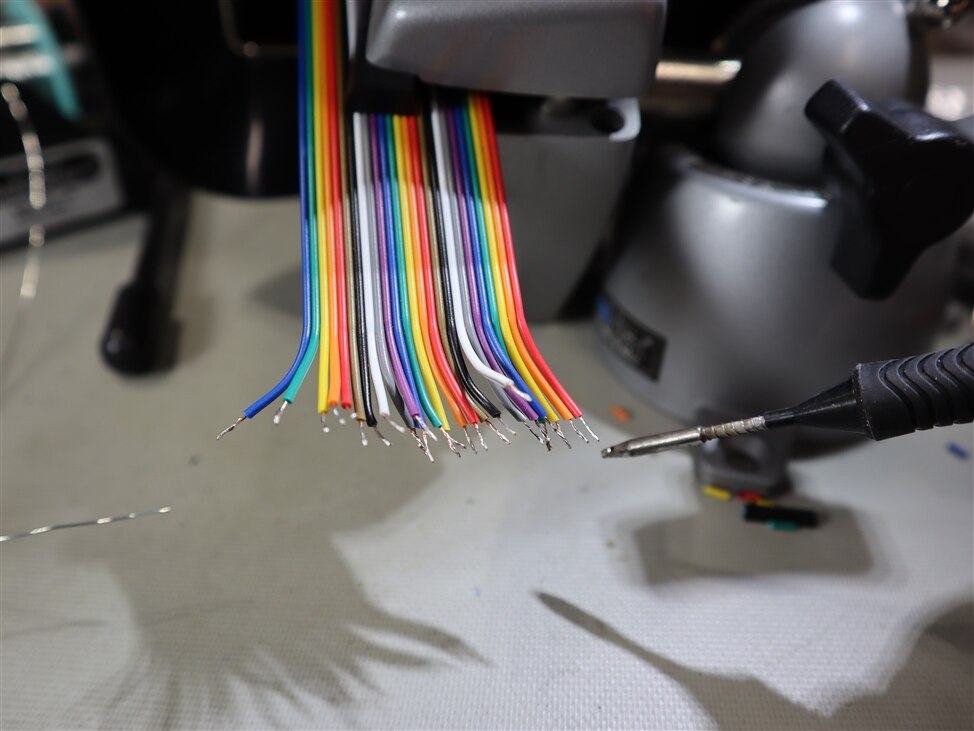

The B&K Precision DAS60 supplements the analog channels with 16 inputs for digital channels, 4 outputs for alarms, and one 12V output all on a single DB25 connector. As I didn't have a ready-to-go digital cable, I had to make one using the included DB25 connector.

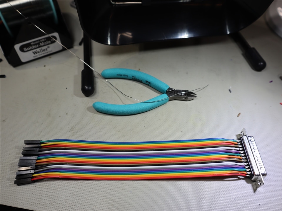

{gallery}Making a 16 Channel Cable
Tinning Wire Ends
Cable Complete

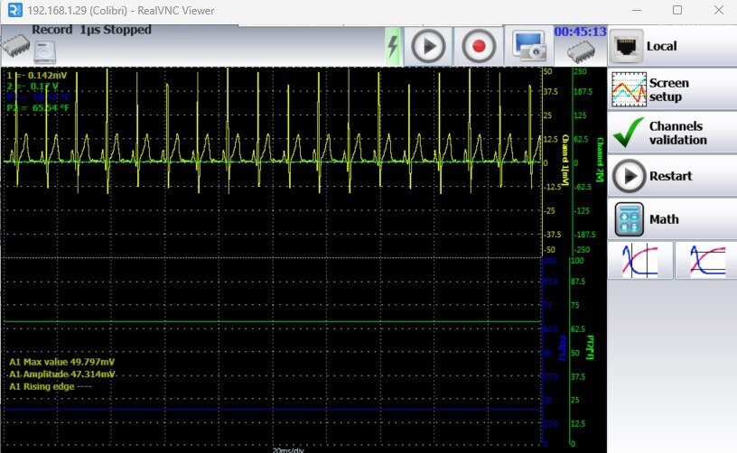

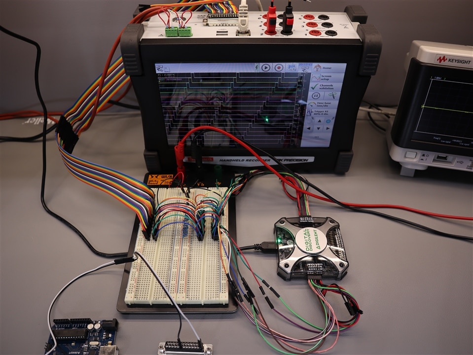

The DAS60 excels at recording for extended periods of time and manages 1-16 binary digital channels easily. However, Bus and Serial decoding is not available in the DAS nor in the Sefram viewer software, which limits analysis to binary only.
It is possible to export to CSV from the viewer software. With some external reformatting, another program may help analyze the binary capture with serial or bus decoders. For example, after significant manual effort, I was able to use sigrok to view the 16 binary channels as a bus and decode ASCII from that. I was not able to find a practical way to decode a serial stream aligned to correct timing. Perhaps with more effort, or advice from E14 members?
The instruction manual claims, on separate pages, that either 3.3V or >4V logic signals are required. So, which is it? Unfortunately, the latter is true, signals need to be over 4V to reliably record a logic high level. I would like to see the DAS60 support 3.3V directly. The below photo shows two digital signals captured by an oscilloscope but not by the DAS60's digital inputs.
I used both an Arduino Uno and Diligent Digital Discovery to provide digital signals for testing. The Arduino outputs 5V, the Diligent outputs 3.3V which would drop to 3.0 - 3.1V when connected to the DAS. The Arduino recorded no problem; however, the Diligent could not register on the DAS60 digital inputs directly. I resolved this by using 16 pull-up resistors, to bring the voltage over 4V.

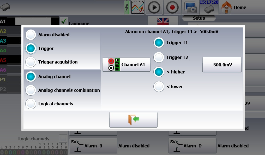

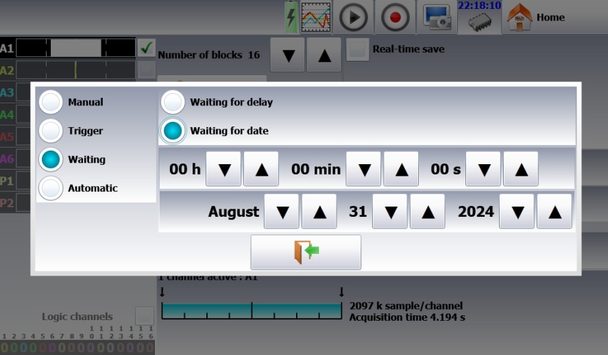

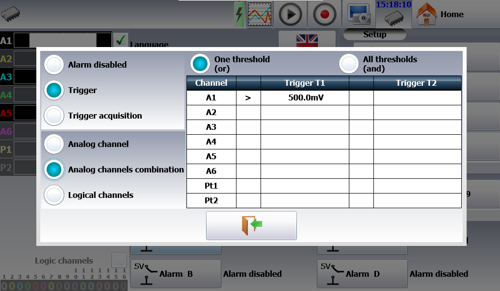

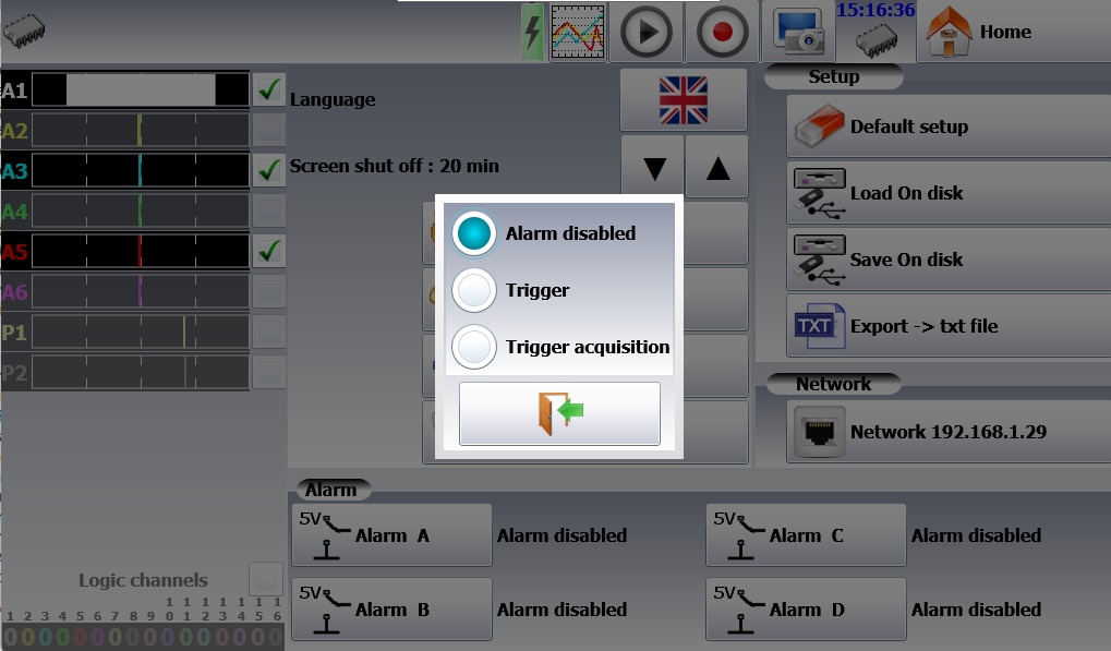

The four alarms are highly configurable, dropping from 5V to 0V when triggered by an analog channel/function threshold, complex combination of analog channels, digital channels, or when recording starts. Two triggers can be set for each analog channel or function, for example trigger on temperature below 32F or higher than 100F.
{gallery}Alarms and Outputs
Setting Alarms
Alarm on Channel 1 > 0.5V
Alarm on Combination of Events is Possible

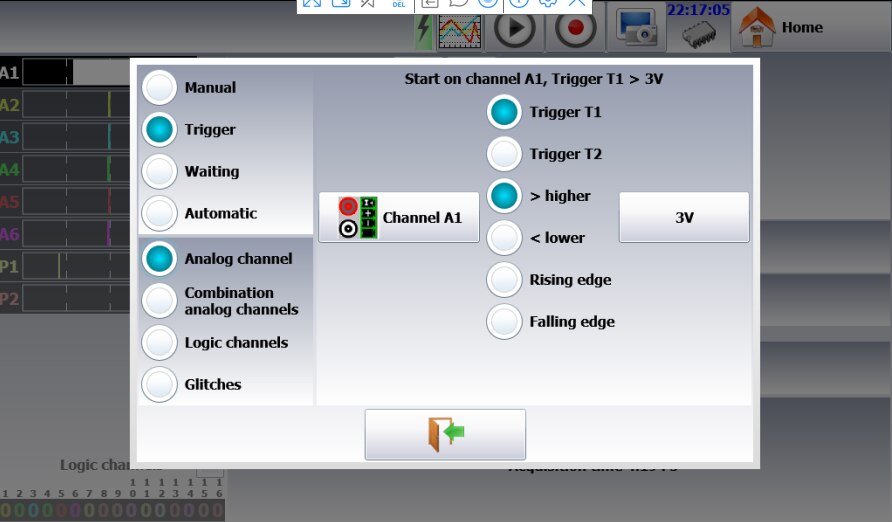

Triggers

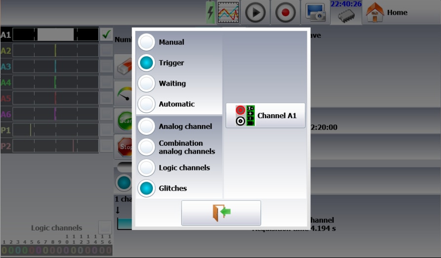

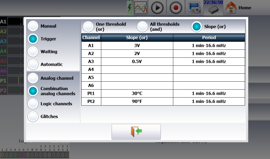

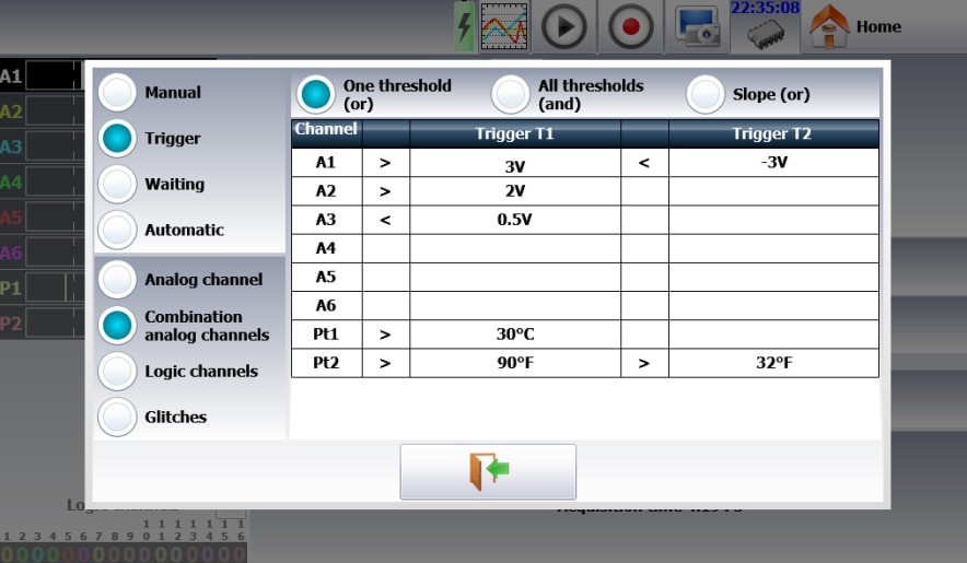

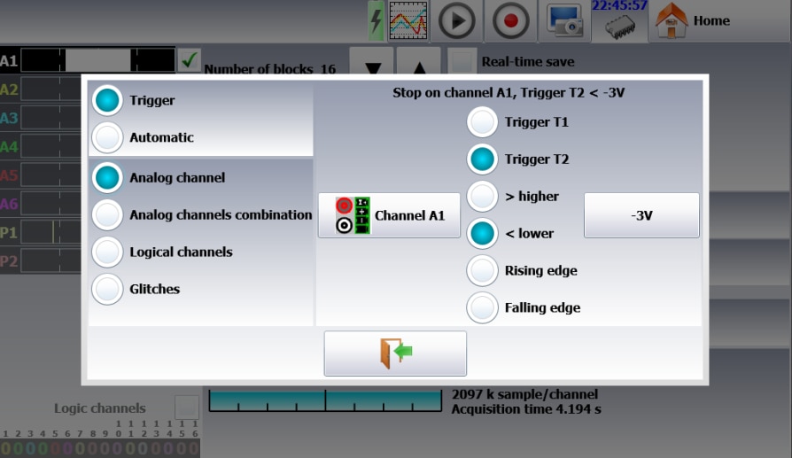

The triggers are customizable and very flexible, but can get complex. Two triggers can be set for a channel allowing for upper and lower ranges and can be set for start and stop conditions. There are options to:
  • delay by a period
  • schedule a trigger for a specific date and time
  • monitor for multiple thresholds
  • check for rising/falling edges
  • set a pre-trigger capture percentage
  • enable a complex combination of analog channel or function thresholds (functions include math calculations)
  • monitor for glitches - rapid changes in frequency or amplitude

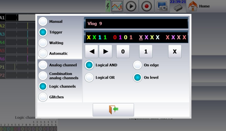

  • track the 16-logic channel state, with a logic AND or Logic OR function
Triggers enable powerful functionality within the DAS60. This allows the DAS60 to capture very specific events, combinations of events, or events on a schedule. It allows the DAS to conserve memory by starting with a key event and then go back to waiting when signals return to normal.
{gallery}Triggers
Combination Triggers
Combination Triggers 2
Logic Triggers
Trigger on Glitches
Trigger Mode
Trigger Waiting
Stop Trigger Options

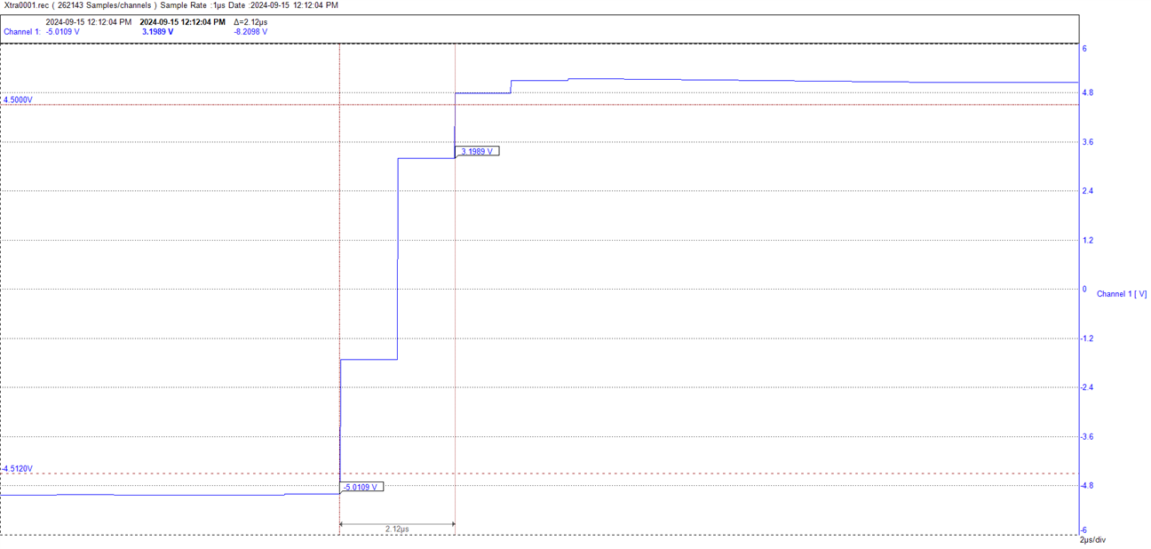

{gallery}Example Trigger on Glitch
Waveform with a Periodic Glitch
Successful Glitch Trigger and Stop
Measurement of Glitch Width
Measurement of Glitch Amplitude

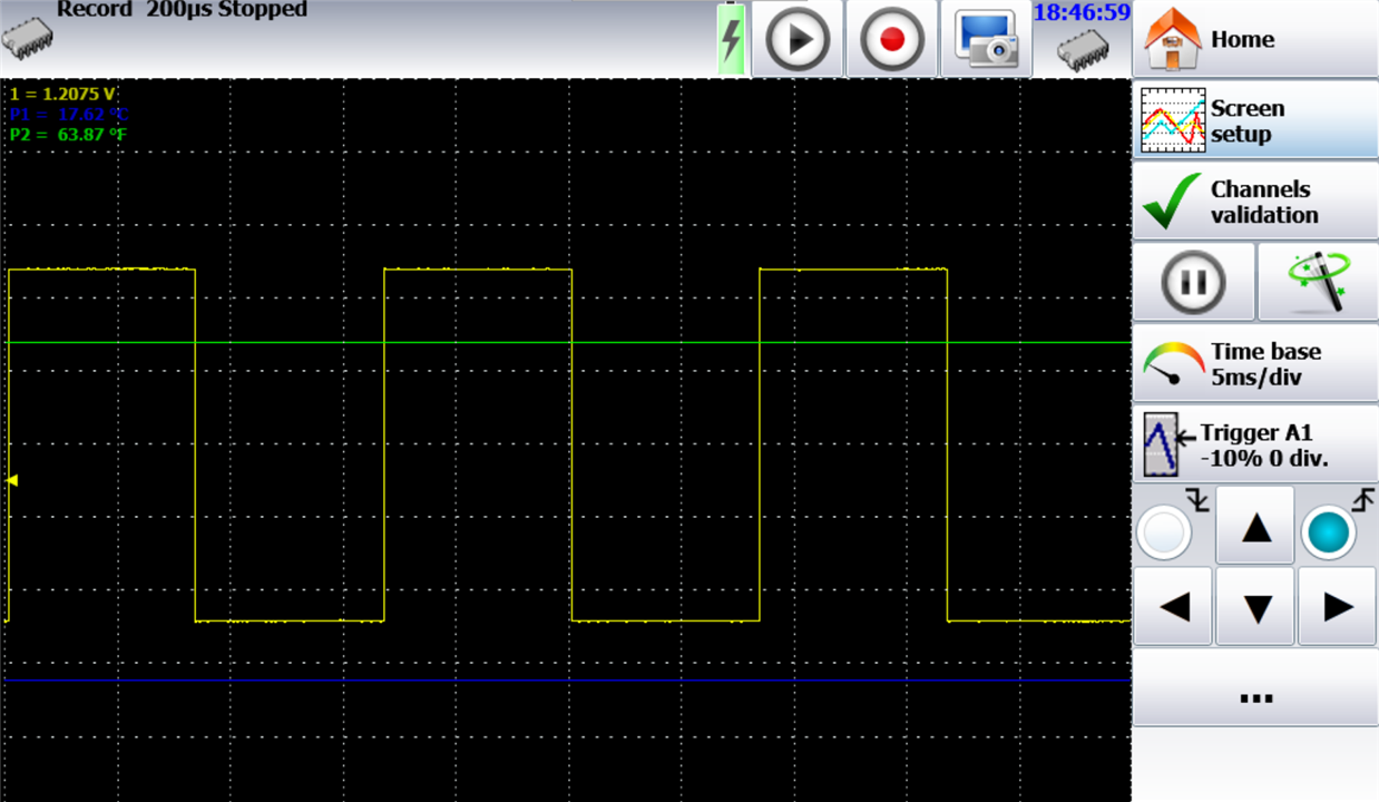

F(t)
F(t) is the DAS60 oscilloscope view and is available for all operating modes.

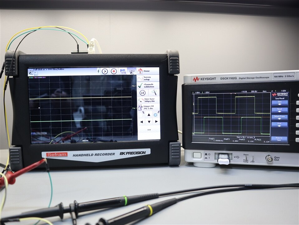

Compared to an oscilloscope, using the fastest sample rate of 1µS(1MHz) the B&K DAS60 can acquire up to an 195KHz signal before -3db amplitude error defines the maximum bandwidth. 30KHz is a more realistic maximum for the DAS60, however respectfully fast for a data acquisition system. At 30KHz, a minimal loss of 50mV occurs with a source 10Vp-p sine and is within the general rule that maximum bandwidth be at least 5x the waveform frequency. The following waveform shows the frequency where the 10Vp-p signal loses 3db and can only display as 7Vp-p.
The DAS60 does not claim to be a full functioned oscilloscope - and it is not. However, it does get close with a graphical F(t) display and several functions found in oscilloscopes. Settings are available for time base, channel range, offset, position and trigger point. It can even match a waveform against a template (see Go/No-go mode below). It is easy to get started with an initial measurement pressing autoset which does remarkably well at setting the channel configurations, time base and range.
Though it is not as full featured as an oscilloscope, it has a significant advantage over most oscilloscopes - this is a 6-channel device (24 channels if you count digital and PT100) and can record signals for extended periods!

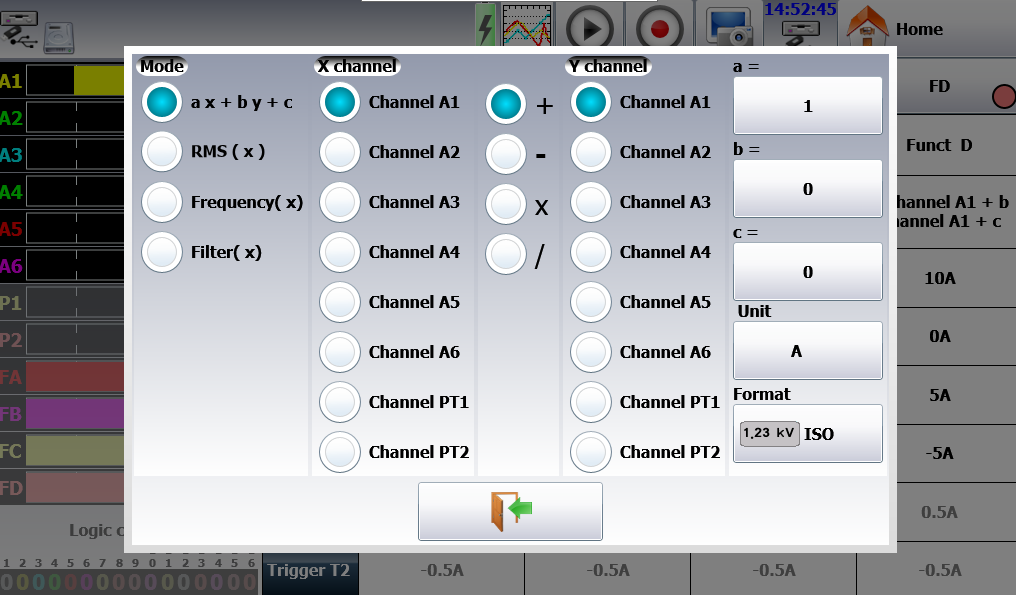

Function measurements and calculations are standard for oscilloscopes. On the DAS60, these are available but found in places that could be more intuitive - they are confusing and backwards from an oscilloscope perspective:
Measurements are curiously found in the Math menu which is on the display page. You can add measurements for min/max, low/high, peak-peak, amplitude, +/- overshoot, frequency, period, rising/falling edge, +/- pulse width, +/- duty cycle, mean, cycle mean, RMS and cycle RMS.
Math calculations are found in the function menu, along with some additional functions. This page is not on the display page, rather it is found on the home page (or the button may not be there, as the functions button is another example of one that disappears – make sure the functions are enabled first). From this page, you can select up to four formulas for ax+by+c or additional functions such as RMS, frequency or one of five filters (10Hz, 1Hz, 10s, 100s or 1000s).

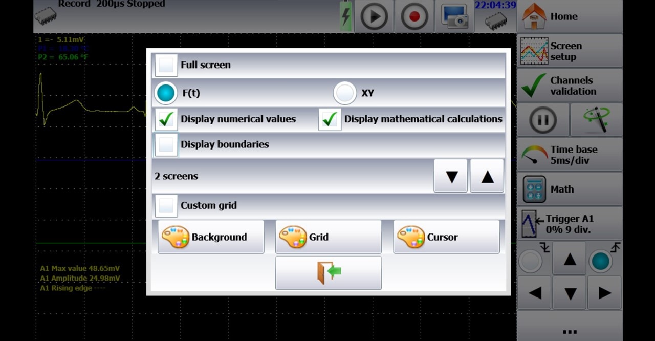

The Screen setup button is important to add calculations to the screen, create multiple screens or to add values to the display – all work together to enhance the screen’s legibility and information.

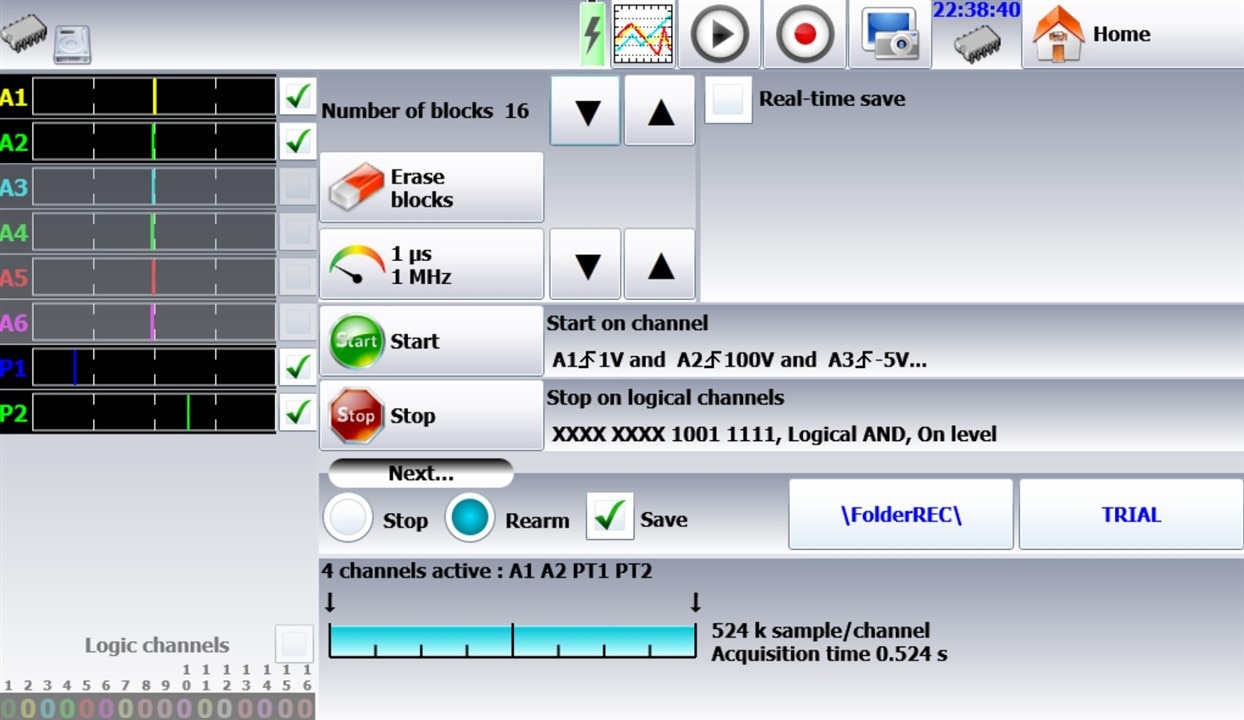

Memory and File mode work similarly to record the acquisition data. But they do have differences.
Both modes allow triggers for start and stop, as well as defining the next actions after a stop occurs (rearm, stop or save to file). There is a handy picture in the upper left corner that provides a quick reference of which mode you are in.
Memory mode is faster (up to 1MHz) and uses blocks of memory to record; the higher the number of blocks, the smaller each block is and quicker it fills up. On a stop condition, you can write the data to a file for later analysis.
File mode records directly to files and is limited by the disk transfer speed. Samples depend on the number of channels recorded but could be up to 500KHz for a single channel. It is easy to set the size of each file, and the display indicates in real time how long each recording will be. I would recommend limiting the size of each file to be under 1GB as transfer and viewing can be problematic at greater sizes.
That is the simple explanation. These modes are complex, and the instruction manual becomes important. Care must be taken to watch what triggers are set, which channels are active and what sample rate is selected – all have a bearing on the screen you are in, and other screens that you may need to go to.
{gallery}File and Memory Modes
File Mode
Memory Mode with Triggers and File Save

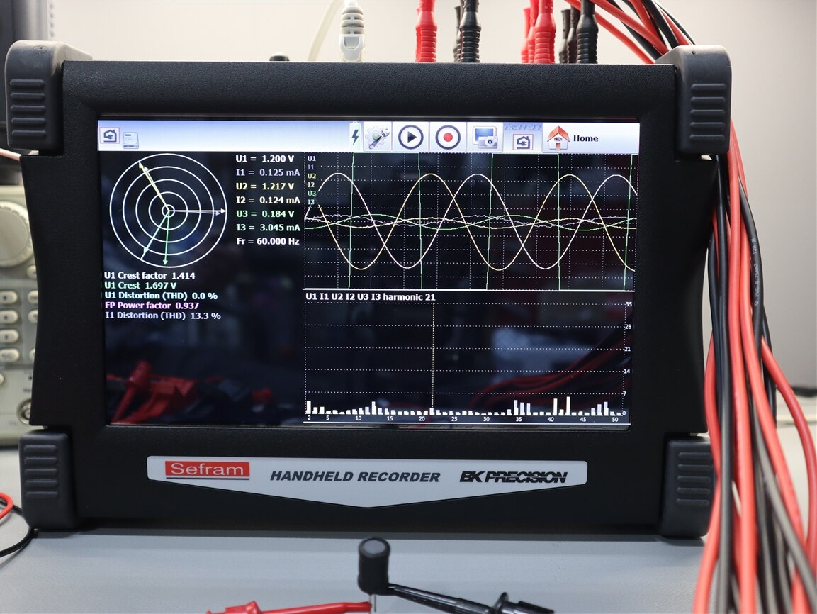

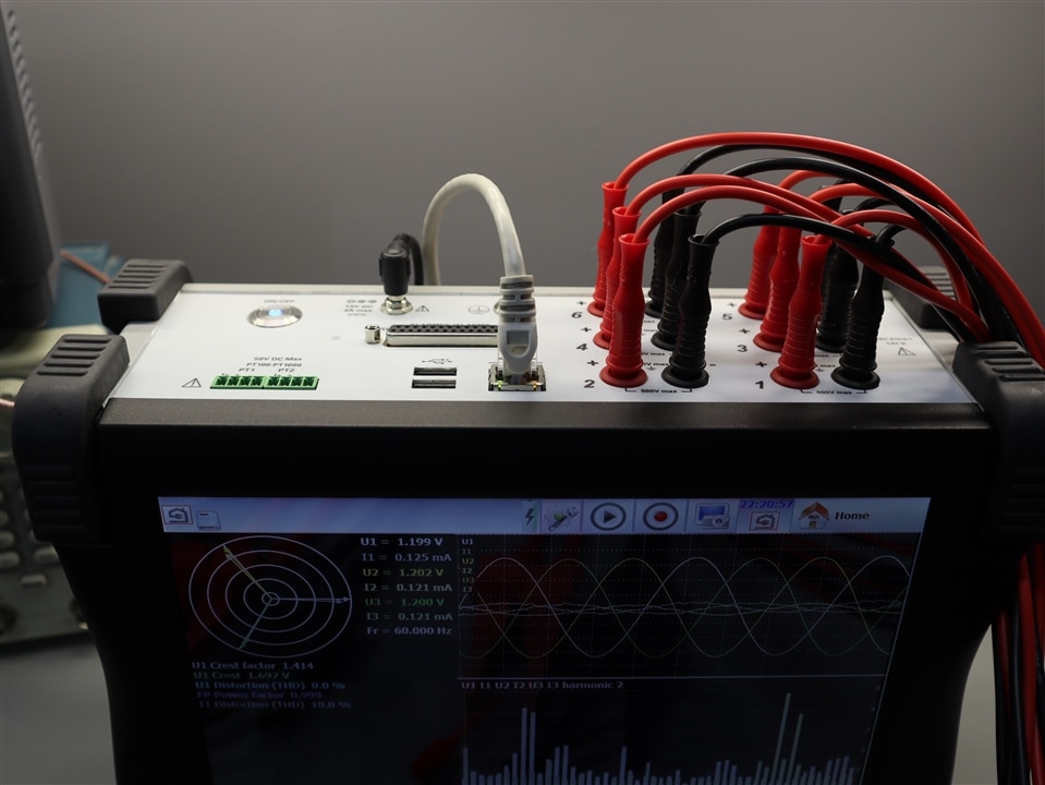

Power Analysis Mode

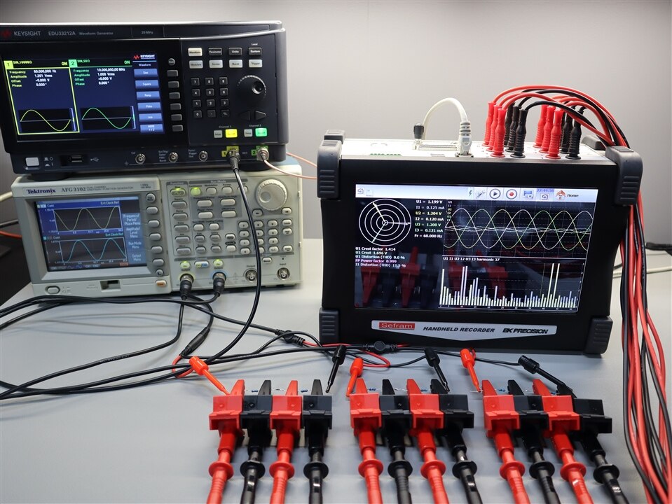

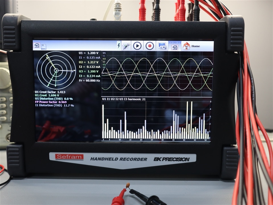

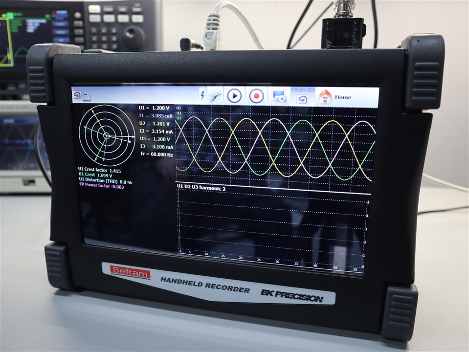

Power analysis mode is a flagship feature of the DAS60 and sets it apart from it's cousins. It enables a suite of functions and capabilities to monitor power quality and identify issues for single or three phase power at up to 424Vrms. With Category III capabilities, the DAS60 can measure voltage directly from a Mains panel.
This powerful mode adds significant value and flexibility to the DAS60. You can analyze a single-phase circuit, or three phase circuit using Star, Delta or Aaron configurations. A picture is displayed at the bottom to explain how to connect the equipment for each type of configuration.
The phase alignment between each input’s voltage and current can be analyzed on a Fresnel diagram with six vectors displaying the phase for each voltage and each current. This is not quite a phasor diagram though, the vectors do not change length to indicate amplitude - use the numeric readings for that.
Harmonic distortion is displayed on the Harmonic Display.
I am a former electrician from a career long ago. However, I have maintained my interest in electrical and electrical power quality. In a previous road test, I examined how oscilloscopes can analyze 120Vrms waveforms. For the DAS60 review, I spent much of my time in Power Analysis mode and the following four test cases highlight its capabilities.

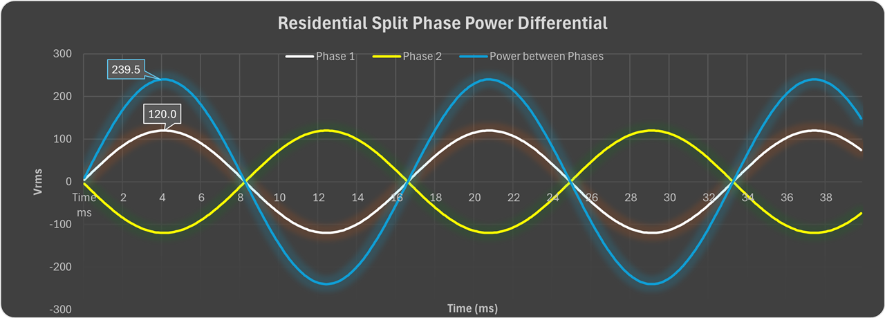

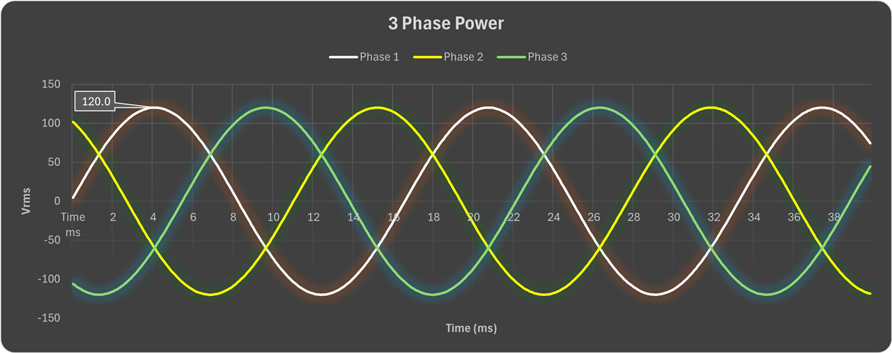

Residential Split Phase Power, as in my house, would look like the below in a zero-distortion environment with each phase 180 degrees apart.
And if you are combining the phases to get 240Vrms, the original phases and combined phase should look like this:

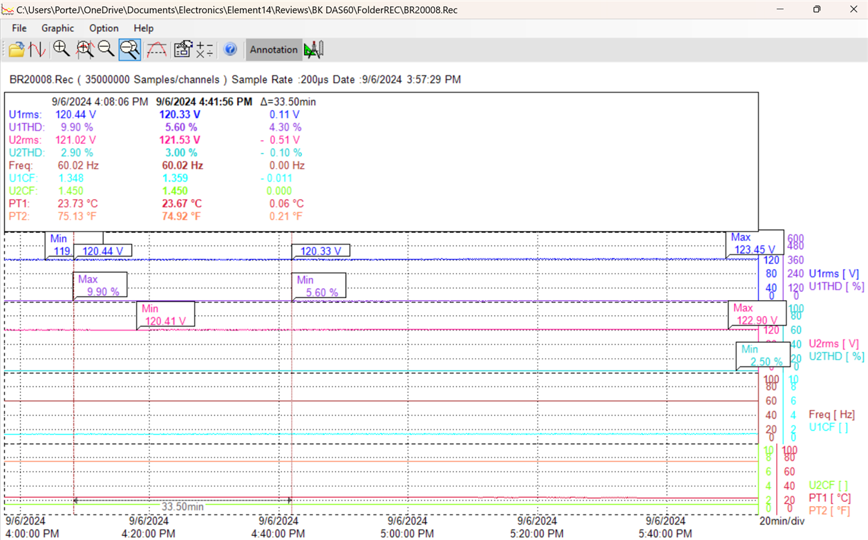

The actual split-phases in my house looks like the below picture, the purple waveform is a calculated value in the DAS60 as the difference between phase one and phase two.

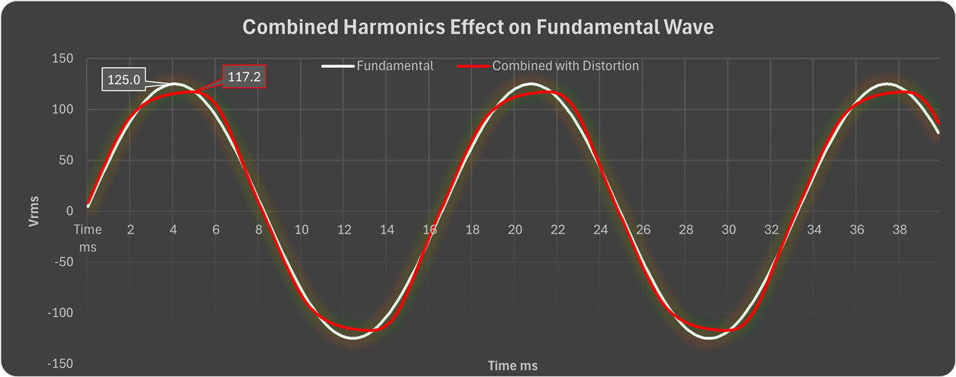

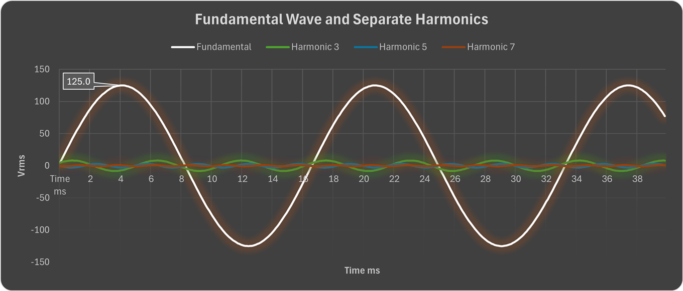

The waveforms are not as clean as the theoretical ones, and there is clearly some distortion in my home power, with significant levels on the 3rd and 5th harmonics. Distortion on odd harmonics is consistent with modern electronics, switching power supplies and florescent lights – devices which draw power in a non-linear fashion. The Total Harmonic Distortion (THD) for voltage should be under 5% to avoid issues, this circuit is getting close to 8%. Although 5% is an IEEE recommended upper value and not a firm limit, some information sources state 8%. The situation becomes clear on the DAS60 in measurements of the 247Vrms signal, the distortion has flattened the sine wave:
What is happening there?  The diagrams below explain the theory, the 3rd harmonic, 5th, and 7th all contribute to the foundational signal. The combination is a distorted wave.

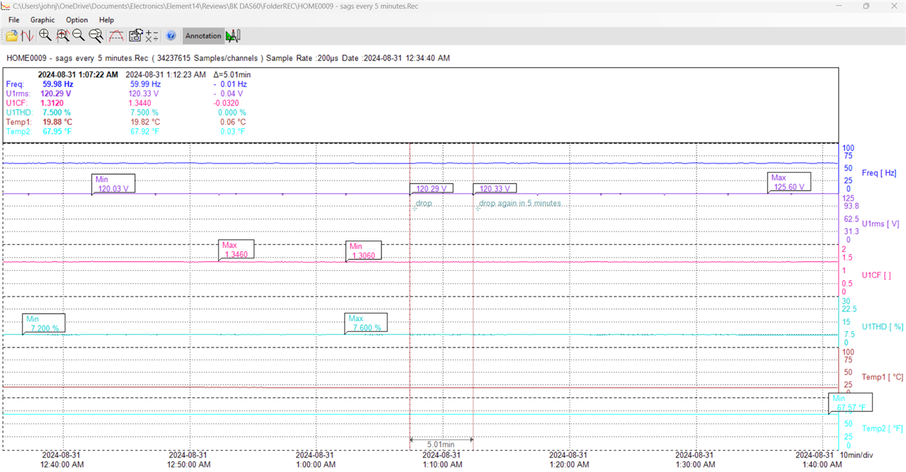

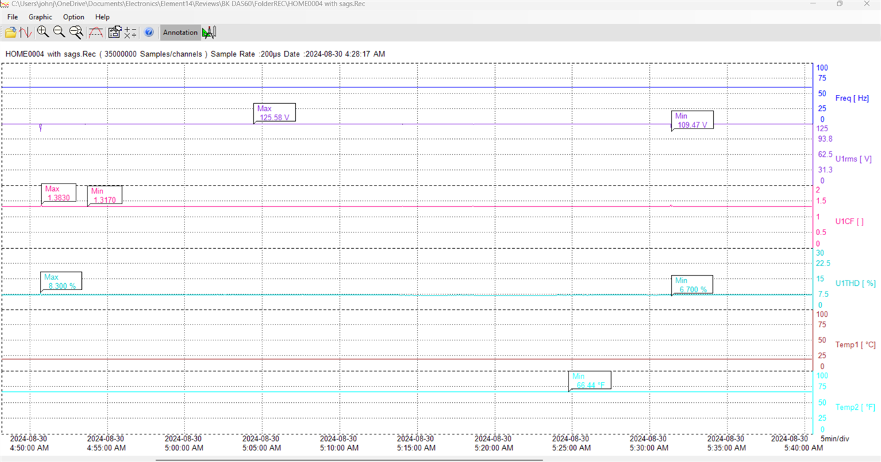

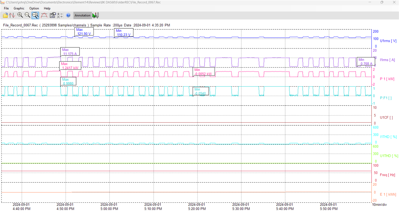

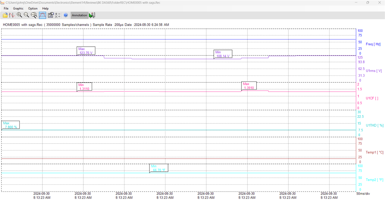

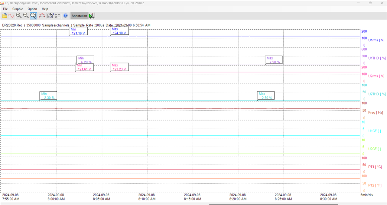

As a house power data logging test, I ran the DAS60 over several days. The recording was saved into two-hour blocks and there were some interesting results. Displayed in the Sefram viewer software, the below diagram shows two drops of over 15Vrms (U1rms violet) during this two-hour block, one at 4:51am and one at 5:32am. The crest factor (U1CF) peaks during both of these events but does not hit the ideal sine wave crest factor of 1.414/ Still, it indicates an improvement to the shape of the sine wave during the events. Total Harmonic Distortion (U1THD) exceeds 8% for one drop and has the lowest value of 6.7% during the 2nd. The event is captured, but the cause is still unknown.
image.
I noticed some sags during a storm event one night where the voltage (U1rms) dropped by 15V for less than one second, the Crest Factor (U1CF) improves, and Total Harmonic Distortion (U1THD) remains constant during the event.
And the next recording was odd, I noticed a voltage drop of about 5 volts every 5 minutes (U1rms) for an hour-long period overnight, I have no idea what caused this, but it is likely external to the house.  It has not reappeared so far.

I didn’t initially plan to do a test of 3 phase power; however I decided to try anyway and borrowed an extra waveform generator. Setting this up on the waveform generators was a tricky operation; I will post a separate blog to describe this and will provide a link here. Additionally, I used shunts to provide results for current, which opened a whole set of new measurements. The setup used nearly every cable that came with the DAS60 and looked like this:
In a no-distortion situation, 3-phase power should look like this diagram with each phase separated by 120 degrees.
In my test, the current for each channel is close to being in phase with the voltage (current is the shorter arrows), and supports a respectable power-factor of 99.9%. The THD for current (11.8%) is much higher than the voltage THD (0%) on channel 1. It would not be unusual to see current THD higher than voltage THD, however this is curious for a clean waveform and a linear load. I see in the Fresnel diagram a small amount of inductance on circuit 1 which would have some effect. I would like to try again if I manage to purchase current clamps for higher current measurements. Nevertheless, with waveform generators and a linear load, the voltage distortion is 0% and I was able to achieve near perfect voltage results (but at low voltage, 1.20V instead of 120V)
The DAS60 does not support numeric phase values, but the Fresnel does show if there is a significant issue or not. I used an oscilloscope to verify the voltage phase alignment.
Test Case 4 – Analysis of the effect of capacitance and inductance on a circuits phase alignment
I did not plan to run this analysis either but couldn’t resist!  In a reactive AC circuit, the voltage will not sit at the exact same phase as the current. In a capacitive circuit, the voltage should lag the current, and the opposite with an inductive circuit. The Fresnel chart on the DAS60 should be able to display this reaction.
Inductive circuit - observing green circuit 3 the voltage (longer vector) and current (shorter vector) are not in phase, the voltage is ahead of the current.
{gallery}Inductive Circuit - U3 (Green)
Test with Inductor
Closer view of the DAS60 analysis - The shorter green arrow (current) is behind the voltage
Capacitive circuit - this picture looks the same at first glance, but close inspection of the Fresnel diagram shows that current and voltage vectors have switched places, the voltage is now lagging the current.
{gallery}Capacitive Circuit - U3 (Green)
Test with Capacitor
Closer view of the DAS60 analysis - The shorter green arrow (current) is ahead of the voltage

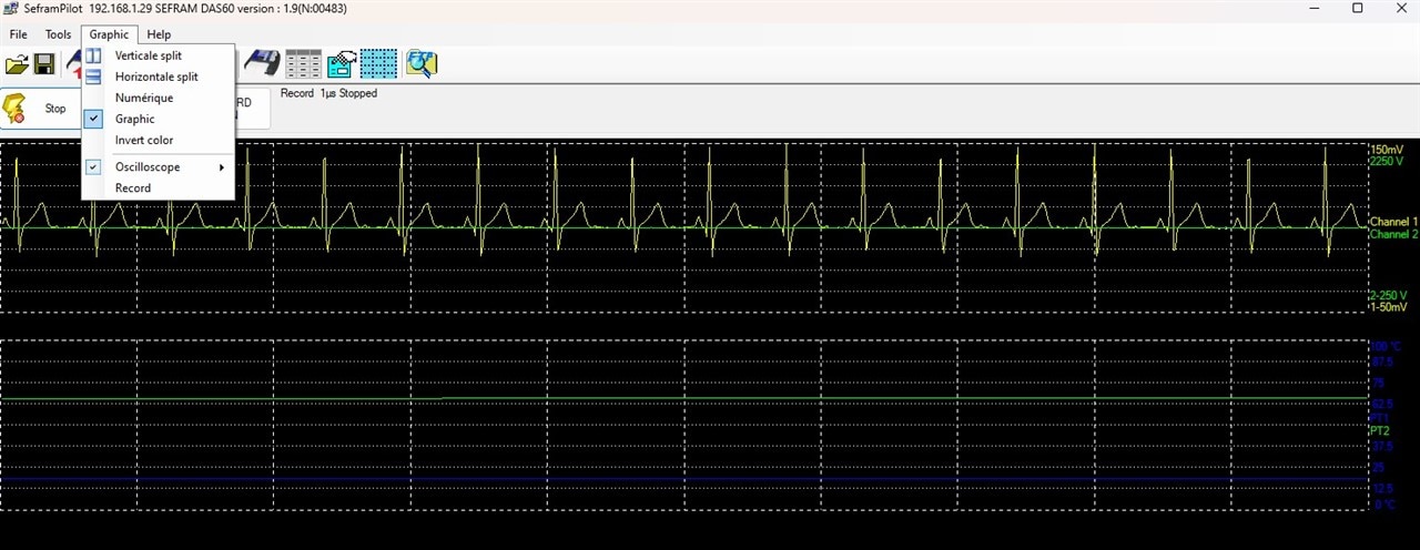

Sefram Pilot is the remote control application for the DAS60. The software controls most of the functions of the DAS60, displays a live view, can save your configuration and you can even start a recording from the software. However, it does not allow control of key features unique to the DAS60, Power Analysis and the Go/No-go modes.  As a result, I used VNC control much more often. Some of the menus have remnants of French language in them, even though English has been selected.
Sefram Pilot provides the ability to transfer files from the DAS60 to your computer over the network using the FTP protocol. While you can also FTP directly (as I did), Sefram Pilot enables this for you in the software as well.
While I liked this software, it is in desperate need of updating to include DAS60 specific functions and could use some polish.

  • High quality cables and connectors, and many of them. The bare wire banana adapters are unique and hold wires in place tightly
