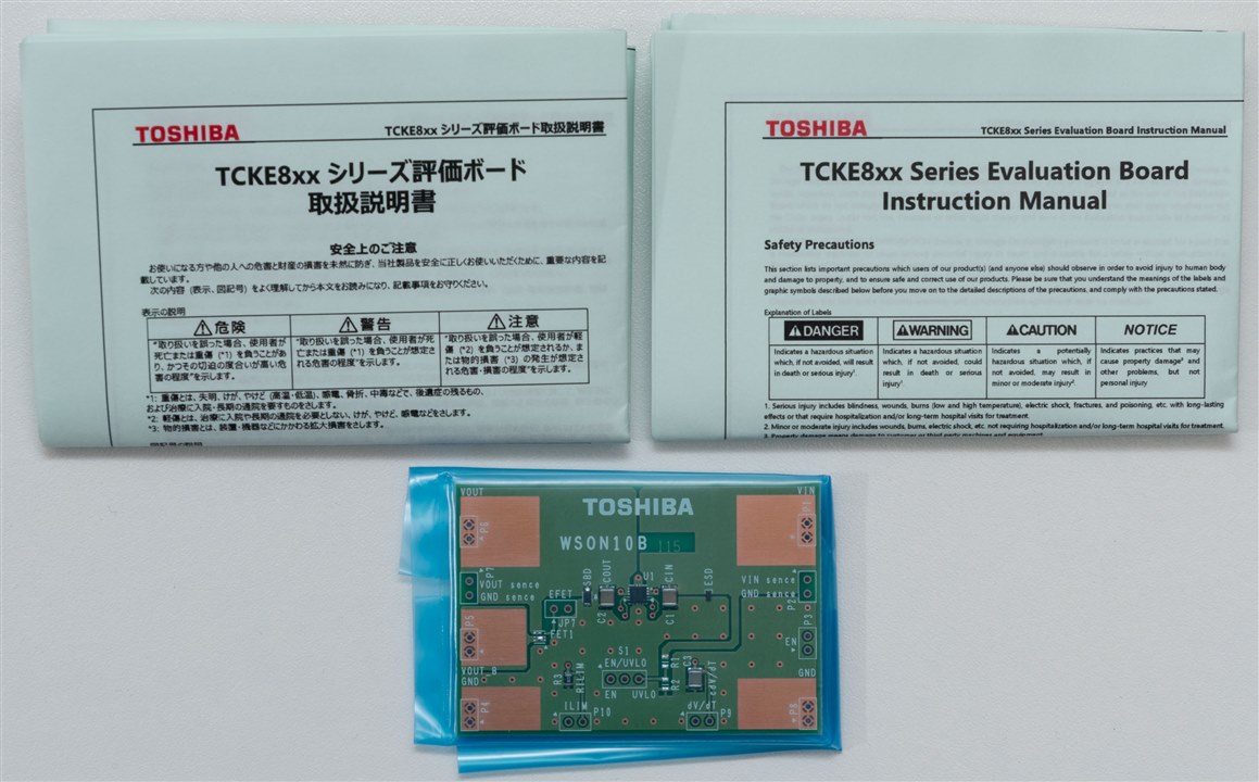

The board arrived in a white thin-card box. It would seem from the labels that the board has probably been in stock for around a year before this RoadTest. It is apparently Assembleed [sic] in Japan.
Inside, the item is ensconced in large pink static-dissipative bubble-wrap.
The inclusions are the evaluation board inside a blue static-dissipative bag, a printed Japanese manual and a printed English manual. This is printed on a large piece of paper, consisting of 10 pages of documentation. The size of the paper makes it a little difficult to navigate, but the small print could be a bit difficult for some to read. Unfortunately, there are no terminals or header-pins included in the package.

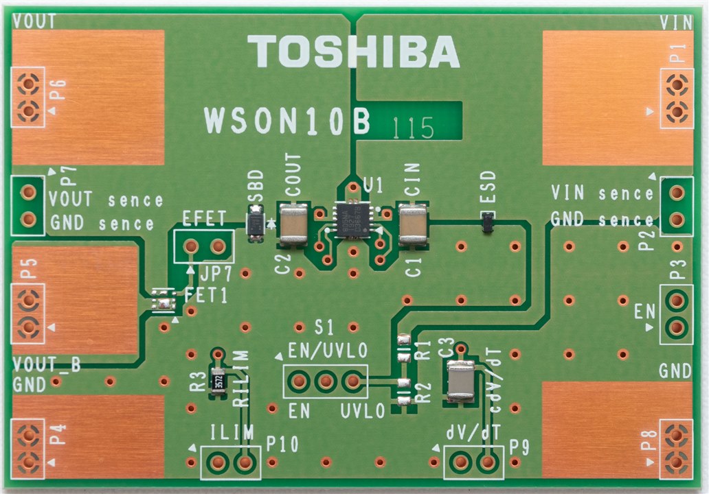

The board appears designed in a “Japanese way”, with the input on the right and output on the left. This is the opposite of convention in many western countries, which go left to right. That being said, there is also a misspelling of the word “sense” as “sence” in the silkscreen. The board is designed as a rectangular 66 x 46mm two(?)-layer board of unspecified copper weight. The board design itself doesn’t appear to be available.

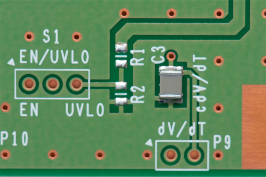

Design features include exposed copper areas for attachment of wires. This is a good idea as it allows for better testing with high current sources. However, the use of terminal blocks may be preferable for convenience. These connections appear doubled-up using thermal-relief vias for connection to 2.54mm header pins (not included). Provision of sense connections improves measurement accuracy, which is a nice addition for those willing to go the extra-mile with a four-wire connection to accurately characterise the chips’ losses.
However, the design is a little strange. The EFET and EN/UVLO jumpers need to be connected with jumper shunts (not included) to allow the EFET gate signal to pass through, or for the EN signal to be sourced from the EN terminals or the voltage divider for the UVLO feature, which isn’t actually populated on the board. The other header connections are actually paired (i.e. connected together), which seems strange especially for ILIM and dV/dT as they don’t allow for overriding the existing mounted values, instead, at best we can just parallel another resistor or capacitor. So it seems surface-mount soldering is a necessity for using this evaluation board fully. Had they designed it such that multiple common values can be jumpered in or out, or the actual connections for the resistor or capacitor were broken out on both sides such that an external value can easily be wired-in, that would simplify evaluation.
The eFuse IC itself is pretty small, especially considering the chosen bypass capacitors. The board has the necessary ESD protection and output-side reverse polarity protection components installed as well.

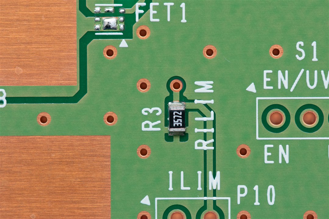

The current limit programming resistor, as provided, is a 35.7kΩ resistor corresponding to a current limit of about 2.98A.
Meanwhile, the provided soft-start inrush-limiting capacitor is 120pF, which is expected to provide a speedy ramp-up. It is unusual they should choose a capacitor with such a large footprint for this value, especially when it doesn’t have to handle the full supply voltage (the datasheet implies 3V is all that is applied).

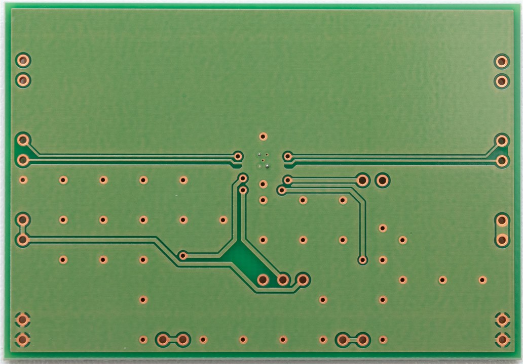

The underside does not have any componentry, although the exposed paddle vias do show some evidence of solder flow-through.
Further documentation is also available through the RoadTest page and also on their website. The documentation is acceptable, although there are places where remnant Japanese exists in the English documentation and occasionally, sentences can be a little difficult to understand.

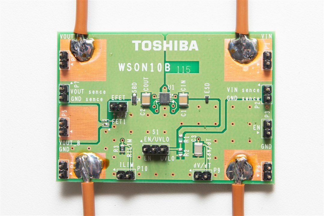

To prepare the board for testing, it was important to attach some header pins to the board for attachment of measurement test leads and to attach wires for the main power input and output. For a more challenging test, I opted to use thick 2.5mm² cables and a high-current power supply (50A) to ensure that any overshoot (if any) would be observable.
After preparation, the board looked as above.

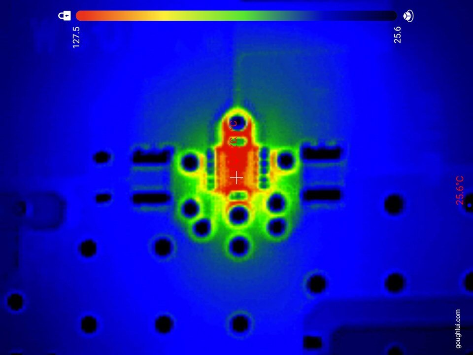

Thermals
As previously mentioned, the process of tripping, current limiting and voltage clamping are all processes which are thermally-related. In the case of tripping, it occurs through current limiting first, creating heat which brings the package up to thermal shutdown. Similarly, clamping occurs in a dissipative fashion, similar to a linear voltage regulator, which also creates heat – enough of which can lead to thermal shutdown.
As a result, it should not be a surprise that, in a tripped state, the chip is hot. The maximum temperature recorded by the Topdon TS001 Thermal Camera was a toasty 127.5 degrees C. While this won’t immediately be harmful to the chip, prolonged operation at such temperatures will shorten the lifetime of the eFuse. This is why I believe the eFuse should not necessarily be relied upon as a form of primary (or sole) protection unless the design can assure that the eFuse isn’t stressed continuously to the point it could fail.

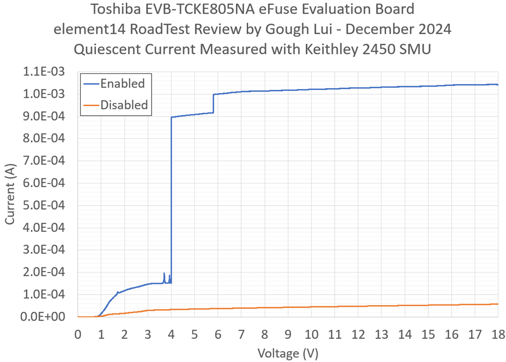

Power Consumption
While it may often be considered that fuses don’t “consume” power, traditional fuses do waste power through their resistance. Conversely, eFuses can waste power through their Ron, but this is not usually any greater than traditional fuses.
However, eFuses also have power consumption required to power the internal comparator circuitry. As a result, I measured the power consumption of the TCKE805NA Evaluation Board using a Keithley 2450 SMU in both the enabled and disabled state.
At the intended 5V operational voltage, the consumption is about 910µA when enabled and 38µA when disabled. The datasheet values claim 460µA and 33µA respectively, which is a significant discrepancy for enabled state and similar values for the disabled state. The discrepancy is likely down to differences in test condition and implementation – a lower Rilim value than datasheet and higher Ven (tied to Vcc) than datasheet. Nevertheless, this consumption is something to keep in mind, especially for battery-operated and power-constrained equipment.

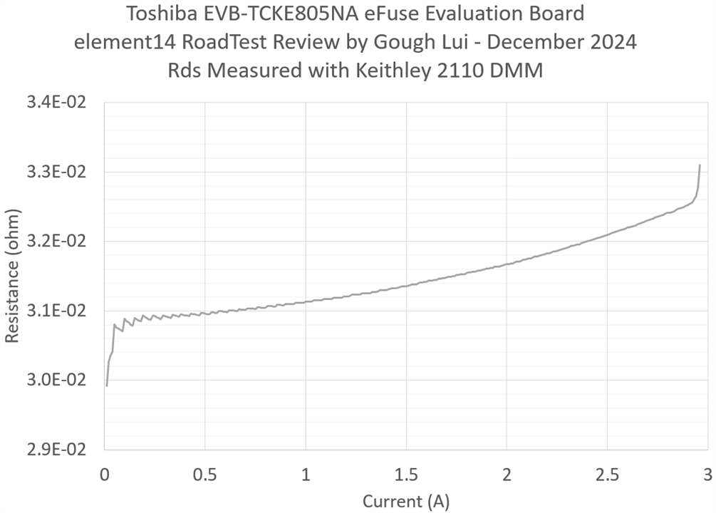

Ron (Rds-on) Losses
As mentioned in the last section, power is also lost as it traverses through the eFuse due to the “Ron” or more traditionally, the Rds-on of the embedded MOSFET. This is claimed to be in the order of 28mΩ typical, up to 38mΩ through the whole temperature range as stated in the datasheet. To measure this, a current was flowed through the eFuse from an Aim-TTi QPX750SP power supply into a B&K Precision Model 8600 DC electronic load. The voltage across the input-to-output connections was measured over the sense connections using a Keithley 2110 5.5-digit digital multimeter for maximum accuracy.
According to my results, the Ron was about 30-31mΩ, increasing to 32.5-33mΩ as it warmed up at higher currents. This is within the expected range, but a little higher than typical. This would not be unusual, as this can vary from device-to-device.

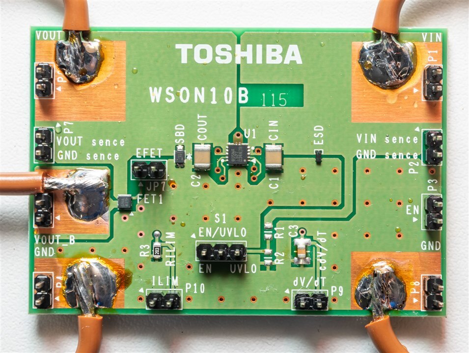

To be able to assess some of the capabilities, the board would have to be modified. For this section, I aimed to perform three modifications – the first was to increase the trip current to approximately 5A. The second was to slow-down the soft start by replacing its capacitor with a much larger 100nF capacitor. Finally, I wanted to test the reverse-current blocking capability with an external FET.

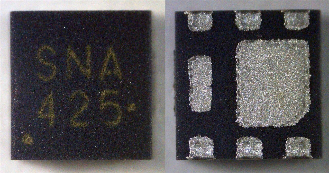

Unfortunately, while the board is designed for use with a Toshiba SSM6K513NU (30V, 15A, 8mΩ) as an external FET for this application, the FET is not provided nor mounted. Thankfully, element14 have this part in their catalogue (4415937), so I ordered five (to meet MOQ). They were about AU$1.13 including GST each, which is a reasonable price for the specification.
It should be noted that the board warranty (Article 4) apparently only covers leaded component mounting, thus this part of the review involving surface mount component mounting would void the warranty. While I can understand why the warranty is written this way, I feel that the board would have been better designed if such components were provided, but were switchable, to avoid the need for users to have to perform surface-mount soldering (which may pose significant difficulty to some) to evaluate the reverse current blocking capability.
The MOSFET is packaged in a UDFN6B package, measuring 2 x 2 x 0.75mm. The footprint is pre-tinned from the factory, which makes soldering a little easier. I chose to use flux and heat-gun from the bottom to avoid blowing the component away and to avoid damaging the header pins I already installed. An additional lead also needed to be installed for the output with the FET in series.
All three modifications were successful and the board appears as above.
Changing the capacitor had an obvious effect, now lengthening the start time to a rise time of 167ms for a gentle and linear ramp, whereas before, it was so quick that it was in the 30-40µs range.
The second desired result was also achieved, with the trip current now at about 4.9A. The behaviour of the circuit has changed slightly, with the trip only being released as the DC load current drops to about 1.1A.
