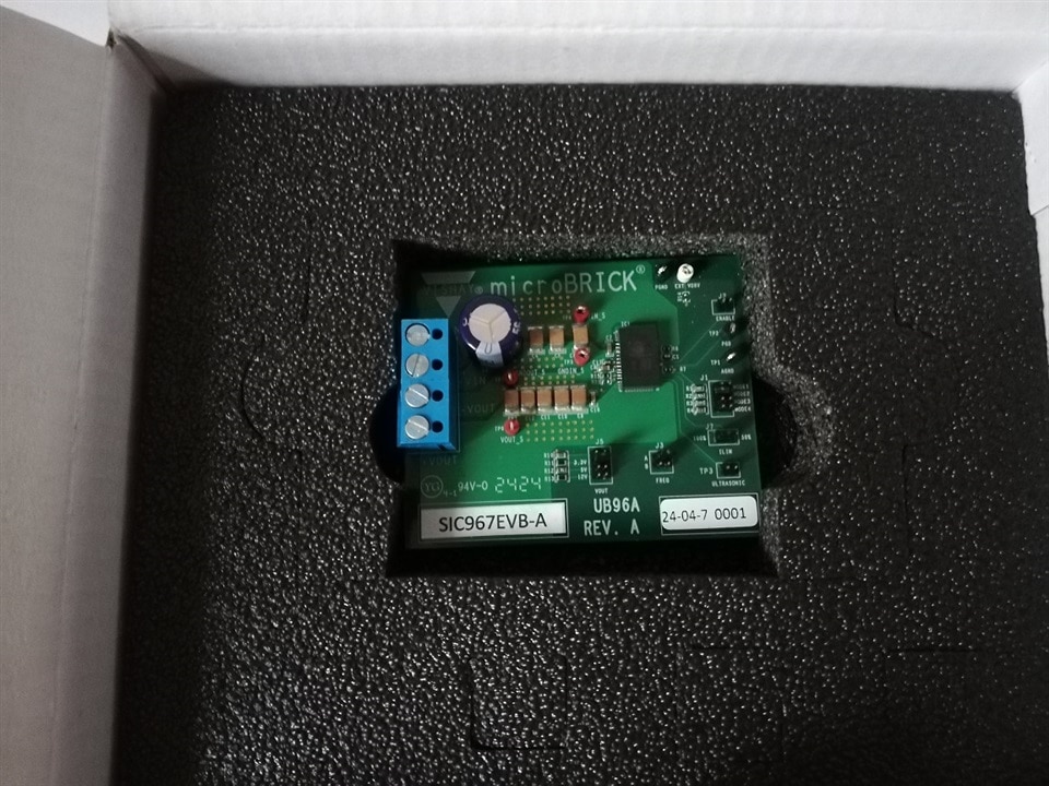

Unboxing
Evaluation kit has arrived (somewhat illegally by the way - it was released in error from customs office before clearance, so it is under some sort of correction procedure currently and it's legal status is unclear - thus unexpected delay in the roadtest) in an elegant cardboard box, filled in some sort of hard foam filling with a cut-out for the module.
{gallery}Module unboxing
External view
The box
The filling
Foam filling

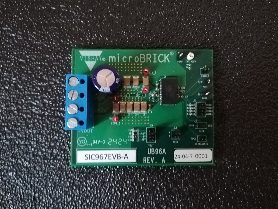

top side
Top side view

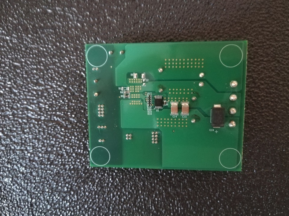

Bottom side view
Bottom side view

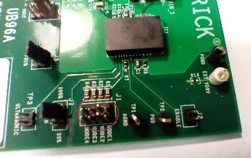

Input and output of the module is terminated using screwed terminals allowing for firm connector placement, which is an important feature, especially when high currents are expected. Evaluation board has several test points prepared and  a configuration of converter parameters is possible using jumpers.
This fact leads us to the first observation - jumpers are of less common type, with 1.27" pitch  and lower than expected endurance. On the photo below, result of this feature is documented - probably during the transport, PCB entered between layers of foam filling and one jumper slightly bent contacts it was placed over.  So - some care should be exercised when operating jumpers.
bent jumpers
There are also no spare jumpers included (that is less important when standard jumpers are used, but not everyone has spare 1.27" jumpers available) and some configuration options (for example: 12 V output with 1 MHz clock) would need at least one additional jumper above the set included with the board.

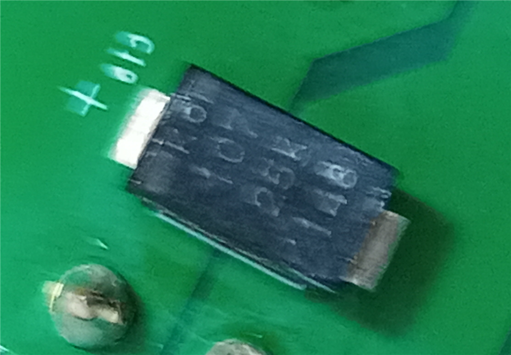

After closer inspection the cause was identified as different than documented value of R5 resistor (10 kΩ instead of expected 2 kΩ), which led to lowering of enable voltage to about 7.5 V and undervoltage protection level to 6.4 V.
Then, additional differences were visually identified (side note - some components are installed with markings visible [and those are probably considered as of interest to the user and meant to be field replaceable if necessary] and others are placed with marked side down; only components with visible markings were checked).
changes vs documentation
Those differences (marked with red ovals on the schematics) are summarized below.
  • C3 capacitor: 56 μF was installed instead of 120 μF from the datasheet,
  • R5 resistor: 10 kΩ instead of 2 kΩ,
    R5
  • R10 resistor: 43 kΩ instead of "not populated",
    R10
  • C19 capacitor: 100 μF instead of "not populated",
    C19
Three last changes are particularly interesting. Change of R5 and R10 resistors was probably caused by a desire to prevent user errors - as original board was supposed to be run from at least 32 V and there was option to select "unregulated" output voltage (J1 position 1-2, connected originally to a "not installed" voltage divider resistor R10), there was an easy way to destroy 25 V rated output capacitors.

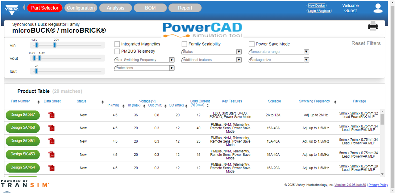

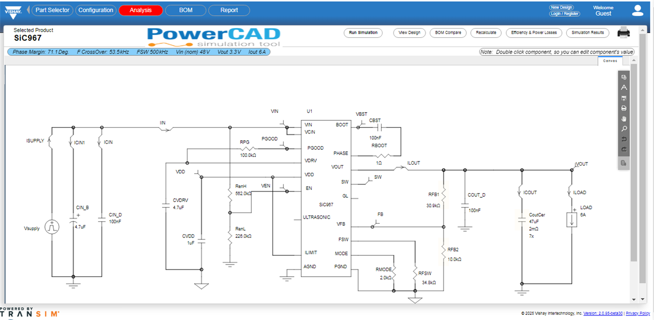

And here enters converter design software provided by the manufacturer. It is called PowerCAD and is advertised as more advanced than the competitor's oferring. Typical session (after accepting a legal disclaimer), starts with selecting a regulator from either microBUCK or microBRICK family. Regulator can be selected by the part number or using some selection criteria
chip selection
then, design parameters can be selected
parameters
with some more advanced options (like startup voltage and output capacitor types and composition) hidden by default
advanced parameters
For our microBRICK converter, switching frequency can be only selected from the predefined list of:

Next step generates a schematics (like below)
48V to 3.3V

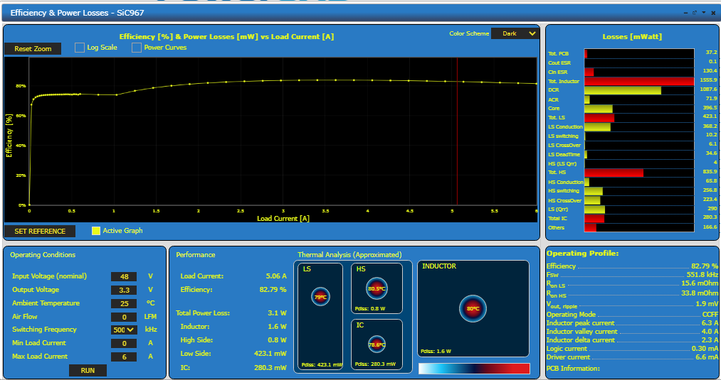

Additional options are available after creating an account - after that we can run simulations
circuit simulation
and calculate expected efficiency, power losses and thermal characteristics (which is advertised as unique to this software)
