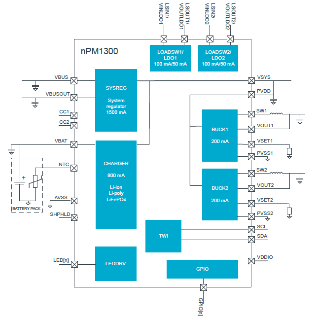

Nordic Semiconductors nPM1300 PMIC (which is a member of family of PMICs compatible with the models generated) is an power management IC designed for nRF52, nRF53, nRF54 and nRF91 system-on-chip (and System In Package in the latter case) - this is important information, because fuel gauging algorithm is implemented as a library running on the host system and provided as a compiled binary.
Introduction to the nPM1300
nPM1300 is a power management IC supporting single-cell Li-ion, Li-poly or LiFePO4 battery with charge current up to 800 mA, 1350 mA unregulated output (when running from the battery) and up to 500 mA of adjustable, regulated output in the form of two 200 mA buck regulators and two 50 mA LDOs (which can be reconfigured as 100 mA load switches).
It also contains:
  • a system-level watchdog,
  • power-loss warning signal generating circuit,
  • Ship and Hibernate low power modes implementation,
  • up to 5 GPIOs and 3 LED drivers,
  • System Monitor (allowing for measuring: input voltage, battery voltage, battery current and temperatures of battery and a chip),
  • Fuel Gauge hardware interface usable when connected to the compatible SOC/SIP,
and has a block diagram as below:

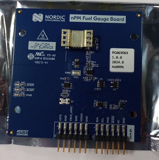

nPM Fuel Gauge board
nPM Fuel Gauge is an daughterboard for nPM1300 evaluation kit, allowing for creating of new battery profiles, with the block diagram as below:
fuel gauge block diagram
As can be seen, it is essentially configurable current sink allowing for discharging a cell in the controlled manner, allowing for measuring it's parameters in all points of the discharge curve.

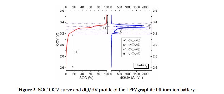

To further underline this relationship, below are presented some of dQ/dV curves from "A Generalized SOC-OCV Model for Lithium-Ion Batteries and the SOC Estimation for LNMCO Battery", where long horizontal peaks on the right side of plots indicate voltage ranges where large charge differences are resulting in only small voltage changes.
{gallery}dQ/dV plots
LNMCO battery
LNMCO battery plot
LMO battery plot
LMO battery plot
LFP battery plot
LFP battery plot
As can be seen, especially in the case of LFP/LiFePO4 batteries, OVC voltage can be misleading when estimating battery charge, particularly when temperature variations are present.

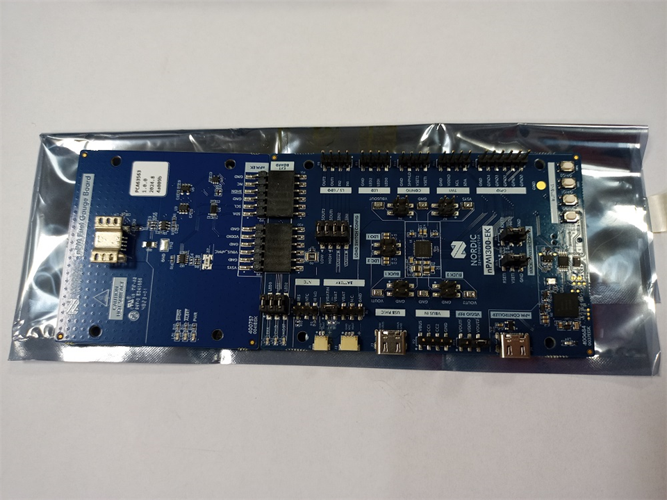

Both modules have arrived (after longer than usual stop at customs office) in small, cardboard boxes, containing boards packaged in ESD protection bags. So - no bundled software, no printed documentation, no (usually redundant) cables, only strictly necessary items.
packaging

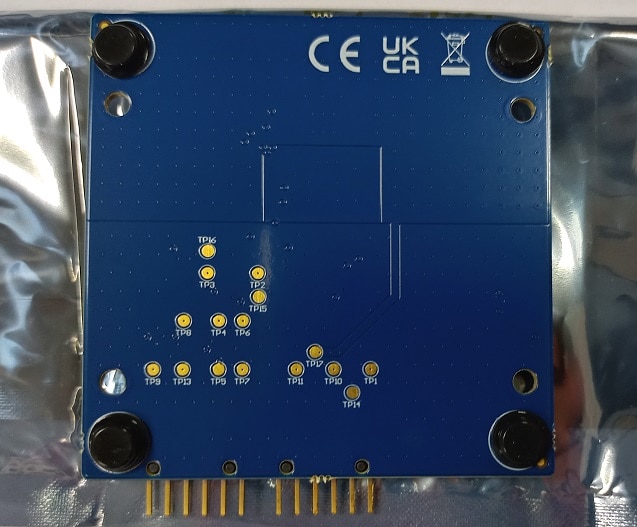

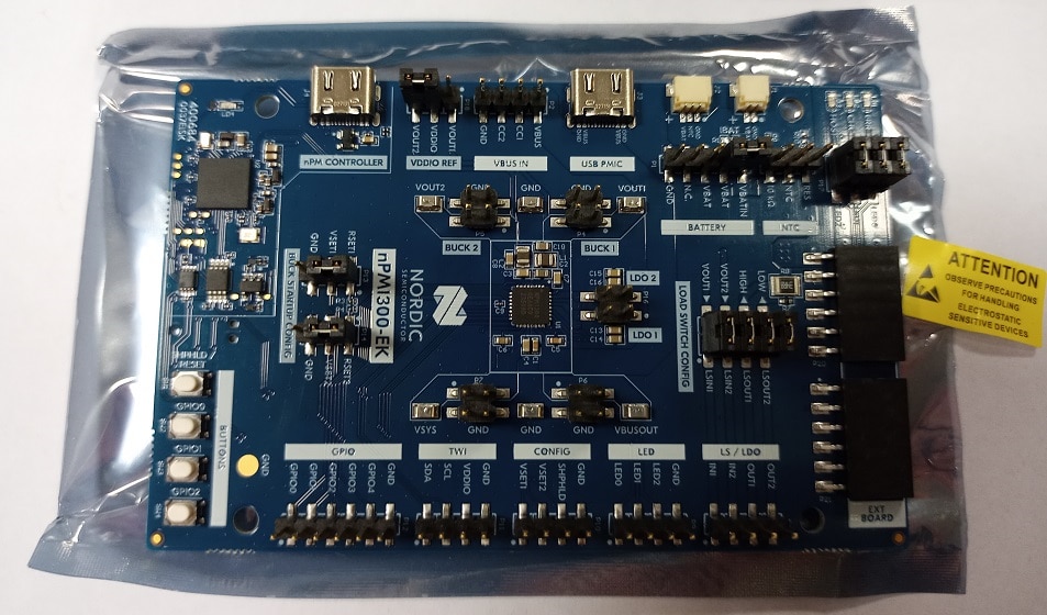

 Both modules are provided in the form prepared to operate without enclosures - without any components on the bottom sides and equipped with plastic "feet", providing some separation from (possibly conductive) working surface.
{gallery}Module photos
Evaluation kit - top
Evaluation kit - bottom

and can be connected using an edge connector (like below)
connected modules

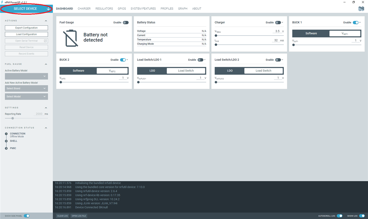

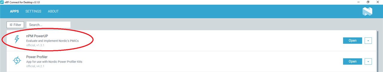

Another component needed for operating the evaluation kit from the PC (and creating models) is an nPM PowerUP application, that can be installed inside of nRF Connect for Desktop package
nrf connect with powerup app
Inside PowerUP application, evaluation kit should be selected first:
select ek

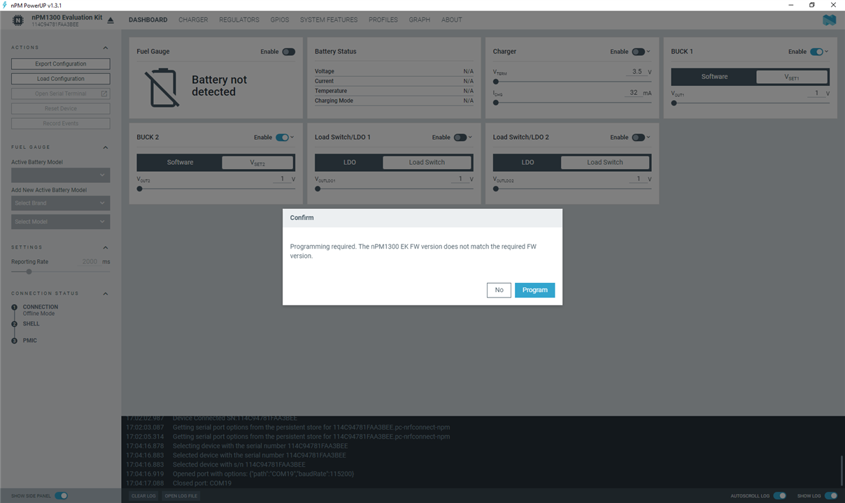

then, after the initial connection, firmware upgrade will be executed:
ek firmware upgrade

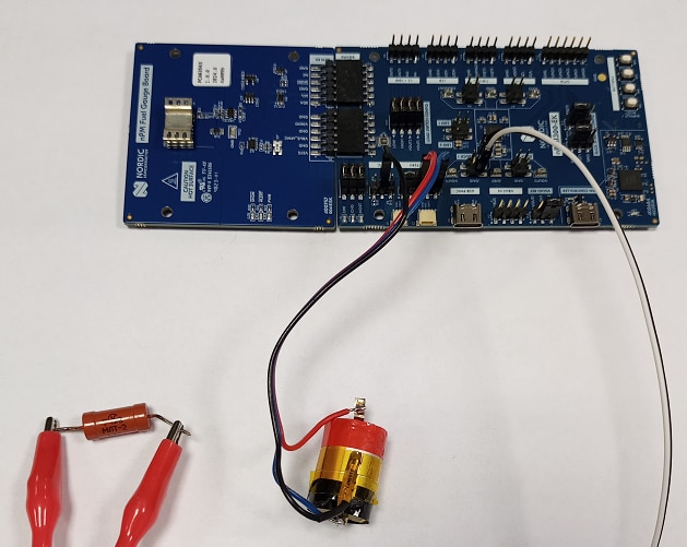

As a test setup, two elements were connected to the Evaluation Kit - a salvaged battery of unknown parameters (marked as 18250 battery with 600 mAh capacity) and an 47Ω resistor (used for controlled discharge of the battery).
As generating precise battery models involve taking into consideration the temperature (and - to get better results, can be repeated at different temperatures, for example +5°C, +25°C and +45°C, while avoiding extreme heat and below freezing values is recommended, as they can increase non-linearities and distort the model), 10 kΩ NTC termistor was glued to the battery.
In case when no termistor is present, evaluation kit provides (selectable by a jumper) fixed 10 kΩ resistor that can be substituted for it, but in this case user supplied test temperature will be used instead ot the measurement, making the model less precise.

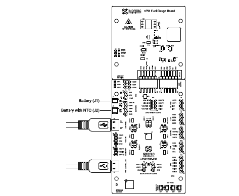

Evaluation kit provides three methods of battery connection:
  • three contact, 1 mm pitch JST-SH connector for batteries with NTC,
  • two contact, 1 mm pitch JST-SH connector for batteries without NTC,
  • two standard, 0.1"" pin headers (one for NTC and another one for the battery),
battery connector

As the battery under test was not equipped with JST connector, header connector was selected.

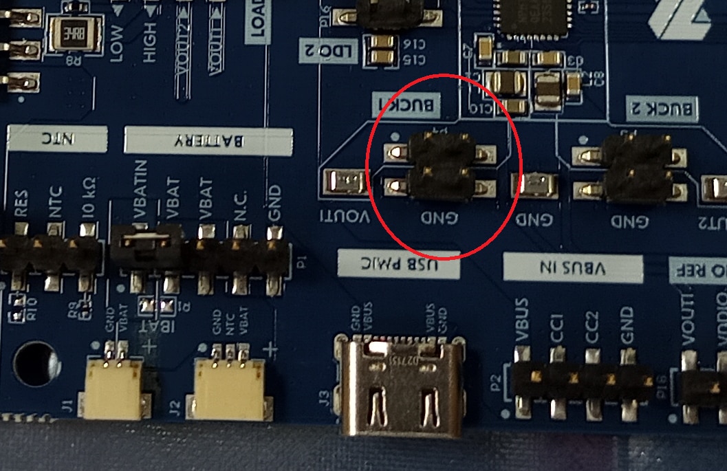

Another component used during the test was an 47 Ω resistor connected to the output of one of two buck regulators - the one marked as "BUCK1" was selected, because the other one is an recommended reference voltage for TWI and GPIO pins (so it cannot be switched off or reducted below 1.7 V and trying to do so generates warnings in GUI). Use of fixed resistor in connection with stabilized power supply allowed for configuring a constant and software controlled load for the battery.
load connection
resulting in the installation as below
test setup

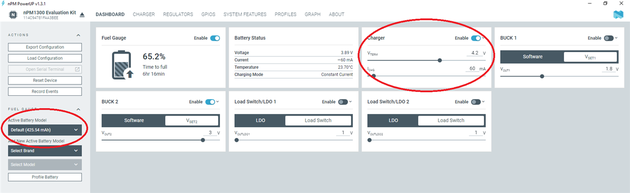

As the battery to be profiled should be fully charged, during the first step charger was configured (with terminal voltage of 4.2 V and charging current - in this case 60 mA, later modified to 120 mA) and then activated. At the screenshot below one can see that "Default" battery model is used and the estimated charge level is presented.
initial charging
 Charging (and discharging) process can be monitored on the GRAPH tab - for example, screen below shows a switch from constant current to constant voltage mode during battery charging
CC/CV switch

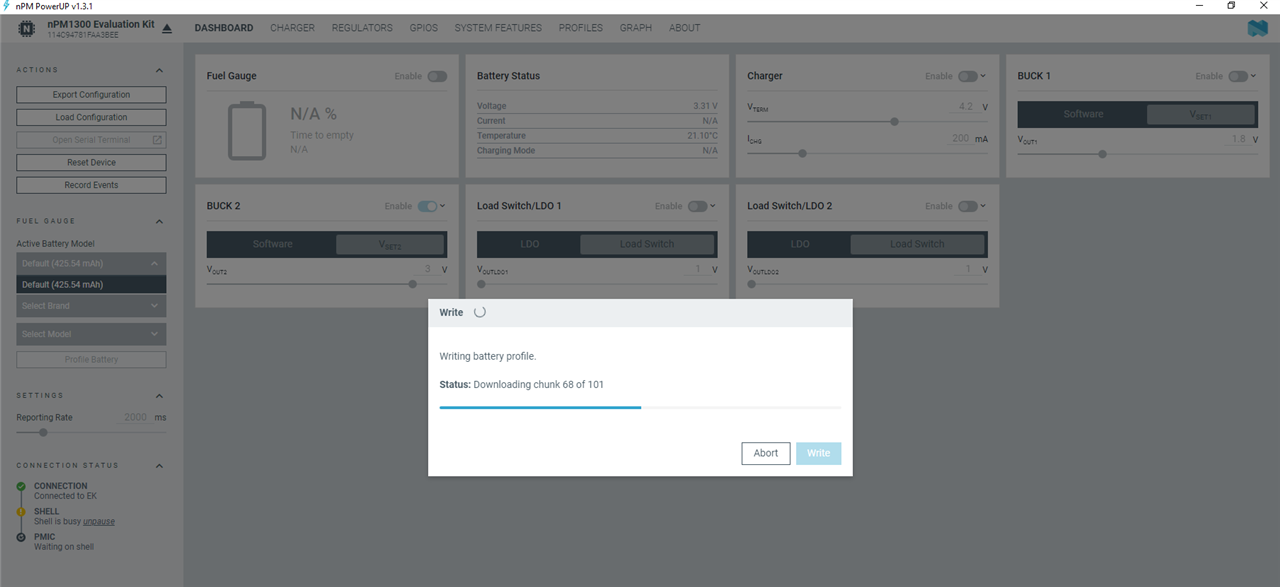

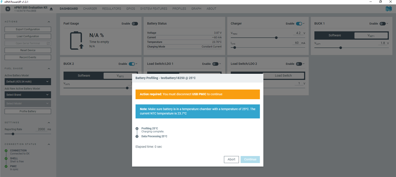

Battery profiling

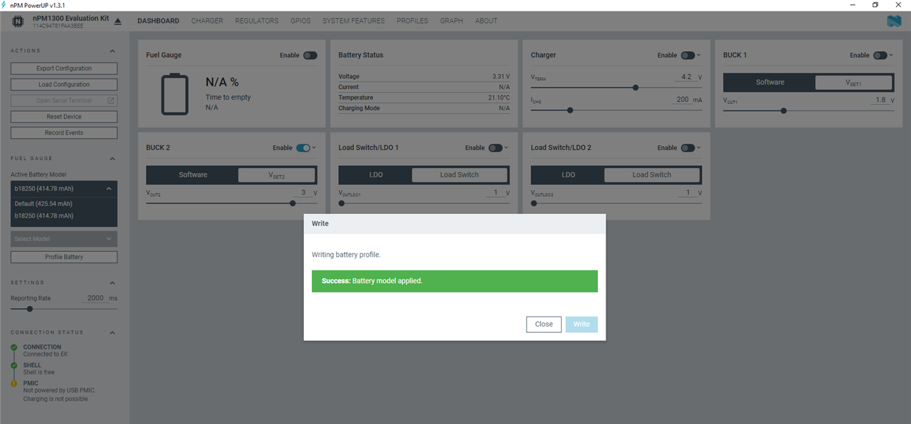

After the battery is full, profiling can be started - it generates several warnings before starting (about expected temperature, operations that should be executed (removing of USB power connection), and a warning against changing device's configuration during profiling) and takes a long time - about two days for each temperature.
At the end, profile can be written to the evaluation kit's memory, into one of four slots
{gallery}Battery profiling
profiling preparation
Warnings before profiling
profiling started
Profiling started
Profiling finished
Profiling finished
Profile writing
Writing of the profile
Profile written
Profile written
After profiling battery is empty and needs charging (which is possible after reconnecting USB power cable, disconnected in the profiling process). At this stage, newly created profile can be selected as a current one
Charging after profiling

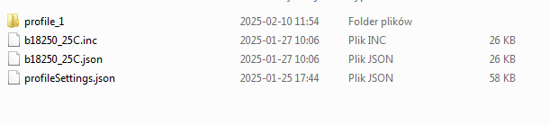

Profiling process generates two main files, one json (to be used with PowerUP application) and one inc (for use with nPM SDK):
output files
both of them contain 12 data structures containing parameters for fuel gauging algorithm, and as   have learned they are intentionally left undocumented by the manufacturer.

In addition, several CSV files are created under profile_1 directory, some of them containing measurements from the profiling process. For example, file b18250_600mAh_Tp25.csv contains data like this:
Seconds	Current(A)	Voltage(V)	Temperature(C)
1	-0.000025	4.179207	24.176
7	-0.000025	4.179207	24.072999
8	0	4.179199	24.072999
9	-0.000025	4.179207	24.072999
340	-0.120025	4.074407	24.072999
341	-0.120025	4.074407	24.072999
90151	-0.059825	3.097947	21.834999
90152	-0.059825	3.096347	21.834999
As can be seen, profiling process discharges the battery using current of different values and even some intervals with no current draw (which may be connected with the intent to measure Open Circuit Voltage when the battery is "at rest").

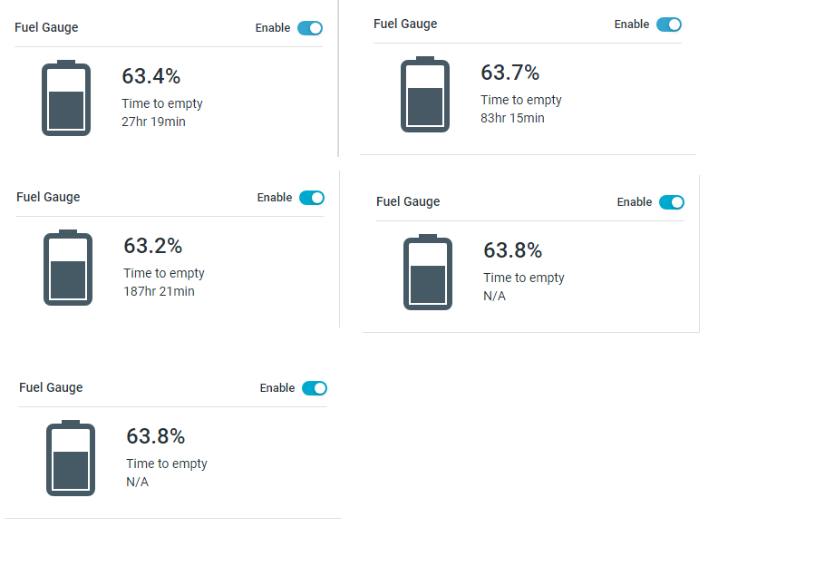

After the battery was discharged to about 60%, main test was executed: five times evaluation kit was powered down by disconnecting the USB cable from controller port (and closing the PowerUP application), which seems sufficient to clear any internal state from the Evaluation Kit, as the fuel gauge algorithm (with high probability) runs on the controller SOC, which is powered by the PC USB connection.
Results are as below and seem repeatable:
fuel gauge test
