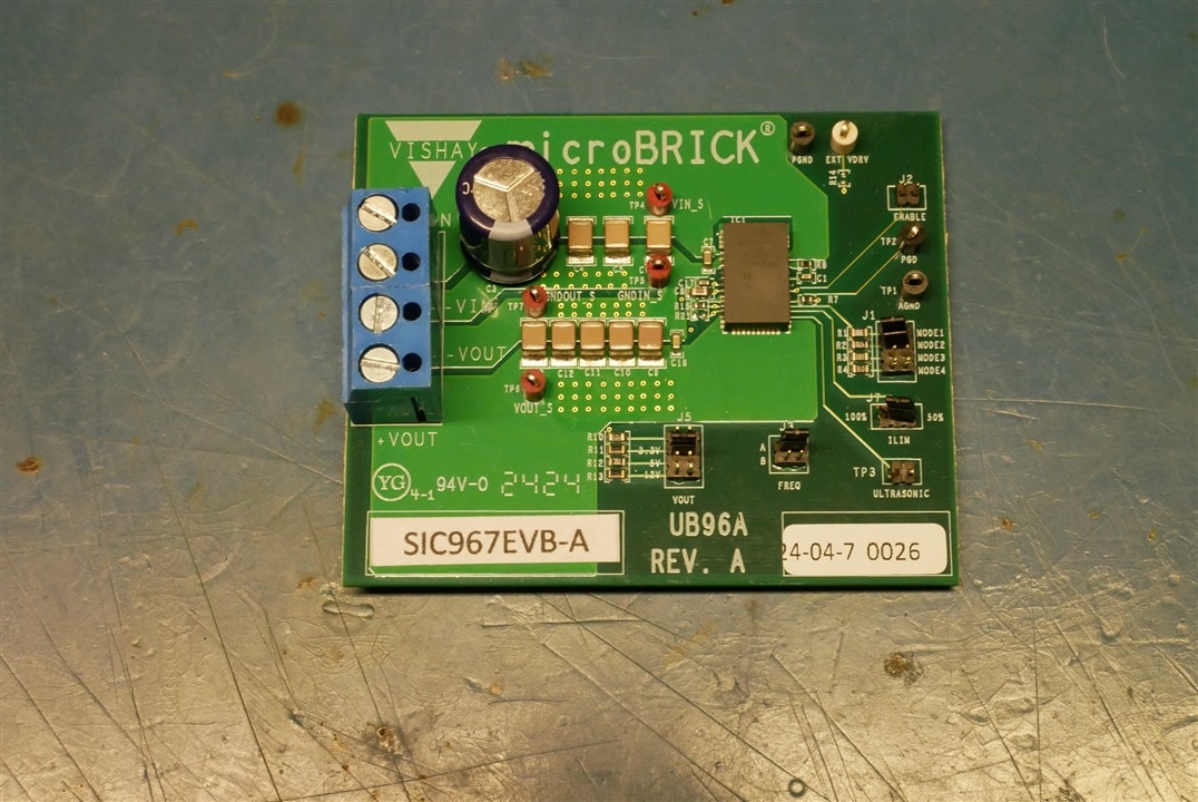

The eval board looks like this:

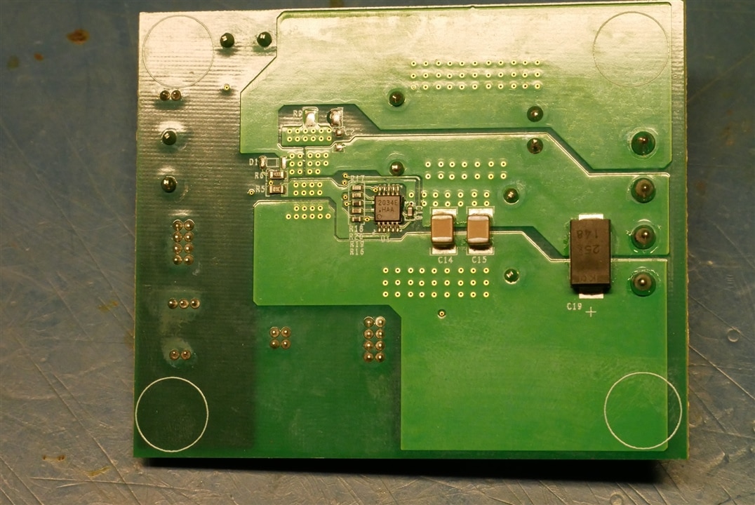

The first thing you'll notice is that the chip is huge, and the second is that there are a lot of capacitors
(and more on the underneath):
It's a six layer board and is not designed to be used for any purpose other than evaluation of the SiC967. With a bit of effort and very little increase in cost it could have been designed to be useful for small volume production but, the only means of connection are via the screw terminals and top side pin headers and there is no way to attach it to a mother board or chassis. The addition of a couple of rows of 0.1" pitch pins would have extended the areas of application into small volume production.
The board has pin headers to allow selection of the output voltage (3.3, 5 or 12 V), the switching frequency, current limit, and the operating mode.
How to set the pins is explained quite well in the eval board "User's Manual which also shows the six layers of the pcb.

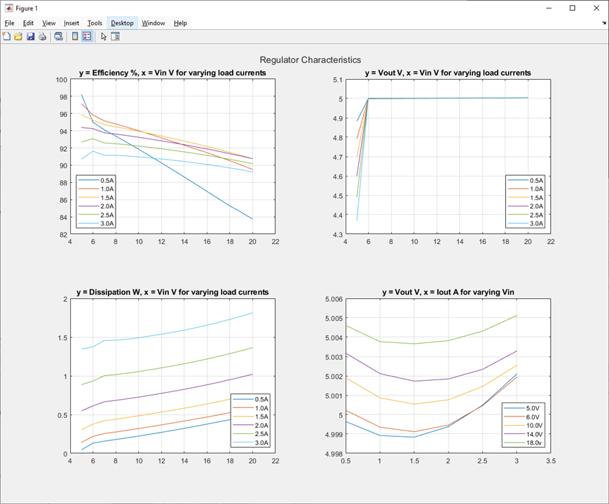

Efficiency Testing The Eval Board
I made some new cables to make it easy to connect the board while working on it, so the first test I did was check the new cables.:
The efficiency graph looks fine, with less than 0.01% error at 6A and 5V.

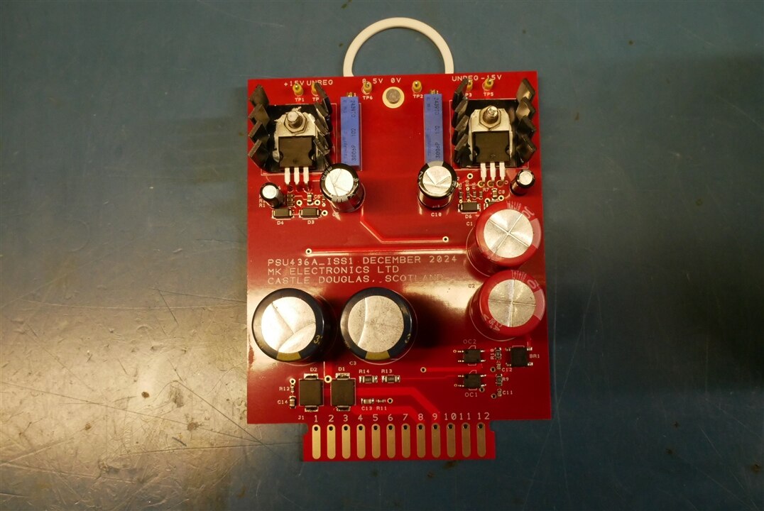

My plan for this RoadTest was to design the SiC967 into one of my current projects which is a replacement plug in power supply PCB for an HP436A RF power meter.  These power meters use TO3 style linear regulators with the signal earht connected to the device case. The 436A  uses its metal chassis as the 0V rail for the 5V supply. I wanted to have an isolated and  5V supply and to avoid huge heat sinks, so a switcher is required.

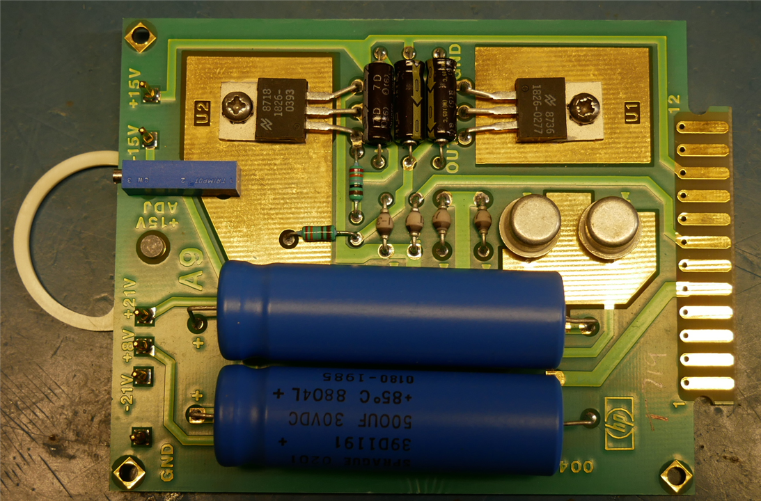

This is the original HP 436A power supply board:
My first spin of a replacement power board for the 436A looks like this:
Like the original it has the rectifier for the 5V supply but not the regulator. My board does have the smoothing caps for the 5V supply - in the 50 years since HP designed this thing capacitors have got a lot smaller too !
There is plenty of room for the SiC967 after a bit of capacitor re-positioning.

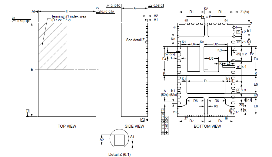

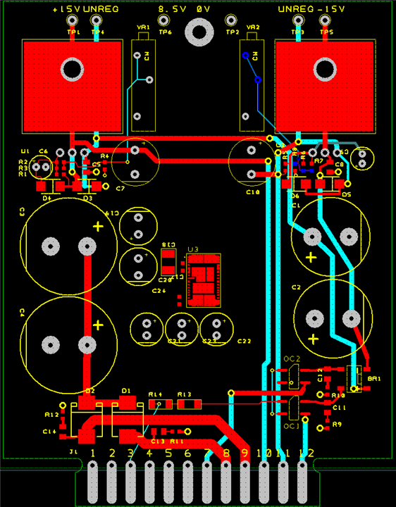

So I started on a new PCB design - and hit the first big snag !

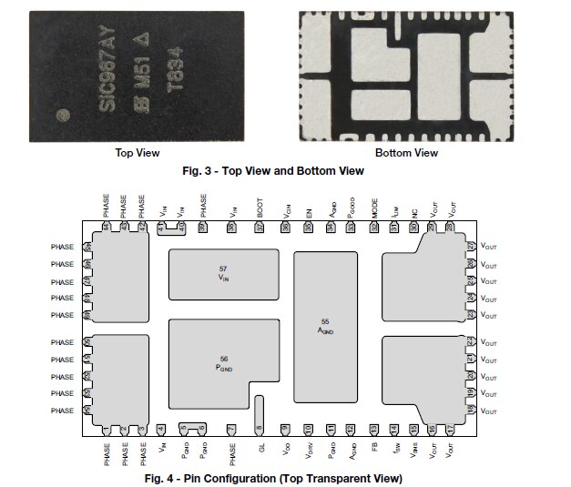

The SiC 967 has a weird footprint. It may not be the oddest in existence but it has a good try.
There isn't a drawing on the data sheet but if you hunt you can find one - and here it is:
The drawing is of the bottom of the chip - it's not a recommended PCB footprint. To turn it into a footprint it needs to be transposed to a top view and decisions made about sizing the pads. To make it as hard as possible - the chip has varying pad pitches, several different sizes of pads and doesn't use a co-ordinate system for dimensions but mainly relative dimensioning.
There are un-dimensioned features on the drawing (what's the gap between the little lumps on the inside edges of the two big bottom pads ?)
For a power chip it would be good to be able to use thicker copper than the normal 1oz but the 0.5mm pad pitch makes this a bit risky.
I asked Vishay Tech support about footprints. They answered promptly but could give me no more information.
There is a footprint on SnapMagic and I downloaded it into my PCB CAD. It's not nice because it lumps the joined together pins into single entities which while not exactly wrong is not the way I work. However, because it's a RoadTest I decided I would give it a go.
I got this far:
Having proved that I could fit all the parts on the board it was time to use the data sheet and simulator to calculate suitable component values and types.

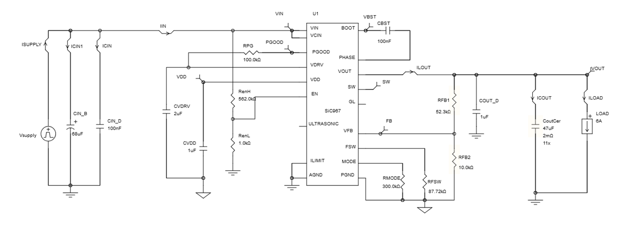

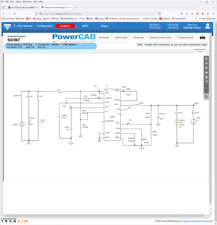

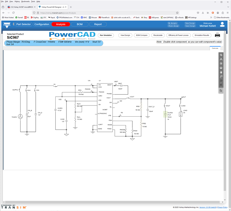

Vishay's PowerCAD tool is very much in the second camp - in the case of the SiC967 you can use the tool to calculate support components suitable for certain design parameters but you can't add external components of your own selection and configuration.

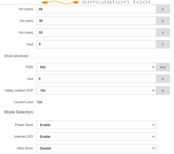

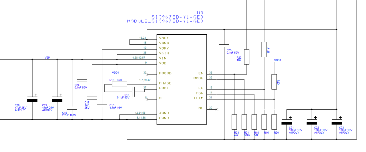

I setup my design parameters like this:
This is the schematic it produces:

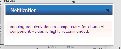

You can change the output cap like this:
I changed the output cap to something a bit more sensible:
And it said this:
The Recalculation took 25 seconds.

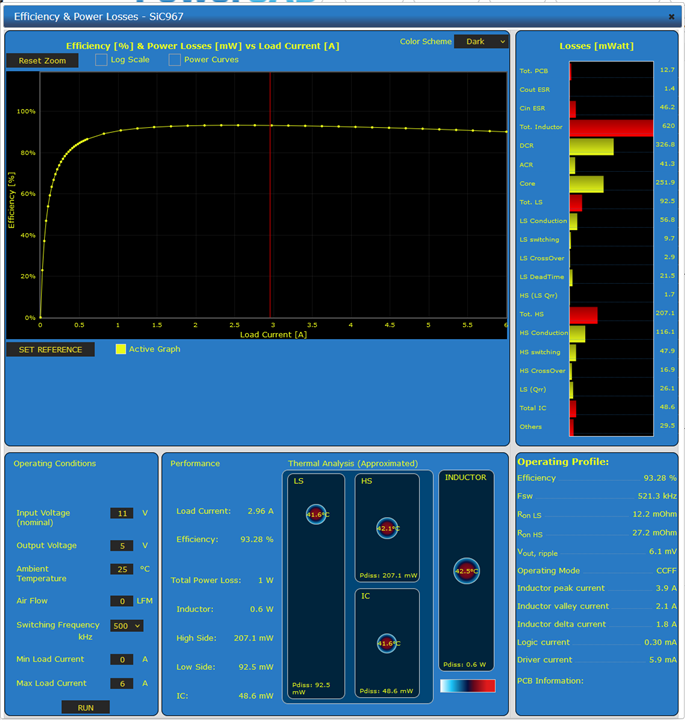

I did the efficiency and Power loss estimate - it took about 1 minute and made this page:

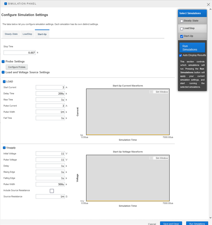

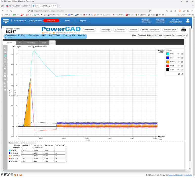

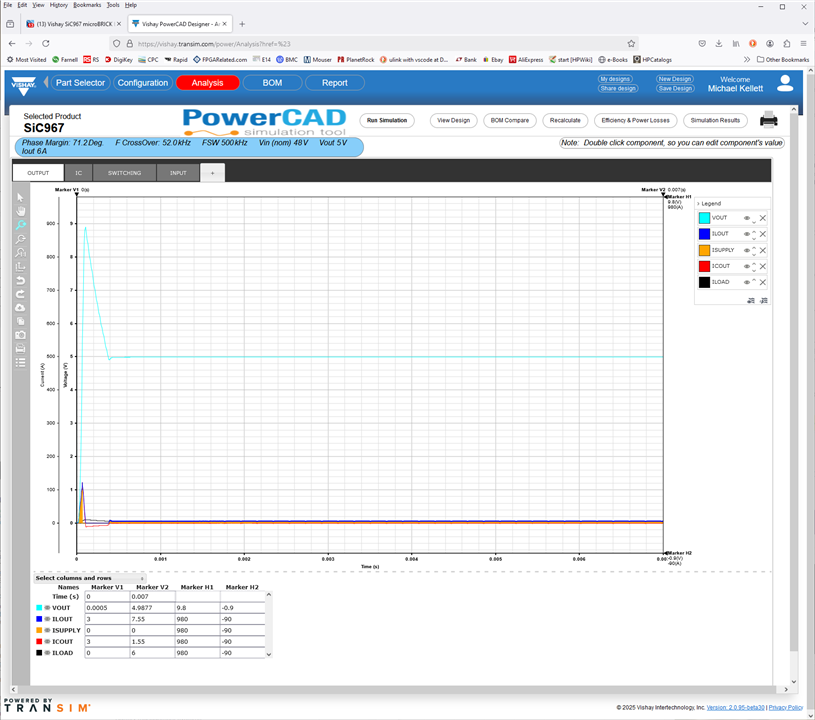

I re-ran PowerCAD after a break of about a month and spent an age trying to work out how to run a simulation !
Silly me ! Everyone knows that the simulation button hides under the title if your browser is less than about a mile wide !!!!!!!!!

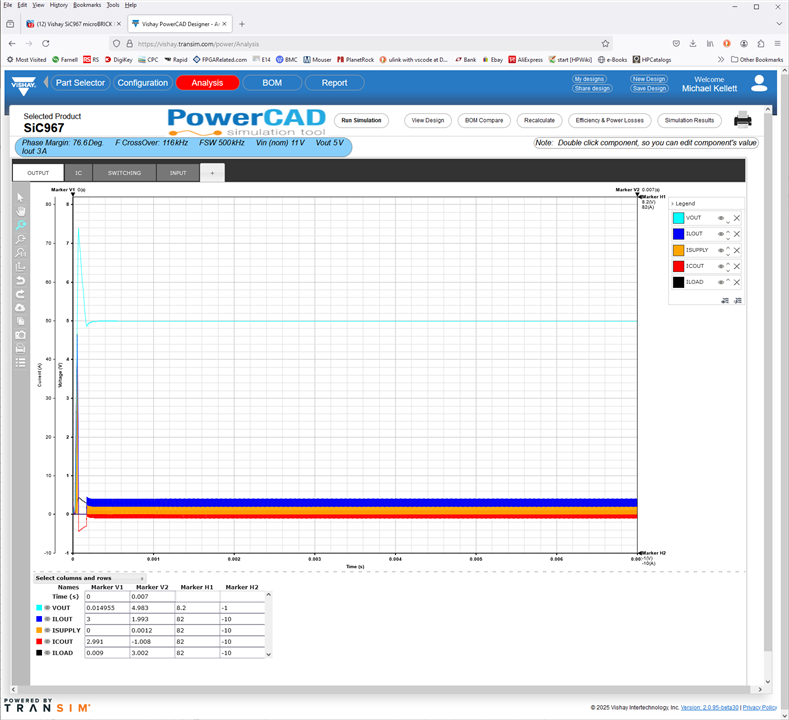

I set this up:
It took 2minutes and 15 seconds to get the result graph up.

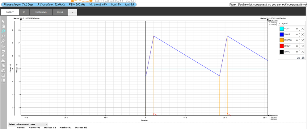

It looks like this:
Lets zoom in on that start up over voltage pulse:
That's truly horrifying - a peak of 7.4V is fully capable of destroying any 5V rated parts connect to it.
So either the simulation is wrong, or the design tool has made a bad job of things or my change of capacitors has screwed things up.
I stopped at this point for lunch, when I returned it had closed the session and dumped my design !
I tried re-loading the design but that didn't work (or else took longer than I could be bothered to wait.)
Closed it down and re-started the simulator. Ran with default values on everything:
Its even worse !
The overshoot peak is 8.4V.
I did play with the simulator a bit more - it crashes, its dreadfully slow, it tells you that the part is going blow your load up.

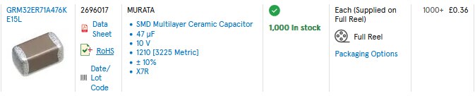

I experimented by replacing the 5 x 22uF ceramic output caps (£1.90 worth at 1k off prices) with 1 x 47uF aluminium poly and 1 x 22uF ceramic (£1.19 cheaper).
The Al poly cap will have a higher ESR than the 4 ceramics in parallel that it replaces.

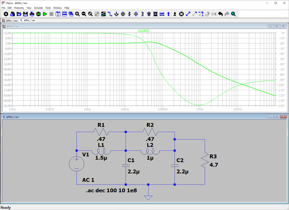

I designed a filter using LTSpice:
The inductors have series resistance of 15mR and 11mR. They are fairly tiny and come from the TDK SPM5030 series. The cost of the filter parts is about £1.50.
The load resistance has very little effect on the frequency response.
The improvement in the output noise is dramatic:
Not only is the output noise at the switching frequency down to about 0.5mV but all the other related noise spurs are less than 10uV.

    Weirdly my PowerCAD with defaults was using 1k for that resistor. I'll check it again sometime.
    1R is reasonable for that resistor, the Eval board uses 3R3 and 1k is probably not a good value to use.

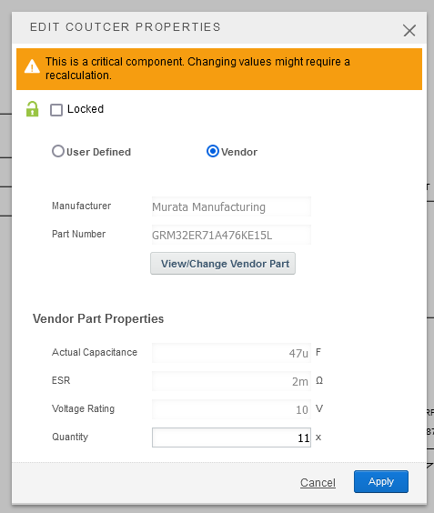

  • Your circuit looks like what one gets with the default settings (although I can't read the value of the resistor on the Phase terminal pin).
    Both repeat the absurd suggestion of 12 capacitors in // on the output.
    Farnell keep the part in question:
    So that's £4.32 worth of output capacitor with an area of at least 160sq mm when mounted on a pcb.

    The startup simulation with the default values has the nearly 9V peak shown in the graph in my RoadTest. There is no way so simulating using the enable pin but my bench measurement showed that the chip does indeed soft start as it should when enabled and  takes about 6ms from enabling, to rise smoothly to full output voltage without significant overshoot.
    I don't have a power supply that can get 48V into the input with a rise time of less than 10us and a peak current in excess of 100A (which is what the simulator startup shows !).

  • I got a better behaving design from the simulator (I think)
    Except for different component values, it had these changes in the schematic:
