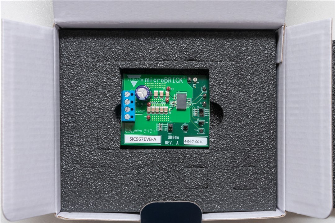

Inside, the PCB sits snugly inside a foam insert, covered by a foam layer (not pictured).

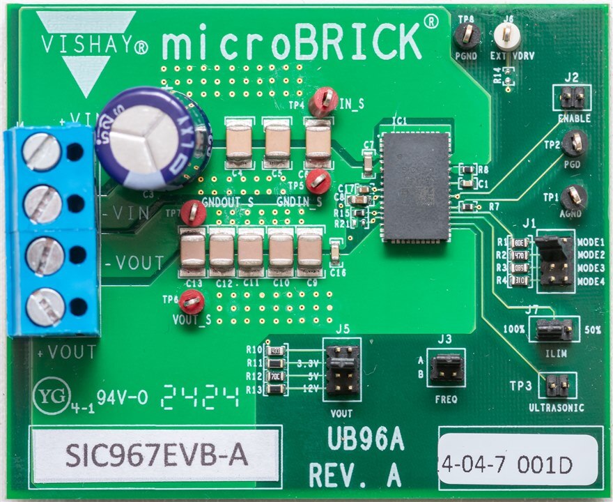

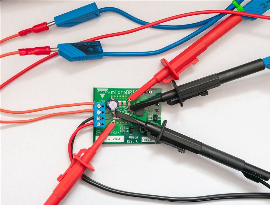

The board itself is quite small and compact, with no mounting holes and jumpers of a particularly small size. Unfortunately, there doesn’t seem to be enough jumpers supplied to test all features – e.g. ultrasonic, or frequency selection of 1MHz which requires two jumpers. I had to improvise a little to make this work, but it would have been much easier had they opted for classic 2.54mm header pins so ordinary jumper shunts can be used, or DIP switches. The board itself feels to be a quality heavy-weight 6-layer board, the optimal type for a thermal-and-power focused design.

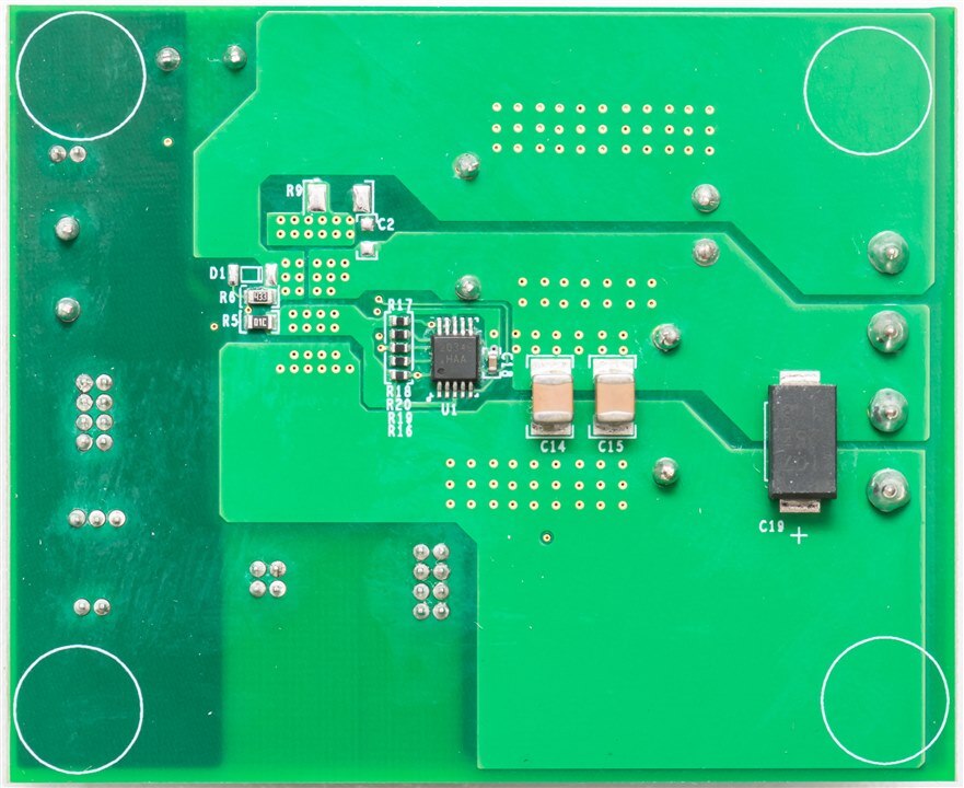

There are some components mounted on the underside as well, including a DG2034 4:1 low-R multiplexer for switching frequency selection, a selection of capacitors and resistors. There is a bit of flux residue as well, with silkscreen labels for positioning rubber feet (not provided).

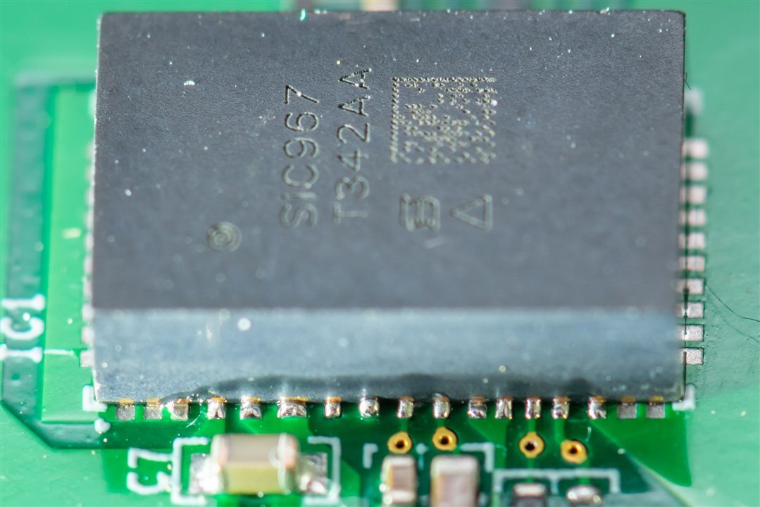

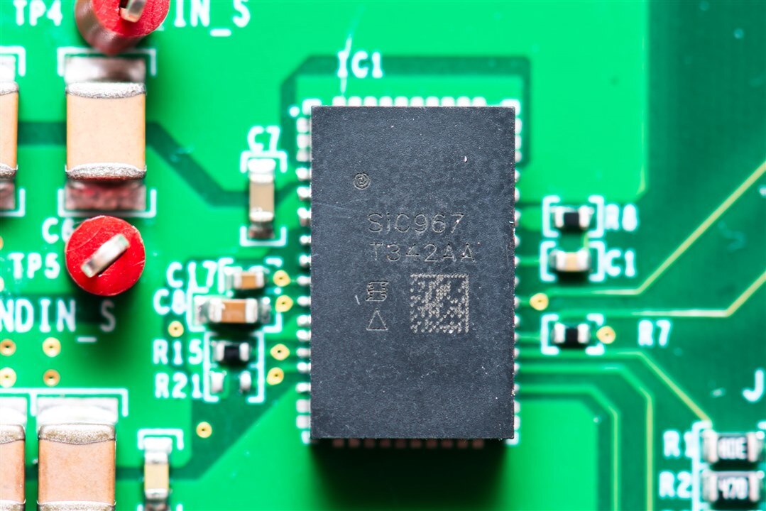

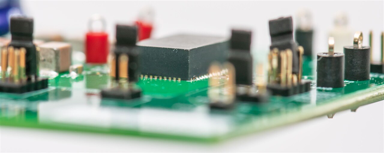

The package itself is a bit tall and appears to be laser-marked. It is very much a “micro” brick!
This is most apparent when looking at the board from an oblique angle. That’s 3mm height – a bit tall for a chip but definitely quite small when considering the regular size of inductors with the necessary ratings.

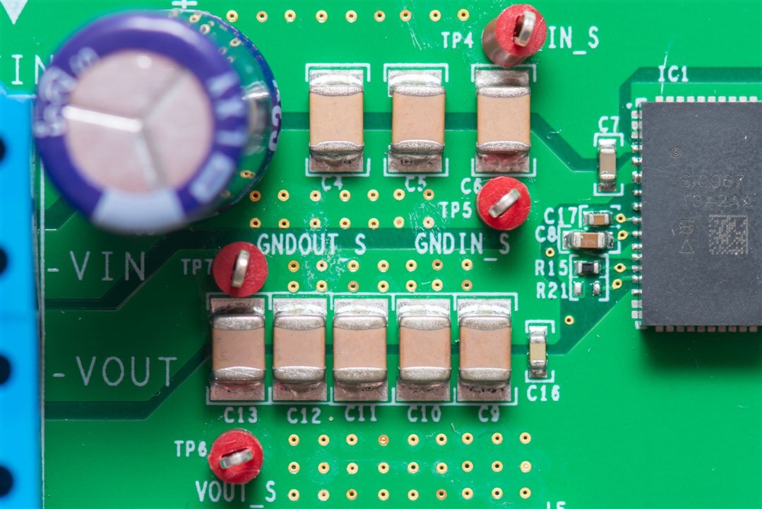

This area of the board focuses on input and output capacitance, with sensing test-points. This is the main supporting circuitry aside from configuration resistances, as everything else is inside the “brick”.

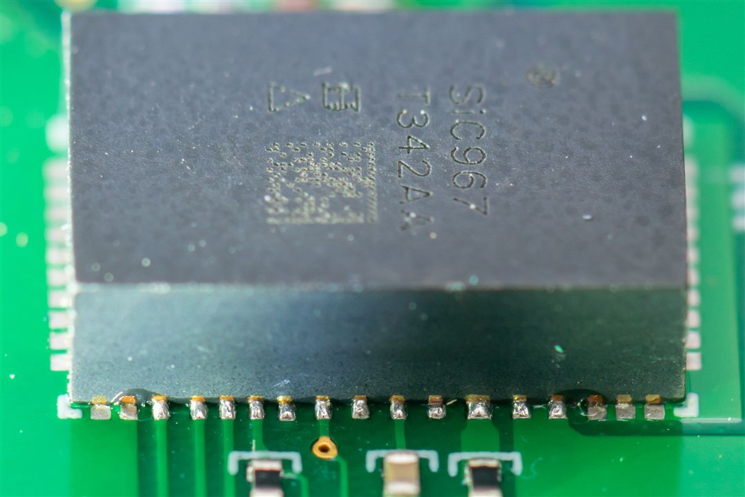

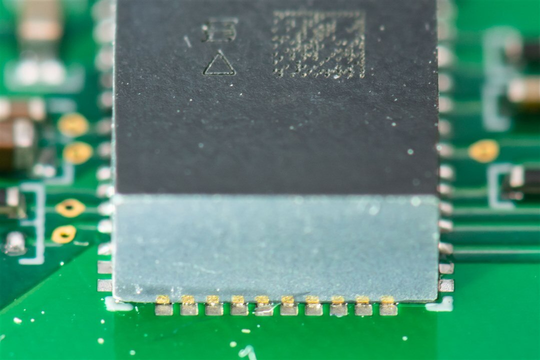

Taking a closer look around the package itself …
image image image image

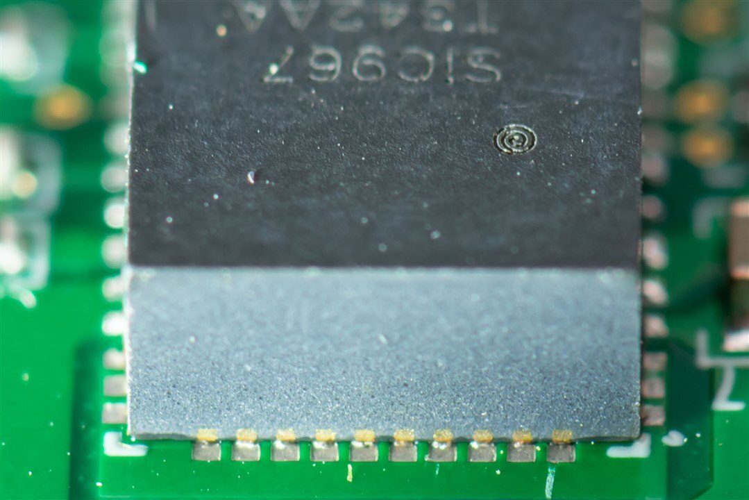

… the mounting of the package itself does not appear to be in perfect alignment and the solder and flux residues suggests difficulties in mounting this package to the board. There may have been some hand-soldering touch-ups applied to the board post-manufacture, but some pins appear “dry” from the outside. This is not the appearance I would expect if the board was manufactured on an automated line. One of the challenges that can occur with soldering larger components has to do with soldering temperature profiles needing to ramp slowly enough such that the component has time to heat all the way through … I wonder if this was an issue in this manufacturing run or whether they simply choose to mount the modules by hand based on demand for evaluation boards?

Testing of efficiency was done using two rails of a Rohde & Schwarz HMP4040 Power Supply and a B&K Precision Model 8600 DC Electronic Load. In both cases, four-wire connections were used to ensure voltage drops across wires were compensated for. Test steps were made in 0.5V increments on input voltage between 4.5V and 60V, and 25mA current increments on the load current axes from 0A up to over-current shut-down based on a 10A valley current setting. Testing was automated by script, with occasional test rack resets required due to transient issues which may have arisen due to communications issues and power supply oscillation (where the converter may have created a load condition which the power supply could not stably regulate).
Testing took several weeks and focused on the three pre-set configurations listed in the manual – 3.3V output with 400kHz switching frequency, 5V output with 500kHz switching frequency and 12V output at 1MHz switching frequency. Tests also examined the difference between Mode 1 (power saving mode) and Mode 2 (no power saving) operation.

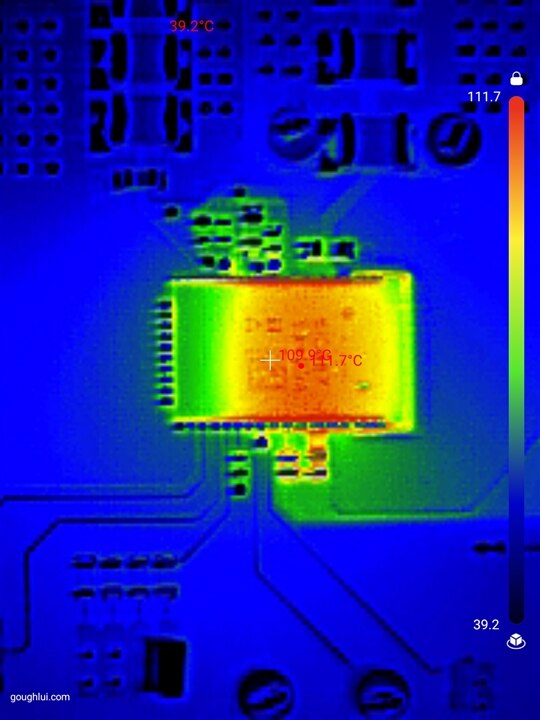

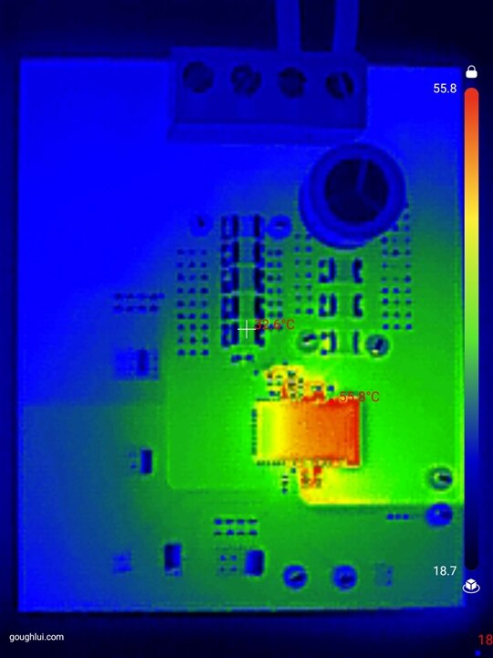

Thermals were assessed using a Topdon TS001 USB-C Thermal Camera using the default 0.95 emissivity setting. The SiC967EVB-A was subject to full-load (6A) with the 48V nominal input and 3.3V output for half an hour.
The wide thermal image shows the module itself being over 100°C while the PCB is about 75-80°C. The unit is very warm but is still functioning as normal.
A close-up of the chip finds the hottest spot was about 111.7°C, this occurring near the centre of the package. The package is rated for operation up to 125°C junction temperature, so this is probably getting quite close to limits.

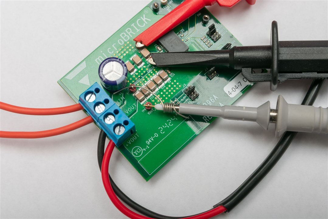

Ripple and noise measurements were made using a Rohde & Schwarz MXO4 oscilloscope (yet to be reviewed). This particular oscilloscope’s low noise-floor was a big asset for this test, which was conducted using DC-coupling combined with voltage offset capability to provide a more accurate view of the ripple. As I don’t have a proper power-rail probe (those are expensive!), I used the included 10:1 passive probe with 20MHz bandwidth filter and HD mode enabled.
Probing was done using a wire “spring” ground using the sensing test points to reduce loop area. The converter was supplied 48V from the Rohde & Schwarz HMP4040 and loaded to the full rated load with the B&K Precision Model 8600 DC Electronic Load.
At 3.3V output with 6A load, peak-to-peak ripple was measured at an average of 32mV, which is 0.96%. This is a very acceptable level of ripple.
At 5V output with 6A load, peak-to-peak ripple was measured at an average of 41mV, which is 0.82%, again a very acceptable level of ripple.
At 12V output with 4A load, the ripple was much lower at a peak-to-peak value averaging 16mV which is just 0.13%. This tight regulation is likely due to the increased switching frequency of this configuration which runs at 1MHz rather than 400/500kHz as in the previous.

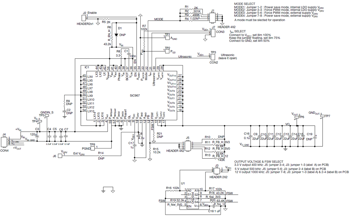

    Excellent question - the schematics for the board is available here - see Page 4 (reproduced below):
    Most significantly, as it is a microBRICK module, the majority of the switching action is hidden away from the user. As a result, the schematic is pretty simple - bypass capacitances, some configuration of modes/voltage output/frequency/current limit/internal chip supply (via internal LDO or via external supply). Everything else is pretty much handled automatically.

  • Very good. I like to see the transient responses. I think many power supplies, particularly older ones, could be problematic to transient loads. Audio and radio power amplifiers are susceptible to transient responses as their loads can vary dramatically.
    A circuit diagram would help explain how the board works.
