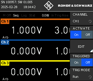

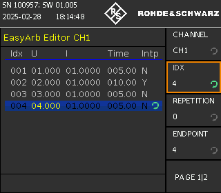

The EasyArb function of the NCG103 was also fairly easy to use. As I've done with most things on theis RoadTest, I started by ignoring the manual and seeing if it was obvious how to use the feature. With a couple of quirks, I'd say it was.
For some reason, the Arb function has its own main panel button, but it can also be accessed via the menu as with the Sequence and Ramp features. For each channel that you want to create a seuqnce for, you need to activate the sequence and then edit the "waypoints". You have a maximum of 512, btu I kept it to just 4 for a demonstration.
It was a little clunky editing this table of values on the device. For larger or more complex sequences it would make sense to edit this on a PC using HMExplorer or as a CSV file and then upload.

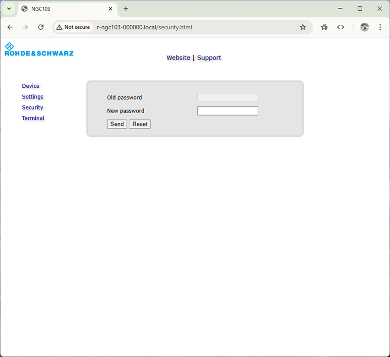

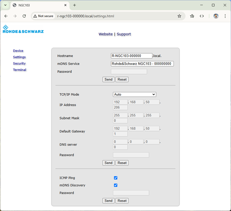

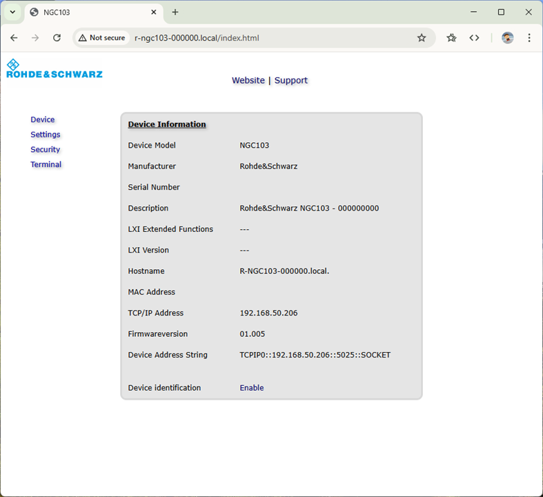

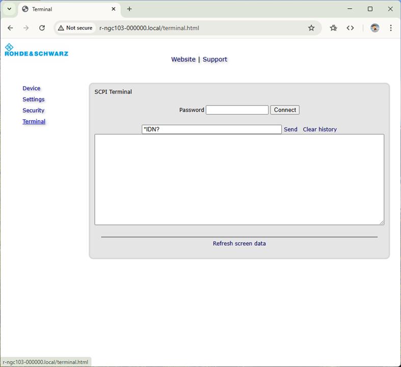

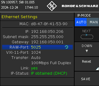

It's wasn't too hard to setup control of the NGC103 over the network. I connected an Ethernet cable and was able to see the assigned IP adderess using the Setup / Interface / Ethernet / Parameter menu on the device. Once I knew the IP it was a case of opening up a web page served by the power supply. I found out afterwards I could also have used the default hostname and go straight to http://R-NGC103-000000.local. To be honest there isn't that much the web interface needs to do other than show some basic info and provide an SCPI terminal for entering commands. I suppose I was expecting something more elaborate such as that provided on the RTM3004 oscilloscope but to be honest that wouldn't really by necessary unless you were in a classroom and wanted to show the display to a room full of students. Taking screenshots of the display was easy enough but I don't believe there is any way to get a continuous live view of it.
{gallery}LAN control
IMAGE TITLE: Device page
IMAGE TITLE: Settings page
IMAGE TITLE: Security page
IMAGE TITLE: Terminal page (SCPI)

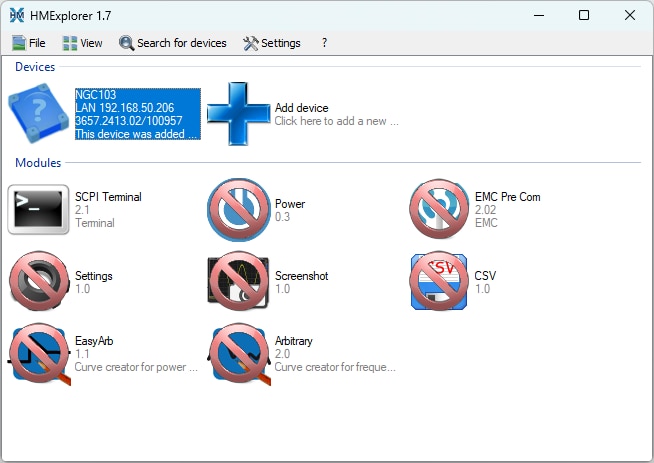

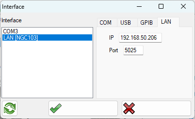

I also found that connecting via HMExplorer over IP was easy too. (The name is a bit of a throwback to the Hameg days!) All I had to do was change the port used from the default of 50000 to 5025 to match the hardware and off I went. Strangely, it seemed that once I selected the NGC103 the only option available was also an SCPI terminal.
Whatever I tried, I couldn't get the device connected over USB - either as VCP or TMC. Th link for driver in manual is incorrect and links to https://www.rohde-schwarz.com/product/ngf201 . Once I found them, it seems that none of the available drivers at https://www.rohde-schwarz.com/product/ngc100 work with VCP. I ended up following a link to ni.com for NI VISA drivers but needed another account. I decided that I didn't need this enough to continuem so stopped there. To be honest, all I really wanted was a way to create screenshots and I discovered that a long press on Save/Recall button saved a screenshot to a USB stick attached to the front panel.
