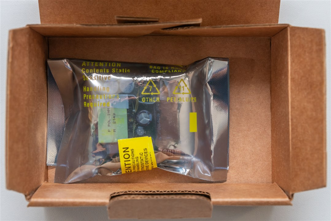

Inside is a natural cardboard-box with the board packed inside a static shielding bag. There was no padding, just the board loosely flying around. But it seems to have survived.

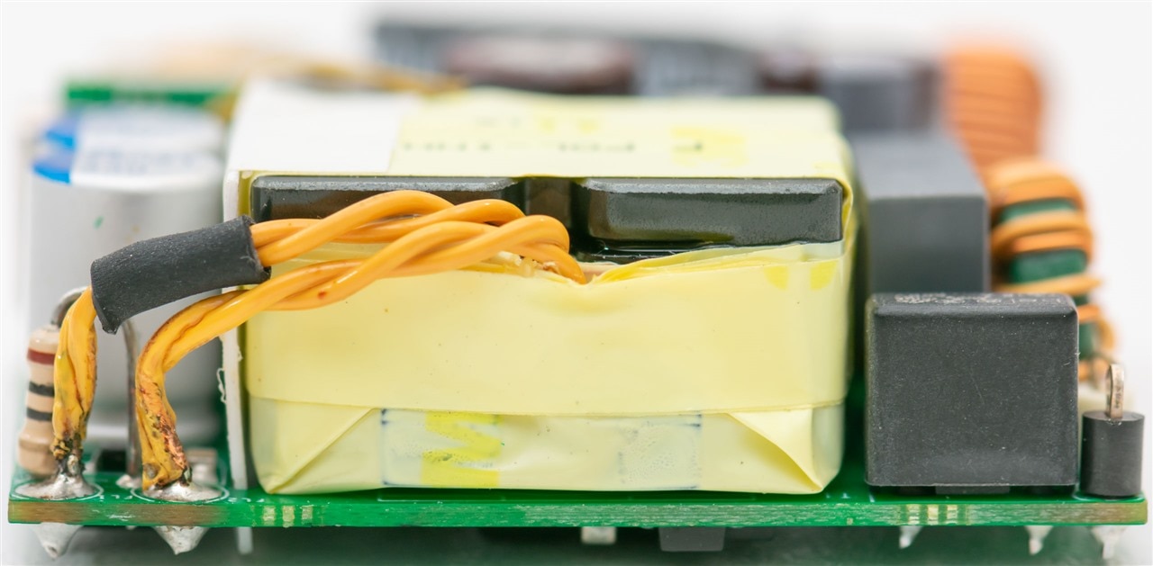

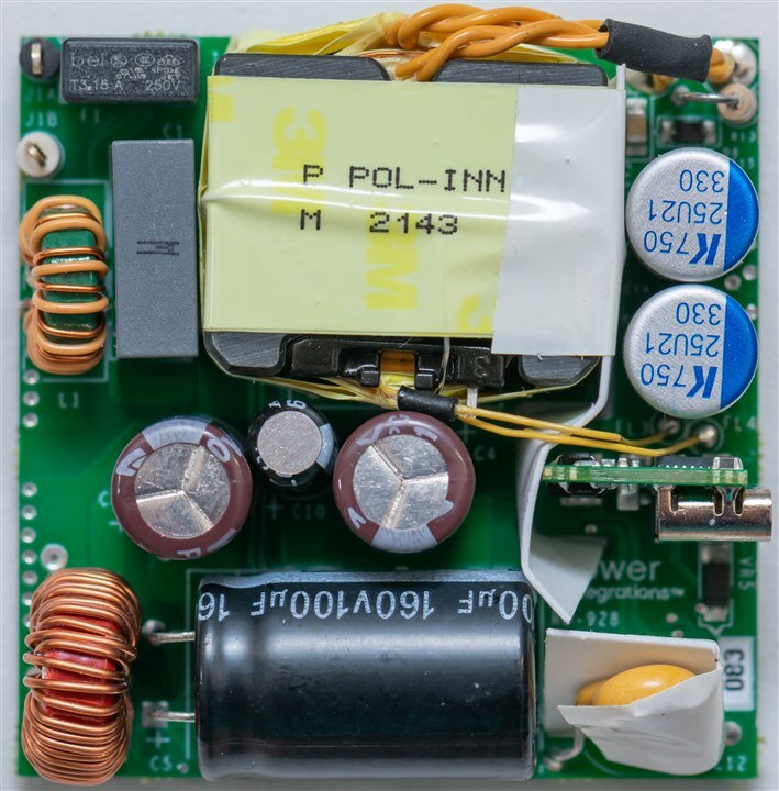

One of the key features of this reference design is the “tight” assembly that minimises footprint and volume. This is important, especially when considering that consumers prefer smaller and lighter chargers for better portability. The provided documentation gives full assembly instructions for the board including the custom-wound transformer, which is nice.
However, at a glance, it is clear that this board is focused on minimising board area, but this means it is not quite a practical design for implementation or testing. For example, there is no mounting points or edge rails to allow the board to be nicely mounted for testing.

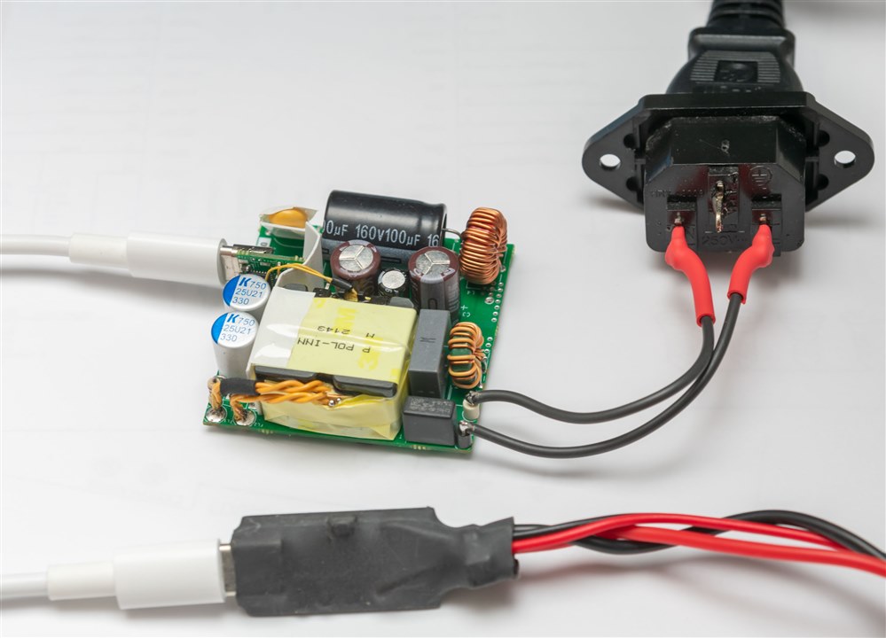

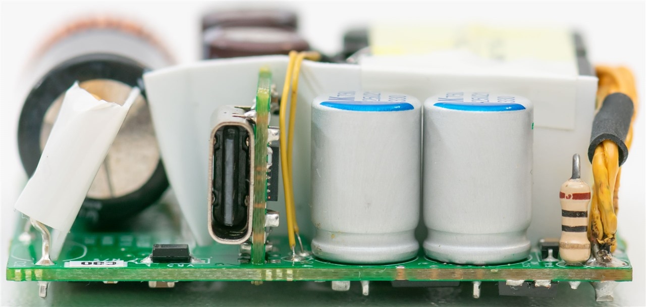

Likewise, power input is via two test loop contacts rather than a more familiar figure-8 lead connector.
The USB-C port also sits on a mezzanine board that rises out of the base in a precarious way that may not be durable enough for a practical charger. But as a demonstration of what is possible, it is still quite neat.
It is clear that attention has been placed to ensuring sufficient insulation between primary and secondary to ensure user safety. This does involve the use of some card and tape.

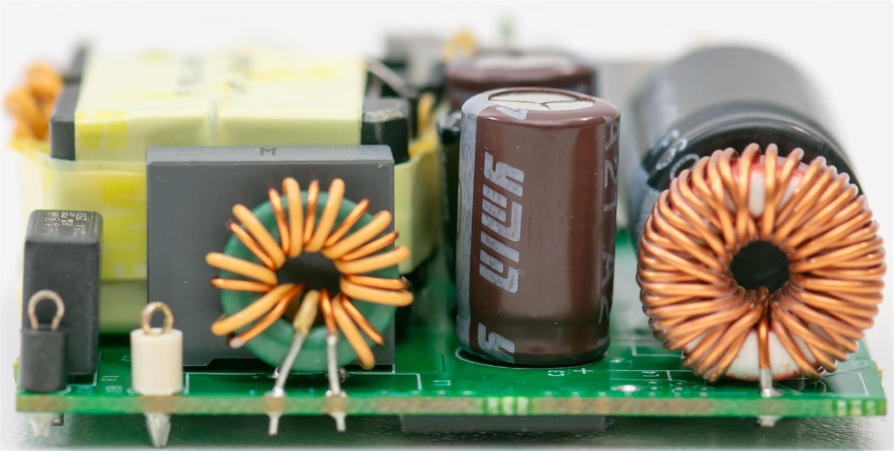

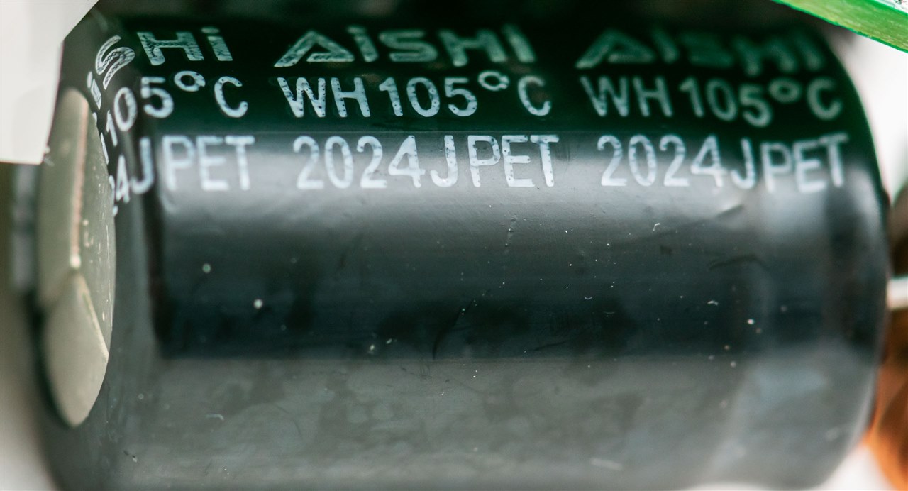

The design uses a mixture of Aishi and Ymin electrolytic capacitors for the high voltage DC rail. Both are fairly well-known capacitor brands which I’ve not had trouble with. They appear quite frequently chosen for such designs because of their temperature tolerance, lifetime and leakage characteristics. The output capacitors are solid electrolytic, which should offer even better lifetime.

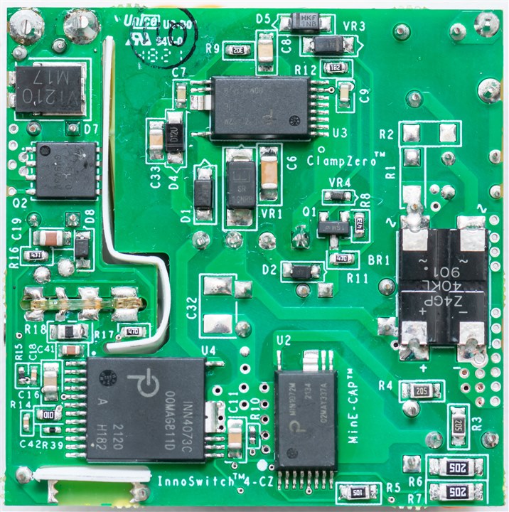

The board is double-sided populated, two layer, with many of the semiconductors mounted on this side. The guide seems to claim the copper thickness is 0.040 inches, but this appears to be a typo because that would correspond to 30-oz. Perhaps it’s meant to be 3-oz.
image image

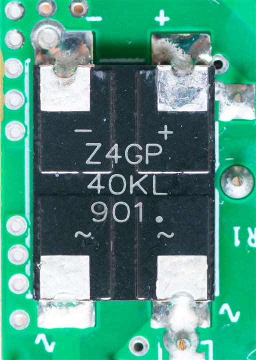

This is a very slim, surface-mounted bridge rectifier. There are also some other supporting components – here’s a Schottky and a MOSFET.

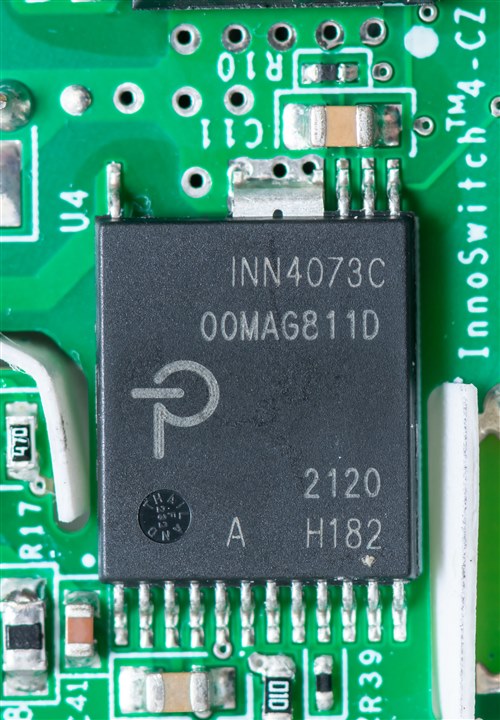

The main switching controller, the InnoSwitch4-CZ, specifically the INN4073C-H182, a zero-voltage switching flyback controller rated at 60W (enclosed) to 75W (open-frame) with output voltages ranging from 3-24V with an input of 85-265V. It features a switching frequency up to 140kHz with integrated Fluxlink feedback control and operating temperature up to 150 degrees C. Protection features include overtemperature, open SR FET detection, input overvoltage, input undervoltage, output short-circuit and output overload.

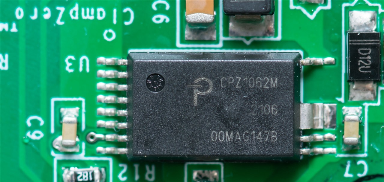

The partner to the switching controller is the ClampZero IC, specifically CPZ1062M. Its role, specifically, is as an active clamp that serves to increase energy efficiency by recycling wasted leakage inductance energy.
Finally, is another innovation, the MinE-CAP (MIN1072M) which is an IC that switches in and out capacitances depending on the instantaneous line voltage to allow for a reduction in the need for large high-voltage bulk capacitances by ensuring sufficient capacitance at lower voltages where the capacitance is really needed. It’s definitely an interesting approach to minimising space consumption as high voltage electrolytics are bulky.

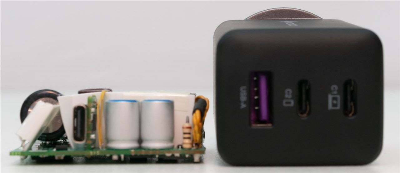

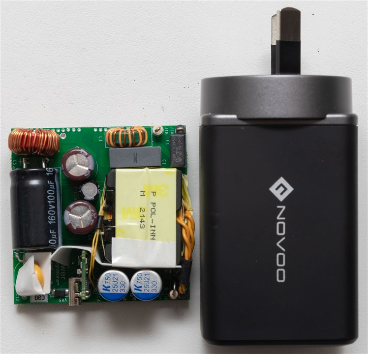

This brings on the obvious question – is it small compared to current market products? Well, here’s a comparison with an (unreviewed) Novoo 67W GaN charger.
In terms of footprint, the RDR-928 is a little larger.
But vertical height is shorter on the RDR-928 so volume is probably somewhat similar although the Novoo does have three ports. As a result, it would seem the RDR-928 is a competitive design for size, even though the report and PCB seems to date this design back to 2021.

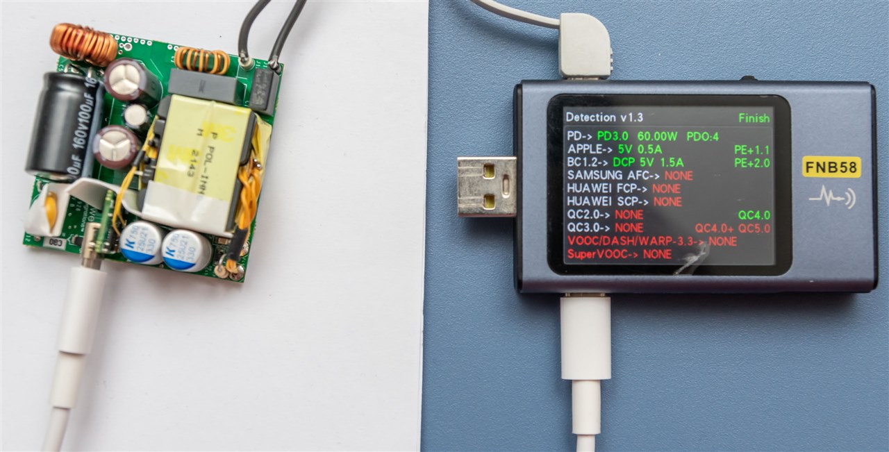

Testing of USB-C output modes was performed using the Fnirsi FNB58.
The RDR-928 appears to support USB-C PD 3.0 at 60W (as claimed) with four PDOs. Aside from this, it does not appear to support Apple fast-charging (hence 0.5A indicated) but does appear as a USB battery charging standard dedicated charging port of 1.5A. Most of the other legacy fast-charging protocols are not supported. Support for QC 4.0 is indicated as it overlaps with USB-C PD, as does PumpExpress.
The four supported PDOs are 5V, 9V, 15V and 20V, all at 3A. No support for PPS is available, unfortunately, which will mean that some smartphones will not achieve the fastest-and-coolest charging possible.
This may seem somewhat narrow in terms of compatibility compared to third-party chargers which can often support a majority of the displayed protocols, however, it is my understanding that USB-C PD compliant supplies are discouraged from supporting such legacy and proprietary protocols to avoid ambiguity and compatibility problems. As a result, this reference design isn’t doing anything wrong – check a branded laptop USB-C adapter and you’ll find the same. But for an end-consumer that might expect a single power supply to fast-charge anything (even through an adapter), this is perhaps not the friendliest configuration.

Measurements were made by scripted control of the instruments using pyvisa. Specifically, the test stepped through the load at 1mA increments until the output voltage fell below the requested voltage by at least 2V to capture over-current protection threshold. At each increment, a total of 32 readings are taken from both power analyser and load, and averaged, to reduce noise in the output curves. This test is repeated at each of the output voltages offered by the power supply. The recorded data is analysed in Excel and the self-consumption of the decoy board is compensated for.
Note that this setup contains exposed live connections at mains voltage and must not be touched while energised! I did consider enclosing the power supply while testing it, however, decided against this as it would potentially affect the thermal performance of the solution and make thermal imaging impossible. I do acknowledge that practical power supplies sold to consumers will be in a suitable enclosure, however, the RDR is set-up in a way that isn’t entirely practical as a product either so I didn’t feel too bad about this (e.g. no mounting points, USB-C port on a mezzanine board that doesn’t feel durable enough for rough handling, no power inlet jack or interface to pins).

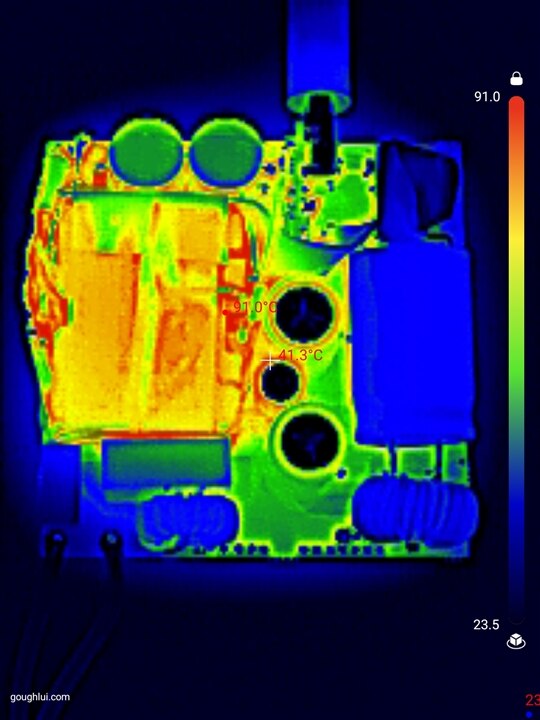

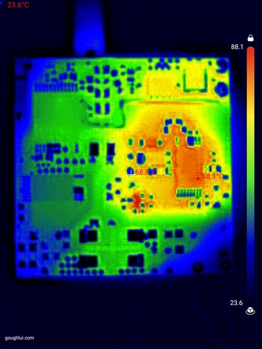

Thermally, the board did get somewhat toasty – the top side measured a peak of 91 degrees C via Topdon TS001 thermal imaging camera using the default 0.95 emissivity value. This appears to be near the middle of the board, specifically at the transformer. Perhaps winding and magnetics losses are responsible for this – after all, that transformer has been minimised in terms of size!
Looking at the chips at the underside, most of them are comparably “cool as a cucumber”, with the exception of the main Innoswitch4-CZ which is doing the hard work and on the underside of the transformer. Peak temperature is 88.1 degrees Celsius on the chip itself.

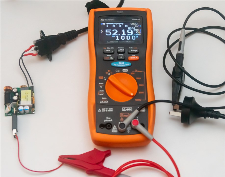

Insulation resistance was tested across primary to secondary using a Keysight U1461 Insulation Resistance Testing Multimeter. A test voltage of 1000V DC was used and a special adapter connected to all power and USB 2.0 data pins on the USB-C connector.
A measurement of 52Gohms was achieved, which is more than sufficiently high for electrical safety. In fact, this reading may be due to leakage in cables or internal to the meter (as I had repaired the OLED display in the past and potentially contamination could have gotten inside), so I wouldn’t consider the fact it isn’t reading off-scale (>200Gohm) to be a defect.

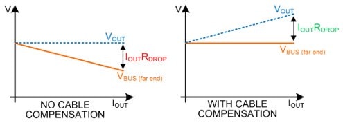

  • Indeed, negative internal resistance in practice can be useful as there is no "far end sensing" wires in a USB cable.
    However, too much negative internal resistance can lead to thick and short leads producing over-voltage when at high loads ... so usually the compensation is conservative. Some chargers I've encountered have a bit of a split - negative internal resistance only kicks in above a certain current level resulting in a voltage "knee" rather than a straight line. This might help some devices that rely on voltage drops to detect the source limit to settle on a higher charging current.
    A charger may just seem to be a simple device, but there's definitely some differences in the way they are implemented.

  • Very true, although I hope they would have opted for a better solution than a slot in PCB that has solder flowed from pad to pad. The mechanical support feels a bit lacking and the forces are directly transmitted.
    Even just using solid angled pins can provide some strain relief. Better yet, a ribbon, wire or connector of sorts may give more accommodation too. People can trip on cables, yank them out or shove them in without much care and you'd rather not have that force act on just solder alone.

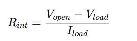

  • This is what chatGPT says: "what is the computed resistance of a power supply?"
    The computed resistance of a power supply typically refers to its internal resistance, which affects voltage regulation and power delivery.
    How to Compute Internal Resistance of a Power Supply:
    1. Using Voltage and Current Measurements
      The internal resistance Rint can be estimated using Ohm's Law:
      where:
      • Vopen = Open-circuit voltage (no load connected)
      • Vload= Voltage when a known load is connected
      • Iload = Current drawn by the load
    2. Using the Thevenin Equivalent Model
      A power supply can be modeled as an ideal voltage source Vs in series with an internal resistance Rint. If the voltage drops under load, you can calculate Rint as shown above.
    3. Typical Values
      • Ideal power supply: Rint=0 Ω (no voltage drop)
      • Real power supplies: Typically range from milliohms (high-quality) to a few ohms (poor regulation)
