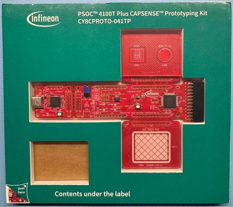

The evaluation started with the unboxing of the CY8CPROTO-041TP PSoCTm 4100T Plus CAPSENSETm Prototyping Kit.
The packaging is compact and well protected, ensuring that the development board and accessories arrive in good condition. The first inspection revealed a clean and carefully packaged kit containing the development board and the required USB-C cable for immediate operation.

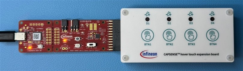

Following the CY8CPROTO-041TP PSoCTm 4100T Plus CAPSENSETm Prototyping Kit Guide, the kit was powered using the provided USB-C cable to run the pre-programmed Out-of-Box example CE240380.
The experience of running the example firmware was immediately positive. The demonstration starts automatically after powering the board, with the LEDs reacting to the capacitive sensing inputs. The behaviour is intuitive and encourages curiosity about the internal implementation and potential integration into real projects.

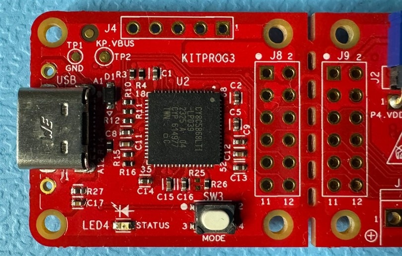

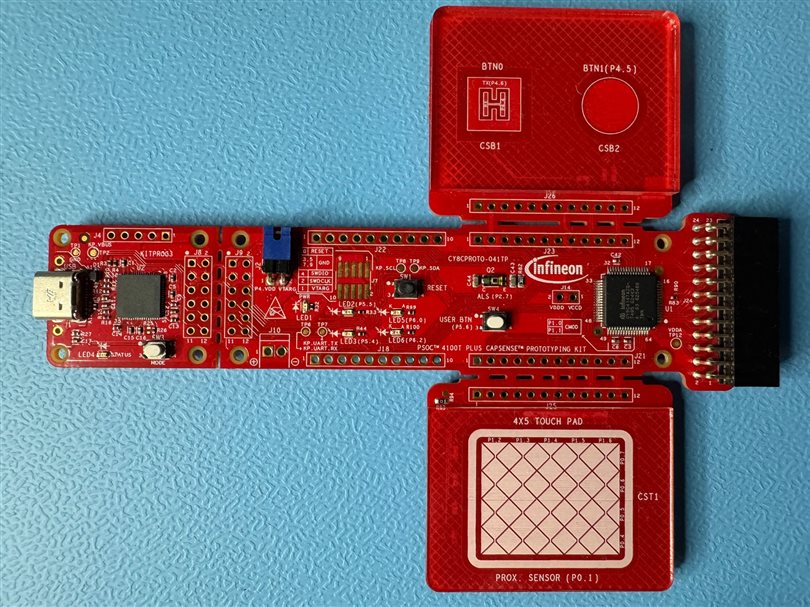

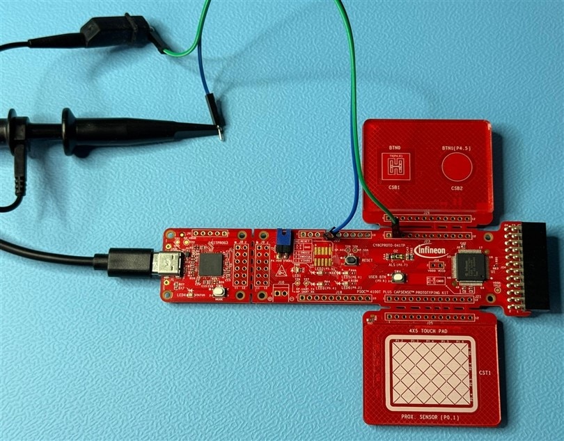

Figure 4 : PCB overview
The PCB layout is clean and well organized. Component placement follows a consistent orientation, and the silkscreen markings are clear and readable, which makes component identification easy during inspection and debugging.
Pin headers are easily accessible and sufficiently separated from other components, facilitating the connection of external circuits during prototyping.

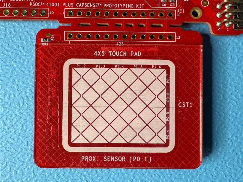

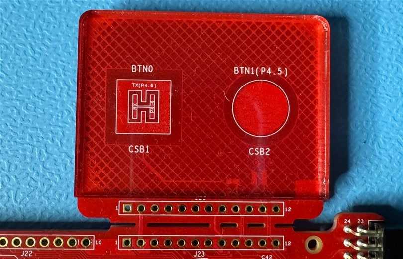

Figure 5 : Capacitive touchpad and proximity sensor
Figure 6 : Capacitive buttons area
A particularly interesting aspect of the board design is its modular layout. The MCU section, sensing modules, and programmer are integrated in a way that suggests that the main MCU board could potentially be separated if required, allowing developers to reuse only the necessary section in a custom prototype.
Figure 7 : USB-C connector and onboard programmer

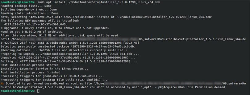

Since the development machine runs Linux, the .deb installation package was downloaded and installed following the instructions provided in the official documentation.
Figure 8 : ModusToolbox installation process
Installation was performed using:
sudo apt install ./ModusToolboxSetupInstaller_1.5.0.<build>_linux_x64.deb

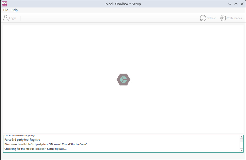

After launching the ModusToolbox Setup utility, the installer guided the process of selecting and installing the required toolchains and software components.
Figure 9 : ModusToolbox Setup initial screen
Figure 10 : Package selection screen
Figure 11 : Package installation progress
During installation, the Setup Tool reported a crash while installing the Programming Tools package. However, further inspection confirmed that the required binaries were successfully installed under:
/opt/Tools/ModusToolboxProgtools-1.7/
This suggests that the installer reported an ambiguous status rather than an actual installation failure.

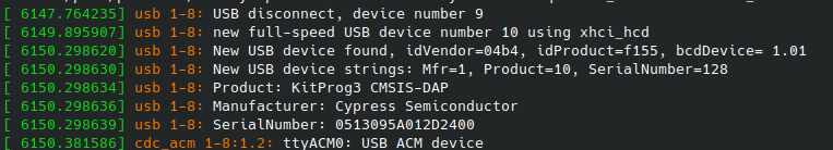

Once the installation was completed, the kit was connected to the system. The board was automatically recognized by Linux as a KitProg3 CMSIS-DAP debugging interface.
Figure 12 : USB device detection using lsusb
USB enumeration confirmed the device with:
Vendor ID: 04b4
Product ID: f155
Figure 13 : Kernel detection using dmesg
Kernel messages confirmed the successful detection of the device and the creation of a USB CDC serial interface:
usb 1-8: New USB device found, idVendor=04b4, idProduct=f155
Product: KitProg3 CMSIS-DAP
Manufacturer: Cypress Semiconductor
cdc_acm 1-8:1.2: ttyACM0: USB ACM device
Figure 14 : Serial interface exposed as /dev/ttyACM0
The presence of the /dev/ttyACM0 device confirms that the onboard programmer and serial communication interface are functioning correctly, allowing both firmware programming and runtime communication with the board.

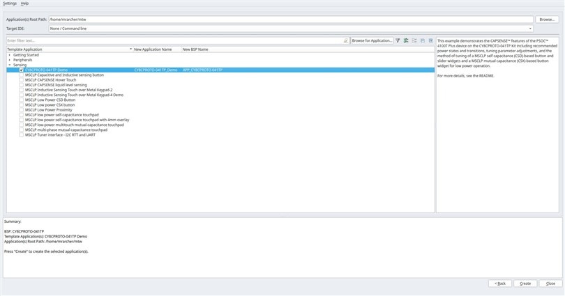

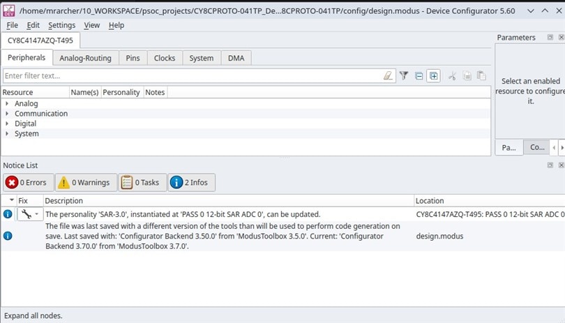

3.1 Creating a ModusToolbox Project
To evaluate the CAPSENSE functionality in more detail, a new project was created using the ModusToolbox Project Creator utility.
Figure 15 : Launching the Project Creator tool from the terminal

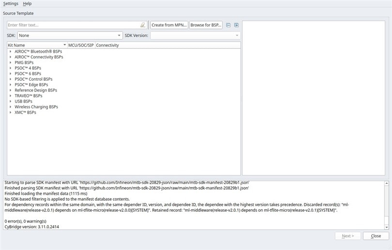

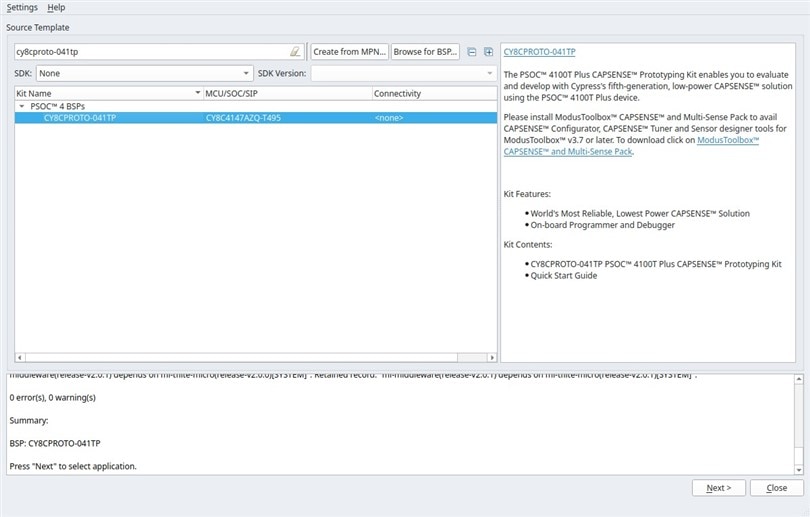

The Project Creator graphical interface allows selecting the target board and example firmware.
Figure 16 : ModusToolbox Project Creator interface
The CY8CPROTO-041TP board was selected as the hardware platform.
Figure 17 : Board selection inside the Project Creator
The example project corresponding to the board demonstration firmware was then selected.
Figure 18 : Selecting the CY8CPROTO-041TP demonstration project

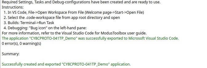

The tool generated the workspace and project files required for development.
Figure 19 : Project creation log

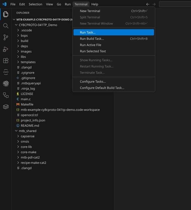

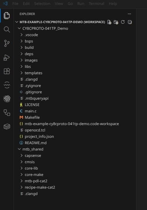

3.2 Opening the Project in Visual Studio Code
The generated project workspace was opened in Visual Studio Code, which is the default development environment used by ModusToolbox.
Figure 20 : Opening the ModusToolbox workspace in Visual Studio Code

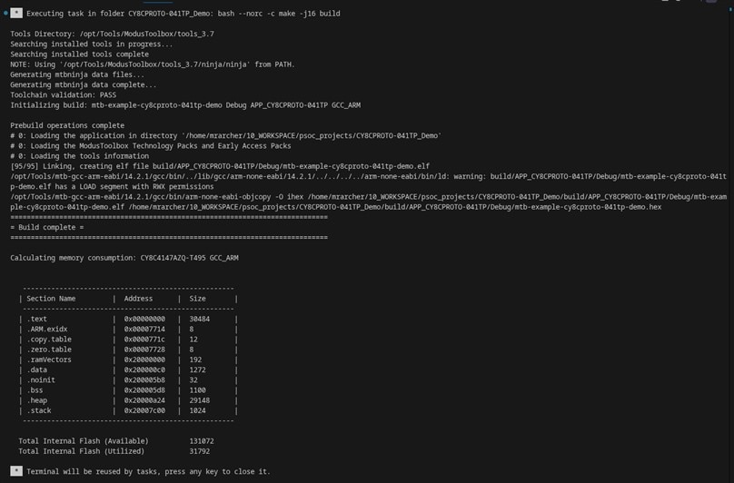

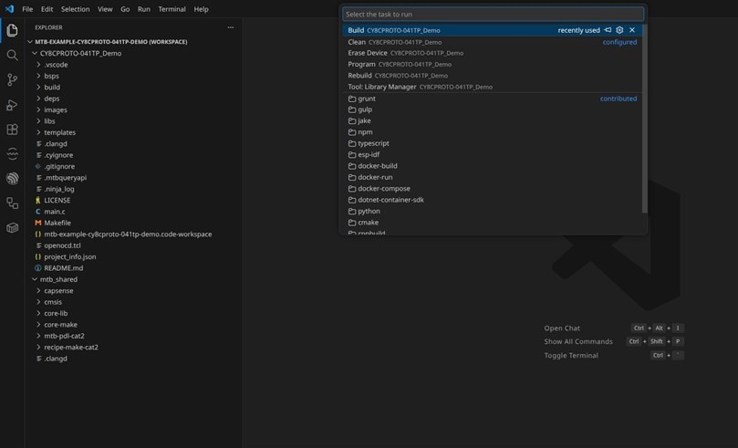

3.3 Building the Firmware

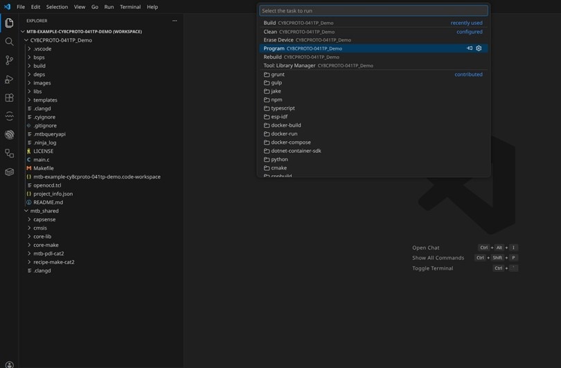

The firmware was compiled using the integrated ModusToolbox build system.
Figure 21 : Selecting the build command
Figure 22 : Compilation command executed by the build system
Figure 23 : Firmware compilation log

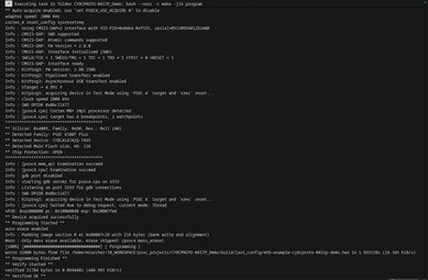

After compilation, the firmware was programmed to the board using the onboard KitProg3 debugger.
Figure 24 : Programming command executed from the development environment
The programming process detected the target device correctly as CY8C4147AZQ-T495, belonging to the PSoC 4100T Plus family.
Figure 25 : Programming log showing device detection and flashing process
The flashing process completed successfully and the firmware verification step confirmed the correct upload.

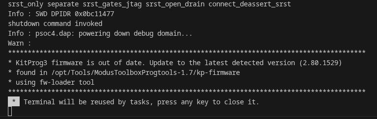

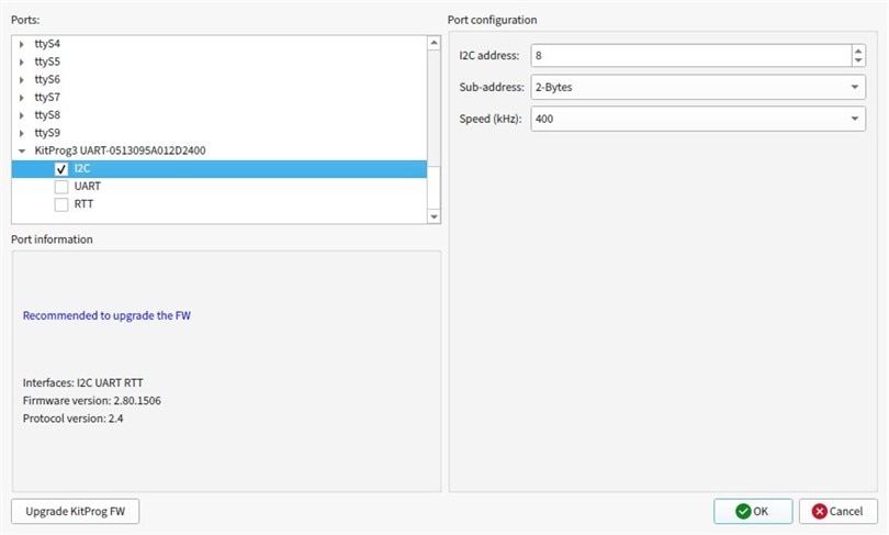

During the programming process, the tool also reported that the onboard KitProg3 firmware was not at the latest available version and suggested an update using the fw-loader utility.
However, this did not prevent device detection, flashing or verification. For the purposes of this evaluation step, no programmer firmware update was required, since the complete programming flow executed successfully.
This warning is worth noting for completeness, but it had no practical impact on the evaluation.

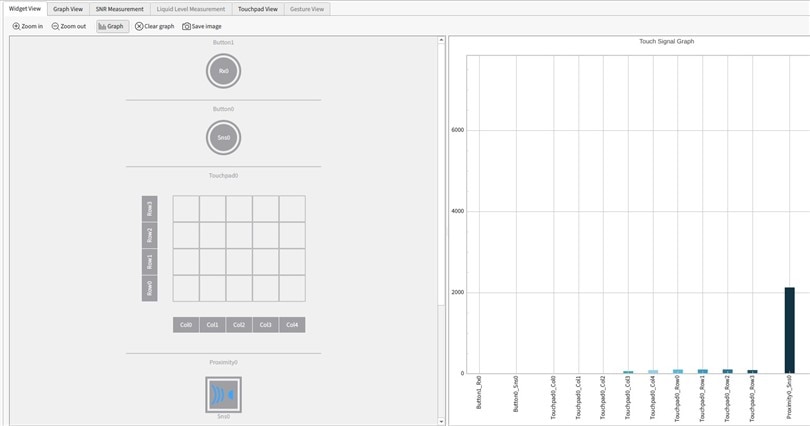

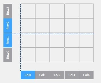

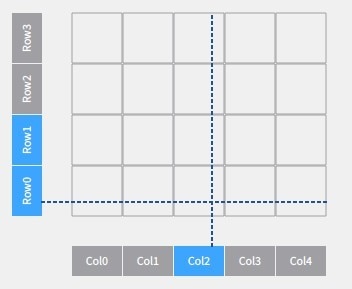

4. Capacitive Sensing Implementation

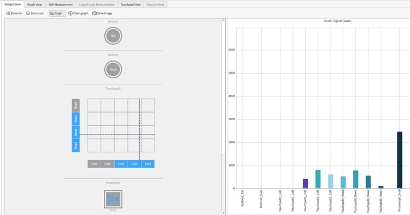

The CY8CPROTO-041TP kit integrates two capacitive sensing interfaces directly on the PCB: a touchpad and a proximity sensor. Both are exercised by the factory demonstration firmware and represent the core human-machine interaction features evaluated in this stage of the RoadTest.
The first objective of this step was to verify the practical behaviour of these sensing elements under normal indoor conditions. The second objective was to inspect the project structure, configuration and application code provided by Infineon in order to understand how these sensing functions are implemented within the ModusToolbox environment.
4.1 Functional Evaluation of the Capacitive Sensors

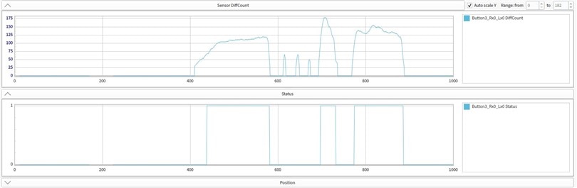

Several simple repeatability tests were carried out using the pre-programmed demonstration firmware.
Touchpad Test
Number of attempts: 50
Metric Result
Correct detections 50
False triggers 0
Missed inputs 0
The touchpad responded reliably during all attempts, with no missed activations and no unintended triggers observed during the test sequence. Directional interaction was immediate and intuitive, making the interface easy to understand even without prior knowledge of the firmware implementation.
Proximity Sensor Test
Metric Result
False triggers 0
Approximate detection distance ~2.4 cm
The proximity sensing area consistently detected the presence of a hand within the expected range. Detection remained stable and predictable throughout the measurement sequence, with no spurious activations recorded during the test.
Stability Test
To evaluate robustness over time, the system was left running for a 15-minute observation period.
During this period:
  • no false triggers were observed
  • no missed detections were observed during repeated interaction
  • the demo remained stable without visible drift or erratic behaviour
These results suggest that the capacitive sensing implementation used in the demonstration firmware is robust and appropriately calibrated for normal indoor operation.
4.2 Sensor Behaviour and User Interaction
The touchpad exhibited immediate response to finger contact and released detection as soon as the finger was removed. No noticeable latency or hysteresis was observed during use.

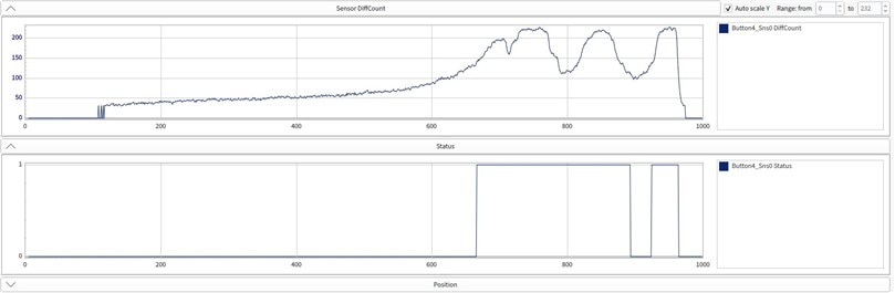

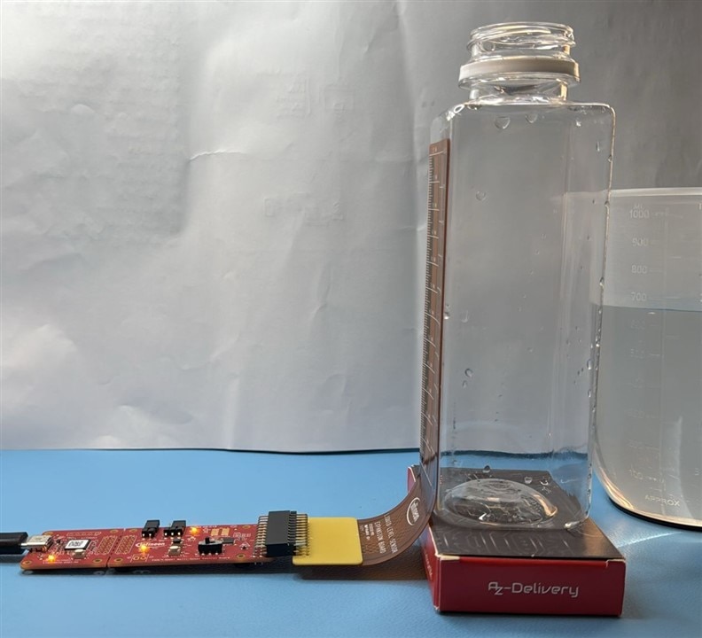

The proximity sensor detected a hand at approximately 2–3 cm above the sensing area. In practical terms, this produced a responsive but controlled interaction zone, which is suitable for simple contactless interaction.

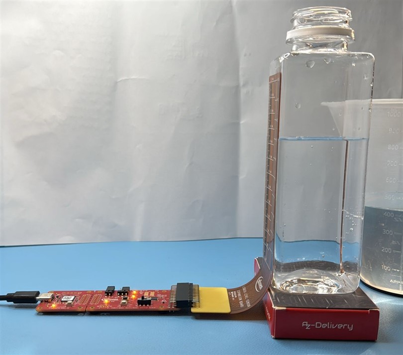

An important practical observation during the evaluation was that the proximity sensor could remain active when the board was placed directly on a table surface. This behaviour is consistent with the operating principle of capacitive sensing, since nearby materials and mounting conditions can affect the electric field around the sensing electrode.
Rather than being a defect of the kit, this is a useful real-world demonstration of an important design consideration: capacitive sensors must always be evaluated together with their mechanical placement, surrounding materials and enclosure geometry.
For final applications, this means that proximity performance should not be judged only from firmware parameters, but also from the intended mounting environment.

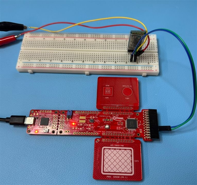

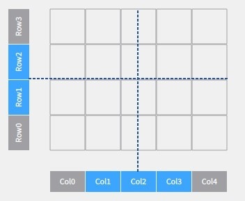

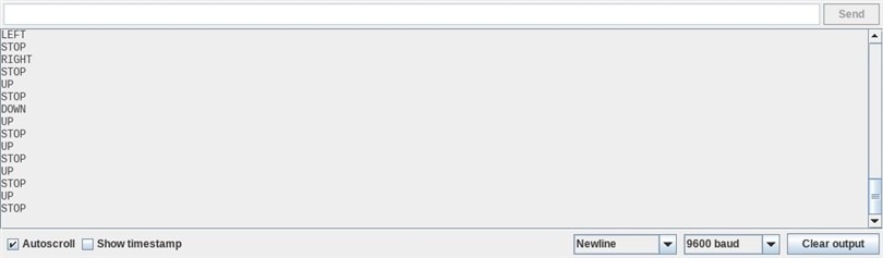

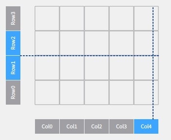

4.3 Conceptual Input Mapping for Later Integration
For the next stage of the review, a conceptual mapping was defined to translate capacitive inputs into robot-control actions.
Sensor Input Control Command Intended Action
Touchpad Up Forward Move robot forward
Touchpad Down Backward Move robot backward
Touchpad Left Turn Left Rotate robot left
Touchpad Right Turn Right Rotate robot right
Proximity Sensor Speed control Increase speed when the hand approaches
This mapping has not yet been implemented in custom firmware, but it provides a simple and intuitive basis for the robotic integration stage of the evaluation.

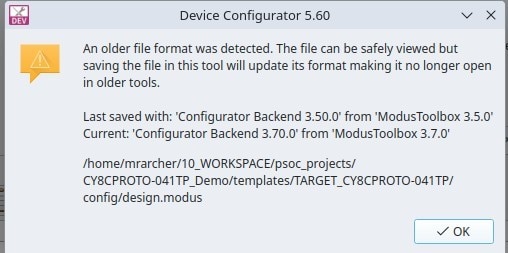

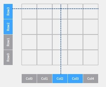

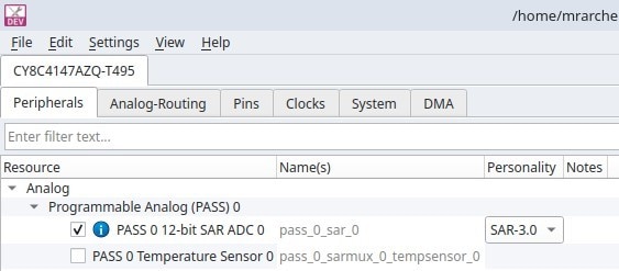

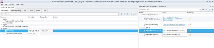

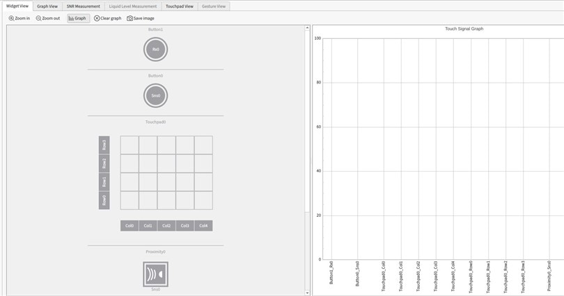

4.4 CAPSENSE Configuration Overview
To better understand the sensor implementation, the provided project configuration was inspected within the ModusToolbox-generated design files.
The project defines a dedicated capacitive sensing subsystem that includes:
  • a matrix touchpad
  • a proximity sensing channel
  • multiple sensor nodes and associated routing resources
  • dedicated capacitive sensing hardware support within the device
Inspection of the design configuration confirmed that the touchpad is implemented as a matrix structure with multiple rows and columns, while the proximity function is implemented as a dedicated sensor node. The design file explicitly defines signals such as:
  • Touchpad0_Row0 to Touchpad0_Row3
  • Touchpad0_Col0 to Touchpad0_Col4
  • Proximity0_Sns0
These definitions are fully consistent with the behaviour observed during functional testing.
Key characteristics observed from the configuration are summarized below:
Parameter Description
Sensor type Self-capacitance based sensing structure
Scan method Dedicated hardware-assisted capacitive scanning
Widgets / sensor groups Touchpad + Proximity
Signal routing Explicit row/column and sensor-node assignment in the design
Integration Native support within the PSoC hardware and ModusToolbox flow
The use of hardware-assisted capacitive scanning reduces software overhead and helps maintain reliable operation even when multiple sensing elements are present.

5.1 Accessing the CAPSENSE Configuration
Within the ModusToolbox environment, the CAPSENSE subsystem appears under the System configuration panel.
Figure 27 : CAPSENSE configuration within the Device Configurator
The configuration interface exposes both the CAPSENSE Configurator and the CAPSENSE Tuner, which are used respectively for sensor configuration and real-time signal analysis.
Additional inspection of the device configurator also reveals the presence of the analog subsystem used by the capacitive sensing hardware.
Figure 28 : Analog subsystem related to the CAPSENSE hardware
The CAPSENSE subsystem itself is visible as a dedicated configuration block.
Figure 29 : CAPSENSE subsystem inside the device configuration

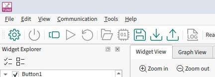

5.2 Establishing Communication with the CAPSENSE Tuner
When the CAPSENSE Tuner is launched for the first time, communication parameters must be configured before connecting to the device.
Figure 30 : CAPSENSE Tuner communication configuration
During initial testing, the connection briefly reported a successful link before a timeout occurred.
Figure 31 : Initial CAPSENSE Tuner timeout during connection
Further inspection of the firmware revealed the reason for this behaviour. The example firmware does not use UART for tuner communication, but instead exposes the CAPSENSE data structure through the SCB peripheral configured in EZI2C mode.
This can be observed directly in the application source code:
Cy_SCB_EZI2C_Init(CYBSP_EZI2C_HW, &CYBSP_EZI2C_config, &ezi2c_context);
Cy_SCB_EZI2C_SetBuffer1(CYBSP_EZI2C_HW,
                        (uint8_t *)&cy_capsense_tuner,
                        sizeof(cy_capsense_tuner),
                        &ezi2c_context);
Listing 3 – EZI2C-based CAPSENSE Tuner communication configuration
These calls configure the SCB peripheral as an I²C slave interface, exposing the CAPSENSE tuner data structure (cy_capsense_tuner) to external tools.
In this architecture, the KitProg3 programmer acts as a USB-to-I²C bridge, allowing the CAPSENSE Tuner application to read sensor data directly from the device memory.
The communication path can therefore be summarized as:
Figure 32 : Communication path diagram in the CAPSENSE Tuner
Once the correct communication settings were selected, the tuner connected successfully to the board.
Figure 33 : Successful connection between CAPSENSE Tuner and the board
5.3 Visualizing CAPSENSE Widgets
After connecting, the CAPSENSE Tuner displays the available widgets defined in the project.
Figure 34 : CAPSENSE widgets detected by the tuner
The example project exposes several sensing elements, including:
  • Touchpad widget
  • Proximity sensor widget
  • Capacitive buttons
The tool allows observation of raw sensor data, baseline values and processed signals in real time.
5.4 Touchpad Signal Behaviour
When interacting with the touchpad, the tuner shows the positional widget response and signal variation.
Figure 35 : Touchpad activity observed in the CAPSENSE Tuner
Note: The X-axis position reported by the touchpad is inverted with respect to the physical left-to-right orientation of the printed text on the board. For example, touching the right-hand side of the touchpad corresponds to a low X-column index in the widget view.
The tuner confirms that the touchpad is implemented as a positional widget, reporting X and Y coordinates corresponding to the touch location.
This behaviour matches the firmware implementation, which retrieves positional information through:
Cy_CapSense_GetTouchInfo(CY_CAPSENSE_TOUCHPAD0_WDGT_ID, &cy_capsense_context);
Listing 4 – CAPSENSE touchpad information retrieval using Cy_CapSense_GetTouchInfo()
The positional data is then used by the firmware to modulate LED brightness according to touch position.

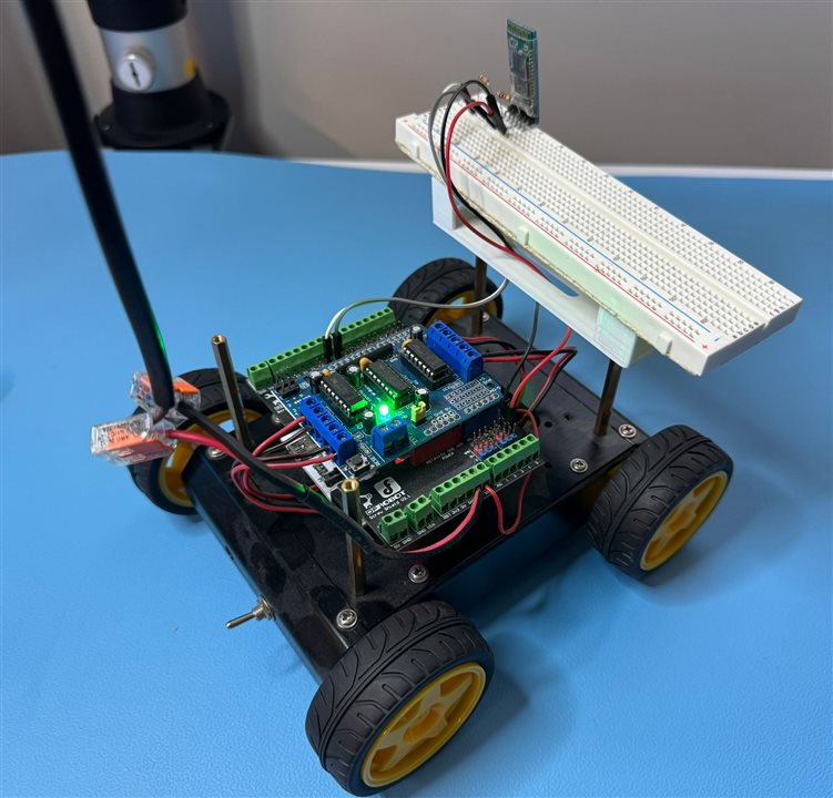

In order to evaluate the CAPSENSE interface in a practical scenario, a small robotic control platform was used as the target system.
Before introducing the capacitive interface, an existing control architecture based on a traditional digital joystick was used as the reference implementation. This baseline system provides a working communication pipeline between a human input device and the robot controller.
The objective of the next stage is therefore not to design a completely new control system, but rather to replace the joystick input stage with the capacitive sensing interface provided by the PSoCTm kit.

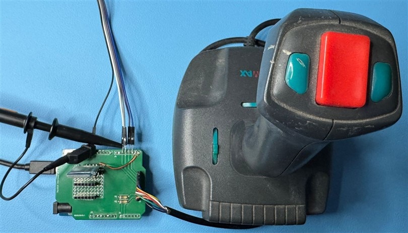

6.4 Hardware Test Setup
To verify correct operation of the communication system, the joystick controller was instrumented using external measurement tools.
The setup included:
  • an Arduino Leonardo acting as the joystick controller
  • a Bluetooth module connected through UART
  • an oscilloscope used for signal verification
Figure 38 : Digital joystick controller connected to measurement instruments
This setup allowed direct observation of the digital signals generated by the controller while interacting with the joystick.

6.5.1 UART Activity Verification
During testing, the transmitted commands were monitored through the serial interface.
Figure 40 : UART output showing transmitted movement commands
Each directional input generates a corresponding command (UP, DOWN, LEFT, RIGHT) followed by a STOP message when the joystick button is released.
The observed sequence confirms correct operation of the firmware state machine and proper serial communication between the controller and the robot platform.

6.6.2 Experimental Setup and Instrumentation
The intended architecture for the migration was to keep the same command path previously used by the joystick controller, replacing only the human input device with the CAPSENSE touchpad.
In that target configuration, the CY8CPROTO-041TP kit would generate the same motion commands as the joystick subsystem and forward them to the rest of the robotic platform without requiring changes in the downstream control chain.
However, in this evaluation, the validation was simplified at firmware level. Instead of completing the full UART/Bluetooth integration, the processed touchpad output was observed on an instrumented LED control pin already available on the board.
This approach made it possible to validate the most critical part of the migration: the conversion of touch interaction into discrete control states. Since the Bluetooth bridge and robot-side command handling remain unchanged from the baseline implementation, confirming correct command generation at the PSoC output stage is sufficient to evaluate the feasibility of the migration.
Figure 45 : Experimental setup used for CAPSENSE integration tests
Figure 46 : Instrumented LED-related output used for oscilloscope observation

The CAPSENSE touchpad provides a two-dimensional input surface whose position coordinates can be interpreted as directional commands.
The firmware reads the touch position (X,Y) reported by the CAPSENSE touchpad widget and converts it into discrete directional states by dividing the touch surface into four regions.
The following mapping was implemented:
Touchpad Region Command Robot Action
Upper area UP Move robot forward
Lower area DOWN Move robot backward
Left area LEFT Rotate robot left
Right area RIGHT Rotate robot right
No touch STOP Stop robot
This mapping allowed the touchpad to behave similarly to the previous digital joystick interface.

6.6.6 Signal Measurement and Validation
To validate the correct operation of the CAPSENSE interface, a series of functional checks were performed.
First, the touchpad behaviour was verified using the CAPSENSE Tuner tool to confirm that the widget correctly detected finger position across the sensing surface.
Once correct touch detection was confirmed, the firmware output corresponding to each directional command was observed using an oscilloscope connected to the instrumented LED output pin.
The following checks were performed:
  1. Verify that the touchpad correctly detects finger presence and position.
  2. Confirm that each directional region generates the expected command state.
  3. Observe the resulting PWM output level associated with each direction.
  4. Confirm that the idle state (no touch) generates the STOP condition.
These measurements allow the internal firmware decisions to be externally verified, ensuring that the capacitive interface produces consistent and reproducible control signals.
6.6.7 Experimental Results and Discussion
The experimental results confirmed that the CAPSENSE touchpad could successfully reproduce the directional behaviour of the original mechanical joystick.
The oscilloscope measurements show clearly distinguishable output levels corresponding to each directional command. These levels match the PWM encoding implemented in the firmware and provide a clear electrical representation of the detected touch direction.
Observations made with the CAPSENSE Tuner also confirm stable detection of finger position across the touchpad surface, allowing reliable classification of directional inputs.
Compared to the mechanical joystick, the capacitive interface offers several advantages:
  • elimination of mechanical wear
  • simplified hardware interface
  • sealed interaction surface
  • flexible interpretation of user gestures
Because the command protocol remains unchanged, the robotic platform can interpret the generated commands exactly as in the original joystick implementation. This demonstrates that the CAPSENSE touchpad can act as a drop-in replacement for traditional mechanical input devices in embedded control systems.
This result confirms that capacitive sensing is not only a viable alternative to mechanical inputs, but also provides additional flexibility in interface design without increasing system complexity. In addition, the absence of mechanical components eliminates switch wear and simplifies long-term reliability considerations.
The following figures show the processed CAPSENSE output signal observed on the LED pin for the idle state and the four directional positions.
Figure 47 : CAPSENSE signal rise edge
Figure 48 : CAPSENSE signal rise time
Figure 49 : CAPSENSE signal amplitude
Center position:
Figure 50 : CAPSENSE widget center position detected
Figure 51 : CAPSENSE center position PWM value observed in the oscilloscope

6.7 UART Integration and Bluetooth Command Transmission
In order to replace the mechanical joystick with a capacitive interface, the PSoC firmware was extended to support UART-based command transmission over a Bluetooth serial link.
Figure 60 : PSoC CAPSENSE kit with Bluetooth module connected for UART communication
In the initial validation stage, directional information was encoded as PWM signals and observed using an oscilloscope. While this approach was useful for early verification, it was not suitable for direct integration with the robotic platform.
To address this, one of the SCB peripherals was configured in UART mode (9600 baud), enabling direct transmission of control commands. The CAPSENSE touchpad position is processed in real time to determine the dominant movement direction based on displacement from the center. A dead zone was introduced to prevent noise and unintended movements.
The detected direction is mapped to textual commands:
  • UP
  • DOWN
  • LEFT
  • RIGHT
  • STOP
Note: The LEFT and RIGHT commands are included for compatibility with a different robotic platform featuring omnidirectional (holonomic) wheels. However, for the purposes of this validation, a standard differential-drive robot with forward and backward motion was sufficient to demonstrate the system functionality.
To optimize communication efficiency, commands are transmitted only when a change in direction is detected, implementing a lightweight state-machine approach. This minimizes UART traffic while maintaining responsiveness.
The UART output is connected to a Bluetooth serial module, enabling wireless communication with the robot controller. This design preserves compatibility with the original command protocol used by the joystick-based system.
6.8 System Integration and Robot Control
Figure 61 : 4WD robot platform with Arduino motor shield and Bluetooth module
On the receiver side, the Arduino-based robot controller was already implemented.
The system was originally designed to operate with a simple command interface (UP, DOWN, etc.), independent of the input device used to generate those commands.
By implementing the CAPSENSE interface on the PSoC side and adhering strictly to the same communication protocol, the integration was effectively plug-and-play. The robot responded immediately to the new input method without requiring any modifications to the existing control firmware.
This demonstrates a clean separation between the input layer and the control logic, enabling seamless substitution of the original mechanical joystick with the capacitive touch interface.

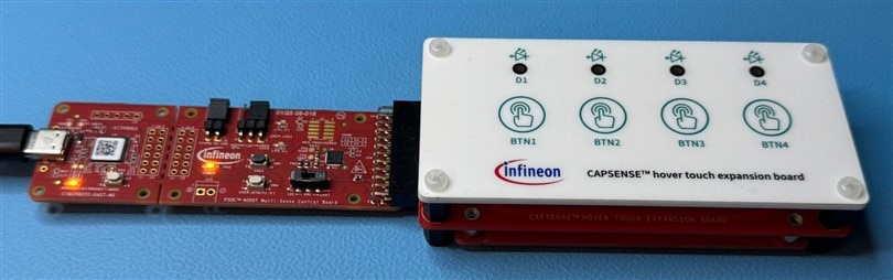

7.1 Hover Sensing Demonstration
Hover sensing extends capacitive touch detection by enabling the system to detect a finger without direct contact with the sensing surface.
Instead of requiring a physical touch event, the sensor reacts to variations in the electric field produced by a nearby object such as a hand.
7.1.1 Experimental Setup
The hover sensing experiment was performed using the MSCLP CAPSENSE Hover Touch example provided within the ModusToolbox environment, targeting the CY8CPROTO-040T-MS board with the CAPSENSETm hover expansion board attached.
The sensor was configured as a high-sensitivity proximity channel, using the default tuning parameters provided by the example project.
Figure 63 : Hover sensing experimental setup
Figure 64 : Hover sensing experimental setup (alternate view)
The sensing surface was left without additional shielding or enclosure in order to evaluate the raw behaviour under typical laboratory conditions.
7.1.2 Observed Behaviour
During testing, the sensor detected the presence of a hand at a distance of approximately 4–5 cm from the sensing surface.
However, the observed behaviour differed from an ideal continuous proximity sensor. Instead of a fully linear or gradual response, the system exhibited a threshold-based detection profile.
At distances near the detection limit, the output was unstable, with intermittent transitions between detected and non-detected states. Small variations in hand position or orientation produced noticeable changes in the signal.
As the hand moved closer to the sensor (~2–3 cm), the signal amplitude increased significantly and detection became stable, maintaining a continuous active state without flickering.
Figure 65 : Threshold-based hover detection behaviour observed in the CAPSENSE Tuner
When direct contact was made with the plastic overlay of the expansion board, the sensor exhibited a strong and stable response with a high signal level and continuous detection.
This confirms effective capacitive coupling through the dielectric layer, enabling reliable touch-through-overlay operation.

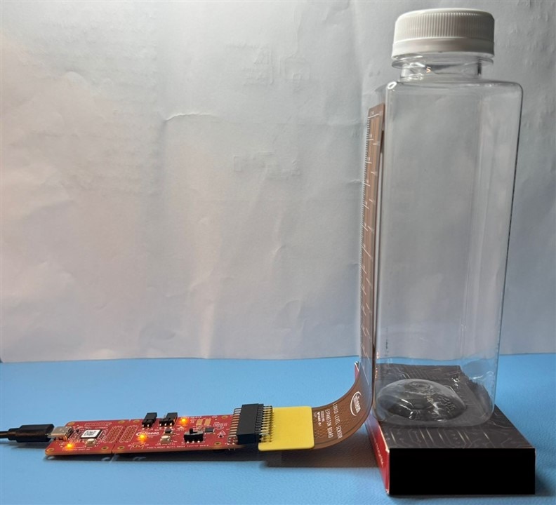

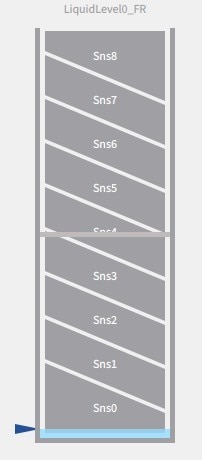

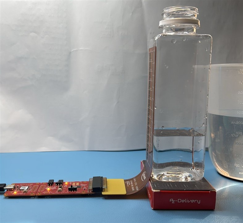

7.2 Liquid Level Sensing Demonstration
Capacitive sensing can also be applied to liquid level detection, leveraging the variation in dielectric properties when a liquid is present near the sensing electrode.
Unlike touch sensing, where a conductive object directly perturbs the electric field, liquid sensing relies on gradual changes in permittivity, enabling continuous measurement rather than binary detection.
7.2.1 Experimental Setup

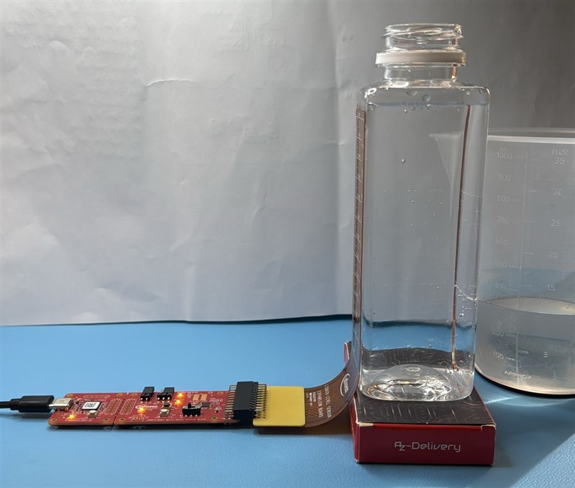

The experiment was performed using the CAPSENSETm hover touch expansion board configured in liquid level sensing mode.
A plastic container filled with water was positioned adjacent to the sensing electrode, ensuring no direct electrical contact between the sensor and the liquid.
The system was calibrated using empty and full reference points to enable proper level estimation.
Figure 66 : Liquid level sensing experimental setup
Calibration Procedure
Liquid level sensing requires an explicit calibration step to define the measurement range.
This was performed using the built-in calibration wizard available in the CAPSENSETm Tuner under the Liquid Level Measurement tab.
The calibration process consisted of:
  • defining the empty condition (no liquid present)
  • defining the full condition (maximum liquid level)
The wizard automatically computed the normalization parameters, allowing the system to map the raw sensor response to a relative liquid level.
Without this calibration step, the system only provides raw signal variation and cannot estimate the actual liquid level.
7.2.2 Observed Behaviour
After calibration, the system provided a continuous and stable estimation of the liquid level.
To evaluate the behaviour, multiple measurements were taken at different fill levels.
Empty condition
Figure 67 : Empty container and corresponding CAPSENSE output
At empty state, only the lowest electrodes showed minimal response, and the system correctly reported a near-zero level.
Partial fill (~30%)
Figure 68 : Liquid level detection at approximately 30% fill
As the liquid level increased, the lower sensors became active, and the system estimated a proportional level. The response was smooth and continuous.
Intermediate fill (~65%)
Figure 69 : Liquid level detection at approximately 65% fill
At intermediate levels, a clear transition of active sensing regions was observed, with the system accurately tracking the liquid height.
Full condition
Figure 70 - Full container and corresponding CAPSENSETm output
At full level, most sensing electrodes were activated, and the system correctly reported maximum level.
Overall, the response was monotonic, continuous and repeatable, demonstrating that capacitive sensing can effectively reconstruct liquid level based on distributed electrode measurements.

  • firm contact or slight pressure resulted in stable activation
  • the signal amplitude increased notably under pressure, allowing reliable detection
The CAPSENSETm Tuner showed a clear transition from idle to active state when sufficient pressure was applied, with a stable DiffCount plateau and continuous status activation.
Figure 72 : Stable metal touch detection under applied pressure observed in the CAPSENSETm Tuner
These results confirm that metal touch sensing is feasible, but its performance is highly dependent on mechanical interaction and system tuning.

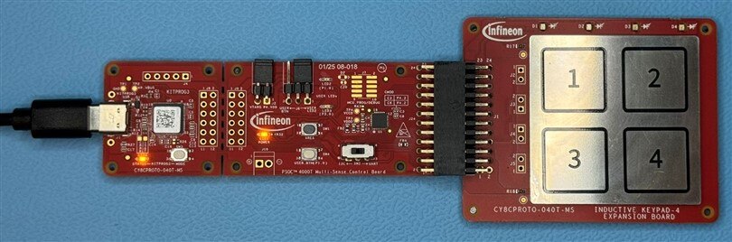

7.4 Summary of Expansion Demonstrations
The expansion sensing demonstrations illustrate how the CAPSENSE subsystem can be adapted to different sensing scenarios beyond simple button inputs.
Demonstration Observed behaviour Potential applications
Hover sensing Contactless detection at several centimetres distance Gesture interfaces, automatic activation
Liquid level sensing Continuous signal variation with liquid proximity Smart appliances, water tanks
Metal touch sensing Reliable detection through conductive panels Industrial and appliance interfaces
These experiments highlight an important aspect of capacitive sensing: the same underlying hardware can be adapted to multiple sensing modalities with minimal changes in configuration.
This flexibility makes the CAPSENSE subsystem particularly valuable for rapid prototyping, where different interaction concepts can be evaluated without redesigning the hardware platform.
These results confirm that the CAPSENSE hardware integrated in the CY8CPROTO-041TP kit provides a versatile and scalable foundation for advanced human-machine interfaces, supported by a well-integrated software and configuration ecosystem.

Feature Result
Boot time to visible demo activity <0.3 s
Touchpad detection accuracy 100% (50/50)
Proximity detection accuracy 100% (50/50)
False triggers during direct testing 0
Approximate proximity distance ~2.4 cm
Stability observation 15 min stable
Linux USB detection Automatic
Firmware programming Successful
Verification after programming Verified OK
From a practical perspective, the system demonstrates excellent responsiveness and stability, with immediate feedback and no observable drift during extended operation.
The capacitive sensing performance is particularly notable for its repeatability and immunity to false triggering under normal indoor conditions, which is often a challenge in capacitive-based interfaces.

  • ModusToolbox setup workflow under Linux can be initially confusing
  • Installation tool may report ambiguous status during package deployment
  • Learning curve exists for developers unfamiliar with CAPSENSE concepts
  • Capacitive sensing performance depends strongly on mechanical and environmental conditions
  • KitProg3 firmware update warning is not clearly contextualized within the workflow
