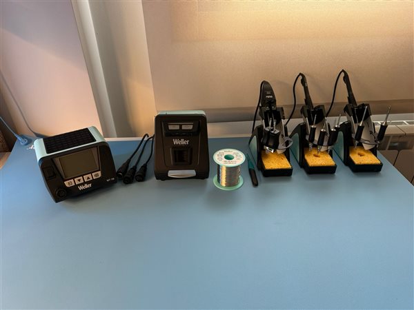

The Weller Micro Soldering Kit and ZeroSmog Guard arrived in two well-protected packages, with all components properly secured to prevent damage during transport.
Figure 1 – Received packages and initial contents overview

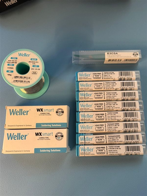

The soldering kit includes the WT1M station, multiple handpieces (micro, pico and tweezers), dedicated holders, an automatic tip cleaner, a selection of tips covering different geometries, solder wire, and small handling tools for fine components.
The filtration unit package includes the ZeroSmog Guard system together with all required accessories for workstation integration, including flexible hose, nozzle, and mounting elements.
Figure 2 – Included consumables and tip selection
From the beginning, the kit clearly reflects a complete and ready-to-use professional setup, rather than a minimal or entry-level configuration.

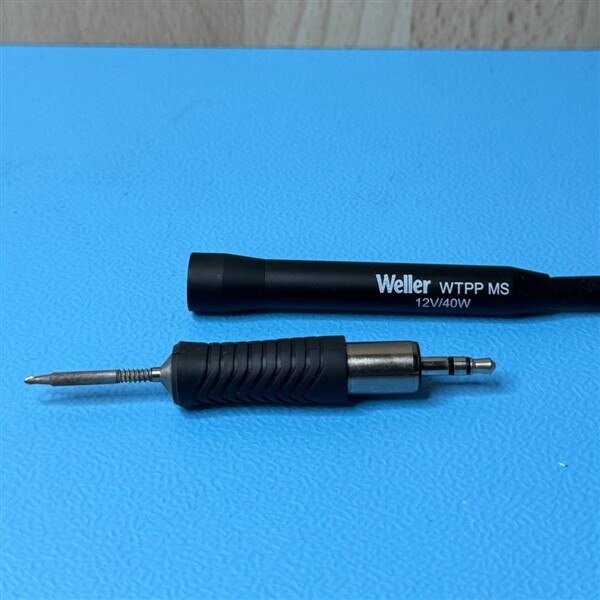

WTMP MS Micro handpiece General precision soldering
WTPP MS Pico handpiece Ultra-fine SMD work

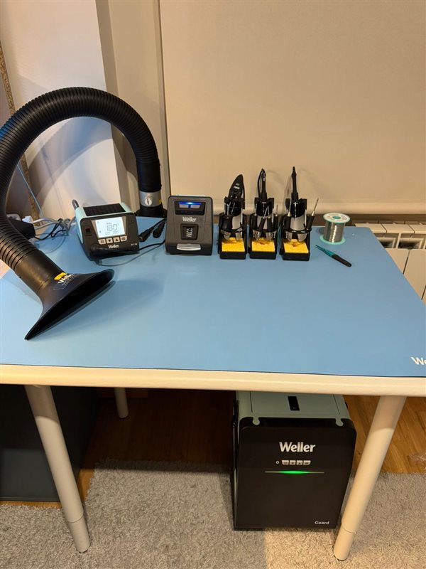

Once all components were unpacked, the full system was arranged on the workbench to evaluate footprint, layout, and ergonomics before powering on the units.
Figure 3 – Initial workbench setup before power-on
The WT station feels compact yet solid, with enough weight to remain stable during use.

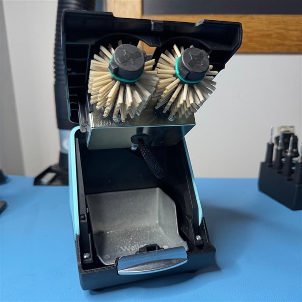

The tip cleaning unit integrates naturally into the setup, providing a more stable and practical solution compared to simple sponge-based cleaning.
The handpiece holders are well balanced and provide good clearance, which is especially useful when working with multiple tools or frequently changing tips.

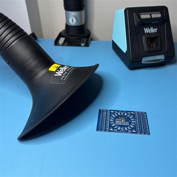

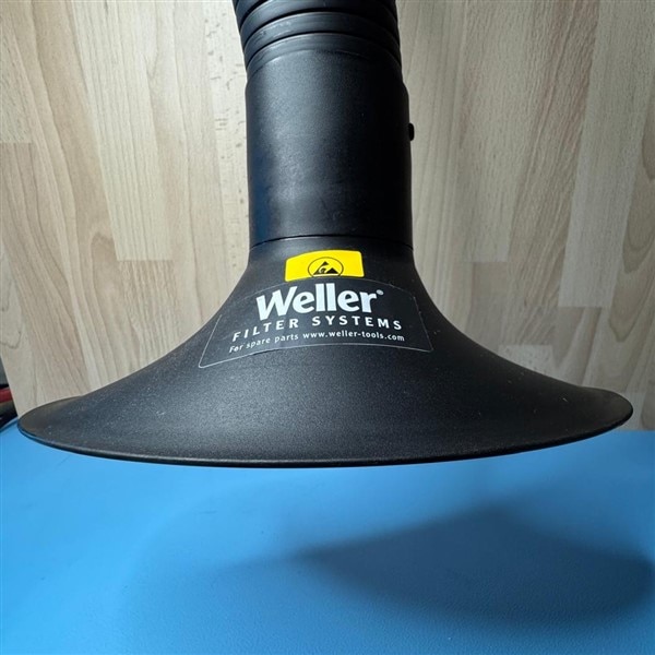

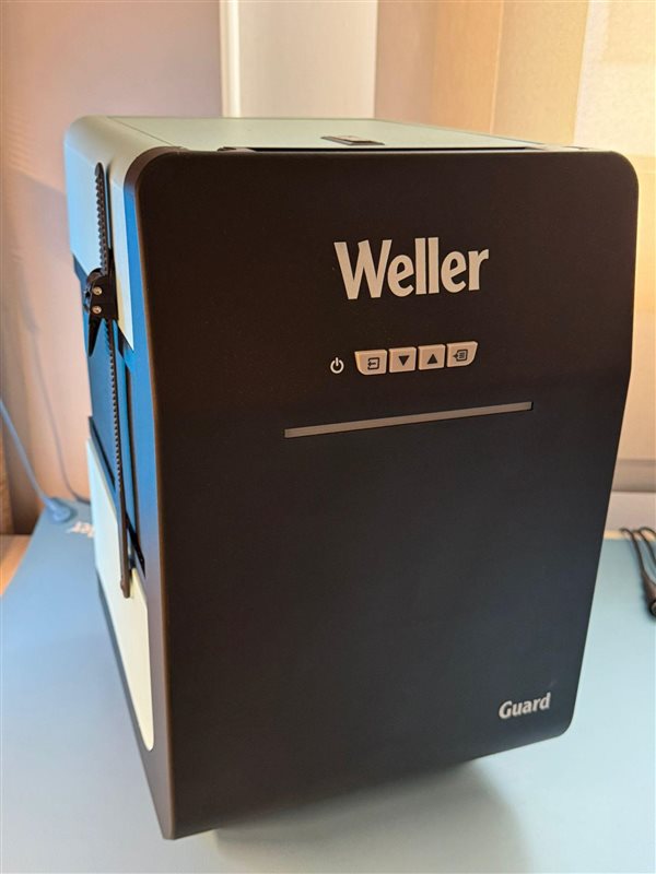

The ZeroSmog Guard unit presents a clean and robust industrial design.
Figure 4 – ZeroSmog Guard front view
Figure 5 – ZeroSmog Guard rear view
The front panel is simple and functional, prioritizing ease of use. The rear panel provides access to power connections, flexible hose connector and technical specifications.
Overall build quality inspires confidence for continuous use in both professional and home lab environments.

Figure 6 – Complete workbench setup with filtration system integrated
The station interface is clear and responsive, allowing quick adjustment of temperature and parameters without requiring prior familiarization.
From a workspace perspective, the arrangement feels natural and well balanced. The station, tip cleaner, and holders are positioned to minimize unnecessary hand movement.

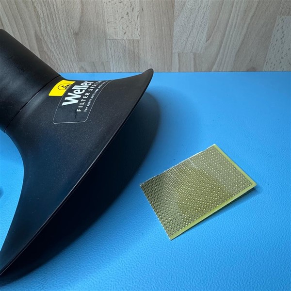

After integrating the ZeroSmog Guard, the filtration unit was placed under the bench, keeping the work surface clear.
Despite being out of direct view, the airflow is immediately noticeable, and the flexible hose allows precise positioning of the nozzle close to the soldering area.
In idle conditions, the unit produces a low and controlled noise level. It is audible but not intrusive, making it suitable for prolonged sessions.

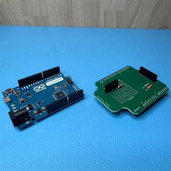

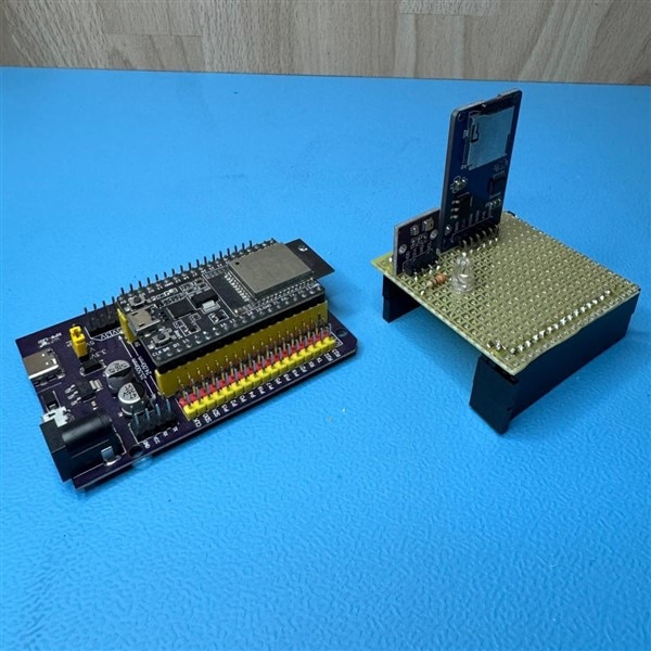

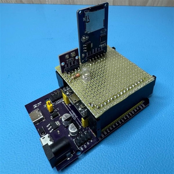

For practical validation, a custom PCB from the real project described in Section 6 was used for through-hole soldering tests, while a dedicated SMD training board was used for fine-pitch components (0603 / 0402) and tweezer-based rework operations.

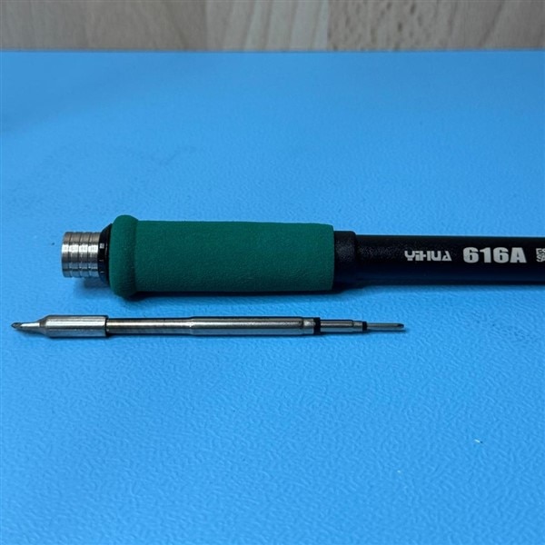

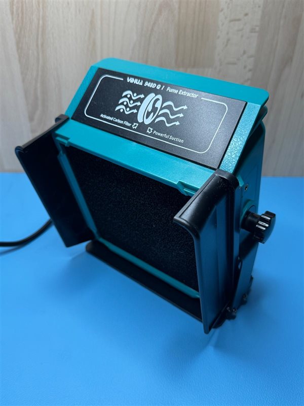

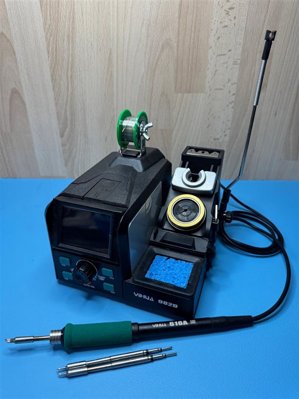

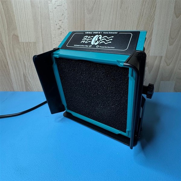

For comparison purposes, results are contrasted against a semi-professional setup currently used in my lab, consisting of a Yihua 982D soldering station combined with a Yihua 948D-QI fume extractor.

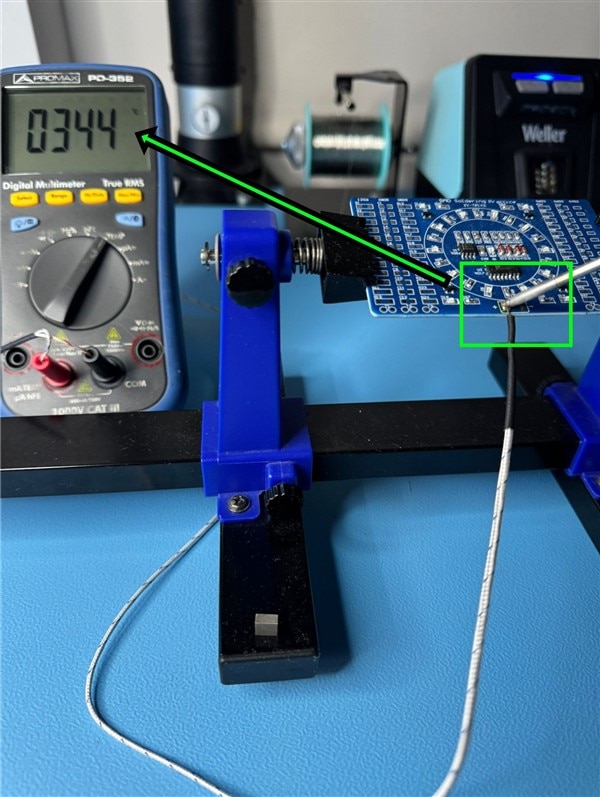

Temperature measurements were performed using a PROMAX PD-352 multimeter with a standard K-type thermocouple. The thermocouple was placed in contact with molten solder on the tip to improve thermal coupling and measurement stability.
Figure 7 – Yihua 982D soldering station
Figure 8 – Yihua 948D-QI fume extractor
This baseline setup represents a common mid-range solution typically used by hobbyists and makers, providing adequate performance for general tasks but with known limitations in thermal response and fume capture efficiency. This setup has been used regularly for embedded prototyping, PCB assembly, and rework tasks, providing a realistic baseline for comparison.

The Weller station maintains a very stable temperature profile with minimal observable deviation, indicating a well-tuned control loop.
Using the K-type thermocouple measurement, it can be observed that after a short stabilization period, the measured temperature converges closely to the value shown on the station display, within the deviation indicated in the table above.
The Weller station achieved a thermocouple measurement of approximately 344 °C while the setpoint was configured at 350 °C, resulting in a deviation of around −6 °C.
Regarding stability, and considering the resolution and limitations of the measuring instrument (PROMAX multimeter), the observed variation was effectively 0 °C, matching the stability indicated on the station display. This level of stability is notably high and suggests a very well-controlled thermal regulation loop.
It is important to highlight that the geometry of the soldering tip used during the test likely influenced the accuracy of the measurement. The Weller tip features an internal cavity that allows the thermocouple bead to be partially enclosed, improving thermal coupling and resulting in a measurement that is closer to the actual tip temperature.
In contrast, the baseline system shows more noticeable fluctuations, especially under thermal load. Measurements using the thermocouple indicate that, after stabilization, the actual tip temperature can deviate significantly from the value indicated on the device display.
The Yihua station presented measurements around 307 °C under similar conditions. However, this value is likely affected by measurement limitations rather than reflecting the true tip temperature. The chisel-shaped tip does not allow the thermocouple bead to be properly enclosed, leading to poorer thermal contact and therefore lower measured values.
Despite this limitation, once a maximum measurable temperature was reached, the Yihua station exhibited a variation of approximately ±5 °C based on thermocouple measurements, whereas the temperature indicated on the device display remained visually stable, showing no observable fluctuation.
Overall, these results reinforce that the Weller system implements a more refined temperature control loop, resulting not only in better stability but also in higher effective precision during real soldering operations.

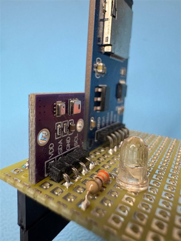

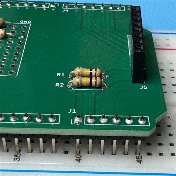

Through-hole soldering was evaluated using a standard prototype PCB with connectors and passive components.
The Weller station provides a smooth and efficient soldering process. Heat transfer to pads and component leads is immediate, allowing proper wetting with minimal contact time.
Even on larger pads or ground-connected pins, the station maintains sufficient thermal power without noticeable delay.
Compared to the baseline setup: - Heat transfer is faster
- Required contact time is reduced
- Solder joints appear more uniform and controlled
This results in improved efficiency and reduced risk of overheating components due to prolonged contact.
Overall, for THD work, the station offers a clear improvement in both speed and control, even though this type of soldering is less demanding than fine-pitch SMD.

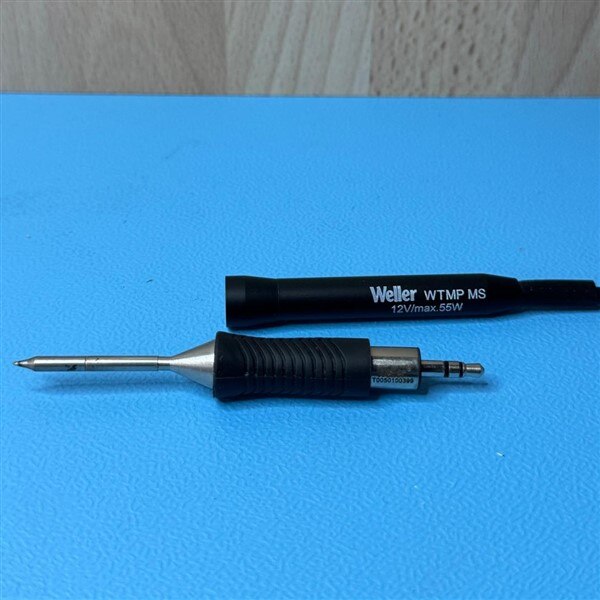

Figure 11 – THD soldering result
Figure 12 – Tip used

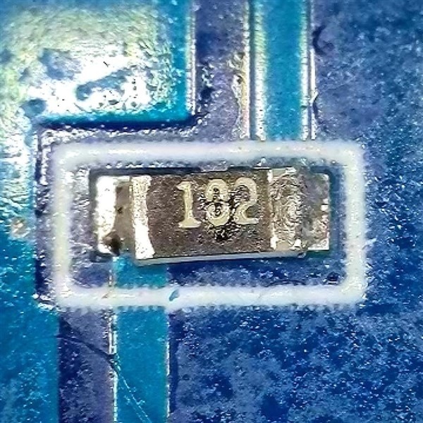

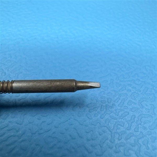

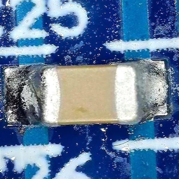

3.4 SMD Soldering (0603 / 0402)
SMD soldering is where the advantages of the Weller system become most evident.

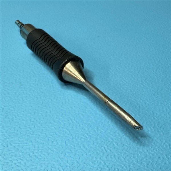

Tests were performed on components down to 0603 and 0402 packages using micro tips included in the kit.
The key observations are: - Excellent tip precision and control
- Very stable thermal behavior during contact
- Immediate response when applying solder
The reduced thermal mass and fast response of the system allow working on small pads without overheating adjacent components.
Compared to the baseline setup, the difference is significant: - Greater precision when positioning components
- Less risk of solder bridges
- More consistent results across repeated operations
In particular, when working with 0402 components, the system enables a high level of control and precision.
This is one of the areas where the transition to a professional-grade station clearly justifies itself.
Figure 13 – SMD soldering (0603)
Figure 14 – SMD soldering (0402)
Figure 15 – Tip used for 0603 and 0402

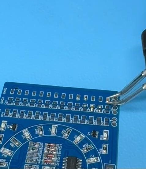

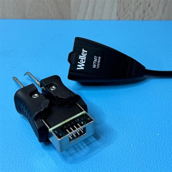

3.5 Tweezers (Rework and SMD Handling)
The soldering tweezers were evaluated in rework scenarios using the same SMD training board employed for 0603 and 0402 soldering tests.
The tests focused on component removal, particularly on small passive components where simultaneous heating of both pads is required.
From an operational perspective, the tweezers provide a very controlled and efficient rework process: - Simultaneous heating of both pads enables clean component removal
- Minimal mechanical force is required, reducing the risk of pad damage
- The process is fast and repeatable
Compared to using a single soldering iron, the improvement is significant. Traditional rework requires alternating between pads or applying excessive heat, which increases the risk of overheating components or lifting pads.
With the tweezers, the component can be removed in a single controlled motion once both joints reach the appropriate temperature.
Figure 16 – Component removal using soldering tweezers
Video 7 – SMD rework using tweezers
Thermal performance during use is consistent with the rest of the system: - Fast heat-up
- Stable temperature during contact
- Immediate response when load is applied
This ensures that both pads reach reflow temperature simultaneously, which is critical for clean removal.
From an ergonomic perspective, the tweezers are comfortable to use and well balanced. The grip allows precise positioning even on small components, and the operation feels natural after a short adaptation period.
Compared to the baseline setup, which lacks a dedicated rework tool, the difference is substantial: - Faster and cleaner component removal
- Reduced risk of PCB or component damage
- Improved repeatability in rework operations
In practical scenarios, this translates into: - More efficient debugging and rework workflows
- Safer handling of small SMD components
- Reduced stress during delicate operations
From a workflow standpoint, the soldering tweezers significantly enhance the system’s capability for SMD rework, complementing the precision and thermal performance observed in standard soldering tasks.
3.6 Continuous Use / Thermal Recovery
Continuous soldering tests were performed by assembling multiple components sequentially without pause.
Under these conditions, the Weller station shows excellent thermal recovery: - No noticeable drop in performance between joints
- Immediate return to set temperature after each contact
- Stable behavior even during repetitive operations
From an ergonomic perspective, this has a direct impact: - Reduced waiting time between joints
- More fluid workflow
- Lower fatigue during long sessions
The combination of fast recovery and stable temperature control makes the system particularly suitable for production-like tasks or extended prototyping sessions.
3.7 Tooling and Maintenance
The Weller system is designed with a strong focus on usability and efficiency during daily operation, particularly when it comes to tip exchange and general maintenance.
Tip replacement is a critical aspect in precision soldering workflows, especially when switching between different tasks such as through-hole assembly and fine-pitch SMD work. In this regard, the system provides a fast and straightforward mechanism that minimizes downtime.
Figure 17 – Tip replacement on micro soldering iron
Video 8 – Tip replacement procedure (micro iron)
The process is intuitive and can be performed quickly without requiring complex tools. The mechanical design of the handpieces and holders allows safe handling even when the station is in regular use, reducing the need to interrupt the workflow.
A similar behavior is observed when changing tips on alternative handpieces, maintaining consistency across the system.
Figure 18 – Tip replacement on pico soldering iron
Video 9 – Tip replacement procedure (pico iron)
The tweezers tool, used for SMD work, follows the same philosophy, allowing efficient tip exchange while maintaining good mechanical stability.
Figure 19 – Tip replacement on soldering tweezers
Video 10 – Tip replacement procedure (tweezers)
From a usability standpoint, this results in: - Reduced interruption time when switching between tasks
- Increased flexibility when working with mixed THD and SMD assemblies
- Improved overall efficiency during iterative prototyping
Compared to the baseline setup, the tip replacement approach differs significantly.
On the Yihua station, the tip uses a bayonet-style mechanism (similar to JBC systems), allowing very fast one-handed replacement. This makes the process particularly convenient during frequent tip changes.
Figure 20 – Tip replacement on baseline soldering
Video 11 – Tip replacement on baseline soldering
In contrast, the Weller system requires the use of both hands for tip replacement. While the process remains safe and controlled, it is noticeably slower and less ergonomic than bayonet-based systems, especially in workflows requiring frequent tip changes.
Additionally, when handling hot tips, the thermal insulation is effective in avoiding direct burns by contact. However, the fingers remain relatively close to the tip area, which can feel less comfortable when the tip is at high temperatures (e.g., around 300 °C).
In real usage, this is not a limitation for occasional use, but becomes a clear drawback in intensive workflows where speed and one-handed operation are expected.
In terms of general maintenance, the system benefits from a well-designed set of holders and cleaning tools. The automatic tip cleaner contributes to maintaining consistent tip condition without requiring additional manual steps, helping preserve soldering quality over time.
From a system perspective, the tooling and maintenance aspects of the Weller system align with a professional workflow, although the tip replacement mechanism prioritizes safety and control, but at the cost of speed and fluidity, which may not meet the expectations of users accustomed to high-end quick-change systems.

4.4 Maintenance
Maintenance of the automatic tip cleaner is straightforward and well aligned with regular usage.
Access to the internal components is simple, allowing quick inspection and cleaning. During operation, residues from solder and flux accumulate inside the chamber, which is expected.
Figure 22 – Automatic tip cleaner opened for maintenance
Video 13 – Cleaning element replacement procedure
The system tolerates this accumulation without immediate performance degradation, but periodic maintenance is required to ensure consistent operation.
The replacement of cleaning elements is intuitive and does not require specialized tools. Additionally, general cleaning of the unit is simple, as the internal chamber is easily accessible for residue removal.
From a maintenance standpoint: - Maintenance operations are quick
- Access to internal components is easy
- Cleaning intervals are predictable
In practice, maintenance is minimal and well structured, making it easy to integrate into routine use.
4.5 Comparison with Baseline
The automatic tip cleaner represents a clear evolution compared to traditional cleaning methods used in mid-range setups.
In the baseline configuration, cleaning is performed using sponge and brass wool, both of which are effective but rely on manual interaction.
With a sponge: - Cleaning requires manual wiping
- Moisture can introduce thermal shock
- Effectiveness depends on user technique
With brass wool: - Faster and avoids thermal shock
- Still requires manual insertion and movement
- Cleaning consistency varies
In contrast, the automatic system provides: - Consistent and repeatable cleaning
- No dependency on user-applied force or motion
- Immediate cleaning integrated into workflow
Traditional methods introduce small but frequent interruptions that accumulate over time. With the automatic system, cleaning becomes part of the natural soldering flow.
From a workflow standpoint: - Cleaning is faster and more consistent
- Tip condition is more uniform
- Workflow interruptions are minimized
That said, traditional methods remain simple, low-cost, and effective for occasional use. The automatic cleaner introduces additional mechanical complexity and requires periodic maintenance.

The ZeroSmog Guard unit integrates naturally into the workspace, particularly when installed under the workbench. This placement helps maintain a clean and uncluttered working area while still providing effective fume extraction at the point of soldering.
Figure 23 – ZeroSmog Guard installation under the workbench
The flexible hose and nozzle system allows precise positioning of the airflow directly at the soldering point. This represents a clear improvement over basic extraction solutions, which typically rely on general airflow rather than localized capture.
From an operational standpoint, correct positioning of the nozzle is essential to achieve optimal performance, as capture efficiency depends strongly on distance and alignment with the fume source.
A particularly useful feature is the ability to connect the extraction unit directly to the soldering station via the RJ interface, enabling automatic activation during operation. This integration ensures that fume extraction is consistently active without requiring manual intervention.
Although this functionality is documented, it is not immediately evident during initial setup. Given its relevance in daily use, it would benefit from being more prominently highlighted in the documentation.
From an operational standpoint, correct positioning of the nozzle is essential, and the system integrates well into a typical electronics workstation, both physically and functionally.

Figure 25 – Setup for noise measurement during operation (baseline)
In contrast, the baseline extractor becomes significantly more noticeable during operation. The higher noise level, combined with a less controlled acoustic profile, results in a more intrusive and fatiguing experience over time.
From a usability standpoint, this difference has a direct impact on user experience. The lower noise profile of the Weller system allows maintaining concentration during long sessions and reduces overall fatigue.
Additionally, the more controlled acoustic behavior makes the system better suited for home or shared environments, where continuous background noise can become a limiting factor.
5.3 Fume Capture Efficiency
Fume capture efficiency was evaluated during real soldering tasks by observing the behavior of smoke generated at the soldering point under different positioning conditions.
Figure 26 – Fume capture test during active soldering (Weller)
Video 14 – Fume capture behavior (Weller)
When the nozzle is positioned close to the soldering point (typically within a few centimeters), the system captures fumes effectively and removes them before they can disperse into the surrounding environment.
The directional airflow provided by the hose and nozzle enables localized extraction directly at the source, which represents a significant improvement over systems that rely on general air circulation.
Figure 27 – Fume capture test during active soldering (baseline)
Video 15 – Fume behavior without directional extraction (baseline)
In the baseline setup, fumes tend to rise and disperse more freely, while in the Weller system the airflow creates a more confined and directional extraction path.
In contrast, the baseline extractor lacks a focused capture mechanism. As a result, fumes tend to rise and disperse freely into the workspace before being partially removed, leading to visible smoke spread and reduced effectiveness at the source.
Observed during testing, the Weller system provides: - Immediate removal of visible fumes at the point of generation
- Minimal dispersion of smoke across the workspace
- Improved visibility during soldering operations
A key observation is that capture efficiency is strongly dependent on nozzle positioning. Small variations in distance and alignment can significantly affect capture efficiency.
When the nozzle is correctly positioned: - Fumes are captured almost instantly
- Air remains visually clean around the working area
When positioned further away: - Capture efficiency decreases
- Smoke begins to disperse before extraction
This behavior highlights the importance of proper setup and positioning as part of the workflow.

The project consists of an indoor environmental monitoring node, where an ESP32 serves as the main processing unit. The current implementation is based on a breadboard setup, with several modules already validated and others planned for integration.
The objective of this phase is to transition from a breadboard prototype to a more stable and maintainable solution using a custom shield built on a perforated prototyping board.
The planned board integrates multiple functional elements: - Header pins for interconnection with the ESP32 breadboard setup
- Environmental sensors (AHT20 and BMP280) for temperature, humidity, and pressure measurements (already integrated)
- A status LED with a current-limiting resistor for alarm indication (already integrated)
- An SD card module for data logging (already integrated)
This setup represents a typical embedded prototyping workflow, combining validated modules with new functional blocks under integration.
Figure 32 – ESP32 prototyping setup and custom board (assembled)
Figure 33 – ESP32 prototyping setup and custom board (dissembled)
During assembly, the Weller system provided precise control when working on the perforated board, where pad definition and spacing require careful handling.
From a process perspective: - Connections are clean and well-defined, even in densely wired areas
- Fine control allows accurate placement of headers and discrete components
- Minimal rework was required during assembly
The improved thermal stability also reduces the time required to complete each joint, which is particularly beneficial when working with mixed components and repeated connections.
Additionally, when soldering modules such as the SD card interface, which involve multiple pins and signal integrity considerations, the ability to work quickly and precisely helps avoid potential issues related to overheating or poor joint quality.
Figure 34 – Detail of soldered connections
From a development workflow standpoint, this results in: - Faster transition from prototype to semi-permanent hardware
- Improved reliability of connections compared to breadboard wiring
- Reduced need for iterative rework during integration
In real usage, the system proves particularly useful in prototyping stages where multiple components must be integrated progressively, requiring both precision and repeatability.

To further evaluate the system under realistic conditions, a custom PCB was assembled as part of an embedded robotics project.
The board is a custom-designed shield for an Arduino Leonardo, integrating multiple functional blocks: - An input connector for an analog joystick, including four push buttons and two potentiometers
- Analog signal conditioning using pull-down resistors connected to the microcontroller inputs
- Standard shield connections to interface directly with the Arduino
- A prototyping area used to integrate a Bluetooth module via UART (TX/RX), without dedicated routing in the PCB
This setup represents a typical mixed-use board, combining analog inputs, digital signals, and manual prototyping elements, making it a good candidate to evaluate soldering performance across different scenarios.
Figure 35 – Custom Arduino Leonardo shield (overview) (assembled)
Figure 36 – Custom Arduino Leonardo shield (overview) (dissembled)
During assembly and rework tasks, the Weller system demonstrated a high level of precision and thermal control.
From a process perspective: - Joints are clean, well-defined, and consistent
- Fine control allows accurate work on closely spaced pins
- No excessive solder spread or bridging was observed
One of the most relevant observations is the thermal behavior when working on ground-connected pins and larger copper areas. In these cases, no lack of power was observed, and the station maintained stable performance without requiring extended contact time.
At the same time, the short dwell time on pads reduces the risk of overheating components, particularly in sensitive areas such as analog inputs or closely packed connectors.
Figure 37 – Detail of solder joints
Figure 38 – Tip used for assembly
From a development standpoint, this translates into: - More precise and repeatable soldering results
- Reduced need for rework
- Lower fatigue during extended assembly sessions
In real usage, the system provides a noticeable improvement when working on custom embedded hardware, particularly in mixed-signal boards where both precision and thermal control are required.
6.3 Workflow Comparison
The following table summarizes the main differences observed between the baseline setup and the Weller system during real usage.
Aspect Previous Setup Weller
Precision Medium High
Comfort Medium High
Fatigue High Low
Air Quality Low High
In real usage, the differences are clearly noticeable across all aspects of the workflow.
The improvement in precision and thermal stability directly impacts soldering quality, while the integration of the automatic tip cleaner reduces interruptions during operation.
Additionally, the filtration system significantly improves air quality and overall comfort, particularly during extended sessions.
From a system perspective, the Weller system enables a more fluid, controlled, and sustainable working experience compared to the baseline setup.

  • Tip replacement system is slightly less ergonomic than bayonet-style alternatives for frequent changes

Metric Weller Baseline
Heat-up time ~3.5 s ~6.5 s
Cool-down time ~25 s ~58 s
Thermal stability High (low deviation) Moderate (visible fluctuation)
Temperature accuracy Close to setpoint ~20 °C deviation observed
SMD precision High (0402 capable) Limited control
THD performance Fast and controlled Adequate
Rework capability Excellent (tweezers) Limited
Tip cleaning Automatic, consistent Manual (sponge/brass)
Noise (active) Moderate / controlled High / intrusive
Fume capture Localized, immediate Dispersed, delayed
Ergonomics High Medium
Workflow efficiency High Moderate
Ease of tip change Moderate (two hands) High (one-hand)
Maintenance Structured, predictable Basic
