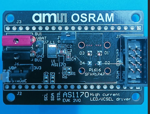

1. AS1170 Evaluation Board (Main Board)
The heart of the kit is the AS1170 Evaluation Board (also marked as “AS1170 High Current LED/VCSEL Driver”). It is a compact, black PCB measuring approximately 60 mm × 45 mm, with clear silkscreen labeling.
      Key features visible on the board:
  • Central AS1170 IC in a tiny WLCSP package
  • Integrated DC-DC boost converter (inductor and capacitors clearly visible)
  • Two pre-mounted 850 nm SFH 41747 IR LEDs (OSLONTm P1616 footprint) – these are the default onboard emitters
One thing that surprised me was that the board was very thoughtfully laid out. The board is designed for both GUI tests and embedded development. The connectors are also clearly labeled, making it very easy for new users. While I am an experienced user of many evaluation boards, I found it refreshing that I did not have to search through the schematics to figure out where to plug in my USB cable.

The board includes several important jumpers and connectors that control its behaviour. I genuinely spent a good few minutes just reading through the jumper table before touching anything — and I am glad I did, because getting this wrong, especially around the power path, could have caused real problems.
Input Description
BU1 VBAT Power Input Terminal: This is a red screw terminal used to connect the positive line from an external bench power supply. Only use this when the LED current is above 450 mA and USB power can’t provide enough power. The AS1170’s VIN range is "2.7 V to 4.4 V."
BU2 GND Terminal: This is the black screw terminal you use to connect the ground from an external power supply.
S1 Strobe Button: This is a physical button that’s wired to the AS1170’s STROBE pin. When the device is set to strobe-controlled flash mode, pressing it will trigger a flash. This really helped when I first started testing, since I could send IR pulses without having to write any code.
J1 External LED Board Connector: This is the connector where you plug in the IR LED breakout board. If you’re using J1, take off J5 so the onboard LEDs are disconnected.
J2 MCU board connector (lower header) It brings out SCL, SDA, STROBE, and 3.3V signals going between the ESP32-S2 and the AS1170 circuit. This is the I2C communication route.
J3 MCU Board Connector (upper header): This is an extra header connector for the ESP32-S2 module.
J5 Onboard LED Enable: If you install this jumper, it connects the onboard SFH41747 LEDs. Take it off when you’re using the external breakout board.
J6 VBAT to 3V3 Jumper: If you install it, J6 lets the ESP32-S2 use its 3.3V rail to supply the AS1170’s VIN. This is the default setup for running low-current tests over USB. The key point is that if you hook up a lab bench power supply to BU1/BU2 for high-current use, you need to remove J6 so the bench supply voltage doesn’t get sent back into the MCU board.
J7 VBAT/GND Measurement Pin: This is a handy two-pin header that lets you check the supply voltage using a multimeter or an oscilloscope.
Honestly, I thought the J6 detail was the one most likely to catch a new user off guard. The idea that leaving J6 in place while connecting a bench supply could back-feed voltage into the ESP32-S2 is the kind of subtle thing that is easy to miss on a first read. I was glad I caught it before making that mistake.

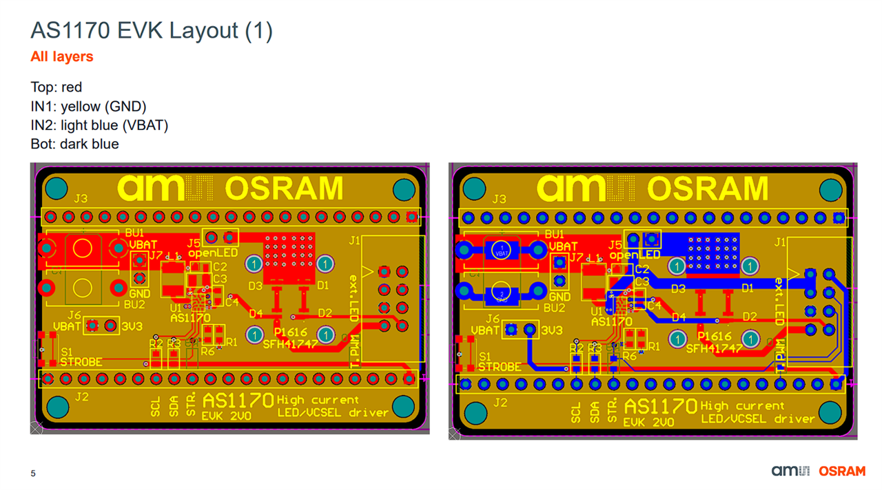

 1.2 PCB Layout
       Figure 1.2: PCB layout view highlighting routing layers and internal connections of the AS1170 evaluation board
These diagrams show the top layer (red), inner layers for GND and VBAT, and bottom layer.
They are very helpful for understanding power distribution, signal routing, and thermal design of the boost converter.
When I first looked at the layout, what caught my eye was that it is packed tightly around the AS1170 in a manner that is specifically recommended in the datasheet layout recommendations for minimizing the area of the high-frequency switching current loops.

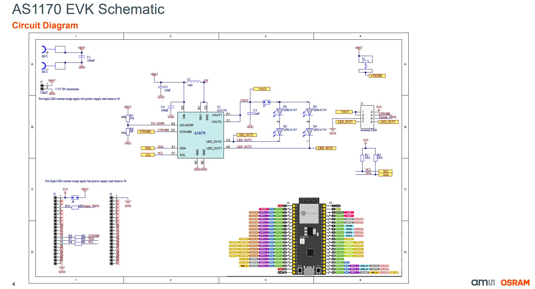

The entire circuit diagram for power input, boost converter, LED outputs, I²C interface, and ESP32-S2 connection points.
The complete circuit diagram showing power input, boost converter, LED outputs, I²C interface, and ESP32-S2 connection points.

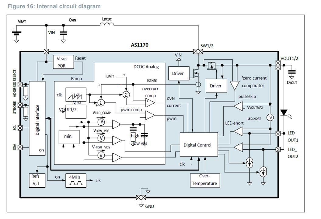

1.3 Internal Architecture
If we go through the provided documentation, it shows that the internal circuit diagram reveals a complete power management subsystem integrated into the single WL-CSP die.
Figure 1.3 : AS1170 internal circuit block diagram from the datasheet, showing DCDC control, current sinks, comparators, and protection blocks
The key functional blocks are worth tracing through:
The DCDC Analog block sits at the centre, controlling the PMOS and NMOS switches (SW1/2) at a fixed 4 MHz clock. The oscillator on the bottom left feeds the clock throughout the chip. A ramp generator and comparator implement peak current-mode control of the boost converter.
The current sinks on LED_OUT1 and LED_OUT2 are controlled by the digital core, which translates the I2C register values into a reference current for the current DAC. This is how the LED current is precisely set — not by varying voltage, but by directly controlling the current sinking through the LED.
The VDS comparators continuously monitor the voltage across the current sinks. There are two thresholds: VLOW_VDS (~320 mV) and VHIGH_VDS (~900 mV). These are used to determine whether the boost converter needs to operate at higher or lower duty cycle, and they feed into the 4 MHz / 1 MHz switching mode selection logic.
The protection blocks on the right monitor VOUT for overvoltage, the LED pins for short-circuit conditions, and junction temperature for thermal protection. All faults are reported through a dedicated register accessible over I2C.

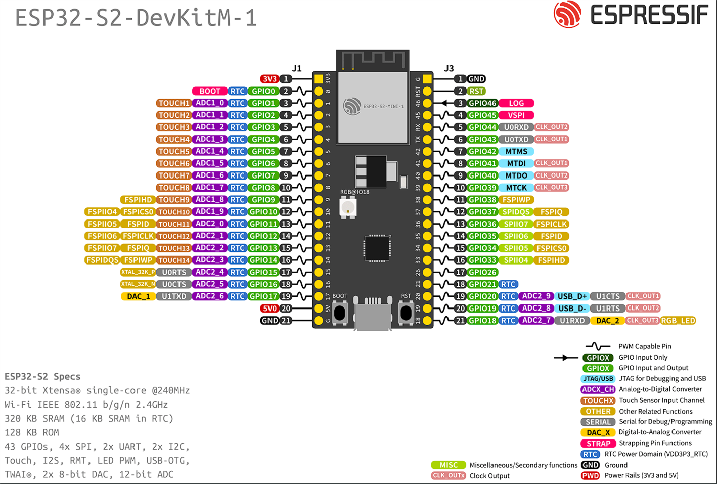

3.1 Technical Reference: ESP32-S2 Pinout and Layout
For detailed understanding of the ESP32-S2 board layout and GPIO capabilities, the following reference diagrams are included.
                  Figure 3.1 : ESP32-S2 DevKit M1 front view showing onboard components and interfaces
          Figure 3.2: ESP32-S2 pinout diagram highlighting GPIO functions, peripherals, and signal mapping.

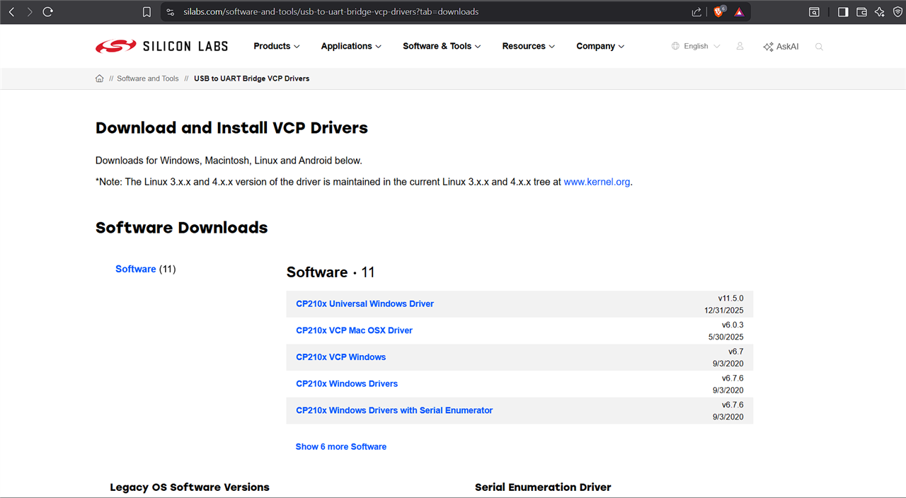

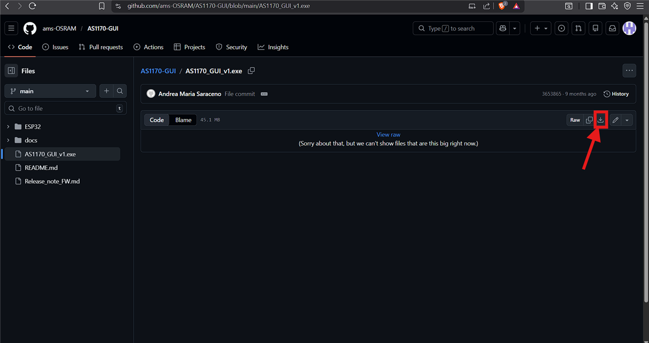

Step 1: Go to this Github repository  and download the AS1170_GUI_v1.exe

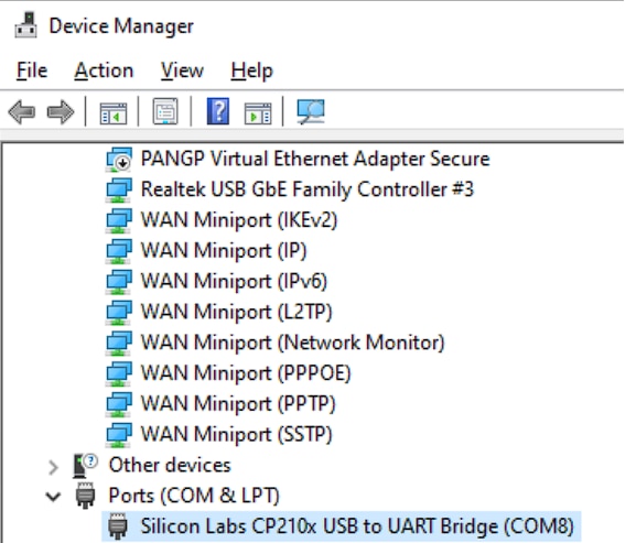

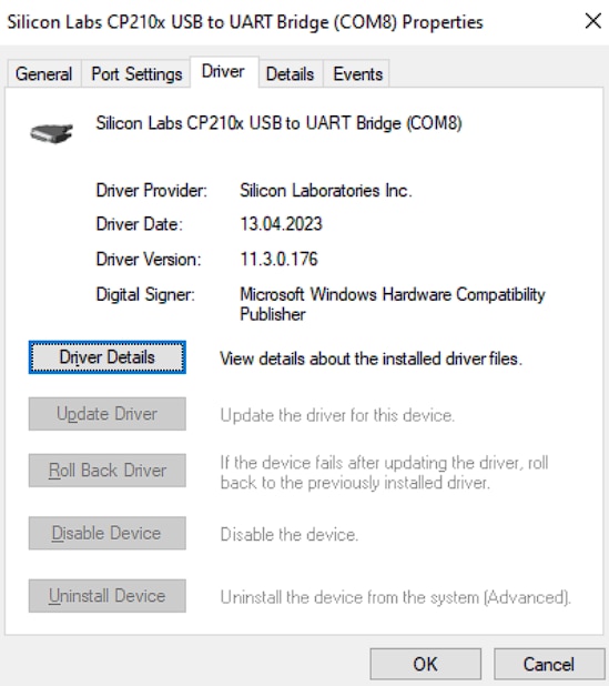

Step 2: Download the require CP210x VCP Drivers – Silicon Labs
Step  3:  Attach Eps32 with main Board and connect it to PC using USB 2.0 Type-A to Micro-B cable
Step 4: Open Device Manager and search for “USB to UART Bridge”
Step 5 : “Update Driver” from your local drive and select folder of step #1 (location of extracted SW package)
Step 6 : Driver is successfully installed launch AS1170_GUI.exe

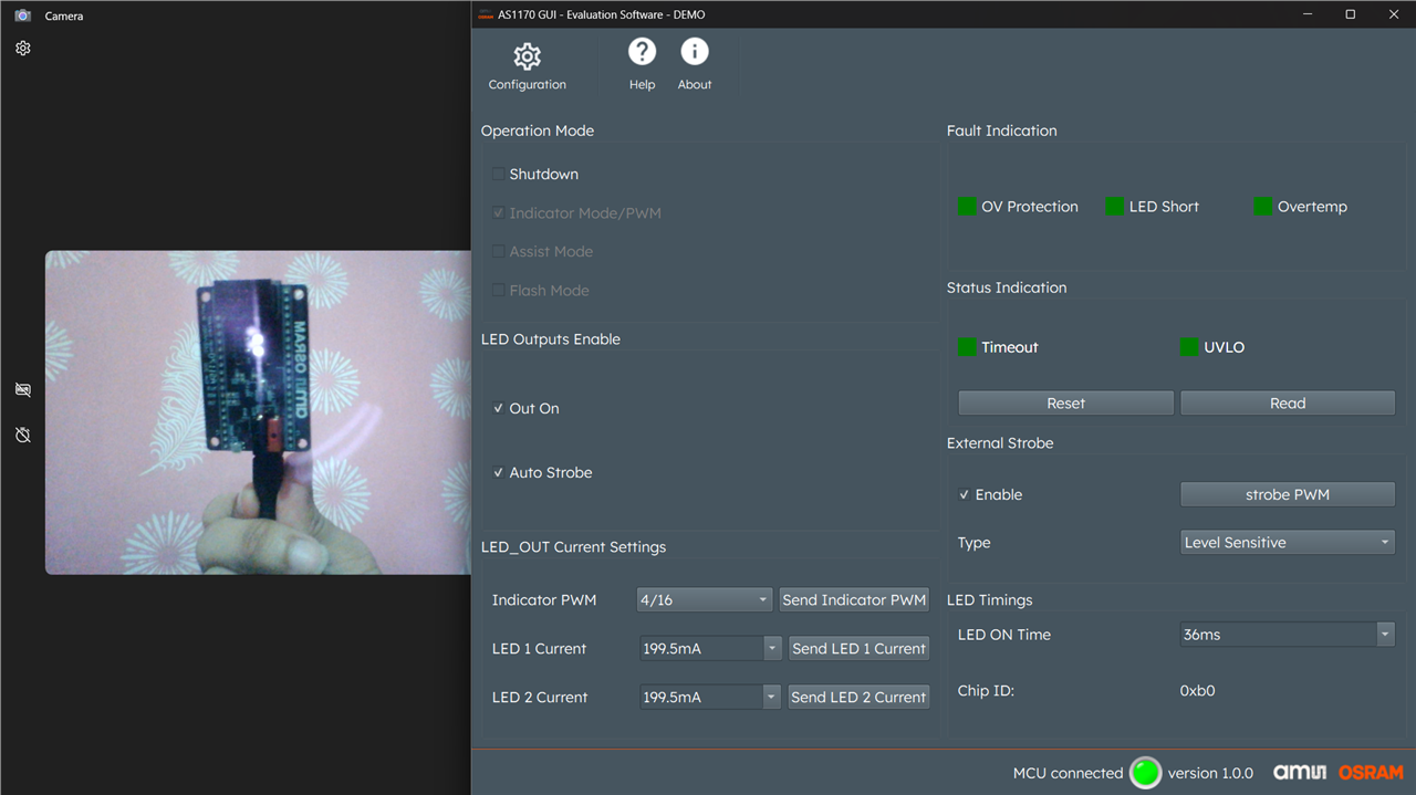

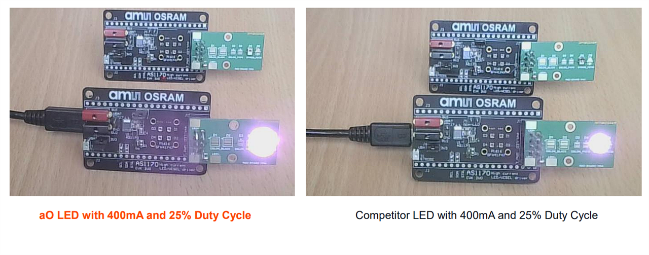

Indicator Mode / PWM
Indicator mode uses the 6 LSBs of the LED current registers and applies a 31.25 kHz PWM modulation. This is designed for applications like always-on proximity sensing or low-power face tracking where the LED needs to run continuously but at reduced average current.
I configured it as follows: selected "Indicator Mode/PWM" in the Operation Mode section, set Indicator PWM to 4/16 (25% duty cycle), LED 1 Current to 199.5 mA, LED 2 Current to 199.5 mA, then checked "Out On".
Figure : AS1170 GUI configured for indicator mode PWM, with 25% duty cycle, 199.5mA per LED channel, Out On enabled.
According to the EVK user guide, this will drive approximately 400mA at a duty cycle of 25% with a PWM frequency of approximately 30.6 kHz on the LED OUT pins. Pointing the camera at the IR LED, I can see the IR LED lighting up. This is due to the camera's sensor, which can detect near-infrared light, not visible to the human eye.

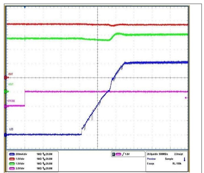

Flash mode is the high-power mode of operation in which the full range of the LED current register is utilized. I selected Flash Mode and left the current settings at 199.5 mA per channel. I then set the LED ON Time to 2 ms.
With "Out On" checked and "Auto Strobe" selected, I pressed the S1 button on the EVK board, and the IR LED emitted a flash pulse.The IR LED emitted a flash pulse corresponding to the configured 2 ms timing, as expected from the AS1170 configuration.
Figure: AS1170 GUI in Flash Mode 2 ms LED ON Time, 199.5 mA per channel.
I recall when I first pressed the S1 button for the first time in flash mode and how nice it was to get the perfectly timed IR burst triggered by the physical button with no code written at all. This is the kind of workflow that makes a well-designed EVK so valuable.

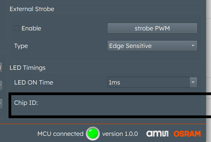

2. Chip Detection and Control Does Not Function
Sometimes, the system was not able to detect the chip ID. This meant that the system was not in control of the main board. Although the interface was still working, it was not possible to do anything with it. No commands were registered, and no interaction was possible.

  • Enabling/disabling output
  • Switching operating modes
  • Reading fault conditions
  • Monitoring UVLO status
  • Checking thermal fault conditions
  • Detecting LED short conditions
  • Reading device identification
  • Configuring strobe signaling behavior
This is precisely the sort of control expected in a real embedded deployment.

Observations
This was a particularly useful part of the roadtest in confirming that AS1170 isn't just another GUI-oriented demo board, but an actual embeddable solution.
I²C communications were stable, register reading was flawless, and the firmware successfully gave meaningful control over the device.
In comparison to the GUI, it feels much more natural as product integration.
Instead of using vendor software, you control a subsystem from your firmware by clicking buttons.
However, the API is quite low level.
It is not intended as a high-level abstraction:
  • it offers no higher-level APIs such as setFlashMode()
  • writes override registers directly
  • partially supported CSV loading
However, for this kind of evaluation, this wasn't really a downside as we got insights on how the device can be controlled in firmware.

One of the most rewarding aspects of any IR LED driver evaluation is seeing this invisible light in action. As the AS1170 driver is designed to drive near-infrared LEDs (with the SFH41747 emitting at approximately 850 nm), this light is invisible to the naked eye but perfectly within range for detection by most digital camera sensors.
10.1 Camera Verification Method
I used a digital camera on a laptop. I aimed this camera directly at the IR LED package. In Indicator mode at 400 mA combined current and 25% duty cycle, the IR LED was visible on the camera preview as a bright white/purple spot – very visible and unmistakable.
The EVK document includes a comparison shot of the ams-OSRAM IR LED versus a competing IR LED product under the same conditions (400 mA, 25% duty cycle). The ams-OSRAM IR LED emits a much brighter light in the camera preview – again, in agreement with its much higher optical efficiency in comparison to the competing product’s IR LED chip used in this product – the SFH41747.
Figure 13: Side-by-side comparison showing the ams-OSRAM SFH41747 (left, brighter) versus a competitor LED (right) under identical conditions — 400 mA, 25% duty cycle..

First and foremost, it’s worth noting that at its heart, the AS1170 is a current mode boost converter with precision current sink capabilities. The VIN pin is used to connect up a battery voltage that ranges over a typical range of 2.7 V to 4.4 V. The boost converter kicks this up to whatever voltage is required on VOUT to make sure that the LED voltage is always covered, while the precision current sink on LED_OUT1 and LED_OUT2 absorbs the LED current and regulates it to whatever was set in the current registers.
The boost converter runs at a fixed 4 MHz. This is fast enough to allow very small inductors to be used – in this case, 1µH – but not so fast that EMI becomes a serious issue in RF circuits in a smartphone. The on-resistance of both the internal PMOS and NMOS switches is around 70mΩ – nice and low so that power is not wasted in these switches even at ampere-scale currents.

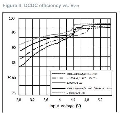

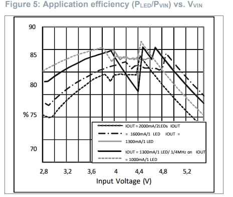

Efficiency Graphs
From the datasheet, Figure 4 is a plot of DCDC converter efficiency vs. VVIN (input voltage), for various levels of LED current. The important takeaway here is that at a typical 3.7 V Li-ion battery voltage, efficiency will remain within 90-95%. This drops significantly for lower voltage – lower than 3 V – which is why there is an undervoltage current reduction feature.
Figure: AS1170 DCDC efficiency versus input voltage for various LED current configurations. Peak efficiency exceeds 95% at 3.7 V input with 1000–1300 mA load.
From the datasheet, it can also be noted that Figure 5 indicates application efficiency, or rather, the efficiency in delivering power to the LED divided by the power being drawn from the supply. This is a much more useful figure, as it includes both the losses of the boost converter and the voltage drop across the current sink. With an application efficiency of 80-85% at 3.7 V, this means that for every 1W being drawn from the battery, 800-850 mW will actually get to the LED. This is a really impressive efficiency for a device of this complexity and size.

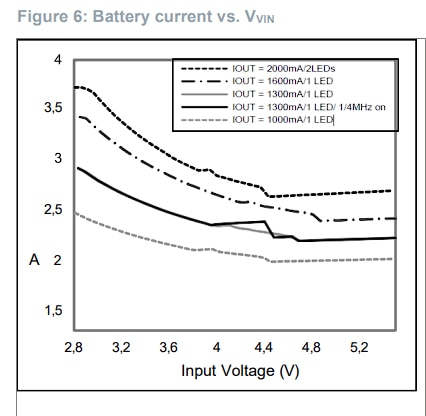

Figure 6 in the datasheet shows battery input current versus VIN. What stands out here is that as input voltage drops (representing a discharging battery), the input current increases to maintain the same LED output power. This is the natural behaviour of a boost converter. At 2.8 V input with 2000 mA combined LED output, the battery current approaches 4 A — a number worth knowing when evaluating connector and trace sizing in a real product.

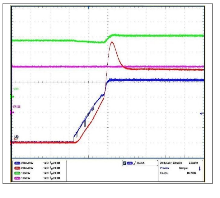

From the datasheet, it is clear that Figures 8 and 9 depict the LED current startup waveforms for 1.0 A and 800 mA, respectively. It is clear that the soft-start ramp is included, as the current does not change abruptly. Instead, it increases gradually over a period of 250 to 1000 µs. This is done internally to prevent a sudden surge in current, which would cause a voltage glitch. This is particularly important in RF environments, such as in smartphones, where noise is a critical factor
Figure 8: AS1170 LED current startup waveform at 1.0 A — the soft-start ramp smoothly brings the LED current to its target value over approximately 500 µs, preventing supply voltage transients.
Figure 9 shows the ramp-down waveform, which also performs smoothly. The ramp-down time is 500–1000 µs. Together, these controlled edges are what make the AS1170 suitable for camera flash applications where abrupt current switching could create visible artefacts in captured images.
