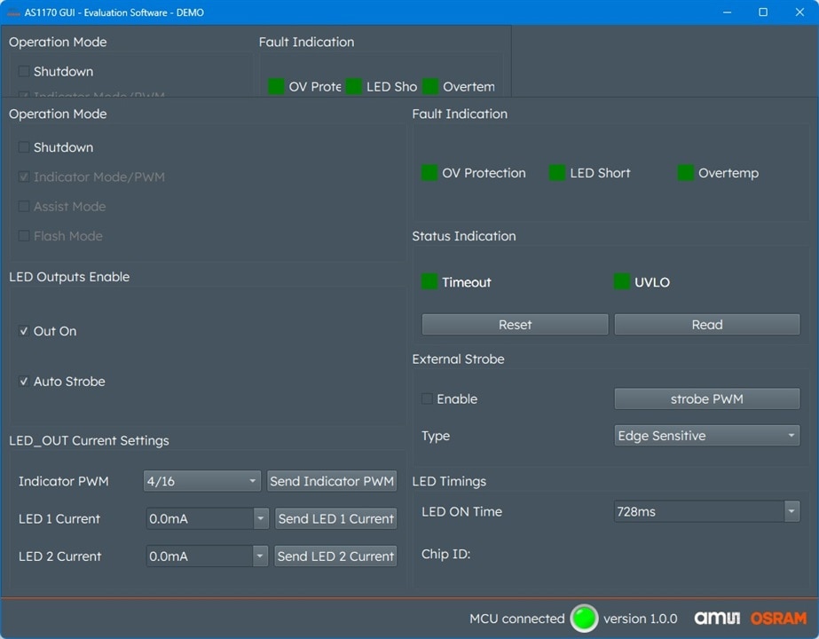

I downloaded and installed
  • ams AS1170 PC GUI Software V1.1
Here is the kit.
The initial attempt at evaluating the kit was a bit frustrating.
The AS1170-GUI PC software has a few problems.  It works sometimes, sometimes not at all.  To diagnose what the problem is, I need to dive deeper into the software interface.
The AS1170 IC is a LED driver with two outputs that can source up to 1A on each output.  The basic AS1170 IC block diagram is shown below.

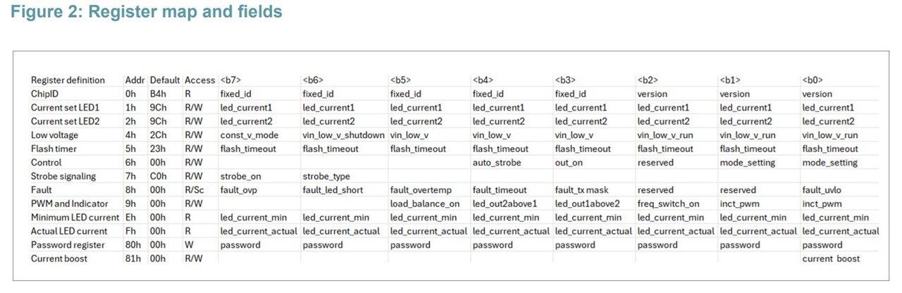

The AS1170 is controlled using the I2C bus by loading various registers per the following table.
The AS1170-GUI PC program talks to the ESP32 through the USB serial interface using read and write commands, and then the ESP32 transfers the register data to/from the OSRAM board via the I2C bus.

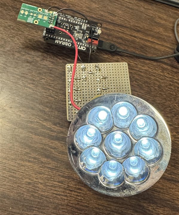

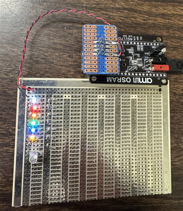

I soldered up a small interface board to plug into the OSRAM board via the 8-pin header so I could connect some visible LEDs and disconnect the IR on-board LEDs.
My intent is to eventually connect the OSRAM AS1170 board to some CNC laser modules.
Below is the current CNC laser driver board.
The AS1170 user manual isn't totally clear as to how the register settings control the driver output modes.
In the AS1170 EVK manual there are a few example configurations.
AS1170_EVK_QG001040_2-00.pdf
\https://look.ams-osram.com/m/1ad89354fc528e75/original/AS1170-EVK-QG001040-Guide-2-00.pdf
In the AS1170 IC datasheet there is much more information about all the registers and values.
AS1170-High-current-LED-VCSEL-driver.pdf
https://look.ams-osram.com/m/360a4e139e632474/original/AS1170-High-current-LED-VCSEL-driver.pdf
To give myself a jumpstart on how the OSRAM GUI PC app was configuring the board, I used wireshark to monitor the USB bus and log the data transfers.
_ws.col.info == "URB_BULK out"
OUT_on

Program what mode you want the IC to be in:
  • Standby/Off  - Control register 0x06 bit 3
  • Indicator Mode - Control register 0x06 bits 0 and 1 and Indicator/PWM register 0x09
  • Assist Mode - Control register 0x06 bits 0 and 1
  • Flash Mode - Strobe register 0x07 bits 6 and 7
  • Strobe Mode - Strobe register 0x07 bits 6 and 7
If Indicator Mode:
  • Only bits 0-6 are used on registers 0x01 ad 0x02 to set the LED currents
If Assist mode:
  • Bits 0-7 are used on registers 0x01 ad 0x02 to set the LED currents
If Flash or Strobe Mode:
  • Set LED on timer value register 0x05
There is also a current boost register 0x81 used with a password register 0x80 for an extra %11 current output drive
(I haven't tried this yet - an external power supply must be used for this because normal USB ports can't source high currents)
There are several fault protection circuits inside the AS1170 and the fault codes can be read from register 0x08
  • Under_voltage
  • Over_Voltage
  • LED_Short
  • Flash_Timeout
  • Over_Temp
