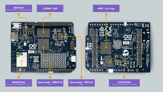

Main processor (Dragon SoC)
A Qualcomm DragonwingTm QRB2210, which features four ARM Cortex-A53 cores and an Adreno GPU, handles the Linux environment. The board ships in two configurations — 2 GB RAM / 16 GB storage and 4 GB RAM / 32 GB storage — giving it enough computational power for light desktop use, data processing, local web servers, and running small inference models.
Microcontroller
The onboard MCU is a STM32U585, which sports a Arm Cortex M33 with a clock up to 160 MHz. This MCU runs C++ executables on Zephyr OS, which is really forward-looking approach to real-time subsystems. The application, thanks to this lightweight and deterministic OS, can leverage real-time access to hardware peripherals.

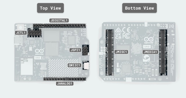

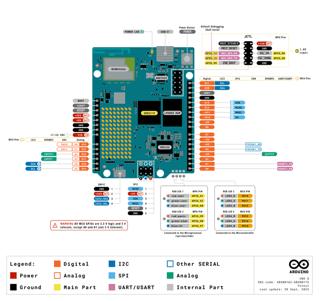

Connectors
The board features, beside the typical digital and analog signals on the Arduino Uno headers, high-speed expansion connectors on its underside for cameras, displays, and audio modules, plus a quick connector for common peripheral hookups.

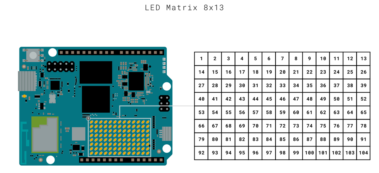

LED Matrix
The board also features a programmable LED matrix, which is somehow scenographic but I don't think it's really useful. First of all, if you mount a shield all the LEDs will not be visible. Second, the information you can show on LED matrix are limited. Considering the cost of the components (resistors and LEDs) and the cost of manufacturing, a tiny 2.8" OLED display would have been cheaper to install

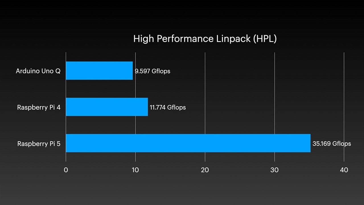

Regarding performances, I found this interesting comparison
In summary:
Idle power draw 0.5 W
Maximum simulated power draw (stress-ng --matrix 0) 1.9 W
During Geekbench multicore benchmark 2.5 W
During top500 HPL benchmark 3.5 W
In terms of number crunching capabilities, the Arduino Uno Q is comparable to a Raspberry Pi 4 (an SBC relased in 2019)

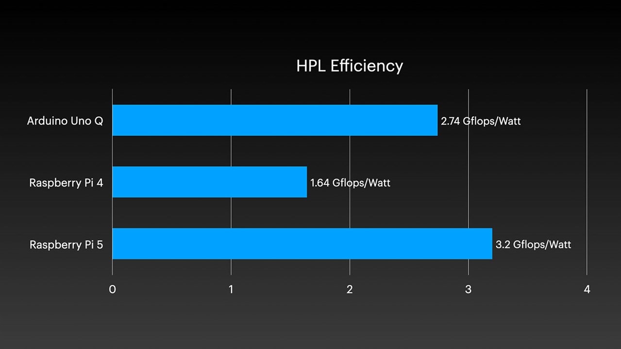

In terms of efficiency, results are much better
As we can see, Arduino Uno Q is not the best in class in terms of performance or even efficiency, but this point of view misses the product's intent. The Uno Q should be considered as a microcontroller-based board that happens to run Linux, not a Linux computer with GPIOs. The absence of a heatsink, the default boot into AppLab rather than a desktop, and the Uno form factor provides an idea of the product the development team had in mind.

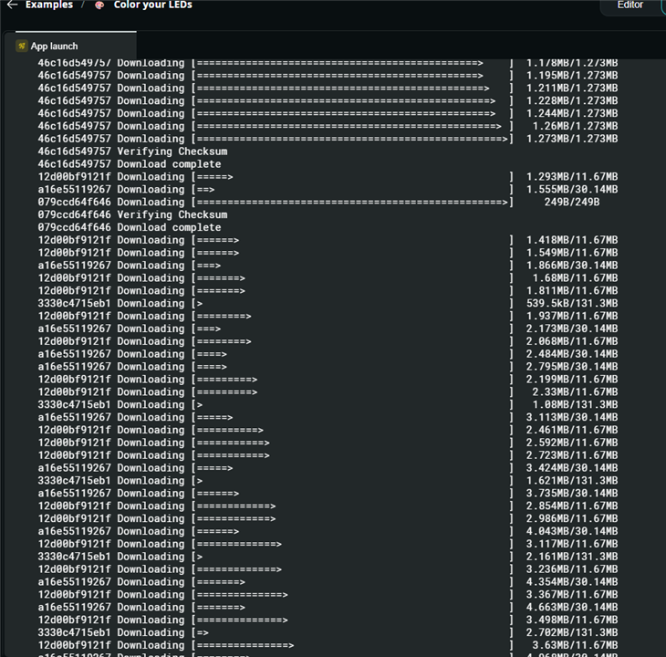

Python scripts and the optional web UI runs in docker container. When you run a project, you will see in the terminal familiar log messages of docker downloading images from docker repositories.
The containerisation means dependencies are isolated and the brick simply exposes an interface to your code. Importantly, the user does not need to manage Docker directly; AppLab handles deployment automatically.

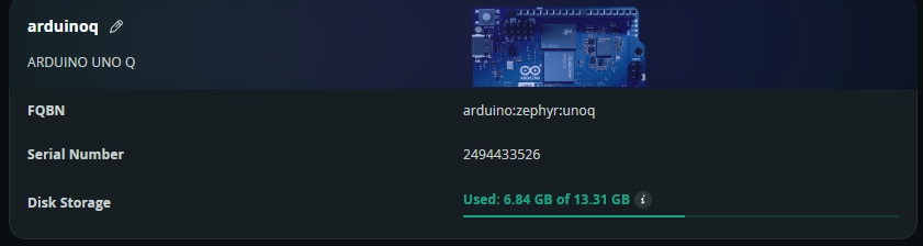

I would have preferred the user data and application to be downloaded in a separate partition. This solution has some benefits
  • the root partition can be mounted as read-only, thus improving board reliability in case power is disconnected
  • the root partition will never run out of space because of a huge docker images

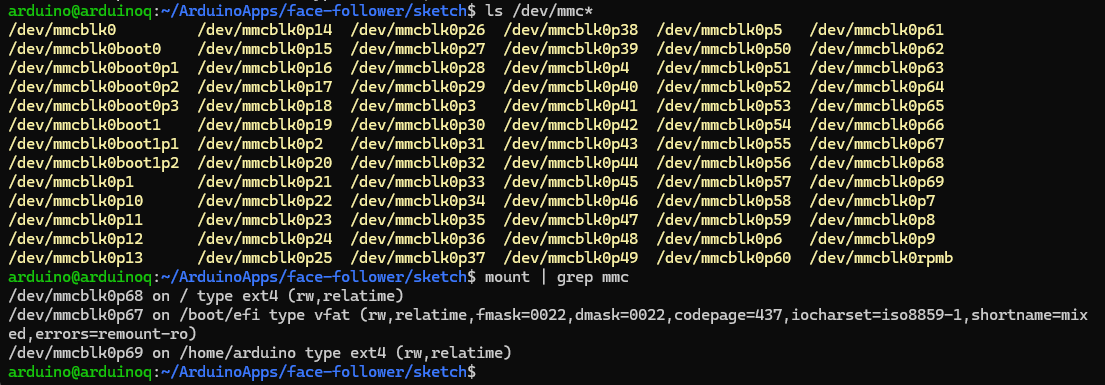

Regarding eMMC partitioning, I worth noticing that that are an incredible number of partitions, but only three are really mounted
It's not clear to me what all those partitions are for, but the finally effect is that you only have 13 Gb available out of 16 Gb

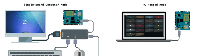

Running App Lab
The App Lab can be run in three different ways:
  • Onboard: There’s a copy that runs directly on the Linux partition of the Arduino Uno Q itself
  • USB Connection: Connect the Arduino Uno Q to a computer via USB-C
  • Network Connection: Connect to the board over a local area network
One crucial concept to understand is that app files reside on the Arduino Uno Q itself, not on your local PC. The App Lab doesn’t make a local copy – it edits files directly on the board. You’ll find these files in the Linux partition at /home/arduino/ArduinoApps/.
Even when you run App Lab on your computer, it’s connecting to and editing files that live on the Arduino Uno Q. This is an important distinction from traditional Arduino development.

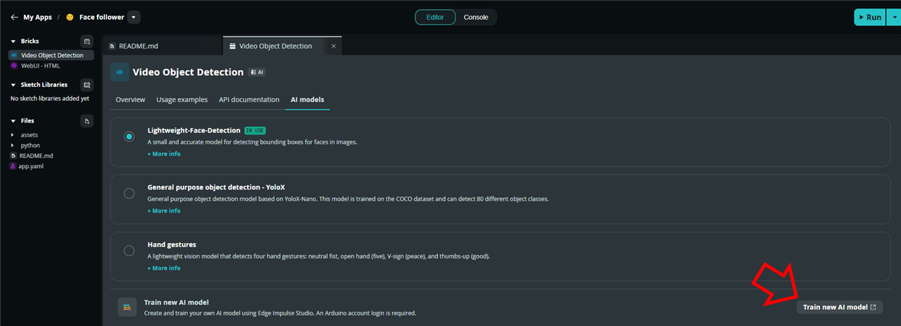

AppLab has a good example to start from: the face detection example. This example uses ML models to detect faces in the scene.
Let's make a copy of this project and start tinkering with the code.
The object detection is implemented by a brick, where several parameters can be adjusted to fit your needs. Among the other things, the object detection supports different models, even custom models created on Edge Impulse

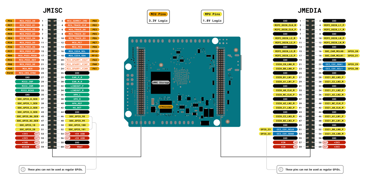

  • No support for advanced shields (JMEDIA and JMISC connectors). For example, there is not support for a CSI camera. You can use a USB camera with a hub, but this removes the benefit of having a small, all-in-one device. For robotics, adding a USB hub and camera makes the board much less useful
