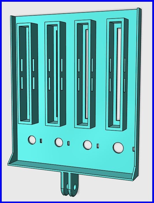

The Case
The 3D printed case features a GoPro mount and 8 button extenders. (shown in blue)

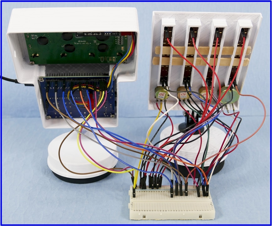

The Control Panel
The control panel has room for 4 rotary potentiometers and 4 slide pots. It uses popsicle sticks to retain the slide pots.
The Assembly
The assembly went smoothly although I had to dig deep into my stash to find enough bulkhead rotary pots.
The one with the different knob had a different shaft size.
image  image
Connections between the control panel and the display case are made using a breadboard as a patch panel.
Amazingly the slide pot pins work directly with Dupont jumpers.
