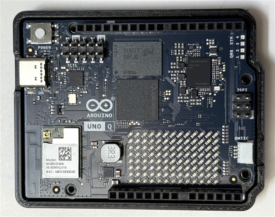

Overview
The Uno Q RoadTest caught my interest since there are relatively few entry level development boards that offer hybrid MPU/MCU architecture. The RPi5 does include the RP1 which is a dedicated IO controller, and maybe the most comparable board is the Radxa X4 which uses an Intel N100 and the RP2040.
The Uno Q makes some interesting design tradeoffs. It uses a Qualcomm Dragonwing QRB2210 MPU which uses the lower performance A53 cores that are used in the RPi3. And it lacks the normal IO ports that are generally found on MPU boards (USB host, Ethernet, HDMI) for standalone operation. It depends on using a powered USB-C hub to provide that functionality. It also does not have the CSI and DSI connectors that you find on other MPU boards that allow easily interfacing cameras and displays. The pins for these functions are available on the JMEDIA connector on the underside of the board, but these IO are coming directly off the MPU at 1.8V levels. To utilize this functionality, you need to use an adapter or shield that provides the IO level translation and connectors for the 3.3V CSI and DSI. Shields should be available later this year. The tradeoff is to use USB cameras and displays through the USB hub.
I wanted to see in this roadtest whether I could discover a use case that would be compelling to use the Uno Q. One of the highlighted features is the AppLab development environment that allows unified software development for both the MPU (Python) and MCU (C).
This roadtest is going to be about fitness for use in the types of applications that I develop rather than verification of performance specifications.  Other reviewers have done an excellent job of documenting the Uno Q hardware and setup, so I'm not going to repeat that except as it pertains to my specific application.  I have also provided links at the end of the review to relevant posts that I made.
I have been doing a lot of Edge Vision AI, so there is some emphasis on that functionality. I’d like to determine the difficulty of interfacing different camera types (USB, IP, SPI). I would have liked to have tried CSI cameras, but there are currently no available adapters.
The title of my roadtest, Uno Q Headless Smart Camera, reflects the end application that I am trying to achieve.

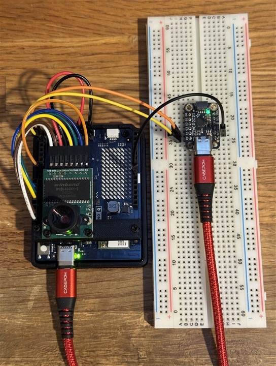

  • USB connected to PC Host
    Power is limited by the USB port (900mA for USB3)
  • Standalone
    Requires USB hub for display and keyboard/mouse
  • Headless
    Requires WiFi connection
  • Headless with OTG adapter
    Provides power passthrough with single OTG USB port

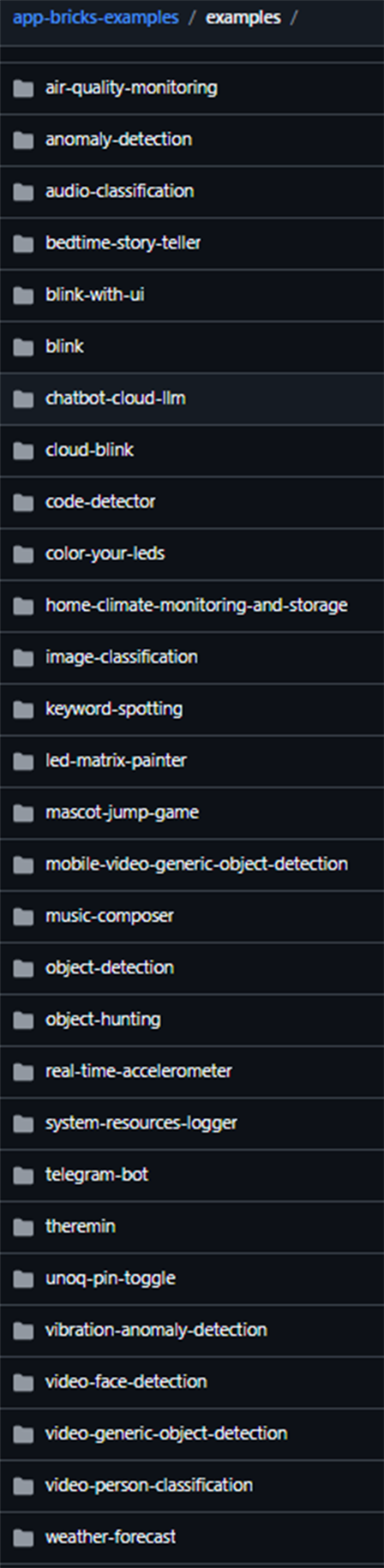

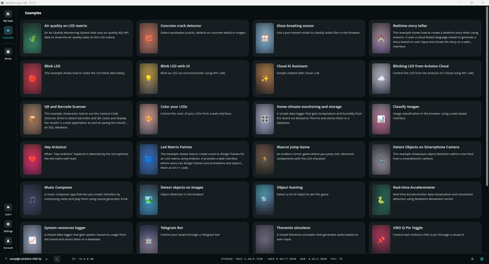

Arduino has done a great job of providing many sample tests to demonstrate the features of the Uno Q and AppLab
There are 29 apps provided in AppLab 0.7.9.  The latest AppLab update available during my review timeframe was 0.7.0.
The app repository is https://github.com/arduino/app-bricks-examples/tree/main/examples

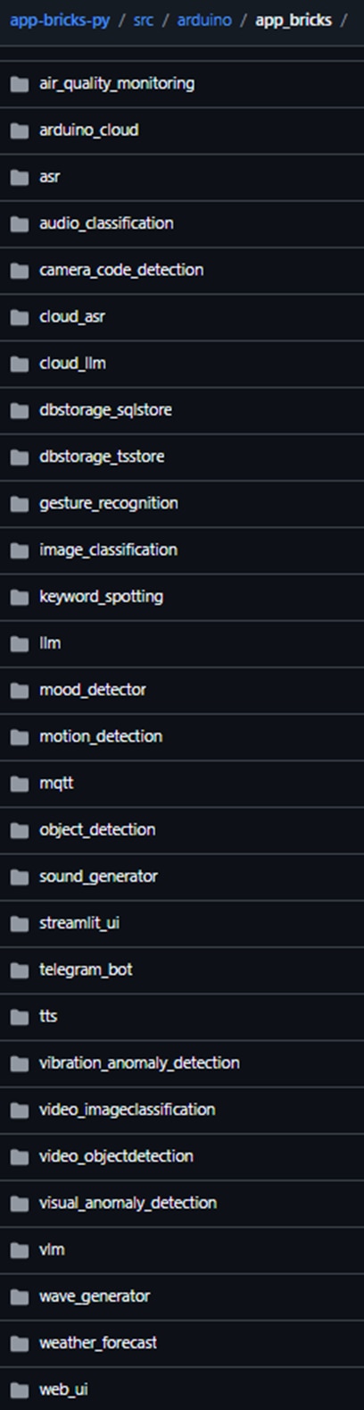

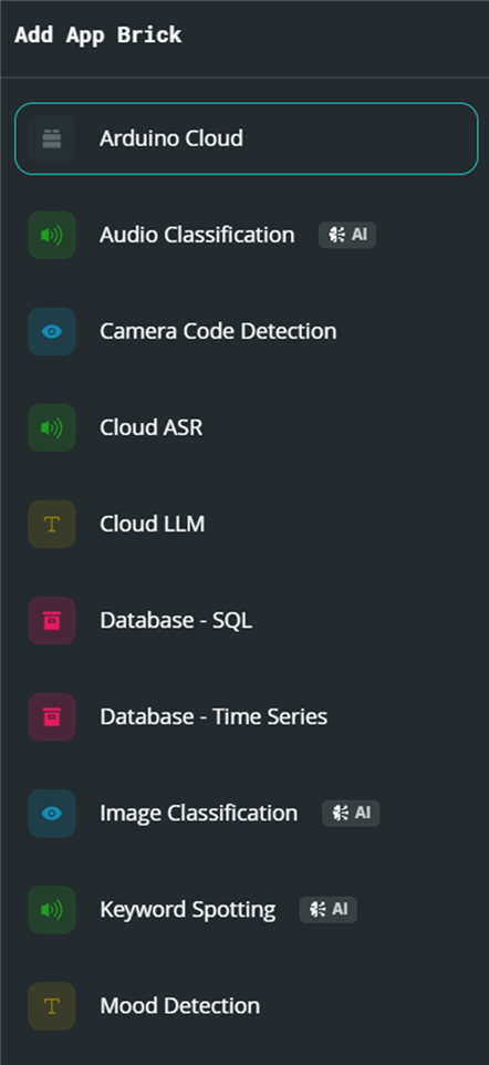

There are also 22 Bricks provided for use.  A Brick is a pre-built, modular software component that adds advanced functionality (like a “super” library).  These "plug-and-play" blocks bundle Python scripts, containers, and AI models to accelerate development.
The Brick repository is https://github.com/arduino/app-bricks-py/tree/main/src/arduino/app_bricks
The MQTT brick caught me eye, but it turns out that the MQTT functionality is embedded in the Arduino_Cloud brick and does not use a more general-purpose broker like Mosquitto.  I guess I’ll do it the old-fashioned way by adding Mosquitto to my application as I don't intend to use the Arduino Cloud.

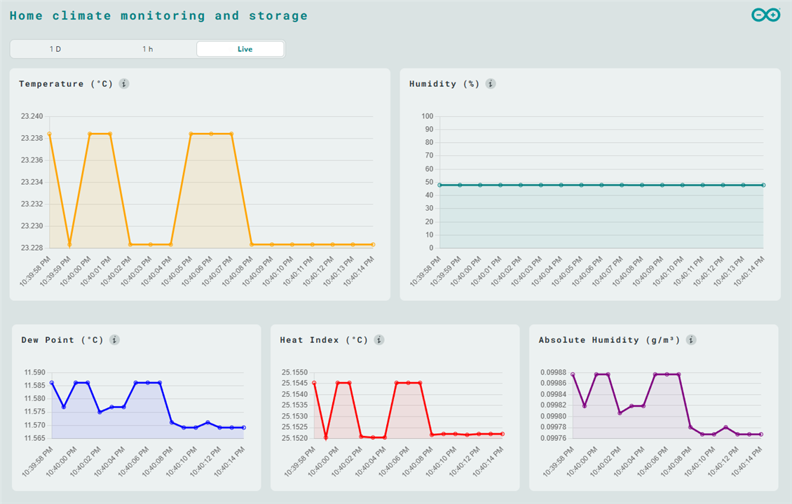

Home climate monitoring and storage
The Home Climate Monitoring example records temperature & humidity data from the Modulino® Thermo node, and streams it to a web interface.
The data is stored on the board, where we can view the data from the latest 24 hour period.
Bricks Used:
dbstorage_tsstore - makes it possible to save, read, and manage time-based data.
web_ui - used to host a web server on the board, serving HTML, CSS & JavaScript files.
I decided to use this example because I wanted to try out the Modulino Thermo and the QWIIC interface.

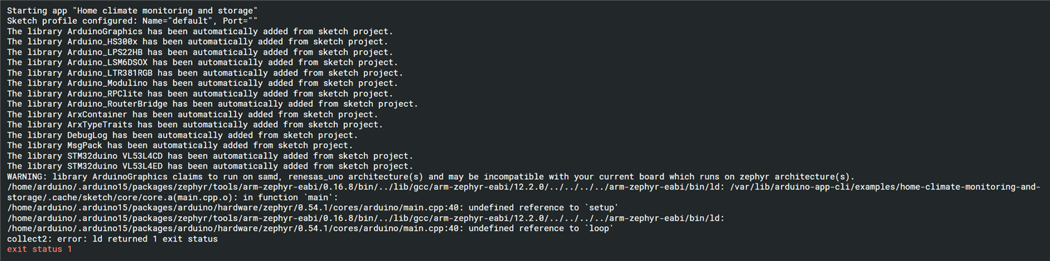

This was the first example app that failed to run.  It had a linking failure during compilation.
It is something related to Zephyr. One of the changes to the Arduino IDE used for AppLab is the replacement of the Mbed hardware libraries with Zephyr due to the end of Mbed support. I'm not completely sure what this error is, but an AI query suggested that Zephyr needed to recompile (due to an update) and it did not have permissions to update the sketch directory because examples are read only. I created a copy of the app which allows me to modify it and it worked without modifying the sketch source code.
The app uses the WebUI Brick to publish data to a web browser to display the data. The browser URL is unoq_ipaddr:7000.

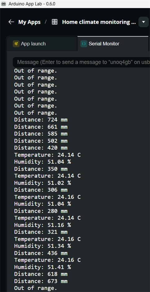

Home climate monitoring and storage with proximity detection
For my first custom test I decided to modify the Home climate monitoring example to add proximity detection using a Modulino Distance module.  I modified the Home climate monitoring app to display the temperature on the Uno Q LED matrix. I used proximity detection to only display data when a person is detected within 500mm. So in addition to the Thermo, I needed to add a Distance module. The setup is shown below.  The Distance (TOF) module is on the left and the Thermo (temperature, humidity) module is on the right with daisy chaining to the QWIIC connector on the Uno Q.

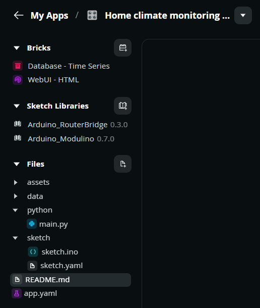

Here is a view of my app file structure.  Basically the same as the original app.
  • Two Bricks are used
    • Database for data storage
    • WebUI for the web browser based data display
  • Two Sketch Libraries are used
    • RouterBridge to enable communication between Linux and the MCU
    • Modulino that contains classes for all of the Modulino modules
  • Two primary app source files
    • Python - main.py
    • Sketch - sketch.ino
My new app just modifies the example sketch.ino file.

      if (distance.available()) {
        // 1. Force a measurement update
        int currentDistance = distance.get(); // Get distance in mm
        Monitor.print("Distance: ");
        Monitor.print(currentDistance);
        Monitor.println(" mm");
        // 2. Check your specific 500mm condition
        if (currentDistance < 500) {
            // Read temperature in Celsius from the sensor
            float celsius = thermo.getTemperature();
            Monitor.print("Temperature: ");
            Monitor.print(celsius);
            Monitor.println(" C");

A quick demo of the app.
A Serial Monitor output shows the result of my approaching from beyond 2m (Out of range)
Then temperature and humidity data starts logging when I am within 500mm and stops when I am beyond it.
Video showing the same sequence on the Uno Q LED Matrix (displays temperature only within 500mm).

Web Browser Viewer for SPI Camera
I was really hoping that the Arduino Uno Media Carrier would be available in time for the roadtest, so that I could try a RPi CSI camera or two.  In the meantime, I thought that I would try an Arducam Mini 2MP+ SPI camera that I've used in with other MCUs and the Arduino IDE.
This was my opportunity to try the Uno Q using the tried and true Arduino IDE on the host PC rather than using AppLab and connecting to the Uno Q via USB.  At the start it felt like an old shoe.  I could compile and upload MCU only examples like always, but as soon as I got to trying the Arducam camera library it failed immediately.  The Uno Q requires using the new Zephyr OS instead of the older Mbed OS. Understandable since Mbed is now EOL, but it causes issues with older libraries that have not been updated to Zephyr.
The other problem I had with the IDE is "where is my serial debug output".  Not in the usual Serial Monitor of the IDE.  Makes sense since the MCU doesn't have access to the USB serial on the Uno Q.  So, reverted to using a USB to UART interface connected the TX and RX pins on the Digital header and received the output in a PuTTY terminal on the PC.  I have FTDI boards somewhere, but I had an Adafruit MCP2221 that I was using elsewhere for I2C.  Maybe I'll need that for the Uno Q later...The hookup is shown below.
The library problems were class definition issues with data types and functions that were causing it not to compile.  Modification to the Arducam_Mini.h and .cpp files got the camera working and I decided it was time to move it into AppLab.
Created a new app and installed the Arducam Mini library.  This is the same version of the library that is installed by the standalone IDE, so I needed to modify it.  Next problem, where is the library?  I couldn't find it by searching the file system using the find command.  This is one of the quirks or features of AppLab that I've learned.  Installing a library using the Library manager does not actually install the library until you try to compile.  Of course, compiling also has the benefit of showing you the library path whether it compiles or not.  The location was /home/arduino/.arduino15/internal/Arducam_mini_1.0.1_becf652cd4feef8c/Arducam_mini.  A bit more obfuscated path than the standalone IDE where libraries are installed in a directory with the sketches.  Before I discovered where the library was (I was overthinking things and wanted to fix the library before I compiled), I took the cheaters way out and installed a copy of the modified library in the sketch folder.  Anyway, more than one way to skin a cat.
The Python code requests frames from the MCU over the Bridge.  The MCU captures the frame and returns it over the Bridge.  The Python code then stores the frame in the  "/app/assets".  The WebUI starts a browser window at unoq_ipaddr:7000 and and the browser pulls the new frames for display.
I was having a terrible time with intermittent behavior capturing frames over SPI when using either D9 or D10 as the SPI CS pin (I had used D10 without issues using the standalone IDE).  When I switched CS to D7, the problems went away.  The Arducam Mini has its own proprietary bridge chip on the SPI bus and there may be timing issues, but slowing the bus down didn't help - only changing the CS pin.  There is stuff going on behind the curtain with pin and function mux'ing when using AppLab.  As an example, I noticed on the debug UART that you get boot messages from the MCU before it switches to being Serial1 for serial print output.  I believe that the D9 and D10 pins were glitching when the MCU was initializing and causing the bridge chip in the Arducam to hang intermittently.

Anyway, I got it working, but I would say that it isn't worth the effort.  There is no shared storage between the MCU and MPU, so capturing on the MCU doesn't make sense because the update rate using the bridge is too slow.  It's better to wait for for the CSI interface to become available and do everything on the MPU..
