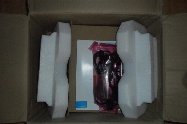

After receiving a battered-up package that bulged at its sides I feared that the device might not have survived the shipping in one piece. The power supply dropped down and the Styrofoam pieces which originally held it in place were lying partly on top of it. (Please excuse the bad pictures, I only had my smartphone at hand and couldn’t wait to open the package image)

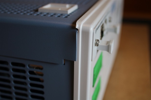

The power supply itself thankfully only received minor cosmetic damage at the rear where both sides got bent outwards and the bottom was dented.
An additional piece of cushioning material below and above the device might help in such situations as shipping damage is to be expected for such a heavy device, especially when it is sent to another continent as in my case. However having a look at the other two reviewers I was apparently still very lucky, and the damage was easy to fix during the teardown.
Included in the package was, next to the power supply itself with two 230V fuses preinstalled, the following:

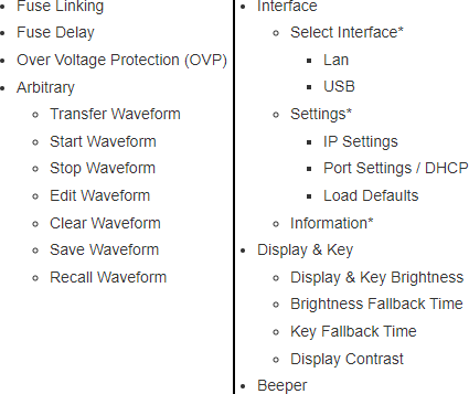

After pressing the Menu button, as you might have guessed, the menu is presented, with the following structure:
*: these entries may depend on the installed option

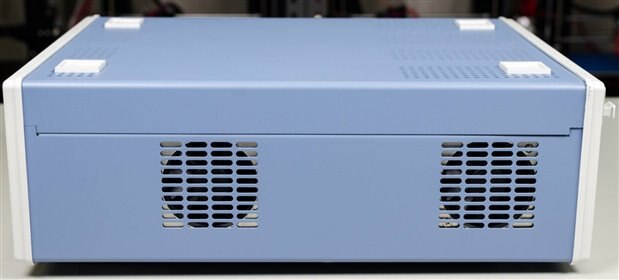

Not much going on on the left side apart from the two fans, which are quite quiet and even under full load do not seem to run at full speed. Also notice the small crack in the side of the back plate that happened during shipping.

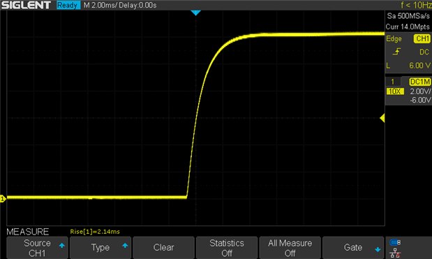

2.1 Turn-On and Turn-Off Behavior
Let us first have a look at the ramping behavior. Designers of power supplies need to make tradeoffs between the ramping speed and the prevention of producing overshoots, as they tend to be mutually exclusive.
     5V ramp up, no load                                                                                                                                 12V ramp up, no load
32V ramp up, no load
Without load the power supply shows excellent behavior with an average ramp up time of about 2.14 ms.

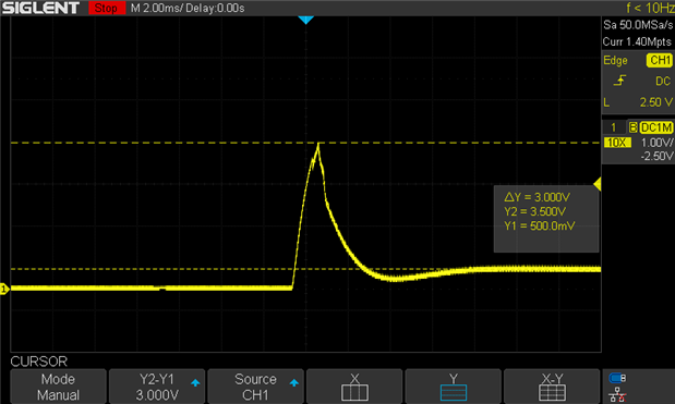

Voltage before ramp up
Sometimes, especially for low voltages it seems, there is a small peak before the ramp up occurs. I can not tell where this comes from but it is insignificant and its amplitude is not constant.

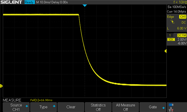

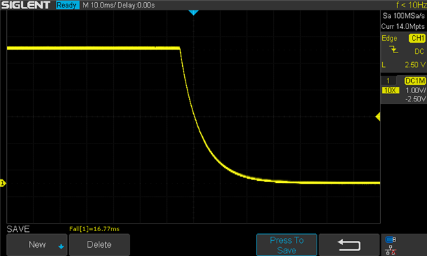

5V ramp down, no load                                                                                                                               12V ramp down, no load
32V ramp down, no load
When turning off the channel without load the output capacitor obviously gets discharged via an internal resistor, which leads to a mean ramp down time of about 16.9ms.

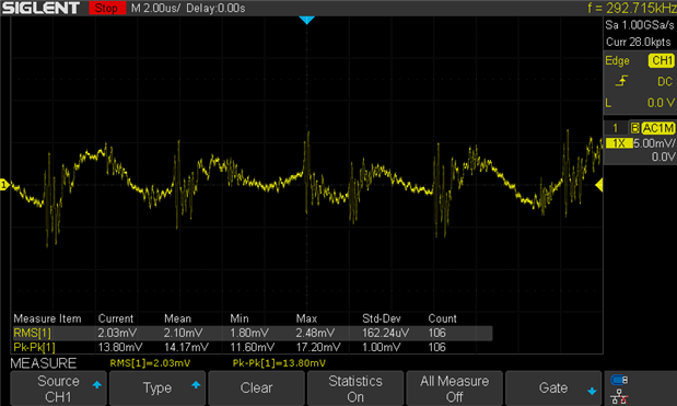

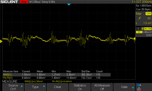

Next, we have a look at voltage ripple. The manual states a voltage ripple of <1.5 mV(RMS) for a 20MHz bandwidth limit, as well as a voltage ripple of <150uV(RMS) and a current ripple of <1mA(RMS) for a 100kHz bandwidth limit. The old Hameg website of the power supply showed scope screens of the voltage ripple for a full frequency range and with a 20MHz bandwidth limitation, which can still be visited at https://web.archive.org/web/20121016192547/http://www.hameg.com:80/595.0.html.
To measure directly at the output port of the power supply I used a DIY BNC to scope probe tip adapter, and a Siglent PP510 probe in the 1:1 setting. For all measurements a bandwidth limit of 20MHz and AC coupling was enabled.

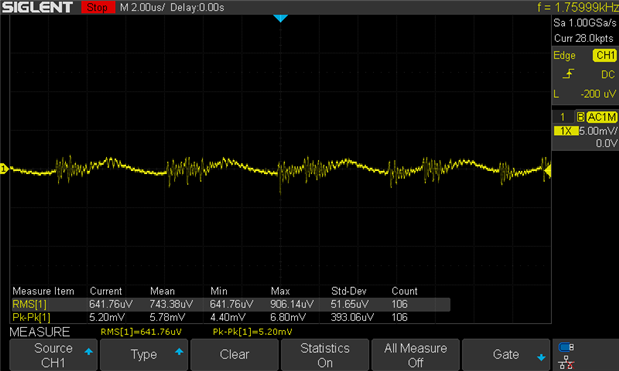

     5V ripple, channel off                                                                                                                          5V ripple, channel on, no load
Interestingly there is still some ripple when the channel is turned off. While the ripple voltage increases somewhat with voltage when the channel is turned on (as seen below), it is constant for a turned-off channel.
5V ripple, 1A                                                                                                                                                 5V ripple, 10A
12V ripple, 1A                                                                                                                                               12V ripple, 10A
32V ripple, 1A                                                                                                                                                 32V ripple, 5A
The  "ringing" contents of the ripple voltage increase in amplitude and length with increasing load.
FFT of 5V ripple
A quick look with the FFT function of my scope reveals major frequency contents in the range 2MHz to 8MHz, and additional components above 10MHz. I cannot completely exclude the possibility of some of my equipment interfering in this measurement, so additional measurements will be done once I get access to our RF measurement chamber at Uni image.

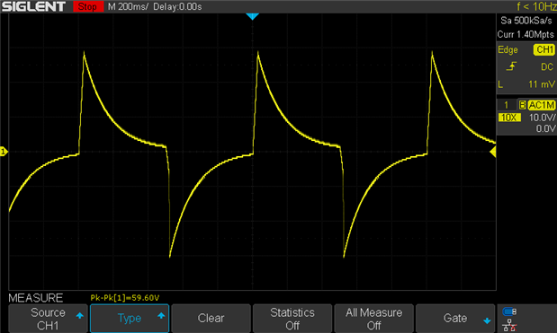

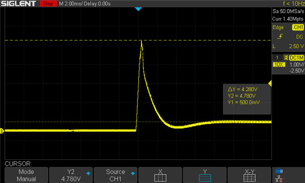

2.5 Power Supply Turn on and Turn off
Turning on the power supply did not produce any considerable voltage at its output terminals, owed to the relay that disconnects the socket to the power circuitry. However, turning off the supply can create a voltage spike at the output.
PSU turned off at 1V output                                                                                                                          PSU turned off at 3V output

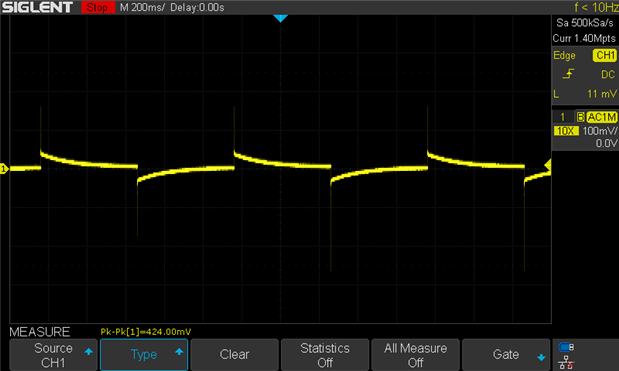

A hard switch off using the main power switch creates a voltage spike that increases with decreasing output voltage when a channel was left turned on. This spike can easily damage attached loads, so I can only recommend to first turn off the channels, or even better disconnect the load, before completely turning off the supply.

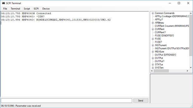

3.2 HMExplorer
On my computer an error message is shown every time the application is started or Add device is pressed, reporting a missing FTDXX.dll. Reinstalling the ftdi driver does not change this, however the application works without any noticable problem so I didn’t investigate this further.
Only three components of the application are available for the HMP series: SCPI Terminal, Screenshot and EasyArb.
SCPI Terminal
This terminal is a handy little tool for sending SCPI commands to the device manually or in a semi-automatic way. After selecting a supported device under Device in the menu bar, possible SCPI commands and a small description of their syntax are listed on the right side.
