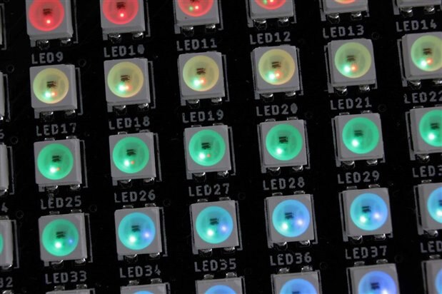

GAME ZIP 64: Zoomed in addressable RGB LED
Rainbow: Zoomed in addressable RGB LEDs
The :GAME ZIP 64 brings a very simple design which uses a two layer, 1.6 mm thick PCB as the main body, this build type feels rigid and doesn't seem to represent a durability risk as all the components soldered add extra rigidity. Every component is clearly labeled and as an added bonus, there is an online datasheet and plenty of documentation available.
The available expansion pads in my opinion have small holes, I was not able to use my mini-grabber test clips securely and found them getting disconnected some times when working on my tests; this may be by design, to keep components in place when soldering but, my take on small holes is that they won't allow solder to flow inside the holes properly by capillary action.
The 8x8 LED display is really bright!, so bright I found myself lowering its brightness at the first lines of code of most of my sketches. Brightness and colors seem consistent across all the LEDs, well except on one image -more on this next-.

Bad Addressable RGB LED
Seems the blue channel of one of the addressable RGB LED was not making proper contact; I believe bad solder is not the problem as we are talking about addressable RGB LEDs here. I think this issue may be due to bad contact of the conductors inside the epoxy encapsulation-, I realized this because it would work -at some times- when I put some pressure on it with my fingernail.

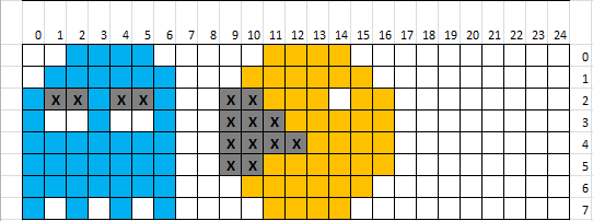

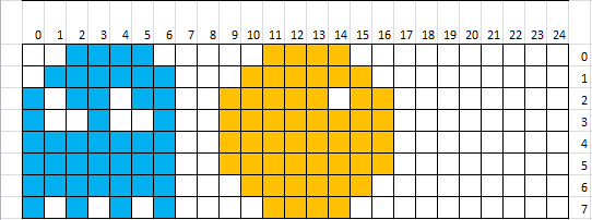

I then started coding a simple Pacman animation with sound. I created the animation by alternating 4 basic frames. When tilting the microbit left or right (roll) this would change what part of the next frame needed to be displayed (remember the display is only 8x8) giving the impression the Pacman is chasing a ghost.
To simplify the process, I initialized the the matrix with a basic template, and as the animation goes to each different frame, it just updates the pixels that would change at any given point of time only. Simple eh?
{gallery:width=542,height=232,autoplay=false} Pacman animation matrix
Pixels that may change: Pixels that may change between each frame, marked with X
Pacman frame 0: Pacman animation, Frame number 0
Pacman frame 1: Pacman animation, Frame number 1
Pacman frame 2: Pacman animation, Frame number 2
Pacman frame 3: Pacman animation, Frame number 3
