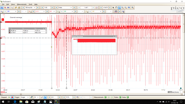

I used Picoscope 5444D to capture and evaluate startup, shutdown and 2A load transient response of a small and cheap SMPS DC-DC buck converter from Ebay (shown on fist picture).
This SMPS was fed with 12V DC, output set to 5V DC. Maximum output current is specified at 3A. EN port on the SMPS is fed with 0.1 Hz signal.

Startup without load. EN signal on CH1 (blue).
Startup with 2.6A load. EN signal on CH1 (blue). Heavy noise on signals.
Startup with 2.6A load. 1 kHz low pass filtering enabled on CH2. EN signal on CH1 (blue).
Load transient from 0 to 2.6A. Huge levels on noise.
Shutdown with 2.6A load. 1 kHz low pass filtering enabled on CH2. EN signal on CH1 (blue).
No load noise on output with 20 MHz BW limit.

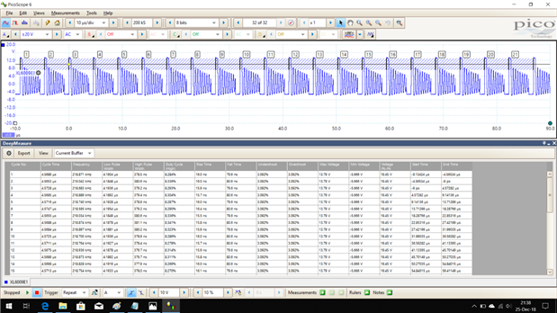

Another interesting feature of Picoscope software is the ability to display set of measurements for each cycle in a waveform captured after the trigger.
I tested this with boost SMPS module based on the XL6009E1 controller, with one analog channel connected to the SW (switching) pin.
It is possible to define the exact area of signal level and hysteresis that will be measured on each cycle.

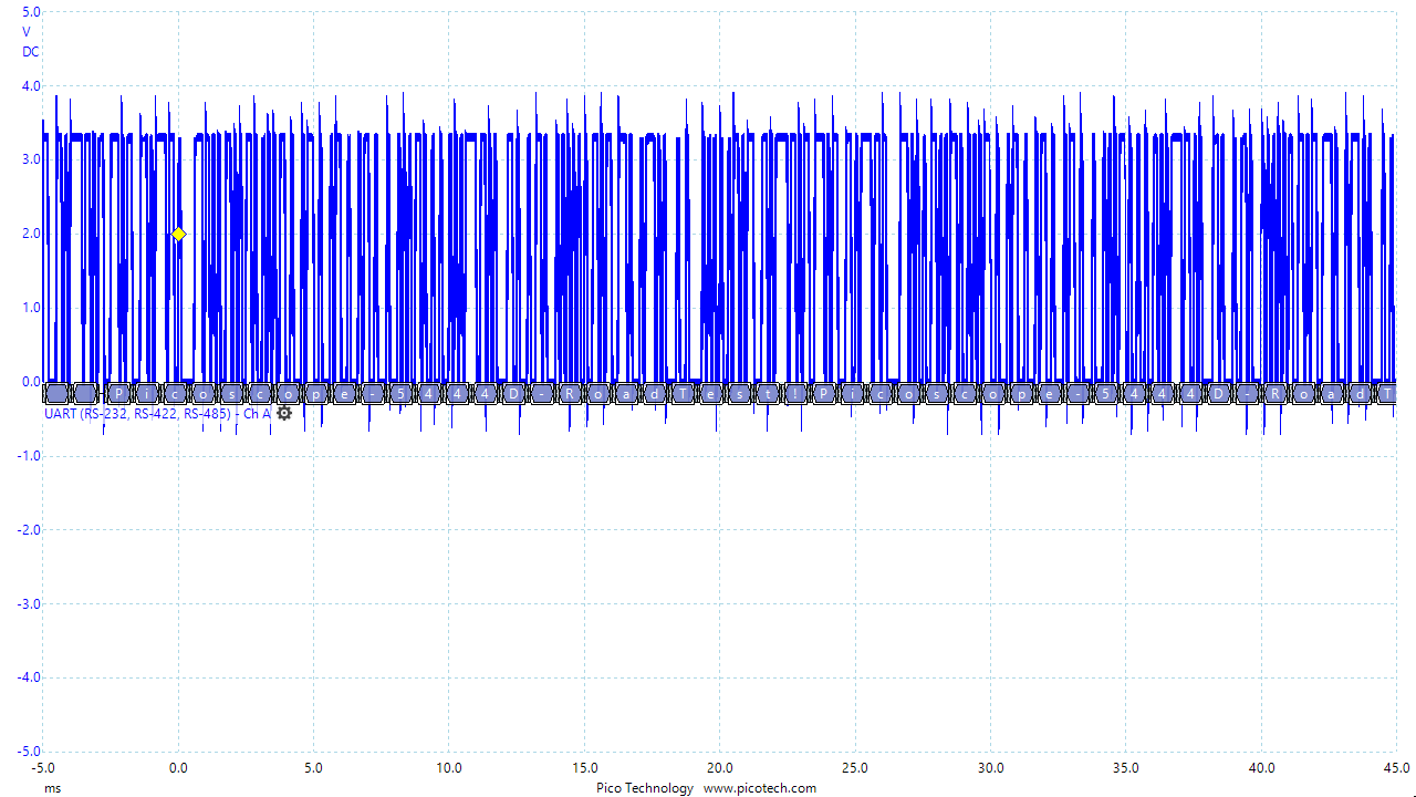

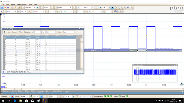

UART decode
For this setup I used a Mbed LPC1768 programmed to output serial stream with string "Picoscope-5444D-RoadTest".
I used one analog channel for this, and built in UART serial decoder.
You can check out the result in the gallery bellow, in a nutshell it performed flawlessly.

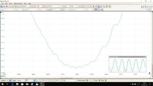

Second picture shows zoomed portion of capture with 16 bits of resolution.

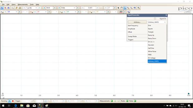

Picoscope 5444D is equiped with built in 20 MHz function and AWG, with BNC connector output on the back of the unit.
Supported functions are: Sine, square, triangle, DC voltage, ramp up, ramp down, sinc, Gaussian, half-sine.
AWG clock is 200 MHz, with 14 bits of resolutions and 32 kS of sample memory.
Usage is straightforward, with few clicks you can easily select the function, frequency, level, offset.
Sweep mode is also available, and generator can be triggered from another event in Picoscope software, allowing for all kind of setups.
Arbitrary generator is also complete and pretty to easy solution, you can import CSV file with defined waveform points, copy a waveform straight captured on on of the channels, select predefined templates, create a bitstream,  or you can even create waveform by free hand.
