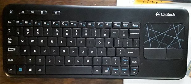

Logitech K400r keyboard.

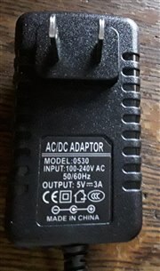

5 volt 3 Amp ac to dc power adapter.

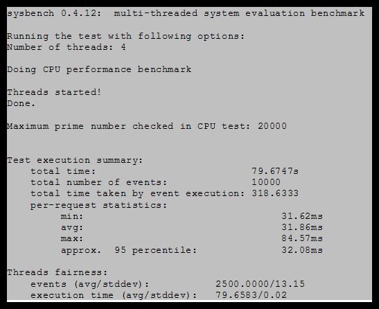

The following results were obtained using sysbench running primes generator on the RPi3 Model B+ set at 4 threads or cores:
   RPi3 Model B+ CPU running 4 cores
With  4 cores exercised on the RPi3, the RPi1 1 core is 91.4% slower!

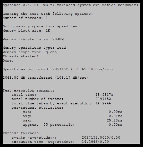

2. Memory Performance:
The following results were obtained using sysbench running speed tests in the read mode on both Raspberry Pi's and BBB set at 1 thread or core:
   RPi1 Model B memory read running 1 core                                      RPi3 Model B+ memory read running 1 core                                    BeagleBone Black memory read running 1 core
With 1 core excercised, the RPi1 shows a 87.2% reduction in throughput compared to the RPi3 and a 31.1% reduction in throughput compared to the BBB.  Apparently, the CPU speed also has a great effect on memory performance also.

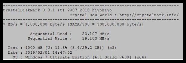

3. Ethernet LAN Performance:
The following results were obtained using CrystalDiskMark 3.0.1 on a Windows PC connected to the Raspberry Pi and BBB with a 1 Gb/s LAN Switch measuring sequential file throughput.  The U3 Sandisk microSD is specified at a minimum of 30 MB/s speed for both read and write.  As a baseline, I measured the throughput of the microSD card on the PC through the USB 3.0 interface and recorded a 43.92 MB/s Read and 42.33 MB/s performance. This therefore represents the upper limit of the testing capabilities for this setup.  In other words, as long as any results I get with the Pi or BBB is less than 42 MB/s I know that the microSD card is not bottle-necking the Pi or BBB results.
   RPi1 Model B 10/100 Ethernet                                                                           RPi3 Model B+ 10/100/1000 Ethernet                                                             BeagleBone Black 10/100 Ethernet
The RPi1 shows a 17.8 MB/s read (transfer from Pi to PC) throughput decrease which translates into a 77.2% reduction and a 11.5 MB/s write (transfer from PC to Pi) throughput decrease which translates into a 62.4% reduction when compared to the RPi3.  The upgrade to a 1 GB/s LAN on the Raspberry Pi3 B Plus shows a tremendous increase over the 100 MB/s LAN of the RPi1.
When compared to the BBB, the RPi1, shows a 6.2 MB/s read (transfer from Pi to PC) throughput decrease which translates into a 54.3% reduction and a 3.8 MB/s write (transfer from PC to Pi) throughput decrease which translates into a 36.9% reduction.  Here again I suppose that the slower CPU in the RPi1 is mainly responsible for the decreased performance over the BBB.

Power measurements were taken using the P4460 KillAWatt Power Meter connected to the 5 VDC adapter and in conjunction with the CPU performance tests previously described.  The efficiency of the 5 VDC adapter was calculated by connecting a 10 ohm load to the 5 Vdc output of the adapter and reading the corresponding P4460 value and determining the difference from 2.5 Watts.  This calculated efficiency is 73%.
The readings annotated below were therefore adjusted by .73:
