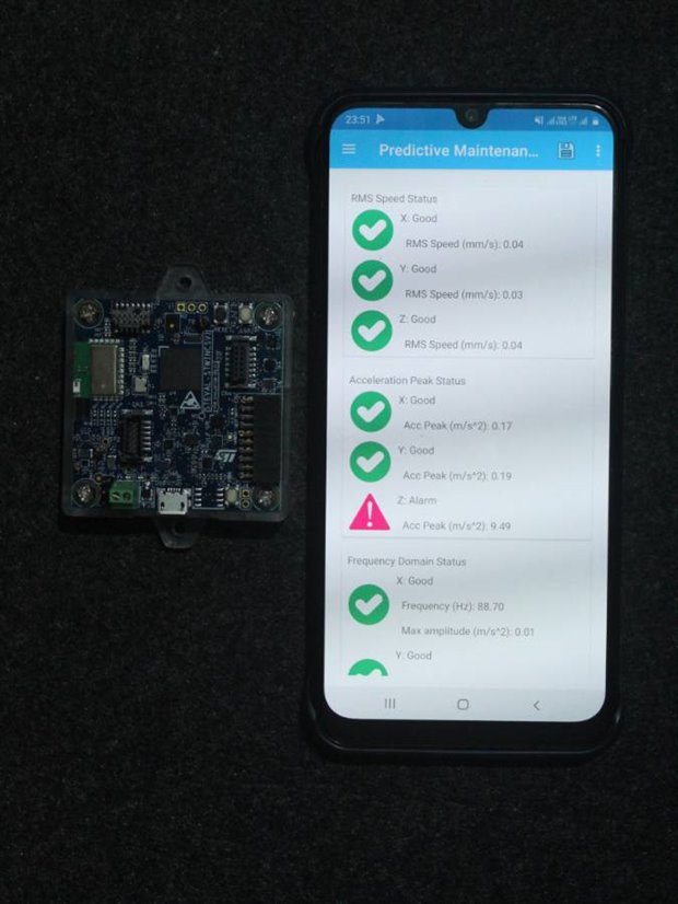

The kit comes preloaded with the predictive maintenance function pack (FP-IND-PREDMNT1) . As soon you power up the board via USB or included battery the green led starts flashing while waiting for an external connection via Bluetooth. We just need to download the ST-BLE-Sensor app which is available for android as well as iOS. The connection is straight forward and after a few seconds, we can see the data coming from the sensor.  The app has the following functionalities:
  • FFT plot of the vibration
  • Temperature , Humidity, Pressure
  • Data logger to save the plot of all the sensors available.
  • Predictive Maintenance Demo
  • Battery and Connection Strength
{gallery} STBLE-Sensor App
Power Up
Welcome Screen
Environmental Screen
FFT Screen
Battery and Network Status
Since the FFT plot feature attracted me the most, hence I tried it on an Industrial Motor Pump set-up at my home.

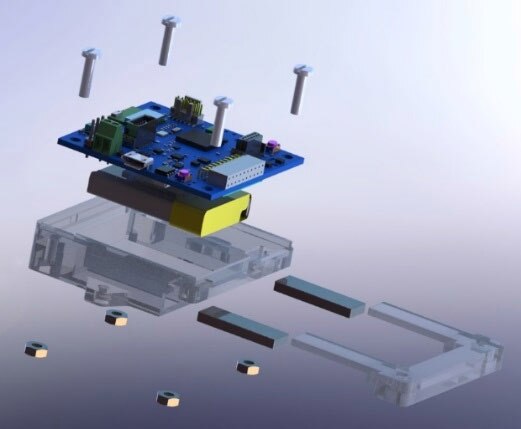

STWIN Assembly Steps:
To assemble your SensorTile Wireless Industrial Node, you need the following components:
• STWIN core system board | 4x M3 bolts and nuts | Plastic box (2 parts) | Battery (included in the kit)
• 2x Magnets (not included in the kit):  ECLIPSE MAGNETICS - N859ECLIPSE MAGNETICS - N859
Step 1. (Optional) Insert the magnets in the rectangular recesses in the bottom of the main case.
Step 2. Slide the U-shaped bracket into the main case. This will secure the magnets if they are present.
Step 3. Connect the battery to STWIN Core Board .
Step 4. Insert the STWIN core system board with the correct orientation .
             Make sure that wires don't get tangled between board and case.
Step 5. Fasten the core system board to the case using the nuts and bolts provided with the kit.
{gallery}  STWIN Assembly
Exploded cad drawing of STWIN node components
Optional magnets inserted in the main case
Core system board inserted in the main case
Core system board fastened with bolts

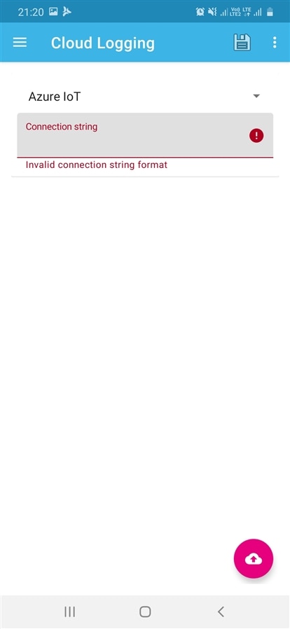

Azure Cloud
Battery Status Not Working

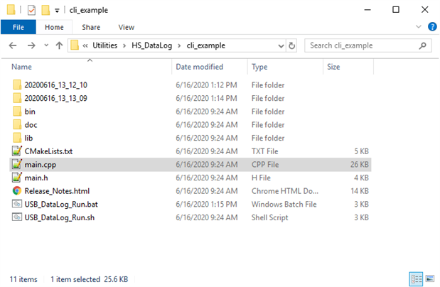

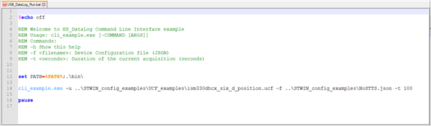

HS_DataLog:
This project has been hyped up is ST's blogs as well in the demo presentation and it does meet the expectations. The High-Speed DataLog firmware for STEVAL-STWINKT1 provides a comprehensive solution for saving data from any combination of sensors and microphones configured up to the maximum sampling rate and which can be used a tool for data scientists to monitor, analyze and log data of all the sensors in real-time. This has been quite possible due to easy-to-use scripts in Python(3.7) and Matlab(v2019a)  that are provided in the software package.

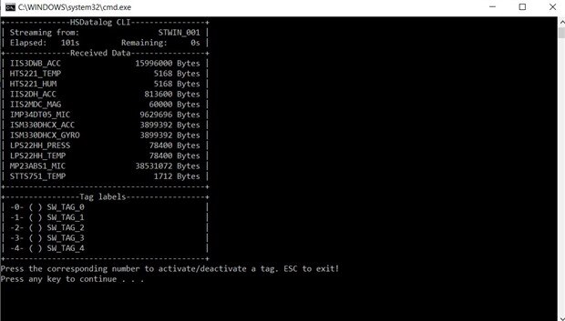

Once you have flashed the HSDatalog.bin to the STEVAL-STWINKT1 you are good to go. Browse to "STSW-STWINKT01_V2.0.0\Utilities\HSDatalog" to find the support libraries and executable. The "cli_example" folder contains a command line-based interface to interact and configure different parameters of the board. By double-clicking on the USB_DataLog_Run batch script inside the "STSW-STWINKT01_V2.0.0\Utilities\HSDatalog\cli_example" the application starts, and the following command line appears, showing information about the connected board. Before running the script we need to configure the settings by using some JSON configuration examples in the directory "Utilities/HSDatalog/STWIN_config_examples".
The application creates a YYYYMMDD_HH_MM_SS (i.e., 20200128_16_33_00) folder containing the raw data, the JSON configuration file, and the UCF configuration file if loaded on PC or SD card.  BLESensor App allows us to configure all the parameters of the sensors, and start/stop logging data on the SD card makes data logging a breeze. However, for longer periods of data logging the App and the board fails to communicate, and the only way to stop logging would pressing the USER button. Functionality to label\tag a particular part of data for a specific time period while performing the data logging makes it useful in certain types of data-driven algorithms such as supervised machine learning.
Hardware tags allow automatically enabling/disabling a tag according to the logical state of a pin on the STWIN STMOD+ connector. This can be extremely useful when the monitored equipment already provides some electrical signals that reflect the machine status, connecting these signals to the hardware tag pins allows retrieving this information during data acquisition.

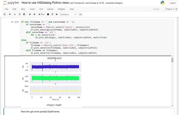

ST has provided post-logging support by providing Python(3.7) and Matlab(v2019a) libraries to analyze the recorded data, which is a good addition as not many players in the markets provide that support. I'm not well versed with MATLAB Scripts hence limit the scope with python scripts only. The Python scripts and classes available in the HSDatalog package can be used to handle the datasets obtained by the HSDatalog firmware.
In-order to make use of these scripts you have to copy the desired data folders inside the HSDatalog/python folder. You can either use "How to use HSDatalog Python class.ipynb" for a more procedural approach or "HSDatalogPlot.py" along with command options for a direct approach.
HSDatalog Python class.ipynb:
  • Search Jupyter notebook is the search bar of the same directory where the .ipynb file is present
  • Select the notebook when the Jupyter session opens and follow the comments mentioned in the notebook.

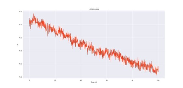

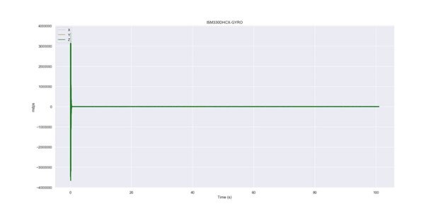

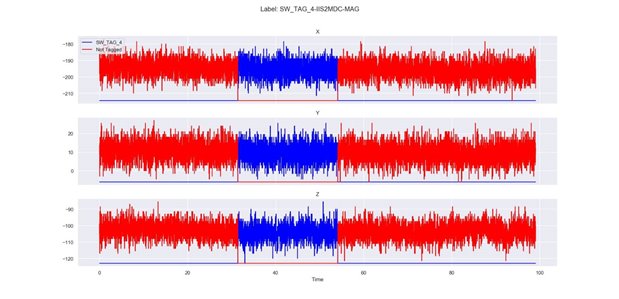

Here are some amazing data plots generated from the python scripts. The data plotter GUI is customizable and allows the user to change the color as well as configure the axis parameters of the plot.
{gallery} Un-Labelled Plots
{gallery} Tagged Plot
