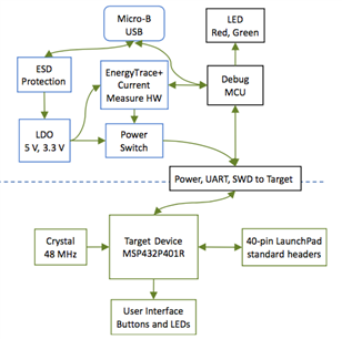

Special attention has been put to the low energy capabilities that are not only peculiar of the MSP432P401R microcontroller but also the entire launchpad board. As a matter of fact it is surprisingly that the board is built in two parts. The bottom half respect the micro USB connector is the launchpad board while the top half is the circuit of the XDS110-ET on-board emulator including the Energy Trace Technology implementation. This design can incredibly simplify the development and debug process, always with special attention to the power consumption.
More in-depth details on the launchpad board can be found on the ti.com site at the following link: MSP432P401R LaunchPad - MSP-EXP432P401R - TI Tool Folder (maybe you should be registered to access the technical details of the site products and devices).
What happens running a project based on this board to the emulator and the energy trace circuit board ? The two half boards (or, better the two boards on the same PCB) can be isolated through a series of jumpers converting the board from a lab development kit to a effective prototype working board. The jumper settings are shown in the table below.
