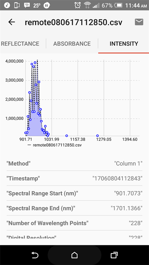

My first scan was of an IR remote. It's a cheap little one with an IR LED, and I honestly didn't know what the beam profile would look like. I see the expected peak in the 900 nm range, but see several peaks, which I didn't really expect. At first I wondered if the light beam is coming out "choppy" due to the diffraction grating of the NIR DLP device. But I expect this is the true output, and that this is perhaps the noisy IR output of the very cheap IR remote.

    As for the choppy spectra from IR remote - I also noticed this, but in my opinion that does not depend on the quality of IR LED. I noticed that this device does not work well with pulsed radiation. When I tried to measure my IR remote, peak was moving from 940nm to 1600nm. It was very inconsistent. The remote worked at 37kHz if I remember correctly. I will perform a better analysis on this subject, perform scan at different frequencies.
  • Thought about the pulsing problem a bit more. I've looked at the waveform of my specific IR remote, and I can see that it sends several square pulses and then has a large dead period. Couldn't find a picture off-hand but it's similar to the image below.
    So depending on when the spectrometer takes the reading, it may be sampling at a period where the LED is actually off. I guess the easiest fix is to take a series of readings, and use some software to combine them and fill in the blanks.
    Here is image of my "chopped result" from my IR remote. Seems like the high points are regularly spaced. Also, the low points are not complete zeros. So I am still quite unsure about all of this image
    That image isn't visible for me, Jordan
