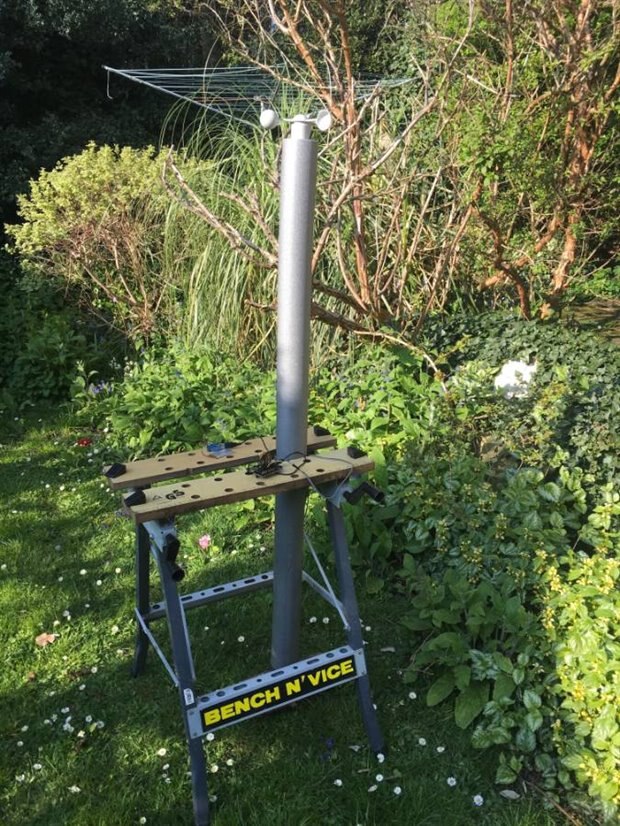

I already have my own home made Picaxe-based wireless weather station using a wind speed and direction gauge that I bought from Maplin a few years ago and I didn’t want to dismantle that. However, a few months after I had bought mine, I noticed that they were selling spare wind speed gauges for about £5 and I bought one as a spare since I know they wear out eventually. The Maplin gauge is a rebadged “Fine Offset” windspeed sensor that is used in several other weather stations. Having that sitting in a box, I thought I’d use it to complete the micro:bit weather station. Not wanting to lose the RJ11 plug, I made an RJ11 adapter to connect the wind sensor to the Klimate board’s GPIO pins.
The outdoor part of the weather station is the Klimate board with micro:bit, a power supply and the windspeed sensor (connected between 3v and P8 so that a pulse is detected on P8 when the reed switch in the sensor closes). I didn’t have a spare wind direction sensor but I don’t find them terribly useful where I live as there are too many trees that cause random air currents. The outdoor part transmits the sensor data using the micro:bit’s onboard radio.
The Klimate board can be powered either from the micro:bit’s USB connection, a separate (power-only) USB connection on the board, or screw terminals. The power connections are regulated down to 3.3V on the board, and I used an Adafruit Powerboost 500+ to provide 5v from a 3.7V Lipo battery via a USB connector.
As I already have a wireless weather station, I didn’t try and make an enclosure for the Klimate board plus micro:bit. Ideally, the Klimate board would sit inside a Stevenson screen and the windspeed sensor would be mounted on a pole well above roof height. I suppose I should make one, one day, but for the time being, my weather station sits inside a box under the eaves of my garage and the wind sensors are on a pole on top of my garage.

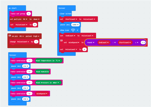

The MakeCode blocks for the “sender” and “receiver” are shown below. The code just counts the number of pulses per second and uses the manufacturer’s provided formula of 1mph=1.5 pulses per second. (n.b. If you wanted to add a wind direction sensor, you would need to use an "analogue read" block to measure the resistance across the sensor's terminals as it spins round. This is because wind direction sensors use a resistor network coupled with a reed switch to detect which way the pointer is facing).
[sender]
[receiver]
