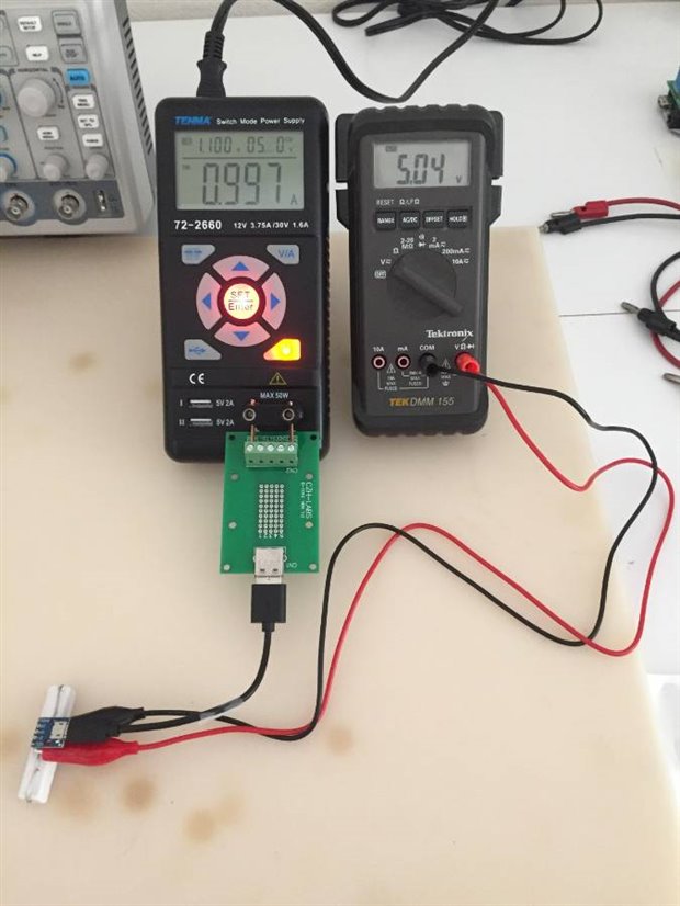

I was inspired by Doug's roadtest and I also must admit to being somewhat cavalier using USB cables to supply power to my various SBC and microcontroller boards although  I do run into occasional issues (more frequent now with current requirements of 2+ amps).  So I put together a little test jig so that I could attach USB to microUSB cables to the power supply output.  Then I went to my cable box and randomly selected 16 cables of various lengths (I probably have 40-50 micro USB cables in total with about half of them in use).
Here is my setup testing a short cable

Of the 16 cables, two of them actually had open ground connections (I suspect this is a connector issue).  Of the rest, I found 2 that I marked as bad because of too much overall voltage drop.
Here is a plot of resistance per inch for the different lengths tested (measured at 1A):
Based on the data I would say a "good" cable would have less than 30 mOhms per inch resistance.  It is interesting that the longest cable has the lowest value.  It is using a larger wire size to mitigate the total resistance.  I wish vendors would just indicate the AWG of the wire in the cable.  Over a small sample there is no correlation with voltage drop vs length or O.D of the cable.  So, my mantra of shorter is better doesn't always apply.  I probably should start measuring the delivered voltage in my different setups.

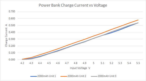

USB Power Bank Input Current
I have a number of different USB power banks that I would like to charge from small solar panels and I want to characterize the input current vs input voltage requirement.  I have a number of power banks from different vendors at capacities from 2Ah to 20Ah.  I'll need to check the characteristic over various charge states, so for this roadtest I've just verifying that the procedure will work.  I wish the supply had automated control capability since it is using a STM microcontroller but that would be asking for a lot at this low price point (I think it mainly a programming effort, plus adding an interface).
I am using the same USB test jig for this setup and manually sweeping the voltage while monitoring the current.
I tested 3 of the 2Ah units and here are the results:
Reasonably well matched but I'll need to check vs charge state.  So, I should be able to get the info that I want, just need to invest the time.
