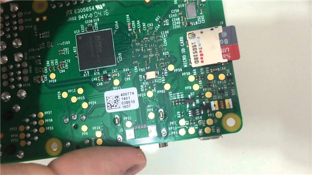

Insert the Micro-SD memory card (having the Raspbian OS image) into the Raspberry-Pi.

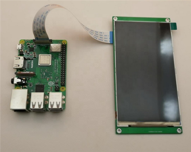

d. Connect the Raspberry-Pi to a 3.5" (or) 5" (or) 7" TFT display, using the DSI ribbon cable to the DSI slot on Pi.

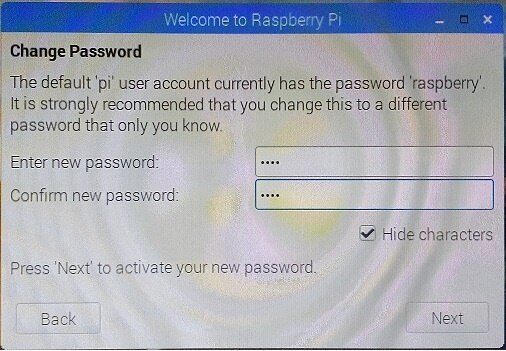

Being first-time boot (on newly installed OS), you would be prompted by the Setup to change the password.

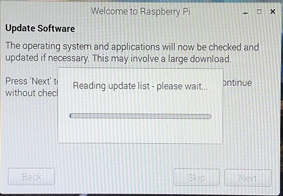

Next, the Setup would give you an option, to Update the Software (which is an optional step).
If 'skipped', the software update can be done at later stage also (using CLI command).

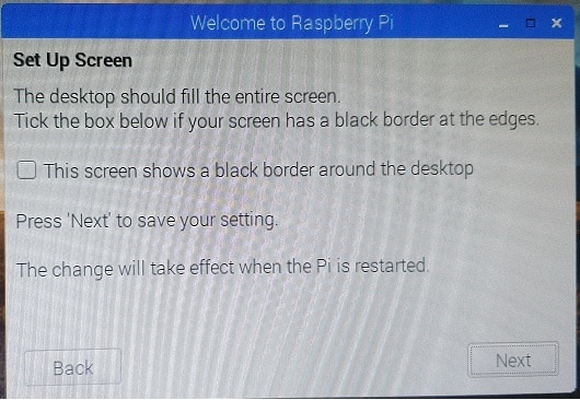

Setup will now, prompt you to 'Set Country / Language / Timezone'.
Next, the Setup will try to calibrate the display screen.

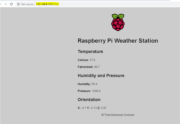

The 8x8 LED matrix should light up and begin scrolling sensor information, from weather.py
web_app.py takes the same data as weather.py but instead of displaying it on the LED matrix it creates a web server and displays it via the web using flask.
So, you can also view the sensor information using the web browser and pointing it to port 5000 of the raspberry pi's IP Address
(from any device (PC/Laptop/Mobile) connected to the same Wi-Fi network)
