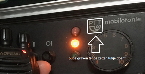

In order to test if this works I transmitted a signal at 145.275 using a handheld radio, and indeed this signal was received by the radio, as can be seen in the picture below.
This proves the pcf8587 IO extenders works.
