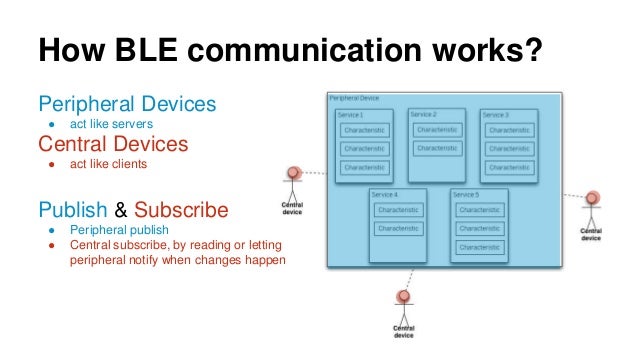

    2.2 BLE 101
          Over here, I'd like to provide a brief, intuitive understanding of how BLE works. Within a BLE ecosystem as it is a 1-to-1 connection, there are only two devices, a peripheral and a central (also referred to as slave and master respectively.) The peripheral usually generates data and the central demands it, however in some cases it may be the other way around. I won't go into how exactly BLE varies from Classic Bluetooth, but suffice it to say that BLE, as the name suggests, uses a lot less power and is usually used in data packet transmission such as data acquisition from sensors as opposed to traditional Bluetooth, which is more optimized for data streaming.
          So how do a peripheral and a central communicate?
          Think about the peripheral as a notice board. It has a lot of notices on it, which correspond to services on the peripheral. Services are a set of variables (for the sake of abstraction) which can be read from or written to, according to the properties specified by it. These variables are called characteristics. Thus, each service is essentially a set of characteristics. A peripheral may have a number of services. Now, coming back to our notice board analogy, suppose a central is interested in only one particular notice. It will look at that notice and nothing else. This is done by hooking on to the required service/ notice using a unique identifier called a UUID. Every service and characteristic has a UUID. Once the central has connected to the peripheral via the desired service, it can read or write to the characteristics within that service according to their properties.
