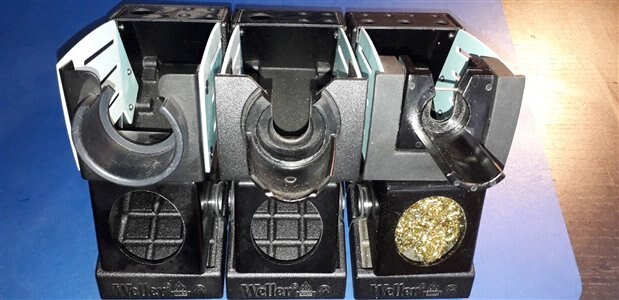

The safety rest is quite sturdy and heavy. It comes with a metallic stand used to hold the tips that can be attached via screws.  . I ended up replacing the sponge with the brass sponge for cleaning the iron’s tip.
The safety rest for the soldering iron is called the WSR. (Weller Safety Rest). It comes equipped with a brass wool and a yellow rectangular sponge as well as a holder for the iron tips.
Personally I like the brass wool. The main disadvantage of the sponge is that wetting the tip imparts a thermal shock on the tip which requires a second or two for it to reheat again to the original temperature.

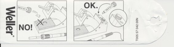

    Since you have the correct Safety Rest for the solder pencil, can you confirm an operation for me.
    The image is from a tag found with my unit. It does not reflect the Safety Rest configuration I have but does show the barrel and tip assembly.
    If I remove the barrel from the solder pencil, (still containing the tip), and place it vertically in the circle holder on the Safety Rest, the tip rests on the sponge. The distance is not sufficient to keep the tip from touching the sponge. Also the holes in the circle holder that supports the barrel are too large in diameter to hold the tips only, the tips fall through.
    Can you confirm in your Safety Rest does:
    1. the barrel & tip assembly touch the sponge while sitting in the circle holder
    2. the circle holder actually hold a tip without a barrel.
    I made note of the component errors in my review Weller Soldering Station WT Series - Review  but did not include all the above commentary. If the Safety Rest and pencil are a mismatch then issues are due to arise. I'm curious to discover if the difficulties I describe, actually exists when the Safety Stand is matched to the correct solder pencil.
  • Sean,
    Weller stands usually fit the iron like hand in glove. I think your suspicion - that the stand you have isn't matching the iron - is correct.
    I have an iron, a heat gun and a desolder iron here from Weller (they came in one kit), and they all 3 have different stands that are designed specifically for the tool.
  • I suspected as such.
    Knowing the mismatch, I didn't think harping on the issue provided any value in the RoadTest Review. It would have been nice to match the pants with the shirt so to say.
    I am a one tip kinda guy, so a Rest with flexibility to hold multiple bits is redundant. I guess it would be a good place to store a spares.
