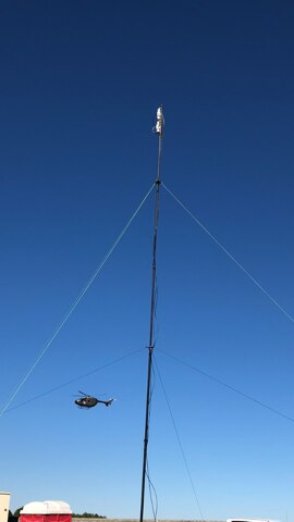

During my testing I found that the Siretta Graphyte -LTE Analyzer did great in locating the direction of the strongest signal strengths with the included directional antenna.  We also used a longer piece of coax that helped get the analyzer antenna as high as the cellular antenna on the cradle point (picture below).  Using this diagnostic tool, we were able to increase the overall gain and data speeds by 15 megabytes.  This was due to getting the cradle point antenna directed to the closest available tower.  It also help determine which service would give the better quality in that area.  While this may have been possible without using the analyzer it would have taken a long time to do constant speed test and shift the antenna a few degrees every time. While monitoring the analyzer the antenna mast was very slowly moved a few degrees and the data from the analyzer was monitored.
