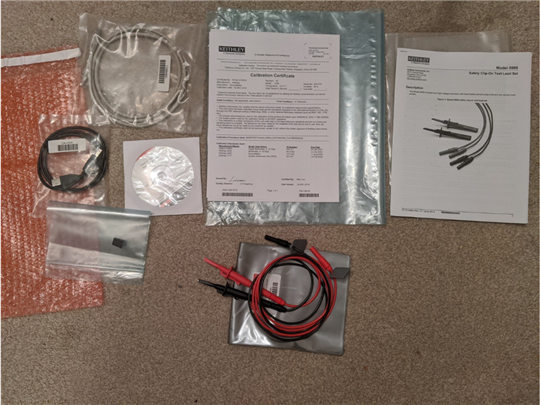

3. Unboxing and first impression
Same type of packing as when I got the DMM6500 from Tektronix a couple of years ago, excellent packaging, the unit comes very well protected.
The unit came with a lot of extras:
- Power cable (US)
- Quick start guide and safety notice
- Old version of Keithley KickStart on a CD
- Ethernet cable
- USB cable
- Interlock connector dongle
- 2 Test leads

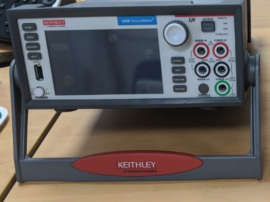

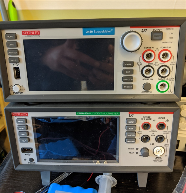

4. Comparison between the case of SMU2450 and DMM6500
The SMU2450's case is slightly bigger than the DMM6500, however both would still fit in a rack cage if needed.
One thing I consider as a great improvement is the built in stand, as you can see in the photos below the 6500 comes with 2 small legs that do not give a robust feel, whereas the 2450 has a one piece stand that can be tucked underneath if not needed.

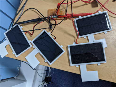

7.3.2. Testing multiple-cell configuration
I created the same configuration in the figure below using a small prototyping breadboard to demonstrate the use of a source meter in characterising IV curves.
(all measurements were taken indoors, so current values are very low, and not accurate since it wasn't measured at STC).
One of the solar cells was covered to show the effect of a bypass diode and how the SMU can be useful in capturing the curve.

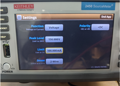

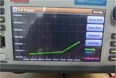

7.4. Application 4: High voltage test
The 2450 is rated up to 200V however I tried different loads and the highest voltage I was able to source was around 43V. I spent some time trying different loads but just couldn’t pinpoint the source of the problem. I will post an update when I hear back from Tektronix. The photo below is from a resistive load rated at a maximum of 80W, highest voltage reached was 42.8V.

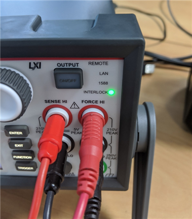

10. Update [High voltage sourcing, and interlock safety connector]
I seem to have missed using the interlock connector [MPN: CS-1616-3], which was the reason the output voltage in section 7.4 was limited to around 42V.
Once connected, the 2450 can source voltages at the full range of the device up to 200V.
When pins 1 and 2 are connected using a jumper wire, and the connector is plugged into the back of the unit, the green Interlock led at the front panel switched on.
10.1. IV-Tracer to source high voltage to an electronic load.
IV-tracer data is captured in KIckstart:
