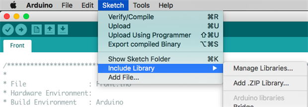

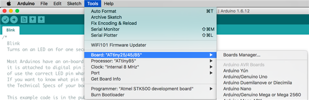

The board can be programmed using the official Arduino IDE and in my testing I used Arduino version 1.6.12. The default setup comes with basic board support and you have to manually add the hardware BSPs.
Adding Board support to the Arduino IDE
The process of adding support packages to the IDE is simple and explained as follows.
Click on Tools -> Boards -> Board Manager
Scroll and find the ‘Intel Curie Boards’ from the list and click ‘Install’. This adds the board support
That’s it. This helps when you need to add or remove support and don’t want to download files from github and stuff.

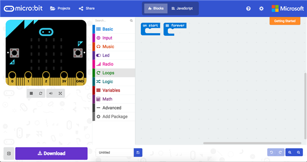

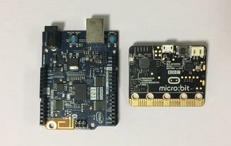

There are other players already in the market that are oriented towards the beginners. I would consider the BBC Micro bit to be a direct competitor to the Genuino 101 and a good one at that. The BBC Micro bit features a Cortex M0 processor with GPIOs and similar sensor and BLE.
It can be programmed using mBed for the programmer friendly types and Touch Develop for the kids who prefer the graphical programming path.
Unlike the Arduino which is targeted towards the hobbyist and maker, the BBC micro Bit is aimed towards teaching so its a better fit for the beginners. The nRF51 Cortex M0 give more advanced user the ability to fiddle with the BLE in more complicated ways. I suggest taking a look at my BBC Micro Bit Review where I made a line follower robot.

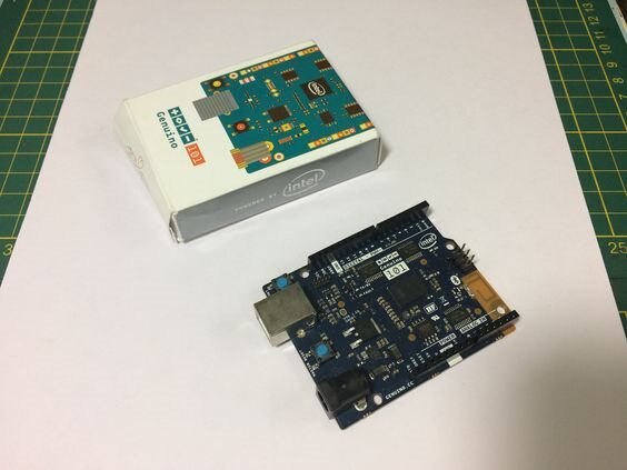

Getting started was simple enough and as outlined, adding board support was relatively easy. My workbench is usually one with a lot of tit-bits and I had to move the board around… a lot! I found that the board was not as rugged as its older cousins and as a result the power supply protection circuit collapsed without any warning.
Schematic Download
What that means is that I am no longer able to power up the Genuino 101 from USB. I can still power it from the DC Jack and I can still program it using the USB which means that the FPF2496 has seen its last working day. On the part of the documentation, the files are incomplete at best.
The documentation indicates the presence of Test Points however the board has no silkscreen nor is the associated documentation anywhere to be found. It is expected in the first iteration of the board however the community has not taken a shine to the board either and consequently very few discussions are available on the subject.
