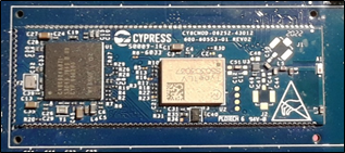

The board is built around the PSoC 62s-based CY8CMOD-062S2-43012 PCA which combines the PSoC 62s MCU (CY8C624ABZI-S2D44) and the CYW43012 based Murata Type 1LV module for dual band 2.4/5.0 GHz WiFi & Bluetooth 5 operation.
Features of the PSoC 62s MCU (CY8C624ABZI-S2D44) include:
*  150-MHz Arm® Cortex®-M4 and 100-MHz Arm Cortex-M0+ cores,
*  2MB of Flash, 1MB of SRAM,
*  Secure Digital Host Controller (SDHC) supporting SD/SDIO/eMMC interfaces,
*  Programmable analog blocks,
*  Programmable digital blocks,
*  Full-Speed USB,
*  Serial memory interface,
*  Industry-leading capacitive-sensing with CapSense® and
*  PDM-PCM digital microphone interface (Not implemented on the board)

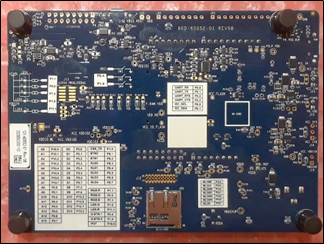

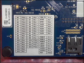

The box arrived undamaged, always a good sign, and well packed.  The actual dev kit box is well constructed to endure most rough handling.
As listed in the user guide, the PSoC®62S2 WiFi-BT Pioneer Kit (CY8CKIT-062S2-43012) I received included:
1 – PSoC®62S2 WiFi-BT Pioneer Board,
1 – USB Type-A to Micro B cable,
1 – Four jumper wires (four inches each),
1 – Two jumper wires (~five inches each) and
1 – Quick Start Guide
The instructions for downloading the user’s guide, software and additional resources are shown on the back of the box.

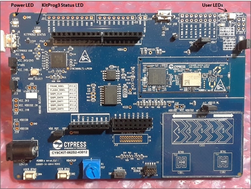

The board is shown below:
NOTE:  For the examples given in the Quick Start and User’s guides, all required components were supplied.  However the User’s Guide is more of a setup guide since it only shows how to get up and running with the kit and offers virtual no examples other than the pre-installed firmware.

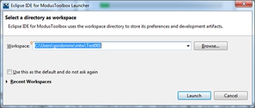

From the ModusToolbox home page, click the download button corresponding to your operating system.
I install the software on my Windows 7 pro (x64) laptop.  The setup wizard will appear followed by the typical License Agreement popup, for which you must agree.  The rest of the steps are straight forward as outline in the installation guide.  I used the default responses where needed.
ModusToolbox IDE start up screen -

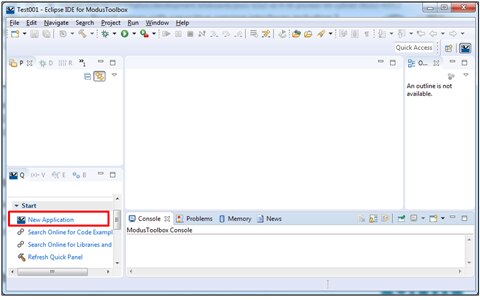

Back to the only example in the user manual, Hello World.  First open the ModusToolbox and select the workspace directory.  The default base directory is <user_dir>/mtw.
Click “New Application” in the Quick Start panel to bring up Project Creator 1.2. Project Creator walks you through specifying your hardware base as defined by your dev kit or MCU.  The panel on your right outlines a brief description of the selected H/W platform.  Then click [Next]

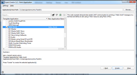

The next Project Creator window will display the list of available examples in your solution collection under Template Application.  A summary of the requirements for each example is shown in the lower panel. This is important because some examples require addition resource before they can be build and/or run.  For the user manual example, check the “Hello World” and then click [Create] to start the process.  The process downloads the latest source code (~165MB) so depending on the speed of your PC, size of the download and internet service, this may take a few minutes.
After the download is complete, highlight the <project name> in the Explorer section, then scroll the Quick Start section until your find <project_name> Program (KitProg3_MiniProg) and highlight it to start the build.
When the build is complete the firmware is automatically loaded to the board.
