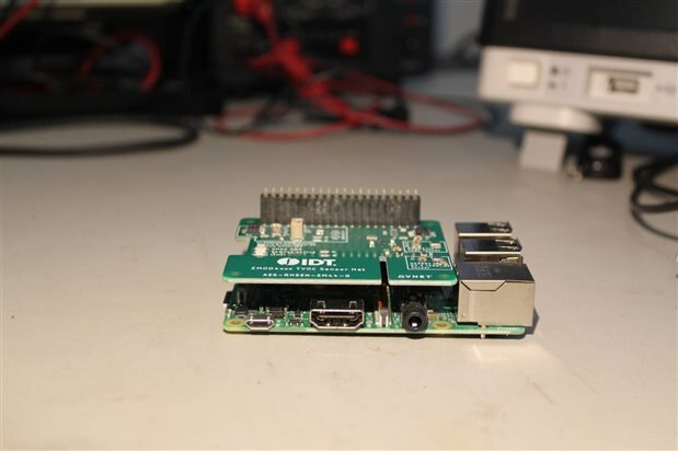

Installing Avnet's Renesas ZMOD4410 Indoor Air Quality HAT onto the Raspberry Pi 3 was straight forward. The included male-female 40 pin header makes the connection easy. Be careful not to stab your thumbs when pushing the pins through the HAT's header, like I did. It hurts! My blog covers the steps needed to get the system up and running.
The HAT performs very well and quickly adjusts to changes in the environment. I was impressed at how quickly a breath, odor or nearby use of cleaning chemicals would trigger a change in IAQ readings – often by the next sample (3 seconds) with a peak reading in 30-60 seconds.
The MOX sensor measures TVOCs which are important measurements to determine air quality. Another important contributor to air quality is fine Particulate Matter (PM) such as smoke particles, which do not seem to be measured directly by the sensor. However, PM should be more applicable for an outdoor sensor. Still, many particles emit VOCs which should then be detectable by the sensor. Carbon Dioxide measurements are estimated (eCO2) and not measured directly. Additional sensors may be required to get a complete air quality picture, however the MOX measurement of TVOCs should address most indoor applications.
Fitting closely to the Pi, the HAT traps heat from the single board computer. This heat influences the board's HS3001 temperature sensor readings which consistently record higher temperatures than ambient air. When using the Pi and HAT installed in the case in a room at 22 degrees Celsius, the HAT's HS3001 MEMS temperature sensor was registering 41 degrees. Without the case, the temperature sensor would still reach 33 degrees. Installing the HAT further away from the Pi would help alleviate this but would create a more cumbersome configuration.

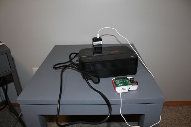

The Pi will draw additional power when the HAT is powered, however, the total draw remains comfortably within the Pi's specifications. When idle, the Pi with HAT installed draws around 320mA. This jumped to 400-550mA when the HAT was actively sampling. Running a basic application on the Pi increased the current draw to 650-800mA and likely higher when I was not looking. It is important to use a quality power cable and power supply to avoid low voltage warnings and spontaneous system reboots as I experienced using a 1A Apple power cube. The recommended power supply for a Raspberry Pi 3 B is 2.5A at 5.1V.  A 2A supply worked just fine for my application.
474.9mA, 5.077V during a sampling cycle
One of the results of the power requirement is that the setup becomes largely stationary when in use. I had occasions where I wanted to move the setup without shutting down the application, however my portable USB battery did not provide enough power. After several failed attempts I resorted to this “mini pocket size” setup:
Ensure your portable power supply can provide at least 2Aimage

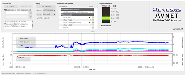

My evaluation included demonstration software, version 7.0.1 for use with Avnet's Renesas Indoor Air Quality HAT. This software is great to demonstrate some capabilities of the HAT, but is not suitable for consumer or general use, despite its reasonably polished appearance. This may be ok as the software and HAT are positioned towards evaluation and demonstration purposes.
The HAT included a getting started guide which points users to the location of the software. I was not off to a good start as the guide did not cover the software use and installation. Searching on the Avnet and Renesas sites turned up a ton of useful information on air quality, the sensor's performance and technical data. Unfortunately, information to get the HAT up and running on the Pi was not found there.
The installation was mostly intuitive but there was one issue: there are additional steps (explained in my blog) required to get the software running. These steps are not described on the product support sites. I took the extra step of reaching out to Renesas technical support. The response was extremely helpful and listed all the steps necessary however, they explained that further support was for corporate customers only. Set up instructions should be added to the getting started guides.

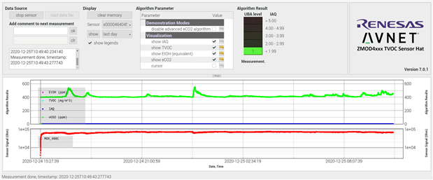

The software logs 35 variables for each sample in a CSV file and shows a few of key interest within the application - five of which are presented using nicely displayed and informative graphs. With one sample every three seconds, the log files get large quickly – very large. I could not find information on the support websites to explain what each of those 35 variables mean however, I suspect there may be some references available for corporate developers. Unfortunately, while seeking information about these variables, Renesas support became no longer available for this non-corporate customer. Is a reading of 86531.54710458081 for MOX 400C good? Or bad? What is "MOX DEC 350C"? More information would be helpful to isolate the cause of a poor IAQ reading.
I experienced several crashes of the software while displaying a duration of results longer than the last hour. When displaying a week, or even a day's worth of samples, the Pi would instantly go to 100% utilization on one of it's four cores. At that point, the software becomes barely responsive or crashes completely. The software leans heavily on Python and the performance could be improved by using a different solution to generate graphs on the Pi. Perhaps the software can leverage compiled code with capability for load balancing across the processor cores or by summarizing the data points.
Frozen screen with processor core 3 running at 100%. I often lost data when this occurred.image
For this evaluation, crashes were frequent and resulted in several corrupted data files and many re-tests. I found software problems to be very frustrating! I lost some interesting data as a result of crashes. The software needs work.

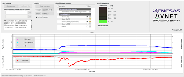

1) Office
While many Canadians are working at home, my department works mainly from the office because we are a designated critical service of the government. Questions surrounding air quality are amplified by the current pandemic. While I have long suspected the air quality in my office was poor, the evidence suggests that the air quality is not too bad – that is until I show up in the office, then it goes down from “clean” air to “good” air.
IAQ in the officeimage
The peak and continued IAQ levels between 2-3 occur when I arrive and stay at my desk. Am I the cause of reduced air quality? I do shower everyday! Thankfully, I was breathing which is the likely culprit. IAQ remained within good levels.

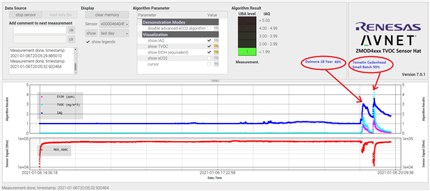

As a final test, I decided to breathe on the sensor after sampling a couple wee drams of Scotch whisky! The Dalmore 18 is one of my favorites with spicy chocolate notes and smooth finish. The Tomatin Cadenhead Small Batch is also very nice but at 110 proof it is closer to the look and taste of a fine gasoline as reflected in the results. The Tomatin presented the highest TVOC reading I saw in any test. Should an IAQ profile accompany whisky tastings? If so, I have a lot of sampling to do – bourbon is next!
Scotch tasting - a more objective way
Scotch under test

    I was able to get demo software working for a longer periods of time by selecting only one parameter to visualize during data capture. As it saves all sensors data to a file you can load them later for analysis.
