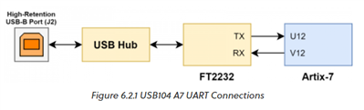

  • FTDI FT2232HQ USB-UART bridge:
One can use PC applications to communicate with the board using the standard Windows COM port command.

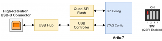

2.1 Detecting the USB-Serial Communication when connecting the board to PC for the first time and running the out-of-box demo.
2.2 Testing onboard USB-JTAG Programmer

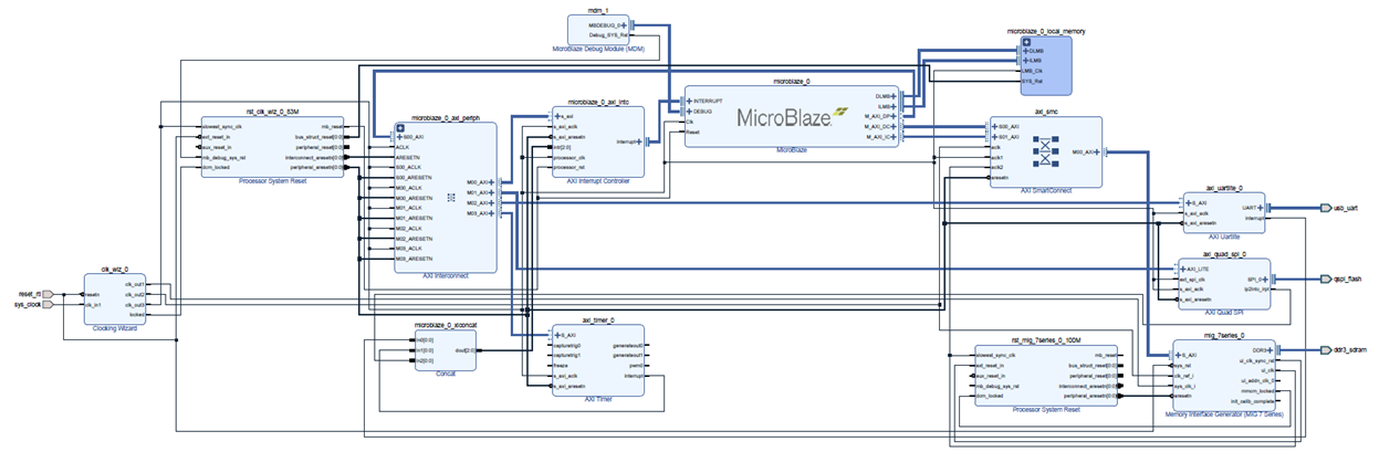

2.6 Design to boot Linux

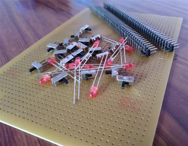

2.7 Testing the GPIO with custom Pmod Starter
       (Includes an interesting section that explains the purpose of this board)

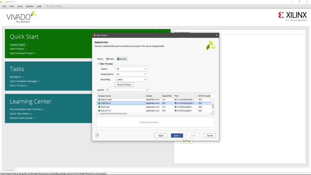

2.1 Detecting the USB-Serial Communication when connecting the board to PC for the first time and running the out-of-box demo:
For the development of block designs and ease, the board files are provided on the Digilent website which can be downloaded and added to the design. Vivado detects the board as soon as it is added to the respective directory - C:\Xilinx\Vivado\<version>\data\boards\board_files
The above images show how Vivado immediately detects the board files for their use in IP and block-based designs.
The board files can be found here: https://github.com/Digilent/vivado-boards/tree/master/new/board_files/usb104-a7/B
2.2 Testing onboard USB-JTAG Programmer:
In this test, a simple HDL code for a half adder will be executed on the FPGA to test the on-board buttons, LEDs and finally program the FPGA using the bitstream generated and programmed into the FPGA

Getting Started
Tab Content
Create Project image
Give the project a name without spaces
Select the Design Entry type
Select the board image
Click Finish image
A Master XDC file is used as a constraints file for easy coding which can be found in this link: https://github.com/Digilent/digilent-xdc/blob/master/USB104-A7-100T-Master.xdc

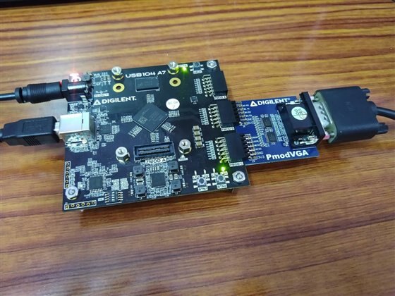

2.4 Testing a design with Pmod VGA:
A sample code to test Pmod VGA in VHDL. Resolution: 1920 * 1080 @ 60Hz

The VGA Pmod is connected to JB and JC as shown below:
Working video:

This phase of the test consists of creating a block design with MicroBlaze and the Pmod SD IP and using the Xilinx SDK to check the read-write capabilities of the SD card.
The SD card will be connected to the JA Pmod connector on the board.
One more thing that should've been included with this board is the system-reset button which should've been an active low button. Almost all IPs such as the MicroBlaze processor system reset and the MIG series comes with default active low reset mode. While this option of having a system reset button is available in the Arty based boards, this board lacks the dedicated system reset button.
The below image shows how I had to use a resistor connected to one of the GPIOs to use it as an external system reset.
After creating the block design, run the synthesis, implementation and finally generate the bitstream.
Launch the Xilinx SDK after exporting the hardware with bitstream included.

The images given below explains how the USB hub is used in the USB104-A7 to route various signals.
{tabbedtable} Comparison Tab Content
In regular boards
Micro USB directly connected to the FT2232 Chip for both JTAG and USB-UART in Regular boards
USB104-A7
FT2232 Connected to the Hub rather than directly connecting to the USB
USB104-A7
JTAG connected to the USB Hub via the controller
USB104-A7
FT232 Connected to the USB Hub for DPTI

Testing the GPIO with a custom Pmod:
I shall start by saying the quote: The expert at anything was once a beginner.” – Helen Hayes
People starting to learn hardware description languages might need the slide switches and the LEDs for sure.
As one would've realized by now that the board still lacks much user GPIO because it's all consumed by the DPTI and the Zmod, to address this issue, a custom Pmod is fabricated.

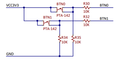

Let's take a look at the schematic for the fabrication.
image         image
Design made with NI Multisim:
From the schematics, it can be understood that using a 10k resistor would be used for pull-up and pull-down purposes.
As there is already a 200 Ohm resistor connected in series to the Pmod GPIO to prevent damage to the FPGA if one accidentally drives an input as an output,
only 100 Ohm resistor is used in series with the LEDs. All switches are active high. The circuit diagram is given below:
Started with the above components, some PCB mount slide switches, LEDs, and the Bent Male-Male Dual pin headers.
After soldering all the components and the connections:
