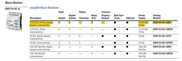

    I highlighted the units I am looking to get for the roadtest: Easy-E4-UC-12RC1

  • mp2100
    mp2100 over 4 years ago in reply to cghaba
    If you look at the model number of the PLC that Randall highlighted, " EASY-E4-UC-12RC1 ", it looks like that model does not come with the screen and keypad.  There's a dash -- in the column for display and keyboard.  (yes, I see the left column mentions them, but why is there a dash instead of a rectangle?)  So if that's correct, we'd definitely be using the EasySoft to program it.
    [edit] I see Randall is going to ask for both types.  The EASY-E4-AC-12RC1 does include the display and keyboard.
  • cghaba
    cghaba over 4 years ago in reply to mp2100
    In the user guide for both models is specified "Base device with display". You can also see on the parts (PN: 197211 and PN:127215) webpages:
    https://datasheet.eaton.com/datasheet.php?model=197211&locale=en_GB&_lt=
    and
    https://datasheet.eaton.com/datasheet.php?model=197215&locale=en_GB&_lt=
  • cghaba
    and
