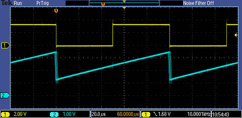

    Same VHDL design seems fine with my Brevia 2 board (XP2 FPGA with Diamond 3.12 IDE). Here's the 555 ramp waveform locked to 10kHz divided down from the board oscillator. Lots of jitter, though. I wasn…

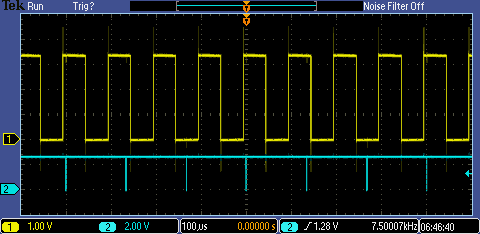

    Progress update (just in case anyone is interested).
    That's the best I've managed so far - that's with a Max II CPLD doing the logic bit. Yellow is a 10kHz reference signal divided down from a xtal osc. Blue is the 555 VCO output that's supposed to be locking to it. It is locked, but in a 3:4 ratio (fractional locking!). The reason seems to be because Quartus is helpfully 'elaborating' my design for me and I can't seem to stop it (the phase comparator design is an asynchronous state machine, so it needs to be implemented as designed). I might give up with fiddling with all the myriad of settings and try it later with a Lattice part.

    Good results, neat idea using the CPLD to get around the FPGA implementation. I think a separate phase comparator could be easier, since as you say even the CPLD portion implementation will be different. I remember you ordered some 74HC4046, the phase comparator portion of that could be used. From memory it may be good for several MHz.

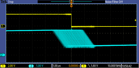

    Lots of jitter, though. I wasn't very scientific with the loop filter (just picked up some likely looking bits from the bench), so I ought to be able to improve that.
    It was really nice seeing the 555 waveform snap into place the moment the programming of the FPGA had completed.
