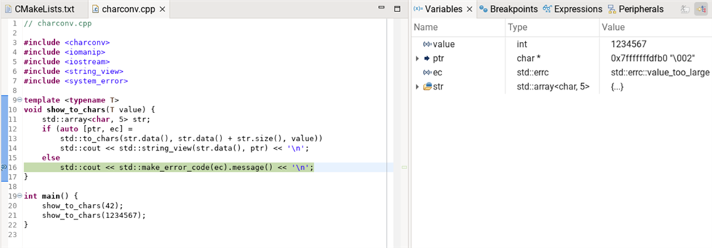

Here is an example of how to use it:
std::array<char, 5> str; if (auto [ptr, ec] = std::to_chars(str.data(), str.data() + str.size(), value)) std::cout << std::string_view(str.data(), ptr) << '\n'; else std::cout << std::make_error_code(ec).message() << '\n';
The function std::to_chars() returns true if successful, falls if failed, and you can get at the relevant response. We pass it a numerical value. If successful, ptr points to the string representation of the passed value. If it failed (e.g. because the string representation does not fit in the buffer), ec contains a std::errc object that holds error information.
