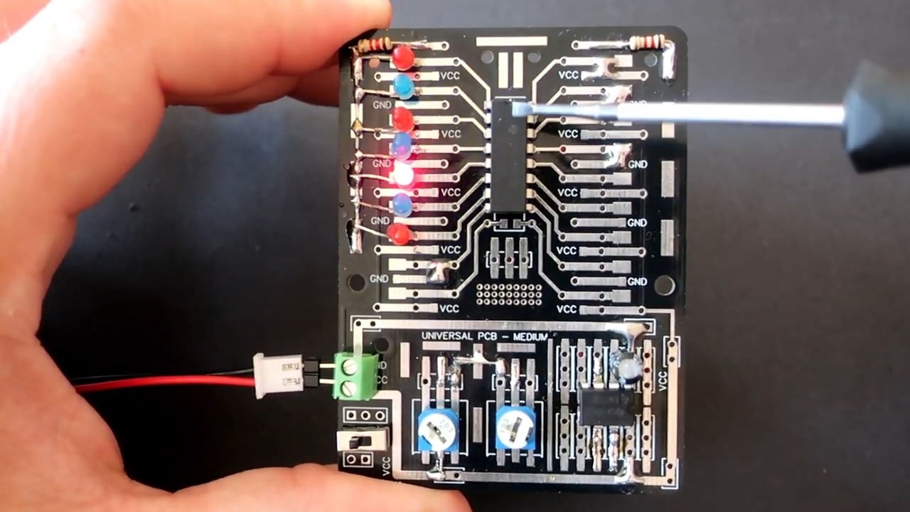

&lt;p&gt;Also, I really like stuff that Volvos does! In fact, I have some of the &lt;a href="https://www.youtube.com/watch?v=LHi-jsuVtwA" rel="noopener noreferrer" target="_blank"&gt;prototype boards&lt;/a&gt; he designed. (and they are great!)&lt;/p&gt;
&lt;p&gt;&lt;img alt="image" style="max-height:360px;max-width:640px;"  src="https://community.element14.com/resized-image/__size/1280x720/__key/communityserver-discussions-components-files/7/555-and-Counter-Example.jpg" /&gt;&lt;/p&gt;&lt;div style="clear:both;"&gt;&lt;/div&gt;</description></item><item><title>RE: Tools (or tricks) to develop graphics/animations for OLED displays (single-color 128x64 or 64x64 style)?</title><link>https://community.element14.com/thread/203493?ContentTypeID=1</link><pubDate>Tue, 06 Dec 2022 04:25:45 GMT</pubDate><guid isPermaLink="false">93d5dcb4-84c2-446f-b2cb-99731719e767:db7bf8b7-7838-4539-9279-5e3d0eb18128</guid><dc:creator>dougw</dc:creator><description>&lt;p&gt;I use a bunch of tools to do stuff like this. Probably not an ideal workflow, but it is free.&lt;/p&gt;
