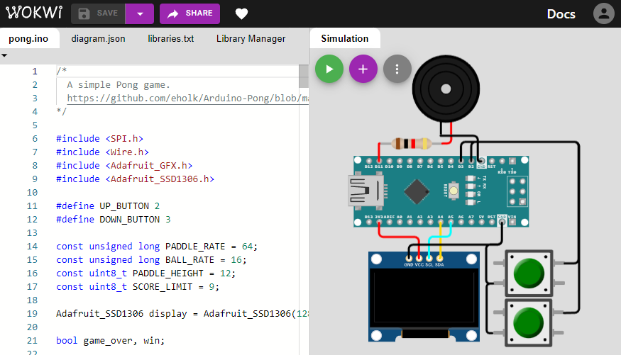

    Not really an answer but a environment I have found helpful at times for testing small code snippets without the actual hardware in front of you.
    https://wokwi.com/projects/346340290067432020
