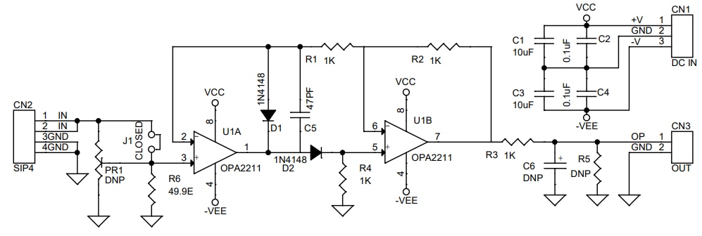

I'm working on a system that reads the voltage drop across test probes measuring AC voltage in the range of 0.05V to 5.00V RMS. I need help to design a precision full-wave rectifier circuit using an op-amp that can accurately rectify these low-level AC signals, so they can be digitized by an ADS1115 ADC and further processed using an Arduino.

    0 dougw over 1 year ago
    Here is an app note:
    Precision Full-Wave Rectifier, Dual-Supply
    I might substitute a chopper low offset zero drift op-amp.

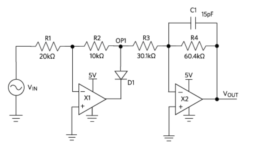

    0 dougw over 1 year ago in reply to Rakesh.Pundir
    Diodes Incorporated AS333SE-7
    single supply rectifier....
