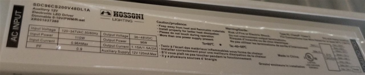

I recently started working on 8' LED tube light. It uses HOSSONI LED Driver (Ballast) SDC96CS200V48DL1A. I believe this is a Constant Current Driver.
t has following:
  • Input voltage measured is 120Vac
  • Output: 36-48Vdc, Actual No-load voltage: 55Vdc
  • 3-wires are connected to the LED lights
  • 3 position switch to select the color 5000-4000-3500K
  • Aux Output: 0-10Vdc (Not used)
  • 0-10Vdc for Dimmer So, a non-dimmable LED Driver should work.
Questions:
  1. A 3 position switch is used to set the color. Does this switch actually changes output currents to 1150mA, 1500mA, or 2000mA?
  2. Does Higher the output current mean higher K value?
  3. There is another switch for Wattage setting; 90-68-48W. What's the meaning of this? Is this the power wattage available or applied to the LED light?
  4. Does the change in output current changes above wattage (90-68-48W)?
Please let me know if more information is required from my side.

    Questions 1. A 3 position switch is used to set the color. Does this switch actually changes output currents to 1150mA, 1500mA, or 2000mA ? No. The switch changes the LEDs driven to be either just…
    0 dougw 1 month ago
    LEDs don't change color with power level, LED systems change color by having multiple LEDs where each LED may be a different color and varying the current in different colored LEDs.
  • Gough Lui
    0 Gough Lui 1 month ago
    Questions
    No. The switch changes the LEDs driven to be either just the daylight colour, warm white colour or both to give you the three colour temperatures.
    No. A higher output current pushes the LEDs harder and creates a higher brightness, but at the cost of heat and lifetime. A slight shift in spectrum does occur in white LEDs, but it's not a fixed relationship with CCT
    This is just selecting a different drive current to allow you to adjust the output.
    Yes.
