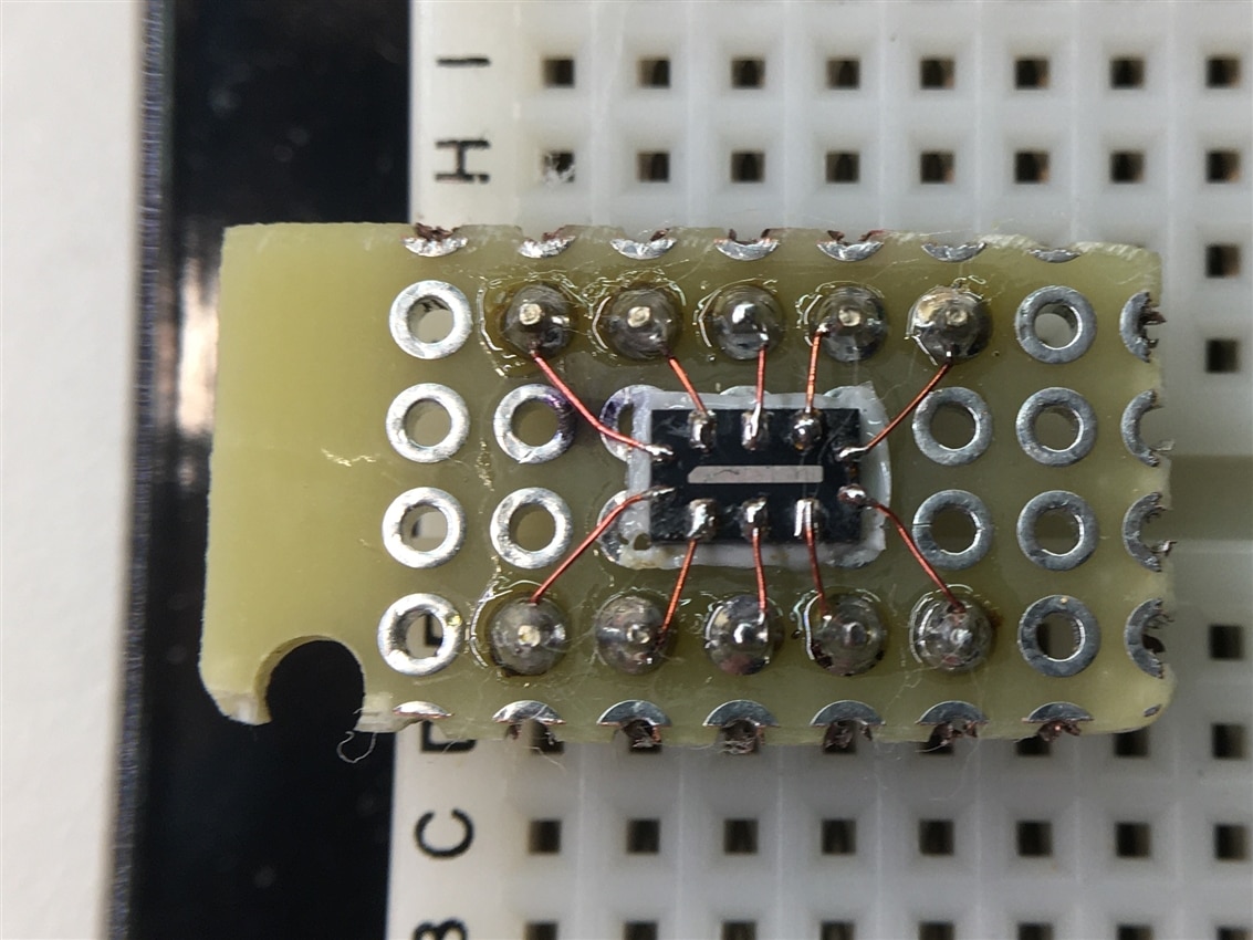

    I'm finding that prototype boards are becoming more difficult to make universal because so many interesting parts now come in weird SM packages.
    Using intermediate prototype boards with maybe a few components and a DIL footprint and then a main board like yours would be a reasonable solution - although I normally just go fo a custom pcb.
    Where did you order these and how long will they take to come - the people I use (PCBCART) are good but a lot more expensive.
    MK
  • wolfgangfriedrich
    wolfgangfriedrich 2 months ago in reply to michaelkellett
    If the SM package becomes too weird, you have to do dead-bugging anyways. Then the through hole grid works perfectly again.
    shabaz 2 months ago in reply to wolfgangfriedrich
    Nice dead-bugging!
