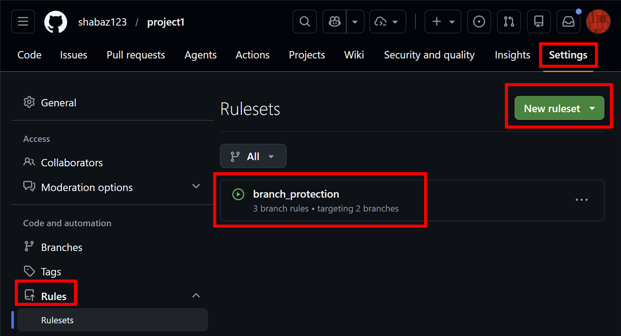

Is It Safe?
Generally, yes! The workflow is designed to avoid using the main branch for direct feature development. One could still mistype Git commands, but most things are generally reversible. Perhaps one may accidentally erase code they had not committed, but that could occur even if one was not using Git. Furthermore, you can try to prevent people from deliberately (or accidentally) working around certain parts of the workflow, by creating branch rulesets (not detailed here, but you can explore that from the GitHub site; see the screenshot below to find where to navigate to.
This blog post uses a real-world repository containing a simple project called project1, and you're welcome to try things out using that repository, or (recommended) create your own. To keep it realistic, I'll happily accept any pull requests that either improve the project, even in minute ways, or result in minor tweaks to README files (I'm OK even with "this is a test" sentences added to the project1 README). However, you'll need to be added as a collaborator by me (I'll need your GitHub username), otherwise you won't have permissions for certain steps. Therefore, it's easier is to create your own repository by forking the project; the screenshot below shows where to click, to do that.

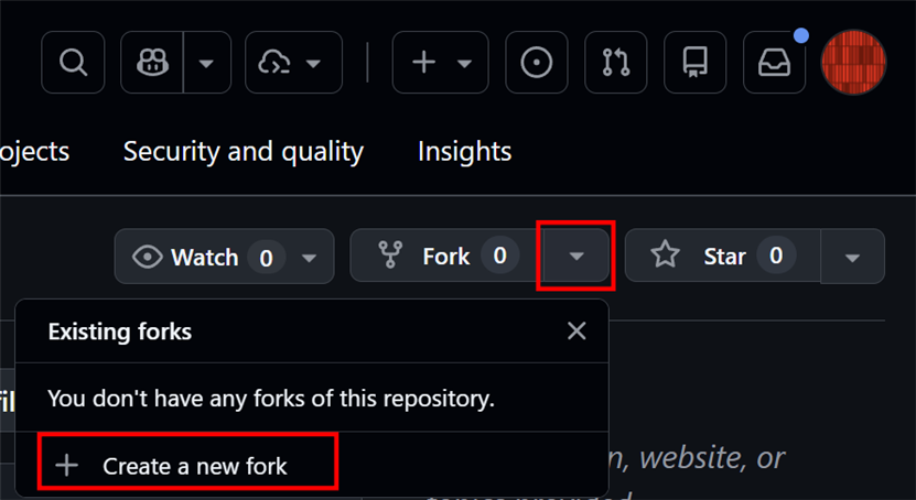

In summary, to follow the tutorial, it's best to create your own repository (either from scratch, or by forking).
OK; it’s time for the step-by-step tutorial. You could try this yourself by creating a GitHub account, and then following from step zero!

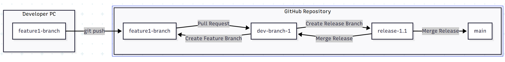

Tutorial Diagram
You may wish to refer to this as you follow the tutorial steps. The diagram assumes steps 0 and 1 have already been completed. This diagram does show a time sequence, running from left-to-right. The remote repository branches are in solid colors, and the local (PC) content is shown with thin double-lines.

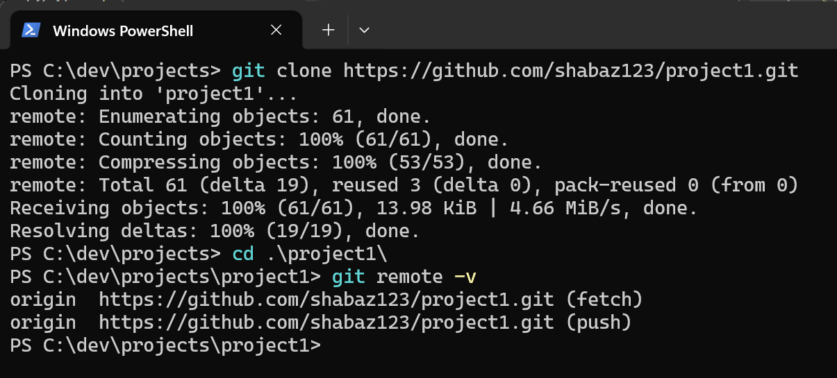

Tutorial Step Zero: Create a GitHub Repository
Use the GitHub site to create a repository if you don't already have one to use. It’s worth getting the site to automatically add a README file at this stage.
Next, on your PC:
git clone https://github.com/<your_github_username>/project1.git # Creates a local copy of the repository onto your PC
git remote -v # Displays the remote repository URL, in case you later forget! It may display multiple URLs for clarity about which URL later operations like git pull and git push will use

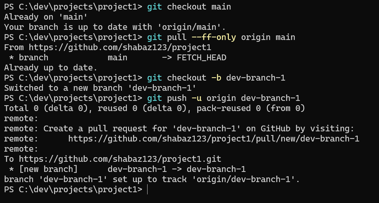

1. Create an Integration (Development) Branch
The plan is to create a branch which will be used as a long-lived development branch. It will be reused for each sprint.
git checkout main # View your local copy of the main branch. Since this is local to you, this may eventually be old compared to the origin (remote repository) if someone else makes changes to that meanwhile
git pull --ff-only origin main # update your view with the latest from the origin (the --ff-only means abort if you have local commits that have not been pushed and origin has also moved forward meanwhile).
git checkout -b dev-branch-1 # Create the branch on your local PC
git push -u origin dev-branch-1 # Publish the branch on the remote (i.e. origin)

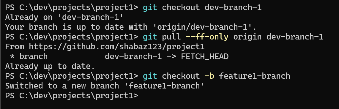

2. Create a local Feature Branch
git checkout dev-branch-1 # View the project on your local copy of the development branch
git pull --ff-only origin dev-branch-1 # update your view with the latest from the origin
git checkout -b feature1-branch # Create the feature branch locally on your PC

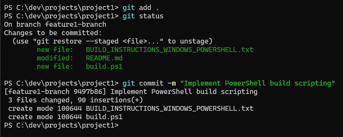

3. Code the Feature
git add . # Prepares (stages) any new/modified/deleted files in your local view
git commit -m "Implement feature 1" # Checkpoints your changes and new files in your local view

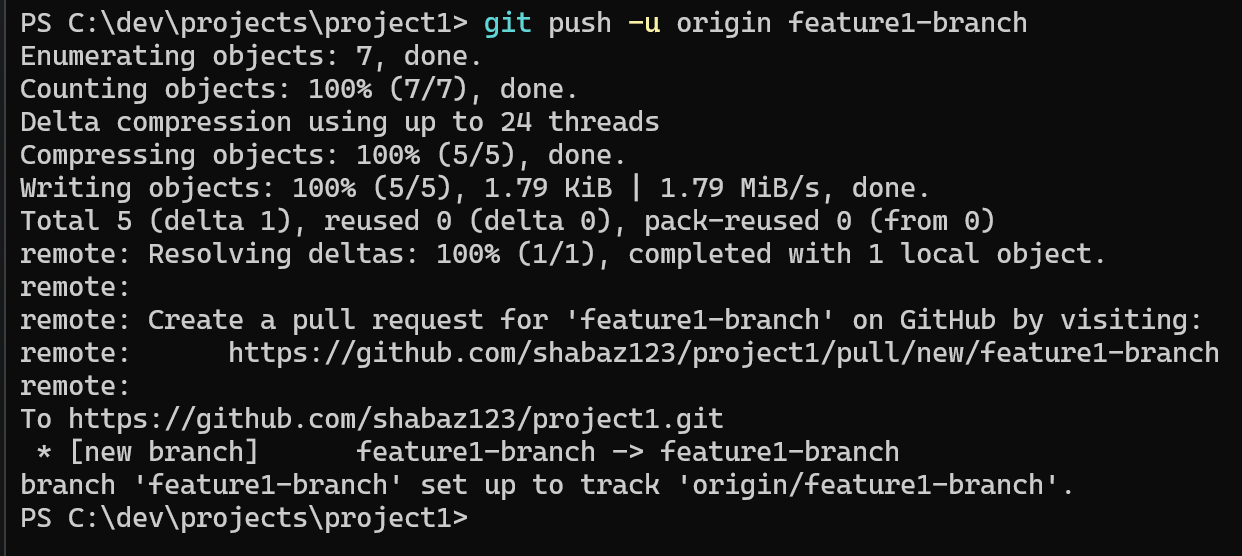

4. Publish the Feature Branch
git push -u origin feature1-branch # Creates or updates the feature branch at the origin

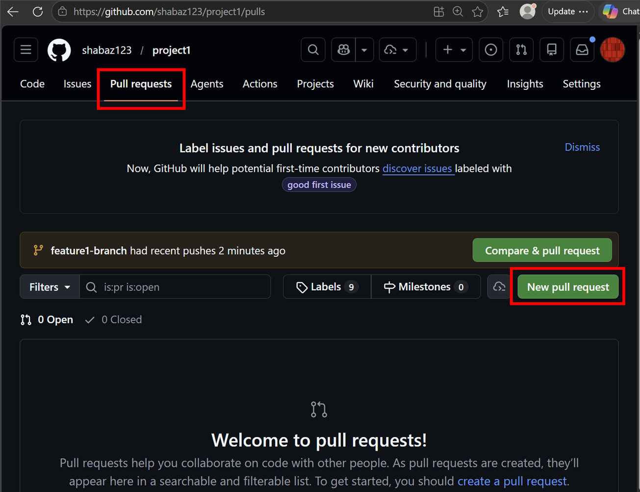

5. Merge Request (aka Pull Request) to Development Branch
In GitHub, click to create a Pull Request, with the feature branch being the source, and the development branch being the destination. Wait for the request and your code to be reviewed and merged!
This screenshot shows where to go to create the pull request:
In the drop-down boxes, select such that the feature branch is the source (notice the arrow direction in the screenshot) and that the development branch is the destination.
Next, the user will be prompted to click a button that will perform the merge. Now the feature code is in the development branch in the repository.

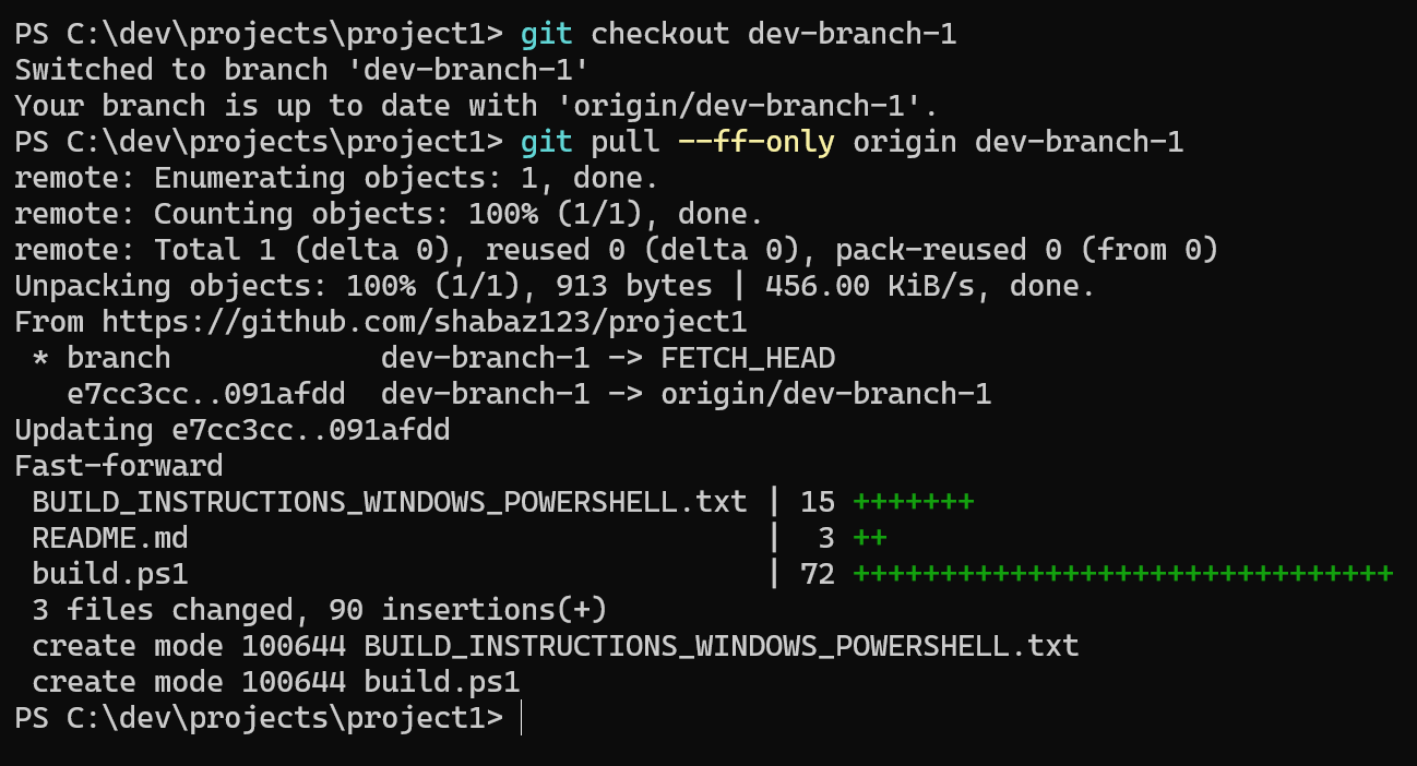

6. Update your local Development Branch

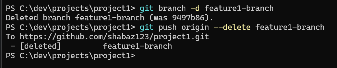

7. Destroy the local and remote Feature Branch
git branch -d feature1-branch # delete the local PC feature branch
git push origin --delete feature1-branch # delete the feature branch at the origin

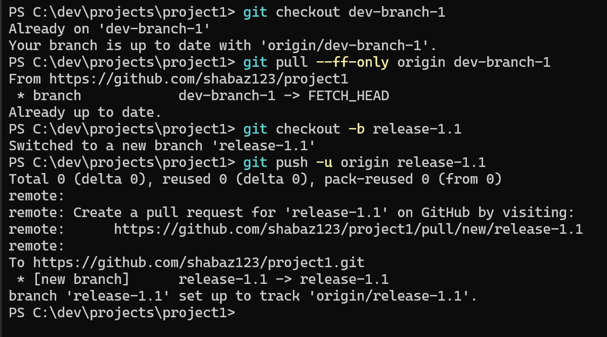

8. Create a Release Branch
git checkout -b release-1.1 # Create the release branch on your local PC
git push -u origin release-1.1 # Creates or updates the release branch at the origin

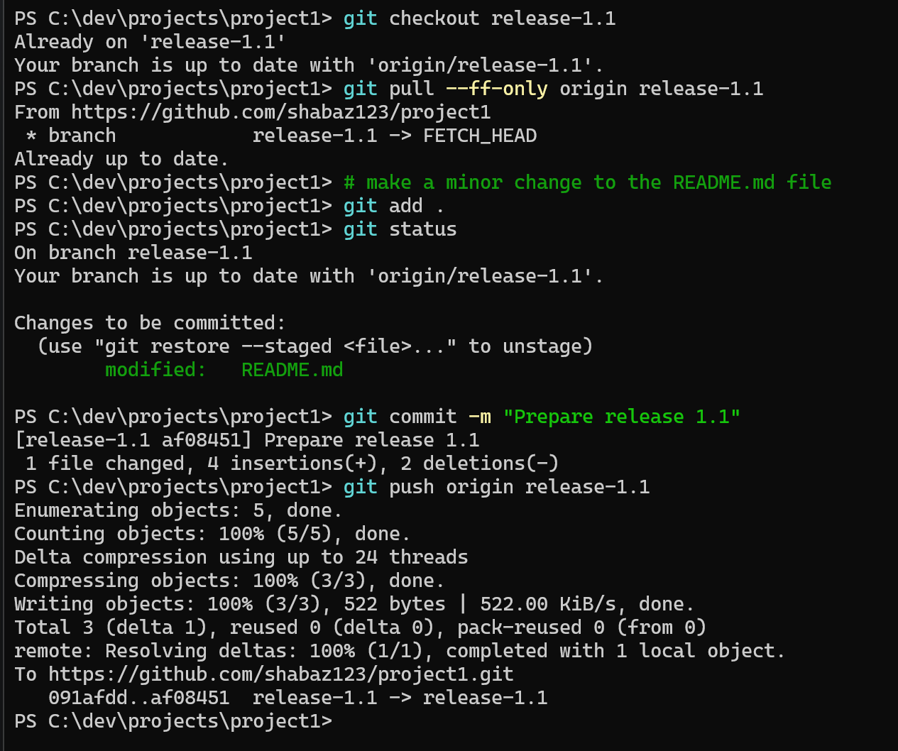

9. Make Minor Fixes in the Release Branch
git checkout release-1.1 # View the project on your local copy of the release branch
git pull --ff-only origin release-1.1 # update your view with the latest from the origin
git commit -m "Prepare release 1.1" # Checkpoints your changes and any new files in your local view
git push origin release-1.1 # Updates the release branch at the origin

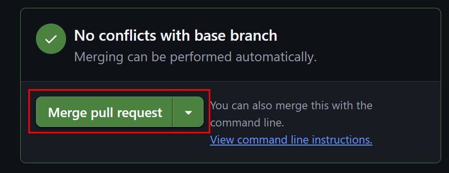

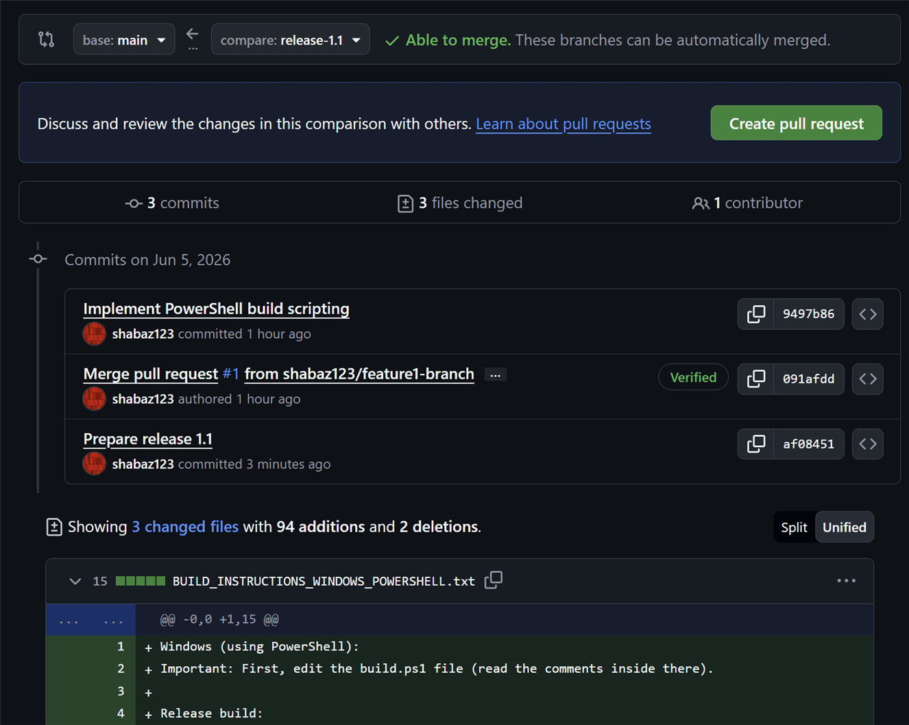

10. Merge Request (aka Pull Request) Release Branch to both Main and Development Branches
You want the release branch content to be within both the main and the development branches.
In GitHub, click to create a Pull Request, with the release branch being the source, and the main branch being the destination. Wait for the request and your code to be reviewed and merged! Repeat, this time with the development branch being the destination.
Here is a screenshot of the merge to the main branch about to be performed. The merge to the development branch is performed in a similar way.

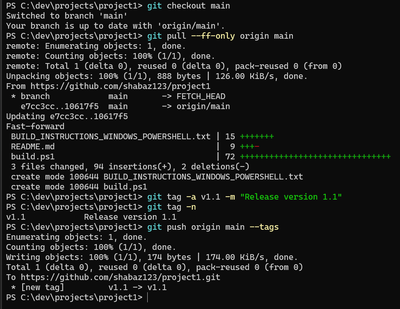

11. Tag the Release
git checkout main # View the project on your local copy of the main branch
git tag -a v1.1 -m "Release version 1.1" # create a tag in your local view at the current commit you’re at
git push origin main --tags # Updates, including tags, the main branch at the origin

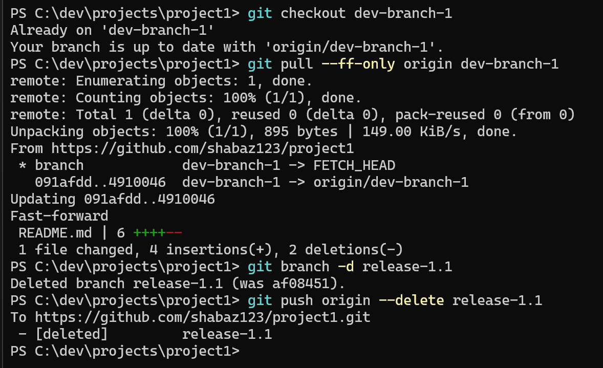

12. Destroy the Local and Remote Release Branch
git checkout dev-branch-1 # Switch away from release-1.1 first
git branch -d release-1.1 # Delete the release branch on your local PC
git push origin --delete release-1.1 # Delete the release branch at the origin

    Finally, to delete the feature branch:
    git checkout main  # get away from the branch that is to be deleted
    git pull # update the view with the latest from the origin
    git branch -d feature-acmeas # delete the local feature branch
    git push origin --delete feature-acmeas # delete the branch at the origin
    All done!
  • balajivan1995
    balajivan1995 3 months ago in reply to shabaz
    All I wanted to say is to include the image you've captured above in the 4th step as an additional information. "You may be prompted to login to GitHub platform to push the changes for the first time". That's it.
    Guess I should've been clearer.
    shabaz 3 months ago in reply to balajivan1995
    Sorry, I still don't get your point. If credentials are required you'll be prompted for them.
    Is it the case that you're concerned that a user may find it unexpected to see slightly different output whereas the example didn't show a prompt for credentials?
    If that is your concern, I think it's a minor issue, simply because I think users will not find it too unexpected nor unmanageable by themselves, that output can be slightly different - I cannot be expected to show the precise detail for every eventuality, nor would I want to. Outputs change and precise command line output can too, over releases. I expect people to use their own judgement at times, especially when there is a lot to go through and they may be using different versions of software and different operating systems too.
    I have tried to understand where you're going with this, but it makes no sense to me. I tried destroying my credentials and re-running the commands, and I see a very unconfusing request to sign in:
    As mentioned, this is sufficient to get through the blog post with GitHub specifically - it's in the title. Any more detail regarding credentials is not within the scope - and I'm OK with that, because I don't see any further detail on this topic in other tutorials either, e.g. the one in Code magazine that I referred to.
    How about this - since I genuinely still don't understand your precise concern, please create a blog post showing the detail that you think readers require to follow the blog post, and if you provide a link to it, people will be able to navigate to it if they do indeed get stuck, and it will be appreciated a lot.
  • balajivan1995
    Git doesn't ask for authentication either after installing or during first usage. It'll ask for username and an email ID when user try to commit some changes. Authentication is required when we clone private repo which we have access to, or pushing the changes to remote first time - regardless of whether it's a public or private repo. Git doesn't need authentication to clone a public repo or to make local commits.
    I thought this might be worth adding considering people who are new to GitHub might be new to git in general as well, and this might be the first time they will configure git to use with remote repositories.
    I think that's fairly unlikely to occur for someone following the blog. There's a link to installing Git, and it will ask for authentication (either after install or when first used). At least, for Windows, it did (I have not tested on Linux recently, but I believe it would be the same). It would increase the blog post a fair amount to start adding credential related material. I think that's very much beyond the scope of this blog.
