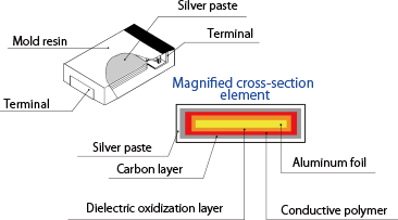

  • SP-Cap (Aluminum Polymer, Multilayer): Figure 1a shows a rectangular-shaped, aluminum electrolytic capacitor that uses a polymer as its electrolyte. SP-Cap is primarily used as input and output Capacitors for DC/DC converters due to its ultra-low ESR and low Equivalent Series Inductance (ESL), a long-life span, a compact size, a low profile, and high stability. It is suitable in final products such as servers, AC adapters, embedded boards, and SSDs.
Figure 1a: Structure of SP-Cap Capacitors (Source)

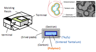

  • POSCAP (Tantalum Polymer): These capacitors have a sintered tantalum anode and a proprietary high-conductivity polymer cathode (Figure 1B). Tantalum Polymer capacitors can simultaneously maintain low Equivalent Series Resistance (ESR) with stable capacitance at high frequencies and temperatures.
    Panasonic's advanced Tantalum-Polymer Capacitor technology delivers some of the lowest ESR levels and excellent performance in high-frequency applications. POSCAP capacitors come in a range of compact package sizes, ensuring a small PCB footprint with high volumetric efficiency.
    Additionally, POSCAP capacitors offer high reliability and exceptional heat resistance, making them an ideal choice for digital, high-frequency devices and more.
Figure 1b: Structure of POSCAP Capacitors (Source)

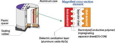

  • OS-CON (Aluminum Polymer, Wound): These Solid Electrolyte Aluminum OS-CON Capacitors use aluminum and a highly conductive polymer material (Shown in Figure 1C) to offer low ESR, excellent noise reduction, superior frequency characteristics, and ripple current capabilities. Additionally, it has a long lifespan, with minimal ESR variation, even at low temperatures due to its solid electrolyte. It supports up to 7.5A ripple current and withstands voltages up to 100V. These capacitors are available in surface-mount and through-hole types. They are commonly used in power electronics, industrial automation, and computing applications.
Figure 1c: Structure of OS-CON Capacitors (Source)

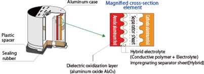

  • Hybrid Capacitors (Aluminum Hybrid Polymer/Electrolyte): Hybrid Capacitors are known for their stable electric characteristics at high frequencies while maximizing reliability. The electrolyte consists of conductive polymer and electrolytic liquid (shown in Figure 1d) and has high endurance, low ESR, high tolerance for ripple currents, inrush currents, and elevated temperature. These Hybrid Capacitors are compact, allowing significant board space savings. Its "hybrid electrolyte" is used in a wide range of automotive and industrial applications such as BMS, ECUs, LED headlights, and ADAS systems.
Figure 1d: Structure of Hybrid Capacitors (Source)

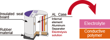

Aluminum capacitors are polarized electrolytic components where an aluminum oxide film forms the dielectric on the etched surface of an aluminum foil anode, while an electrolyte liquid serves as the cathode, as shown in Figure 2. This structure increases the electrode surface area through etching, enabling compact designs with high capacitance and reliability.
Figure 2: Structure of an Aluminum electrolytic Capacitor (Source)

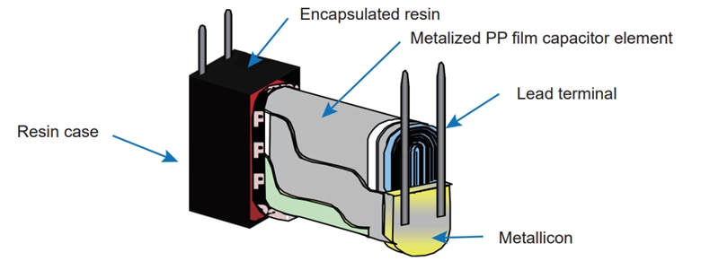

Film capacitors are a highly reliable capacitor that uses an insulating plastic film as the dielectric material. These capacitors are primarily made of PP (polypropylene), PET (polyethylene terephthalate), PPS (polyphenylene sulfide), and PEN (polyethylene naphthalate) as dielectric materials. They offer higher insulation resistance than ceramic and aluminum electrolytic capacitors, along with a greater ability to keep stored electricity. Characterized by excellent volumetric efficiency, high reliability, high insulation resistance, and low ESR and ESL, they are commonly used in high-frequency applications, power factor correction, and start-run motor circuits.
Additionally, film capacitors experience lower energy loss during charging and discharging compared to other capacitor types. PP-based film capacitors not only operate with minimal losses but also maintain their efficiency despite temperature fluctuations.
The primary cause of deterioration in film capacitors is electrode oxidation. Panasonic has enhanced moisture resistance through "encapsulation technology" and "weatherproof technology." Encapsulation technology minimizes moisture penetration into the internal element by optimizing exterior case materials, filling resin, and high humidity-resistant metallic coatings. Weatherproof technology further prevents electrode erosion by utilizing highly moisture-resistant evaporated metal and advanced processing techniques for internal electrodes, as illustrated in Figure 3.
Figure 3: Structure of Film Capacitor (Source)

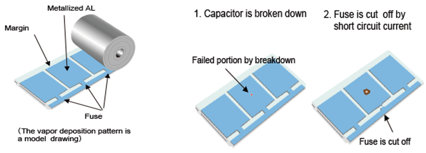

Fuse Function Technology:Unlike traditional aluminum electrolytic capacitors, which open upon failure, film capacitors tend to short-circuit, posing a potential hazard. To mitigate this risk, Panasonic has developed a fuse function for its film capacitors by incorporating fragile layers of vapor-deposited aluminum slits at various points in the dielectric material. These slits localize failures, as shown in Figure 4, limiting damage to only a few sections of the capacitor. If too many of these areas fail rapidly, the capacitor will open in a fail-safe manner.
Figure 4A: Construction of inner electrodes (b) Operation of fuse function (Source)
How it Works:
  • If a local breakdown occurs due to high stress, only the affected segment becomes an open circuit, preventing further damage.
  • The capacitor continues to function, and permanent failure (such as fire or smoke) is averted.
  • This self-healing function also increases the capacitor's functional lifespan, making fuse function technology ideal for xEV inverters, industrial power systems, renewable energy converters, and other high-stress applications.
