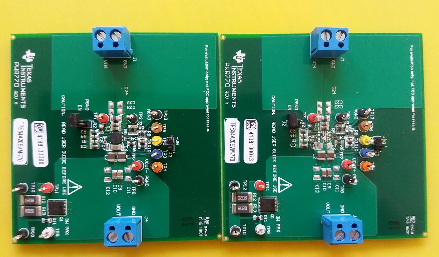

I received an evaluation board for the TPS54A20 DC/DC converter from TI.
This switcher is specific for low voltage designs. The output range is 0.5 - 2 V.
That's a very narrow range. In that range it can deliver 10 A, with a typical input of 12 V.
Efficiency is in the lower-to-mid 80%.
With a switch frequency of 2 MHz (more on that later) it allows for small passive components and a condensed footprint of the whole stepdown module.
The reason that I want to review this particular converter is because it's a two-phase type.
TI specifies it's in essence a 4 MHz design because of this. I'll validate if that's sales lingo or truth.

Evaluation Board Configuration
The board is configured for 1.2 V output and 2 MHz switching frequency.
Input voltage is between 9.2 and 14 V, although 9.4 V is required initially to prime the converter.

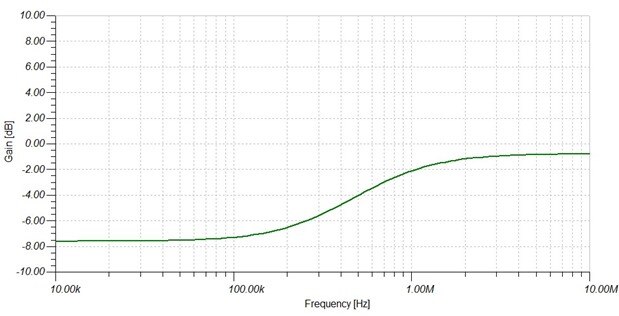

    This is fun. Couldn't resist looking at the compensation on the feedback.
    Here's what it looks like in a simulator.
    The response [of the converter] is rolled off from a couple of 100kHz upwards. Might be interesting to hit the output with a heavy load at a few hundred kHz and see what happens (as that's the area where they think the compensation is becoming necessary but it's only just starting to have effect). With a power FET, load resistor and a waveform generator you could do a slowish sweep from 100kHz up to 2MHz and quickly see if there were any problem frequencies where the output was getting a bit skittish.

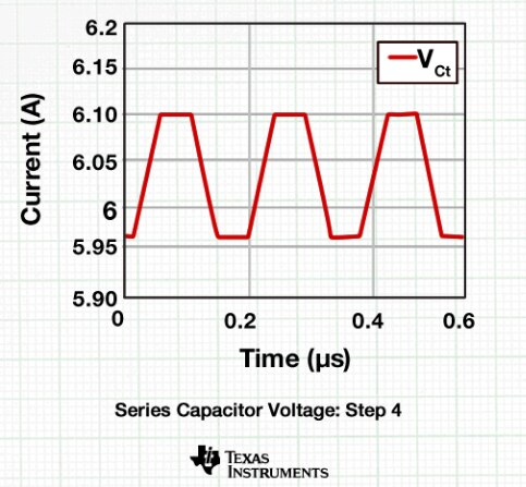

    According to this article (same as I linked in a previous comment), the voltage over the cap swings around half of the input voltage
    (its nominal value is approximately the half of that input voltage - just a little above it in that article's measurement).
    Ignore the Step 4 mention in the caption ofn the drawing below. The trace is showing a few full switching cycles in steady state.
    source: Step by step: How the series capacitor buck converter works
