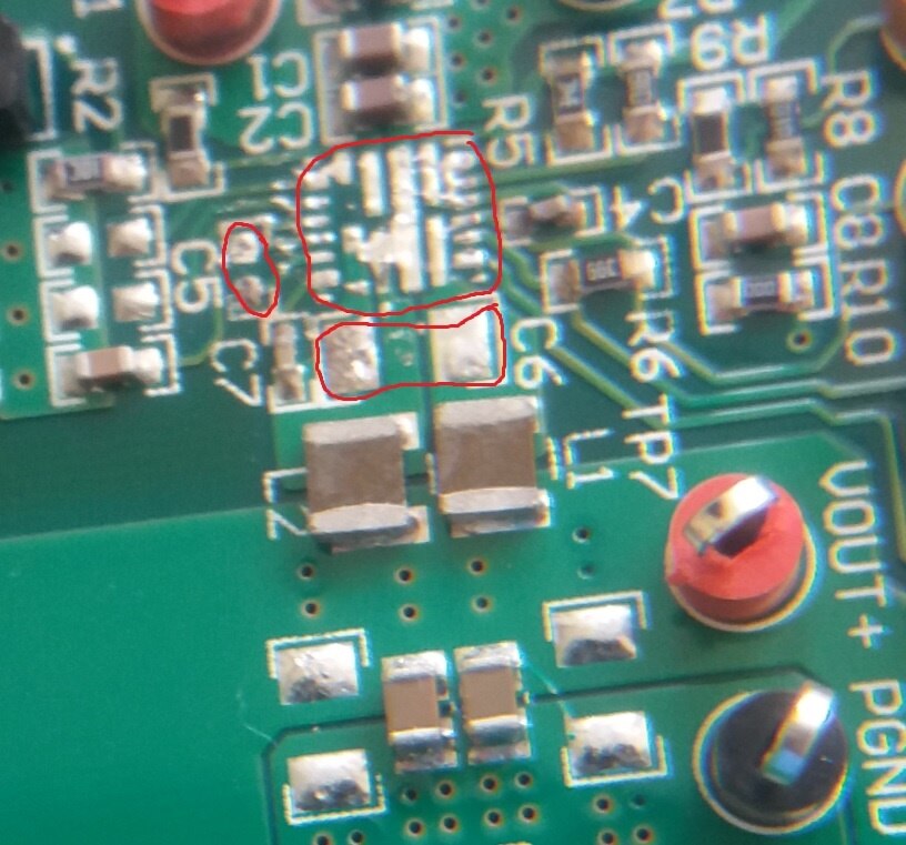

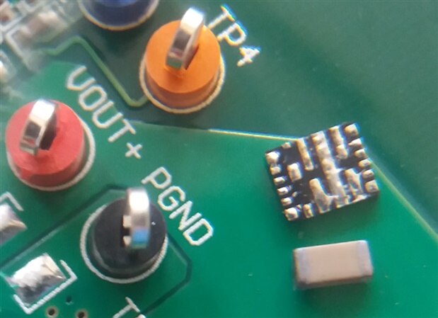

    Jan Cumps over 9 years ago in reply to Jan Cumps
    achievement 1 unlocked: the IC is desoldered.
    I still have to clean up the pads - and two capacitors flew away as collateral damage.
    All in all it's going in the right direction.

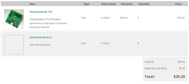

    Jan Cumps over 9 years ago in reply to jc2048
    I'm taking a shortcut here image
    It's Jack Kilby day at TI, and this board is 20% off , no shipping costs, during that promotion.
    I bought a new one for $39.20 delivered.
